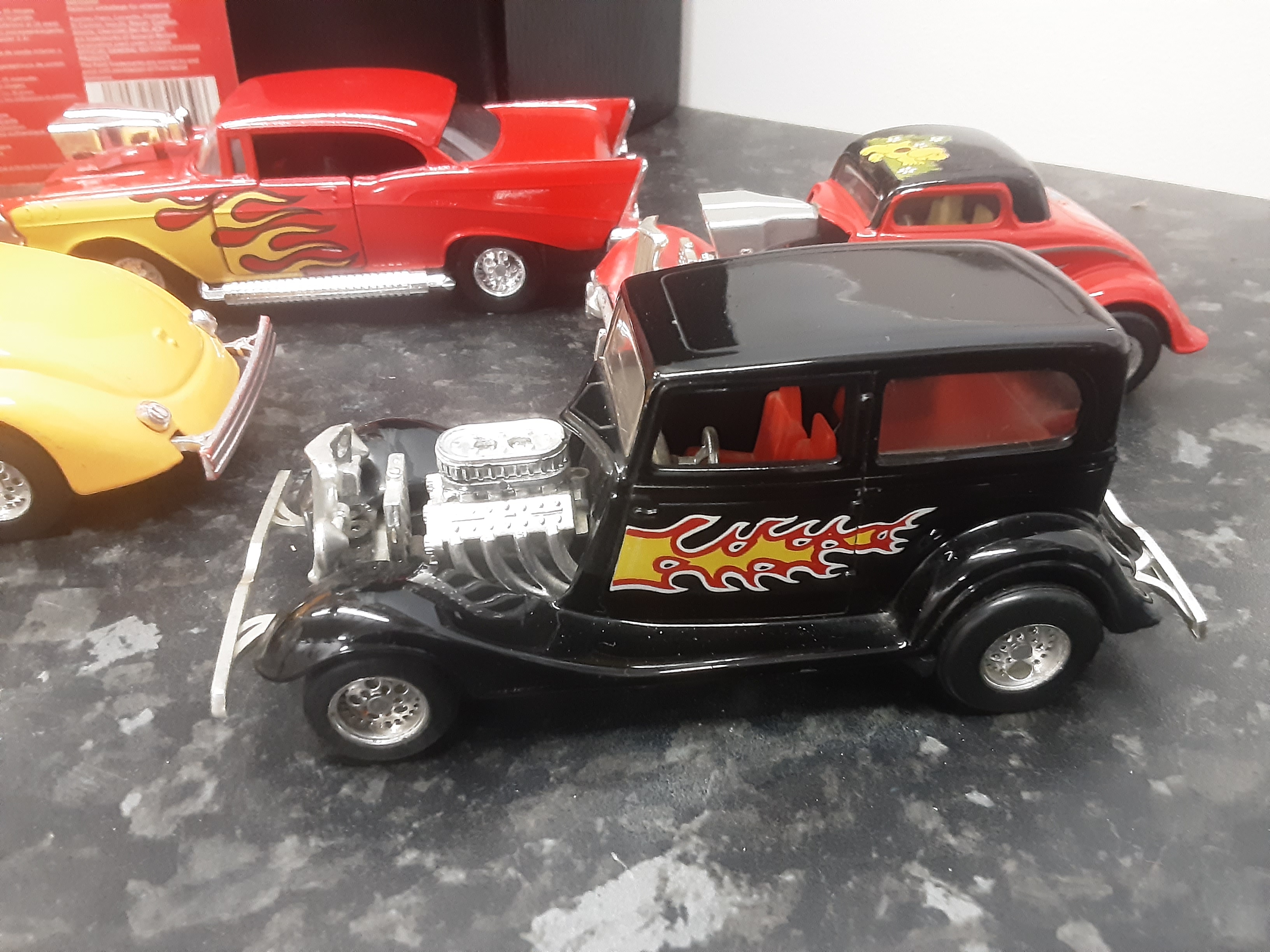

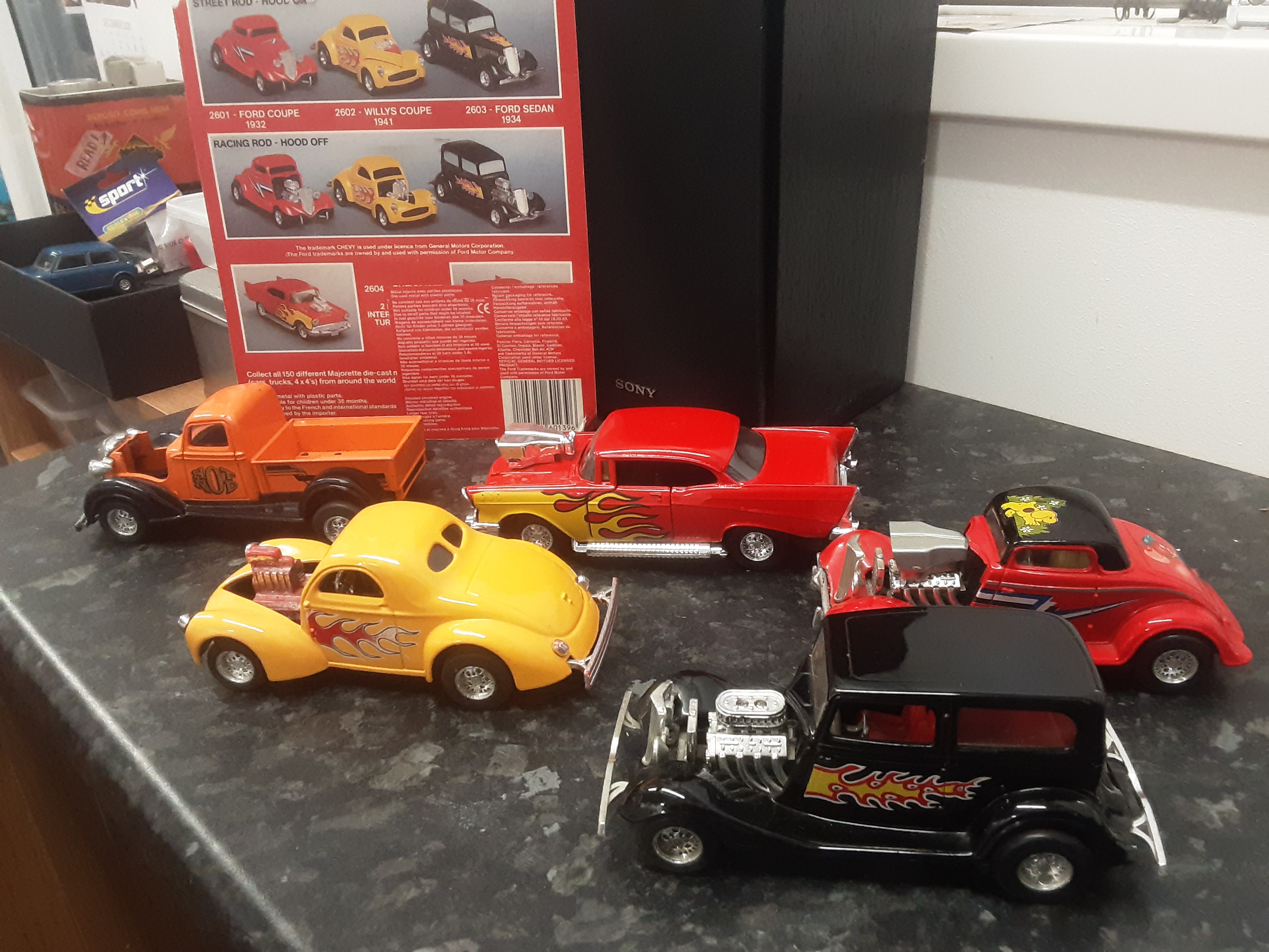

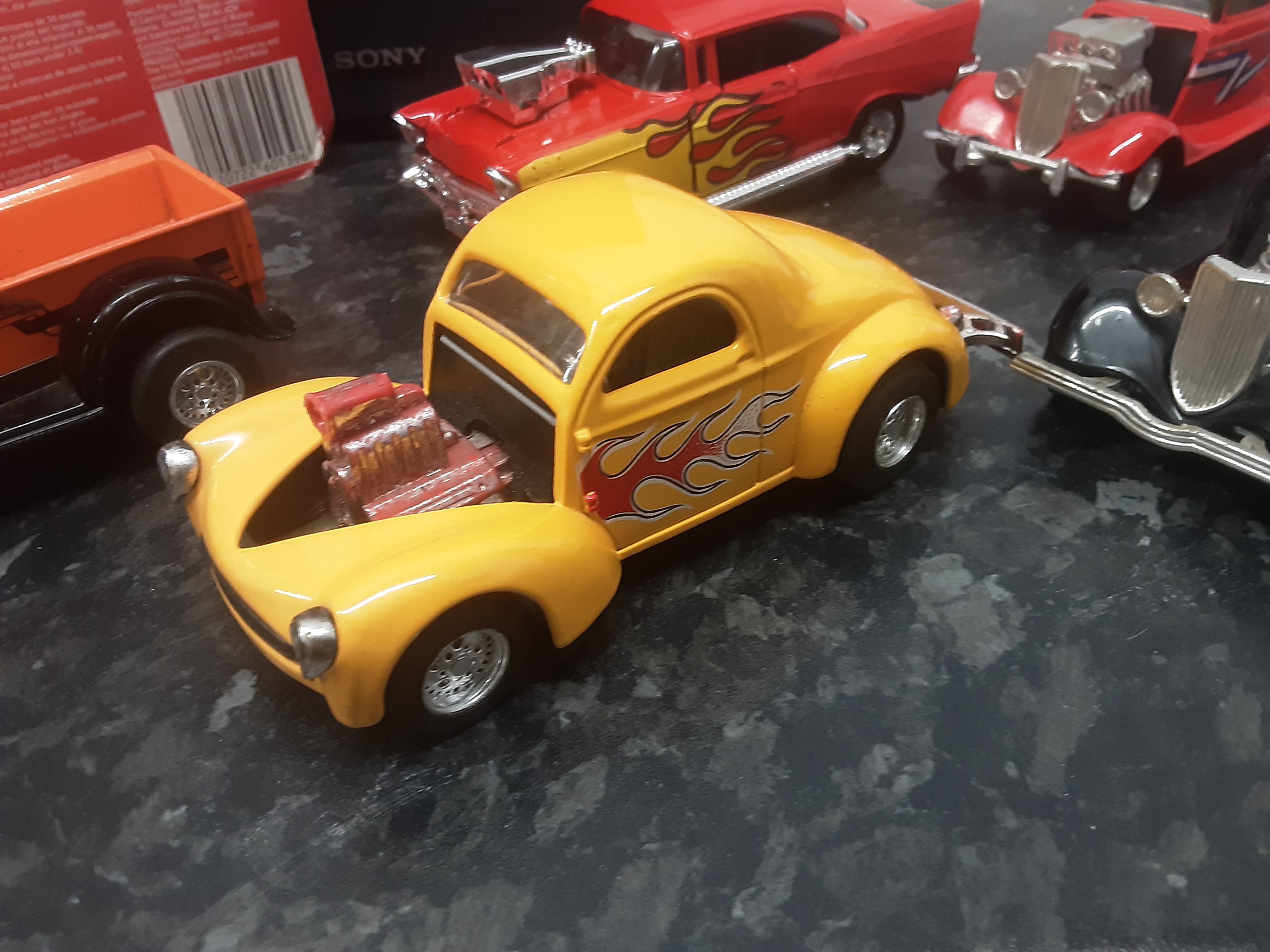

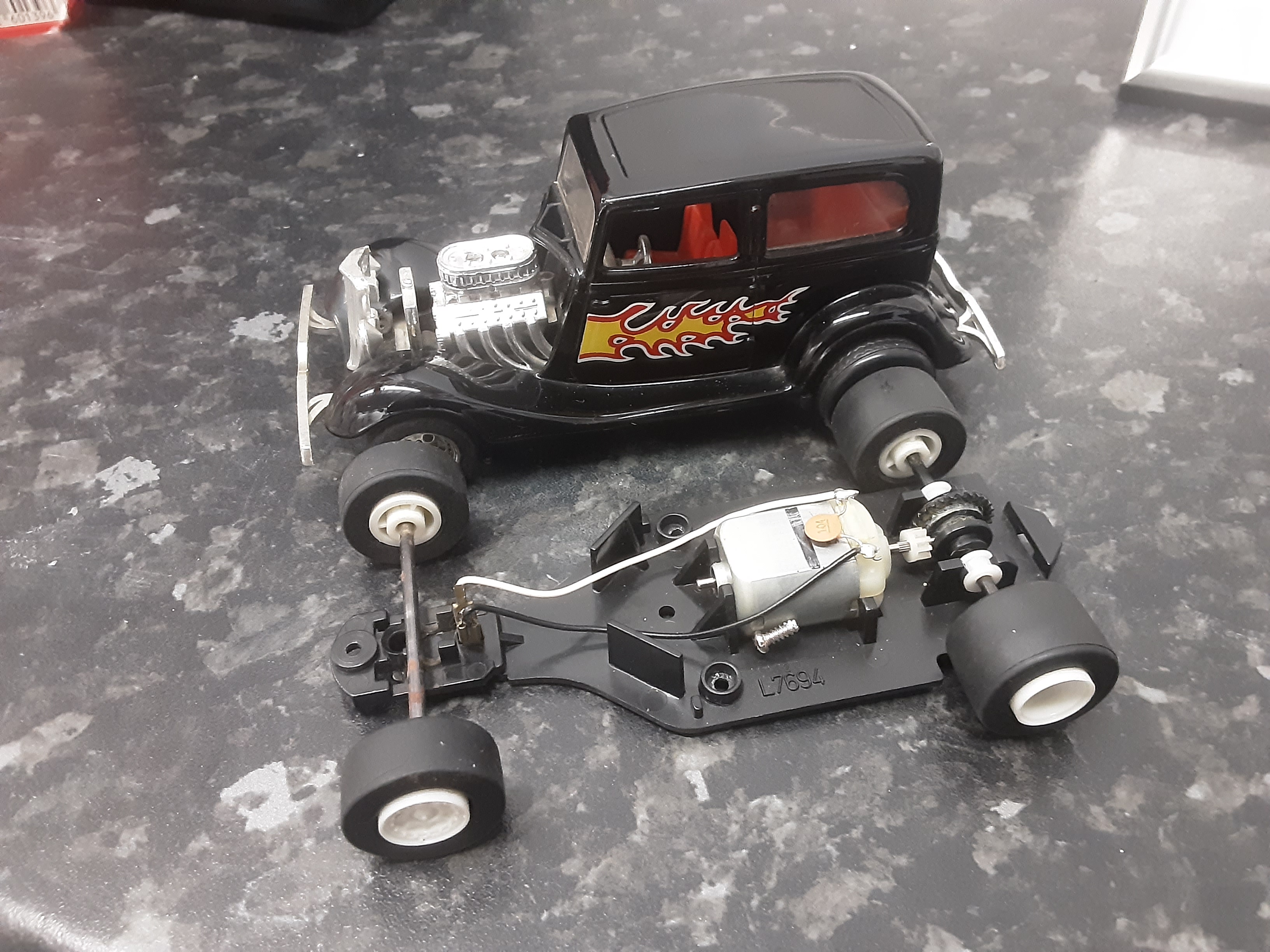

Here are some photos of the Majorette 1 32 scale Hot Rods that will  be getting the same treatment.
All purchased from eBay, used under £6, except for the Chevy '57.  That was brand new and was £6.99!
These are fairly heavy.  I will be using chassis's from the generic Scalextric Formula 1/ Formula 3 cars from the mid '90's.
Very cheap to purchase, easy to modify, inline motors and very flat chassis.
Should be a bit of fun, and once completed (started would be progress) will be a fun edition to a Club night.
Obviously they will not break any records,  but possibly will  break the scenery... Rofl
[attachment=20712]
[attachment=20713]
[attachment=20714]
[attachment=20715]
Will put some chassis photos up next.

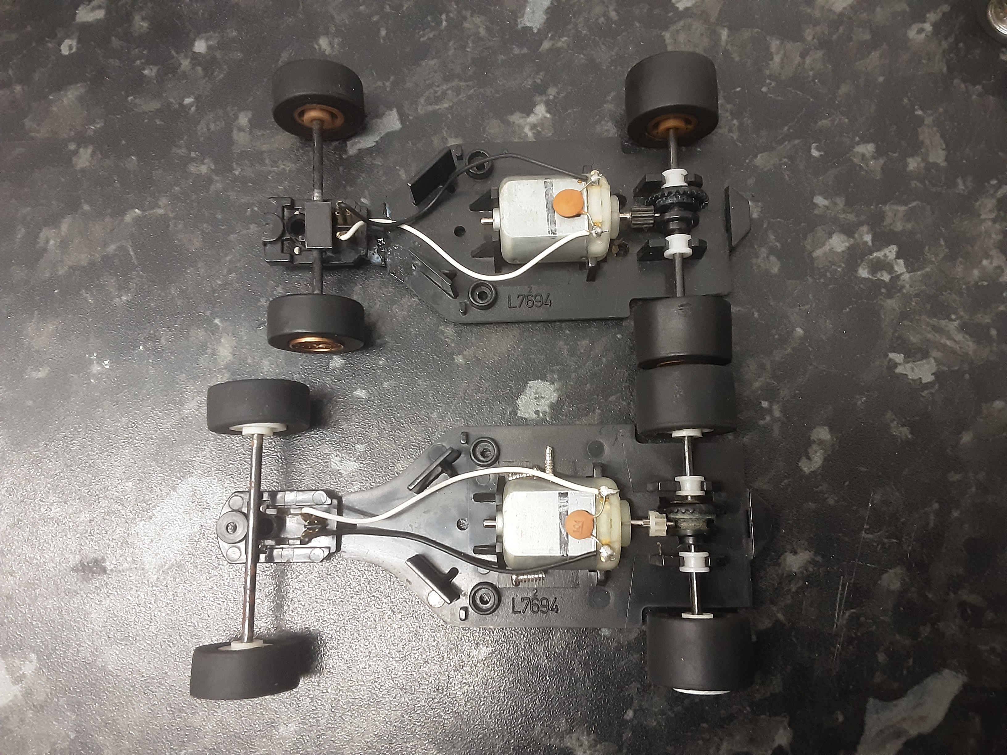

RE: VW splitscreen converted to Crewcab sign truck - Gpa113 - 14th-Jan-22

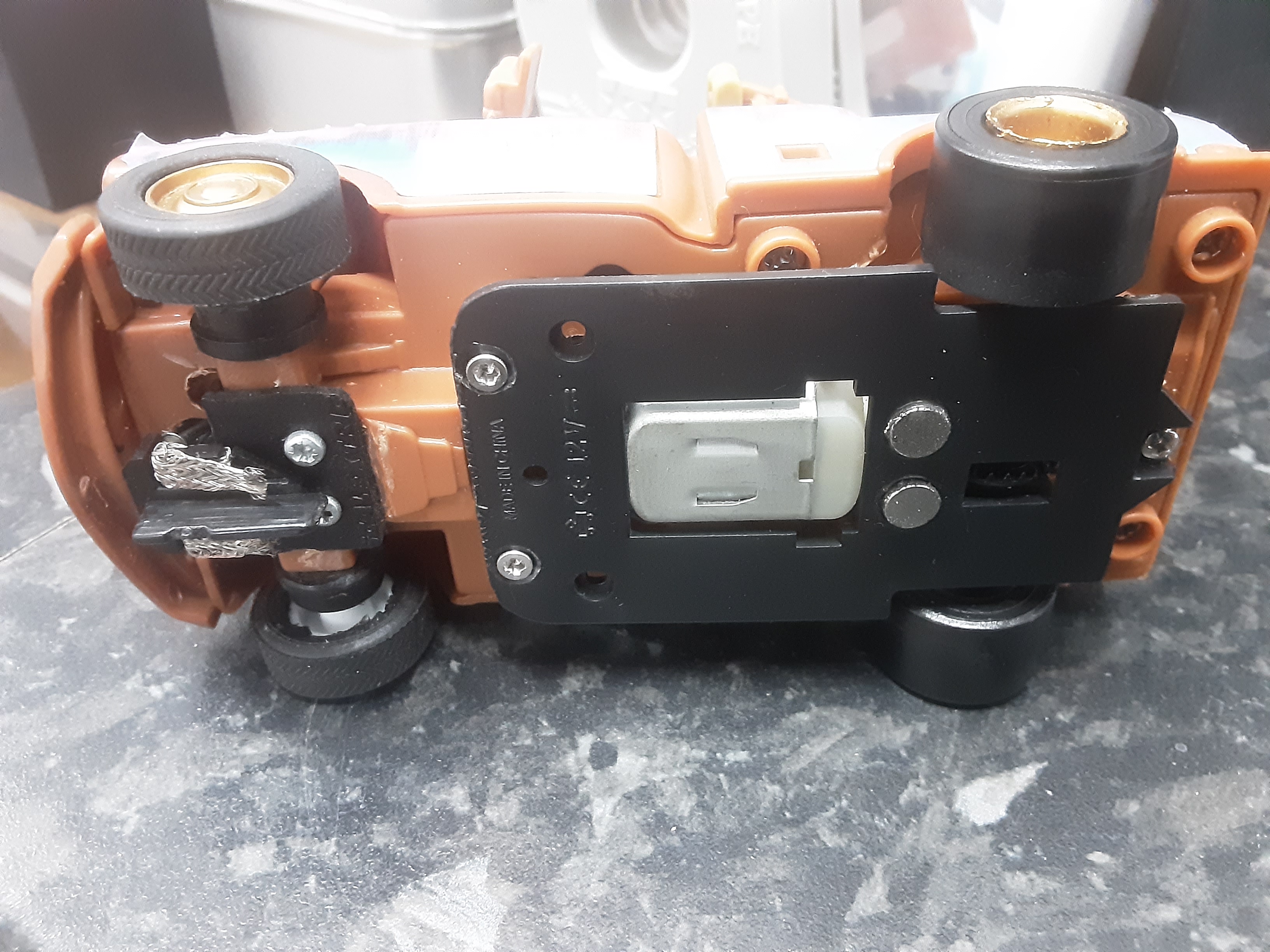

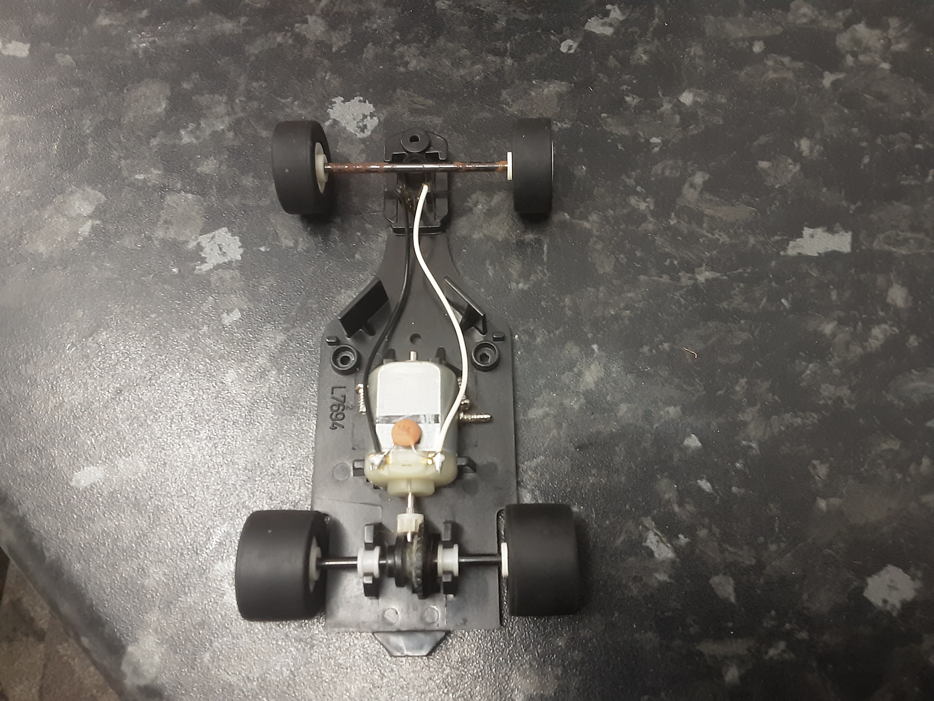

Here are some photos of the generic Scalextric Formula 1 / Formula 3 chassis's.
Note how little there is to start with, how they can be narrowed very easily, and that you can shorten, or even cut them into 2 separate pieces.
Cutting a chassis to shorten it is really pretty straightforward.   As Mr M has already suggested, cut , shorten, brace with plasticard or similar.  Seems a silly idea the first time you go to do it, but you soon get the hang of it.  Best to start with a cheap chassis,  and don't do what I did, which was to use a junior hacksaw.  I got away with it,  but a razor saw is the proper tool for the job.  Pendle's sell these as well!!
[attachment=20716] bottom chassis standard,  top chassis cut and shortened.
[attachment=20717] standard chassis. So easy to trim.
[attachment=20718] alongside one of the Majorette Hot Rods
[attachment=20719] chassis cut into 2 pieces, and mounted onto a plastic chassis Mater truck from Cars. Not my work, but a very clever way of adapting a simple chassis.
