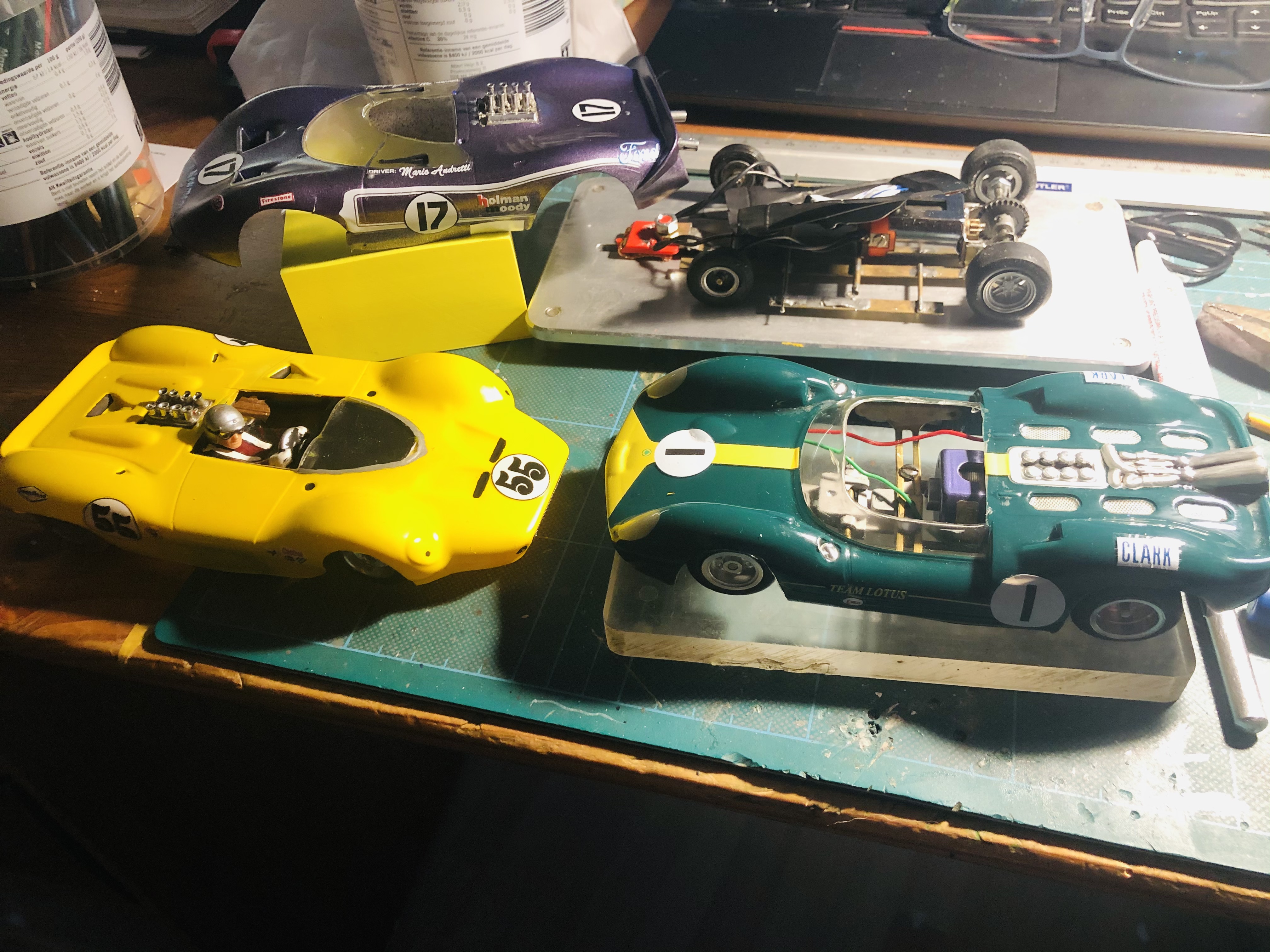

There are probably a few of us here who can remember hand painting the inside of vacform bodies with Airfix or Humbrol enamels. One big "off" at the raceway and the paint would fall off in large sections where the body flexed when it hit the barrier and the paint didn't.
 I have tried painting vacform bodies on the outside with car paints. I found that they tend to try to curl slightly possibly where the paint shrinks a little as it dries and it chips very easily particularly if the cars are raced hard. My entries for Double Trouble look a bit secondhand when I take them back for a second years racing.
 Although most of my vacforms aren't actually lexan I feel inclined to have another go with the Tamiya PS sprays but sometimes I just can't get the correct colours for the car that I want to model.
RE: Adventures with Lexan - Anthony B - 13th-Jan-21
Tony, absolutely correct. I have not worked with - let’s call it lexan  - for 25 years. I clean forgot how if you put it on too thick it bends the lexan . So first one done - the Honker- now has reinforcing ribs to prevent and correct the bending. The second one I did - the King cobra - I layered thin layers and it is fine. .
More progress.,..
[attachment=11433]

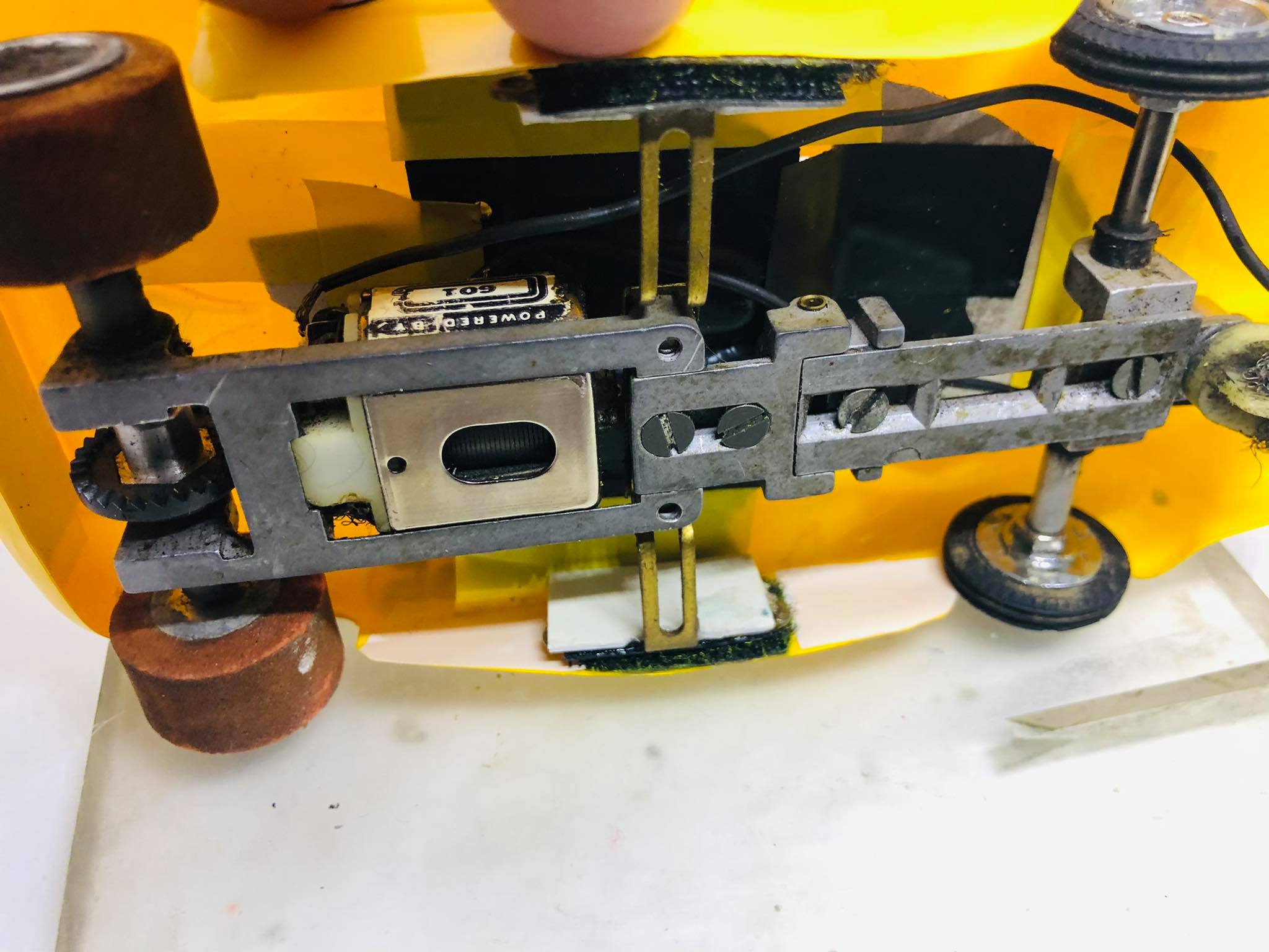

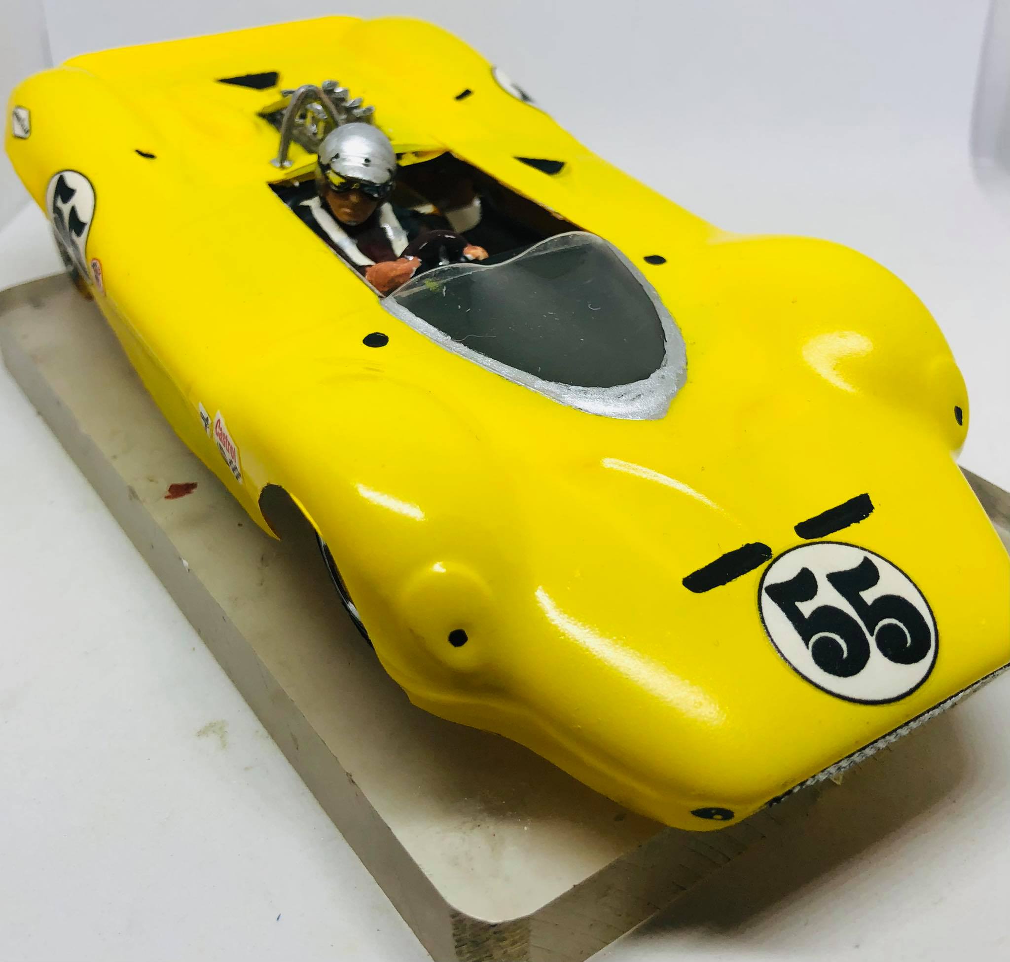

RE: Adventures with Lexan - Anthony B - 22nd-Jan-21

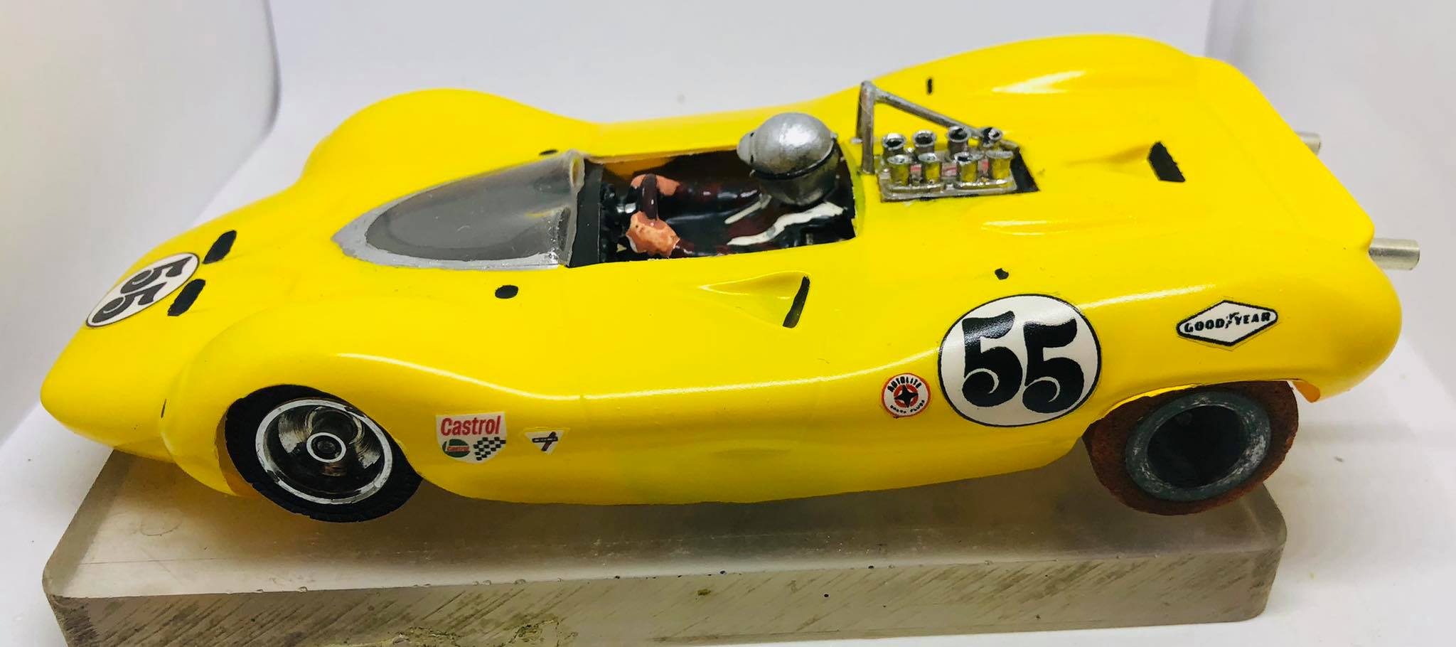

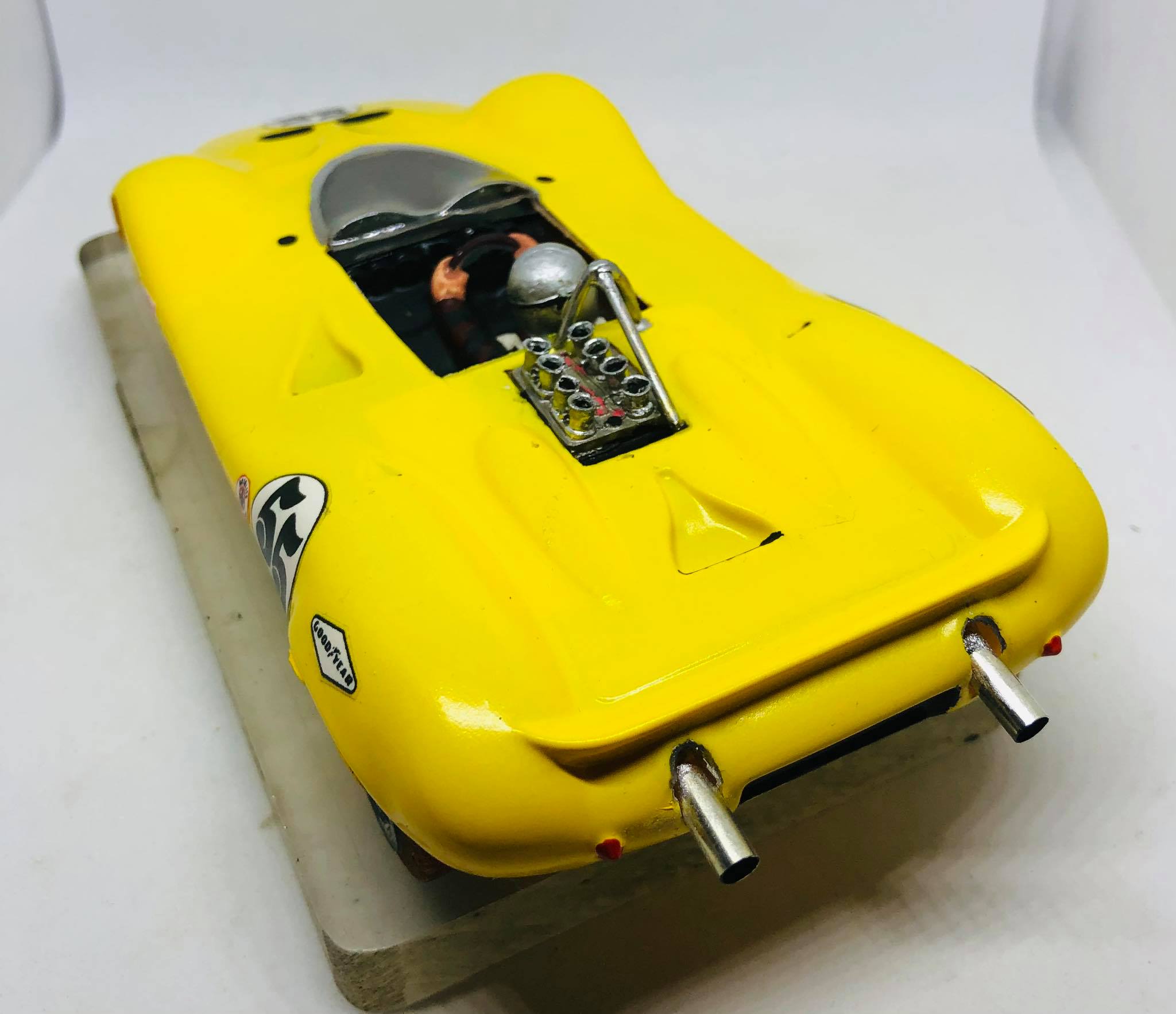

Not all quite finished bu hey they are close. Mainly need wheel inserts and body cuts tidying:
King Cobra.
[attachment=11724]
[attachment=11725]
[attachment=11726]
[attachment=11727]

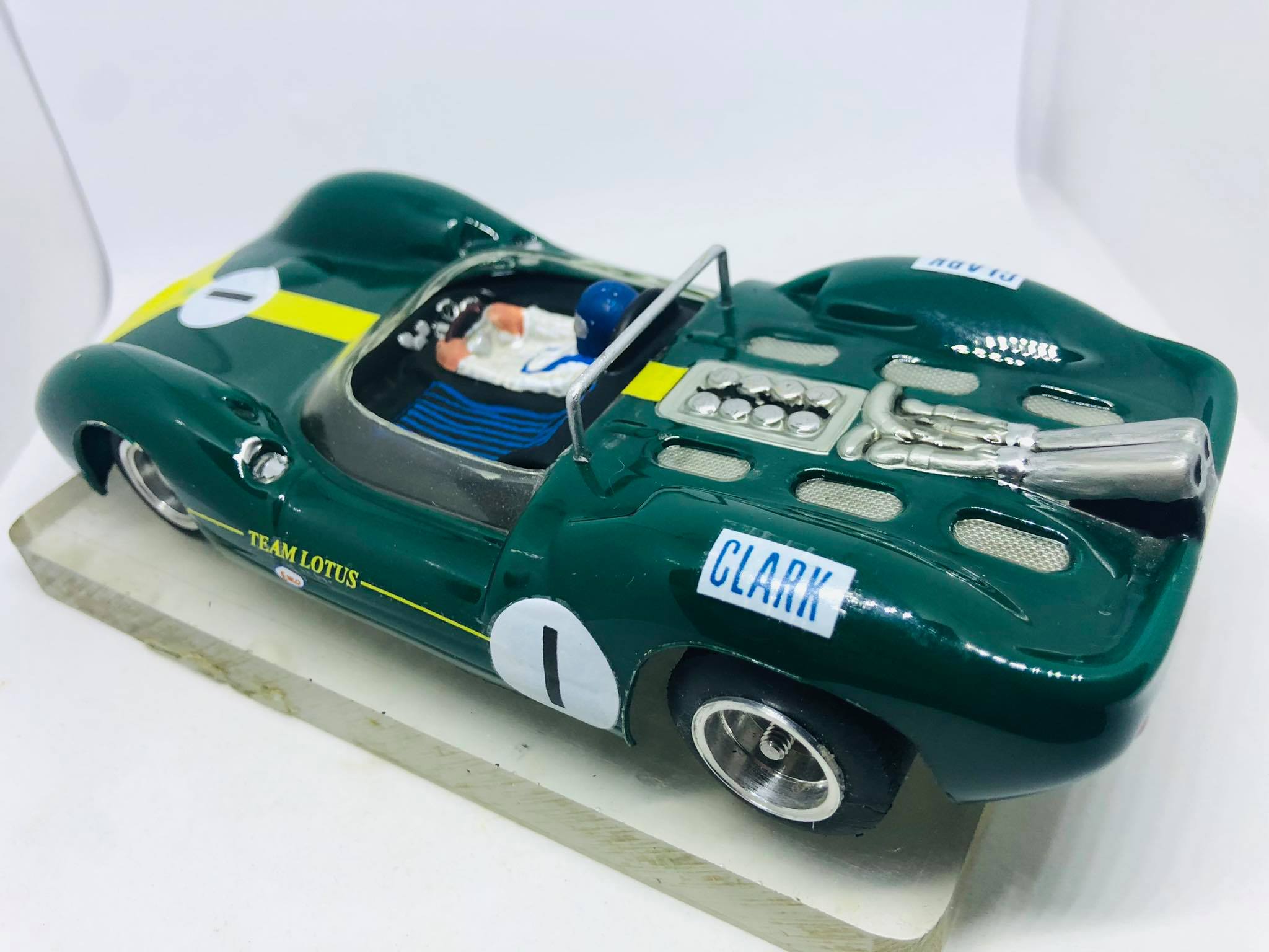

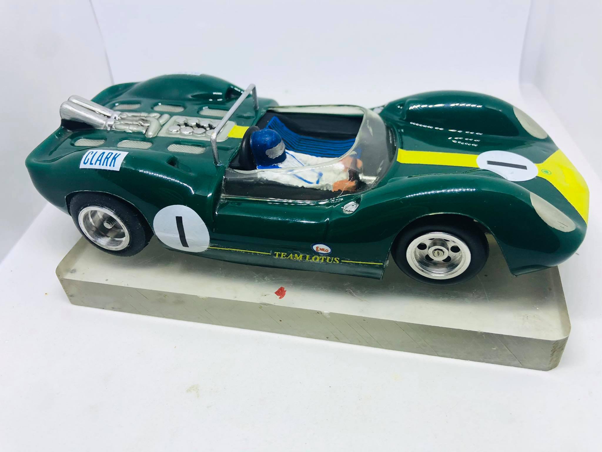

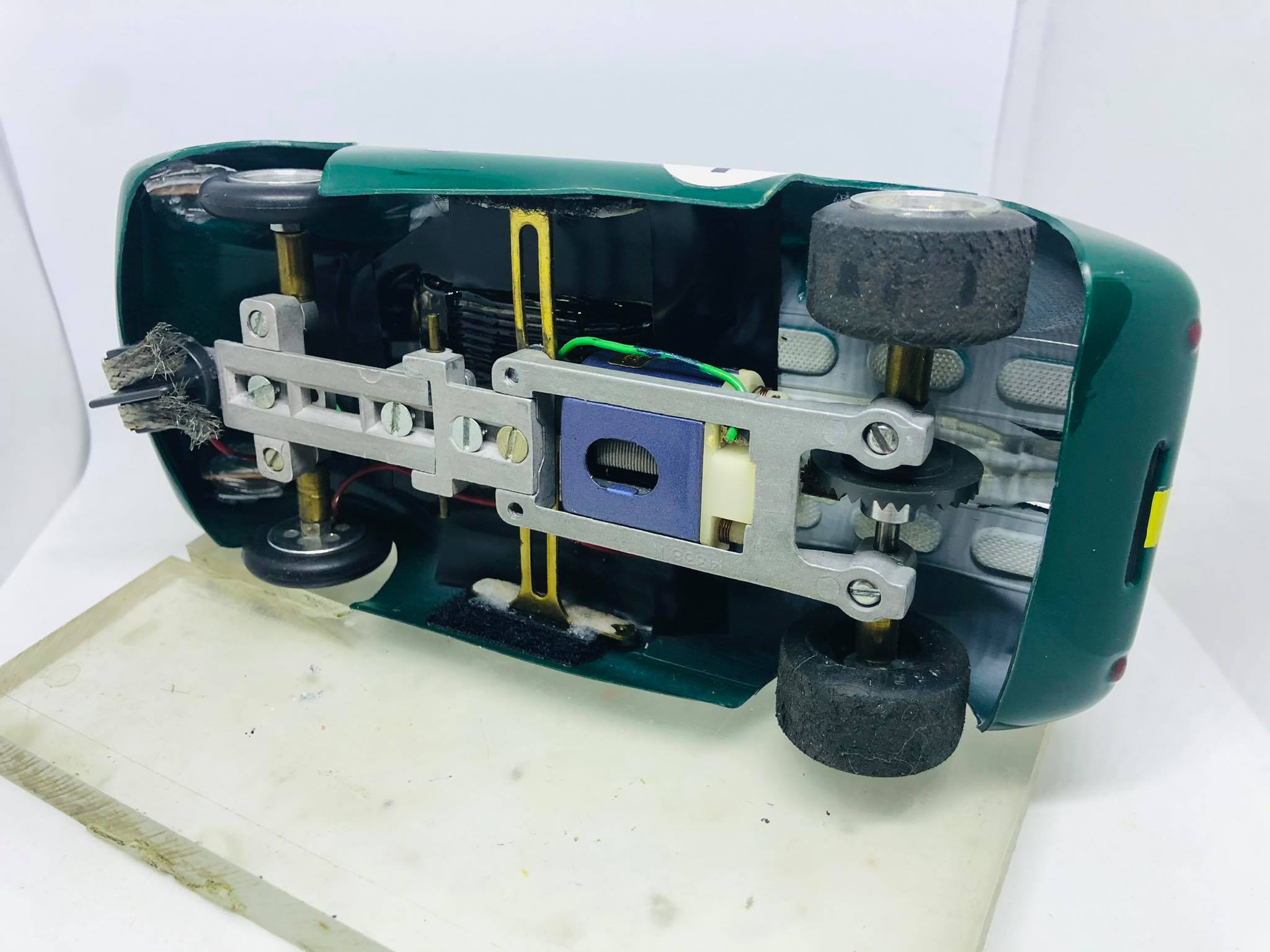

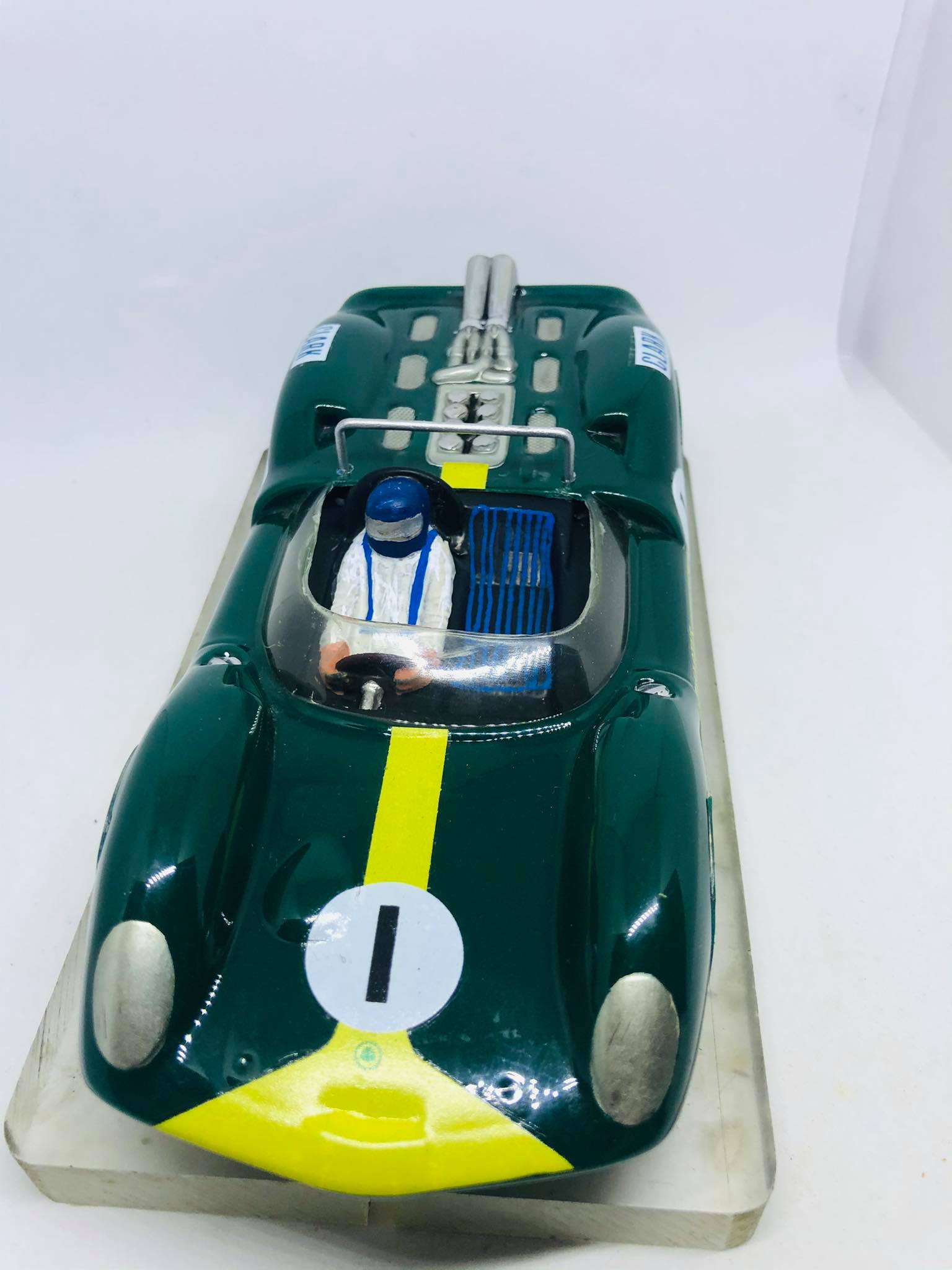

Lotus 30:
[attachment=11728]
[attachment=11729]
[attachment=11730]
[attachment=11731]
Bit of a liberty taken - Jim never used a full face helmet.... Cool   - need to find a better driver set,,,

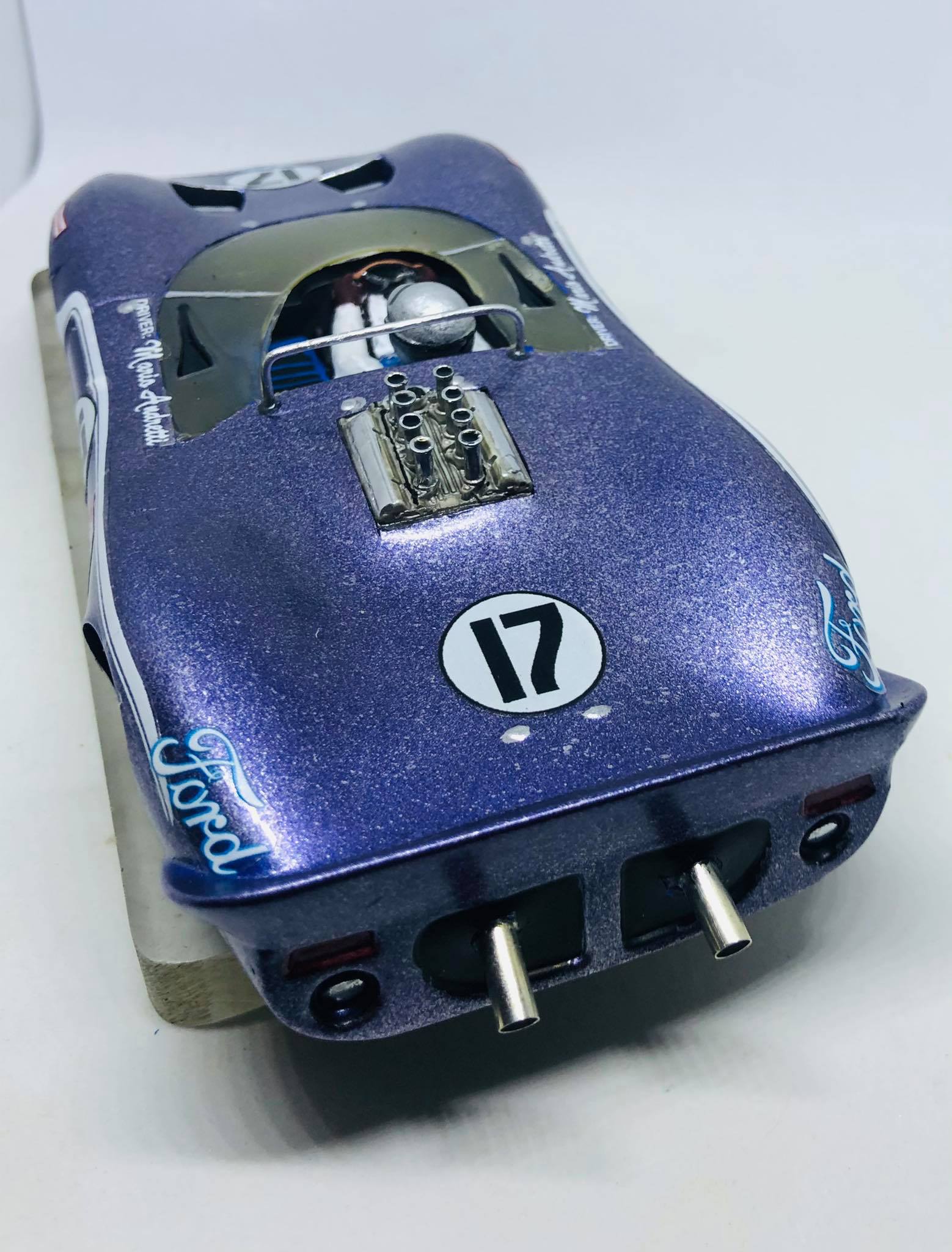

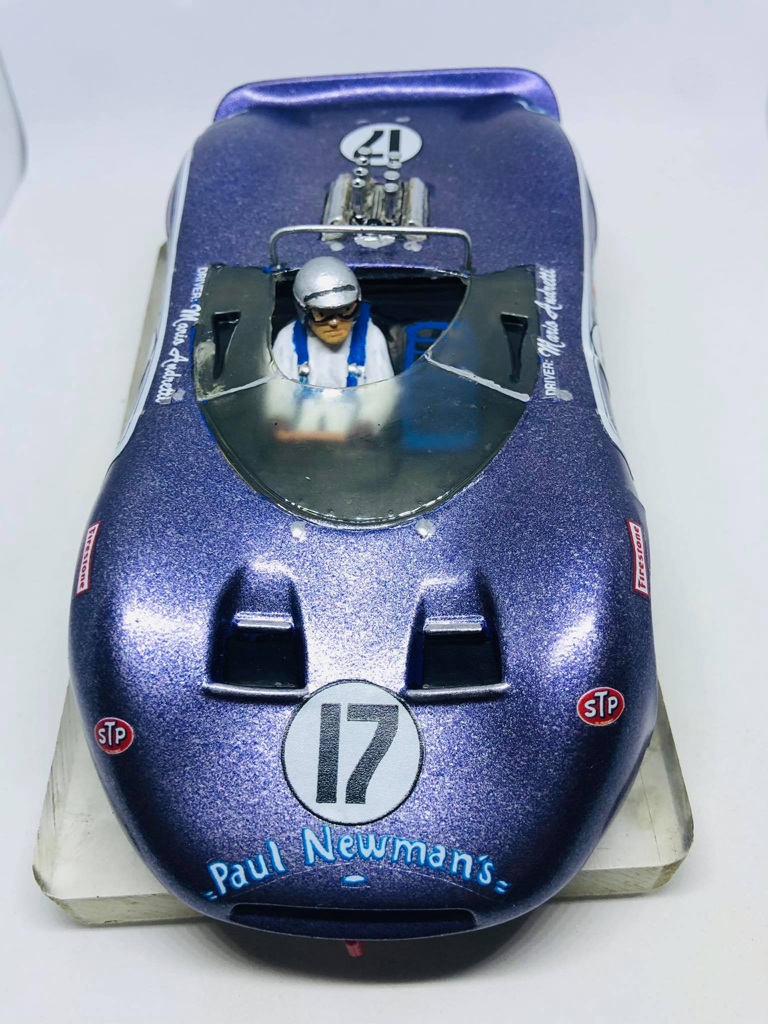

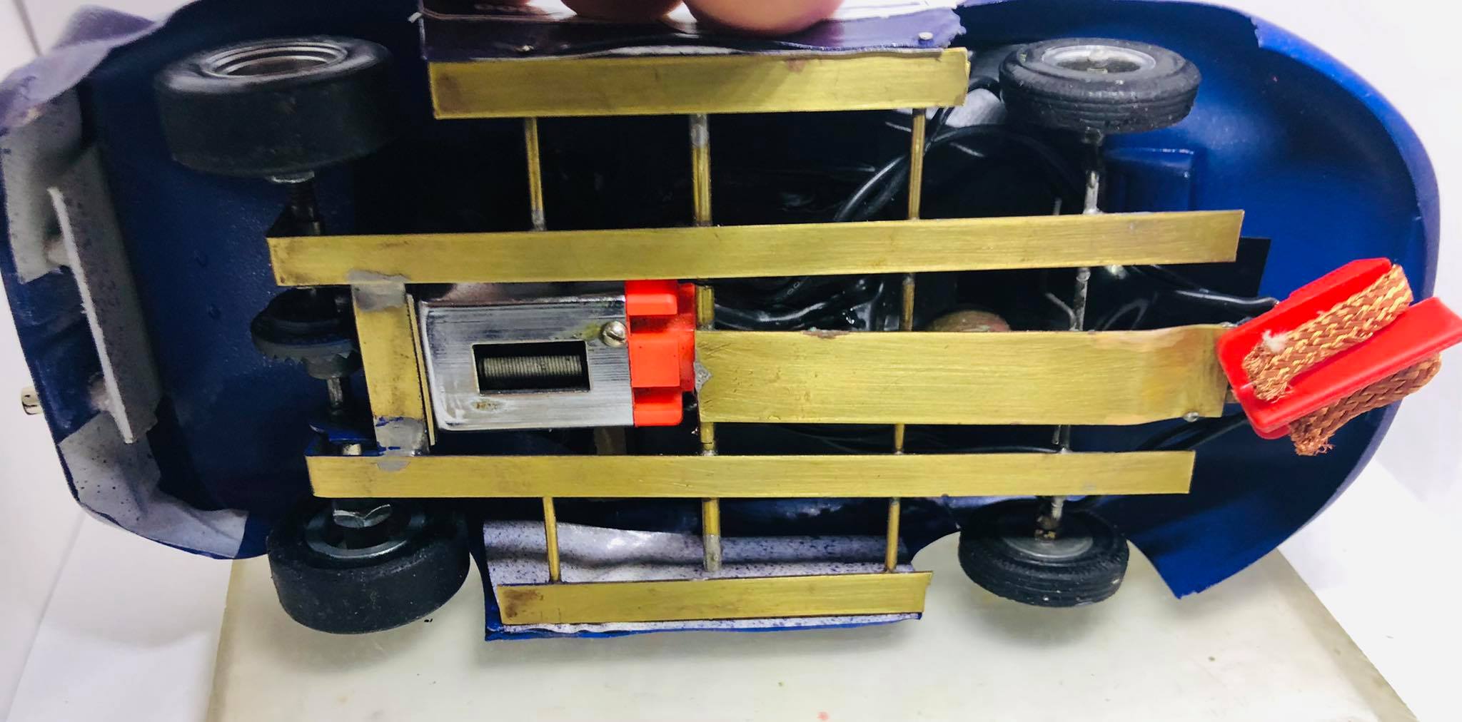

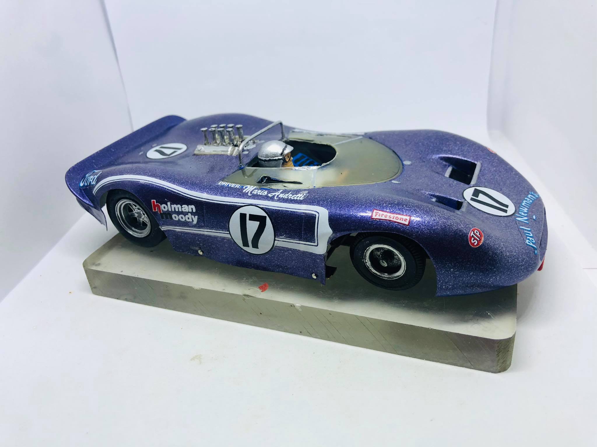

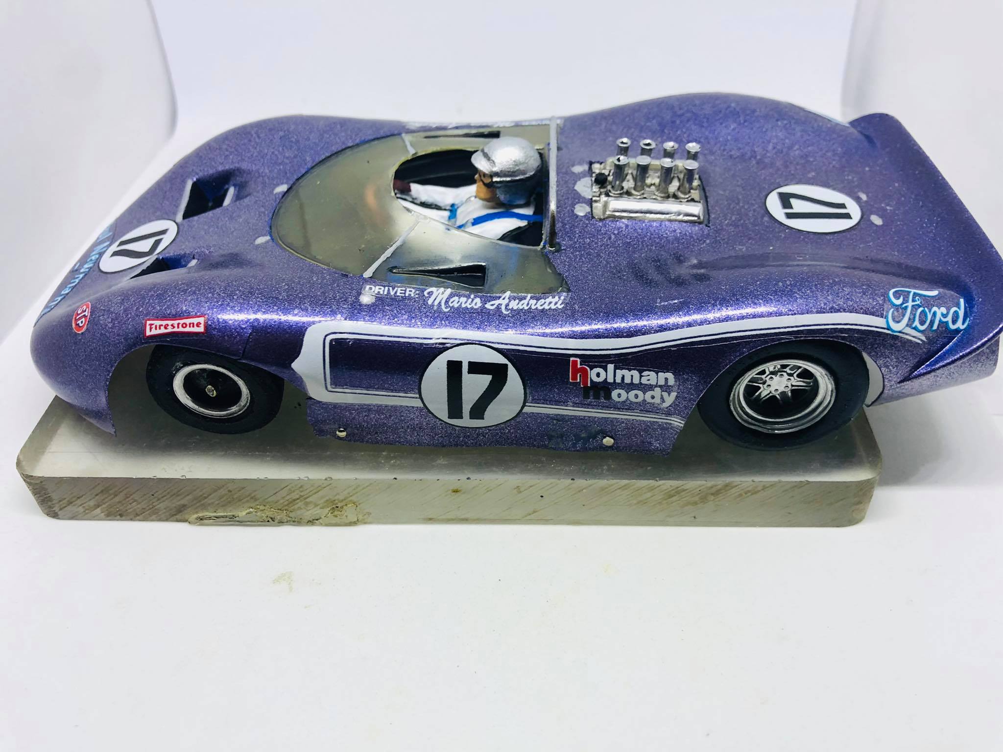

Honker Ford:
[attachment=11732]
[attachment=11733]
[attachment=11734]
[attachment=11735]
[attachment=11736]

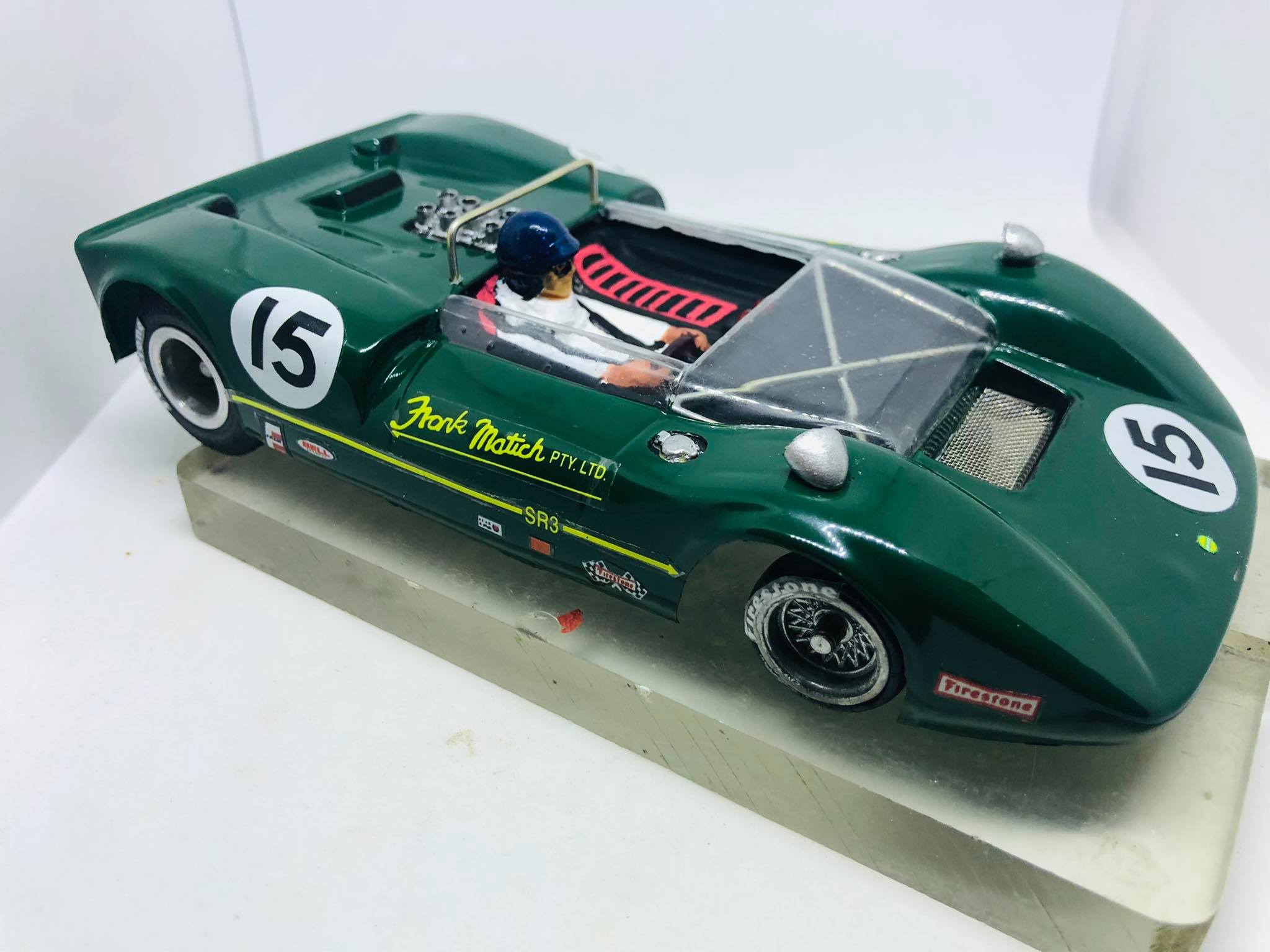

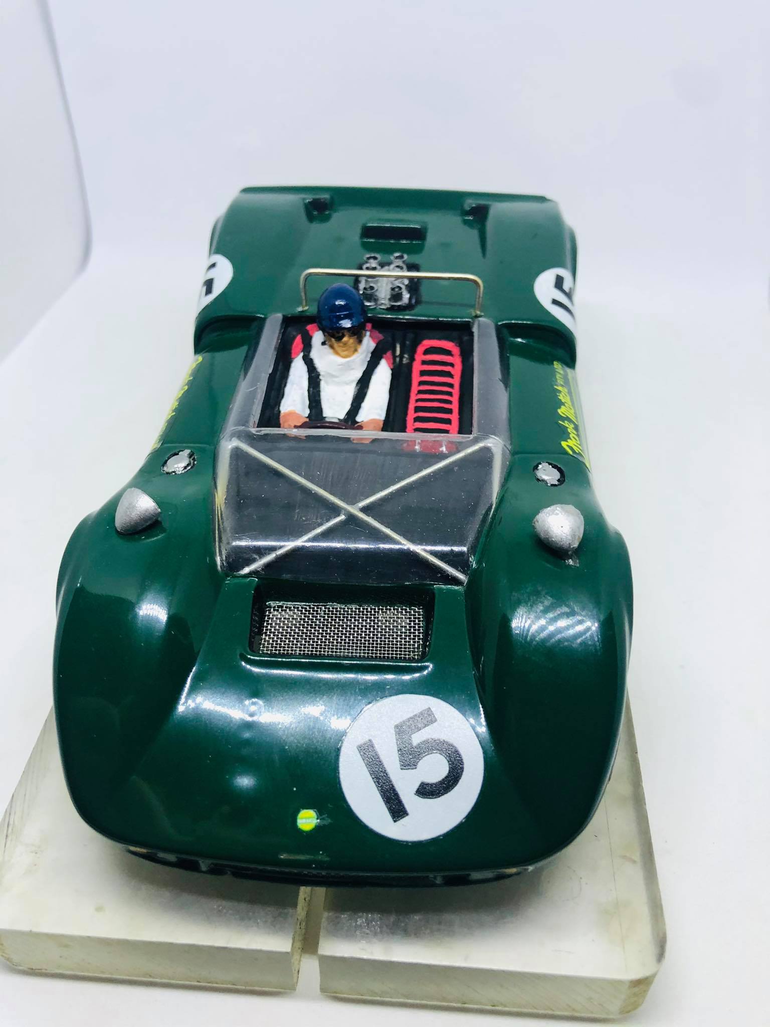

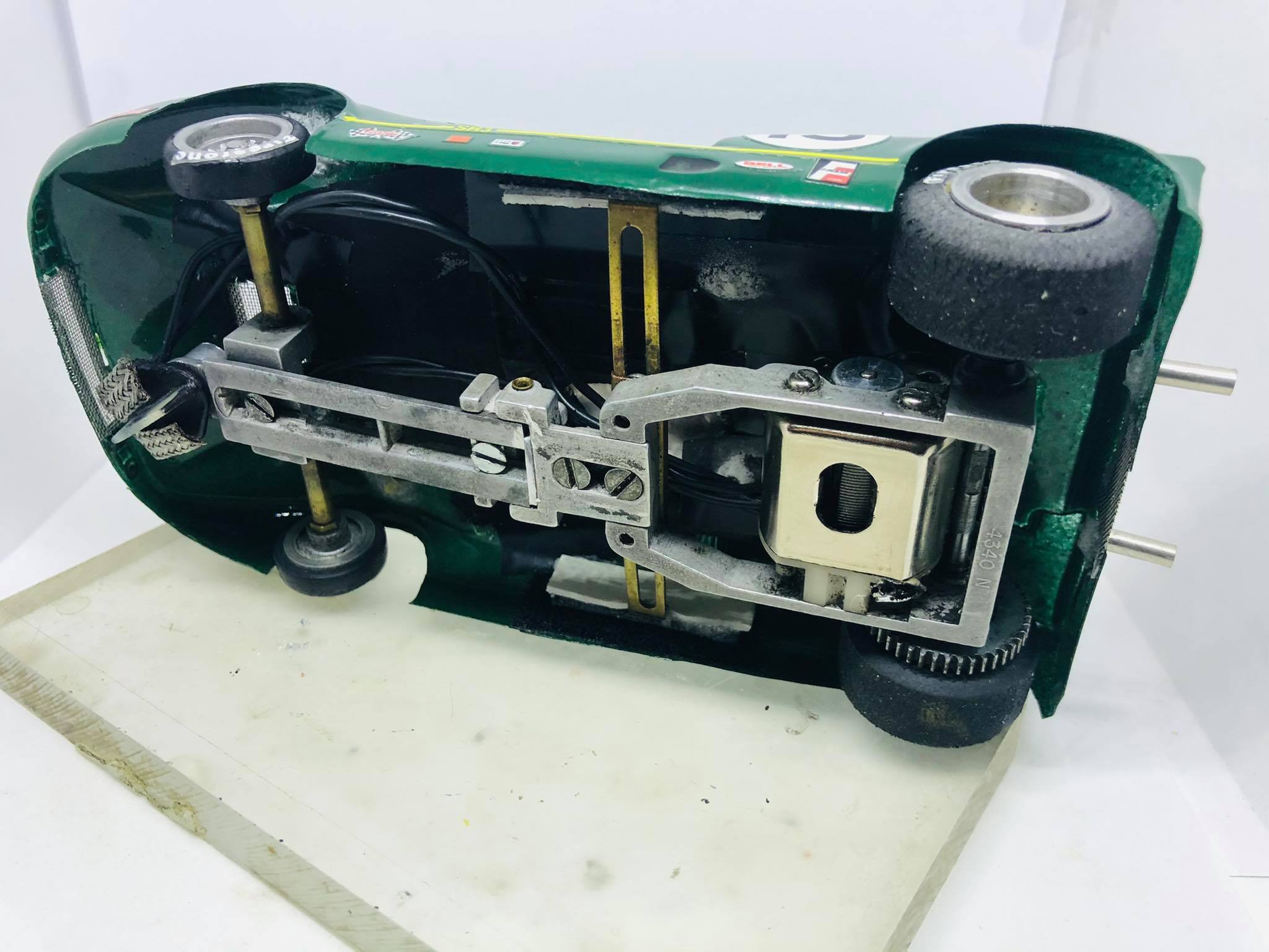

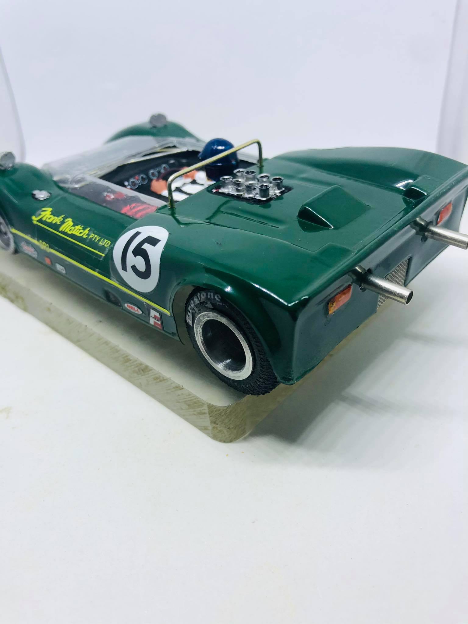

And my personal Favourite - Matich SR 3
[attachment=11738]
[attachment=11739]
[attachment=11740]
[attachment=11737]
RE: Adventures with Lexan - KensRedZed - 22nd-Jan-21
Very cool collection of cars, Anthony.
Are the chassis on the Matich, Lotus 30, and King Cobra made of white metal, or aluminum?
Thanks,
Ken
RE: Adventures with Lexan - Anthony B - 23rd-Jan-21
Ken - Dynamic chassis are a metal - not aluminium - probably white metal?
