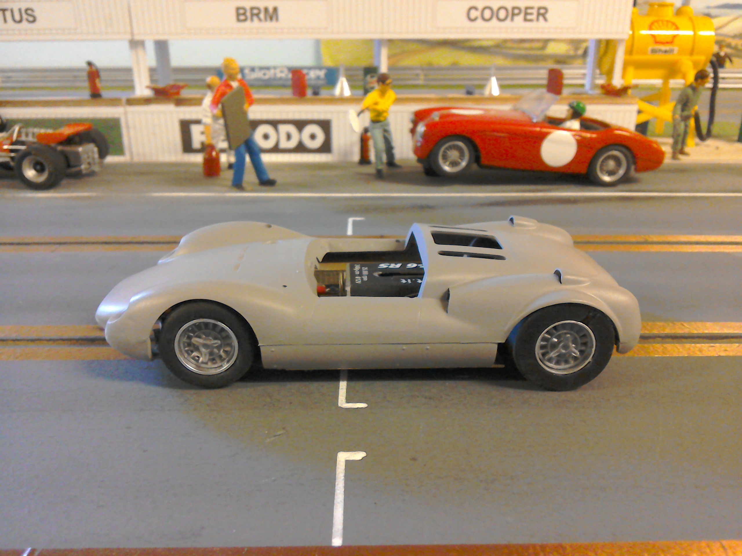

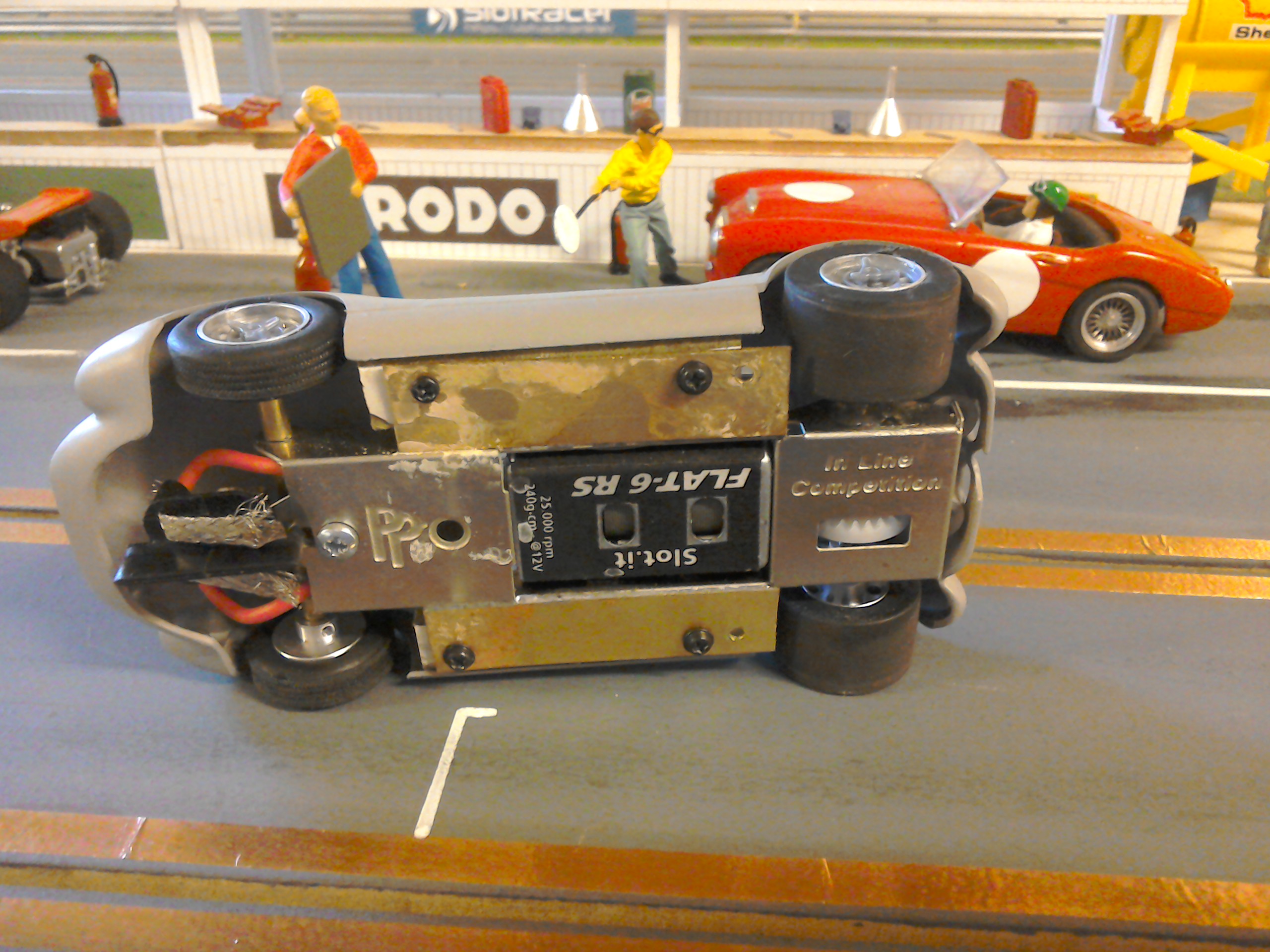

RE: Cooper Ford - Fluff - 31st-May-20
Have got some better front wheels and inserts (thanks Tel) and I think it improves the look .Soldered some brass sides to the chassis and fitted the primed body .Next some colour and finishing off

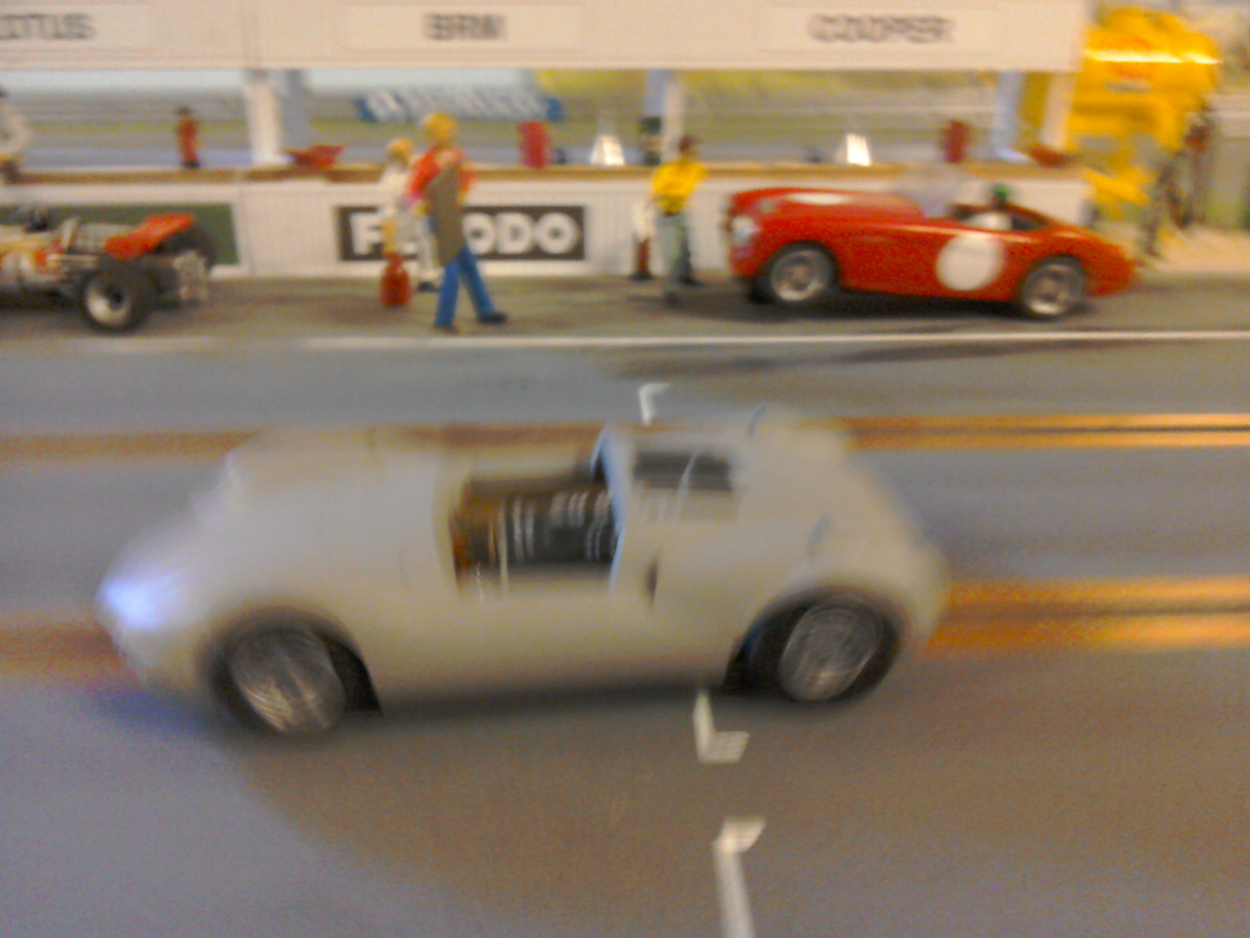

Sorry Gordon ,try this one.
