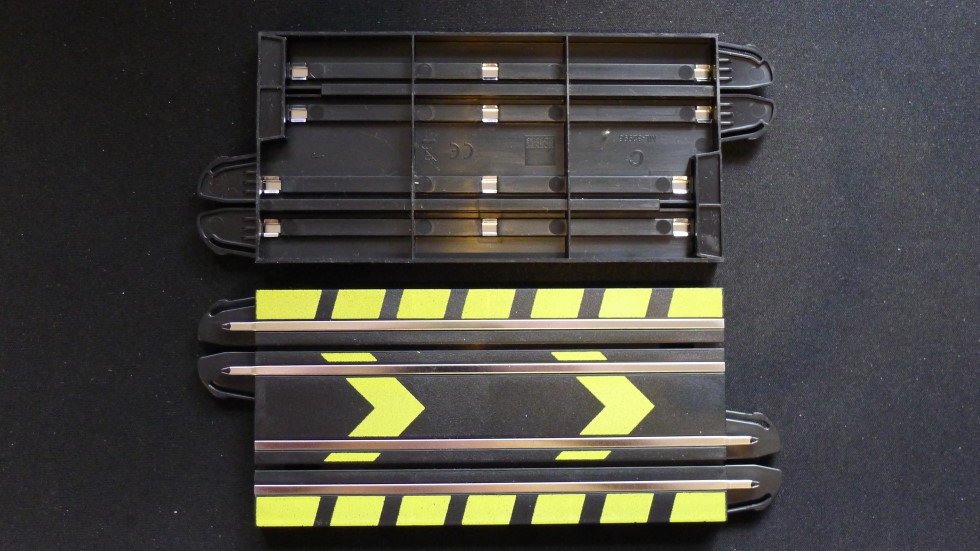

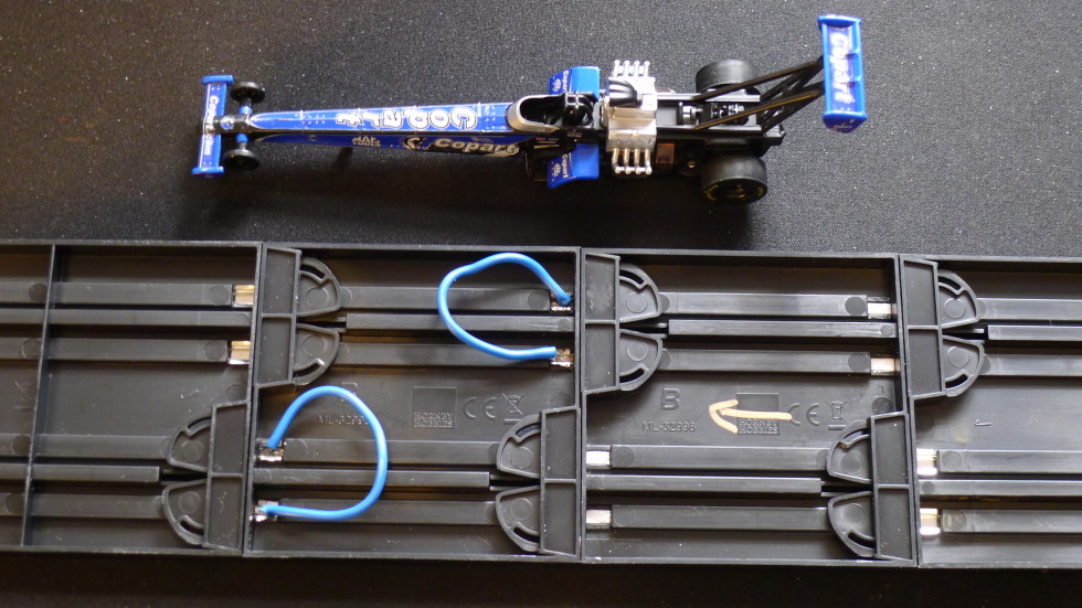

As you can see from under the track sections, the are tabs on the rails that keep them secure in the plastic. Bend those tabs straight up and the rails drop out. They are then easy to solder power cables to and then replaced into the plastic - no risk of melting anything. If you look closely on the underside, you see where the plastic connecting lugs clip into the next piece of track - it is important not to solder to the rails and bring the wires through at that end... the track won't go together (don't ask me how I know that). You can see how I've soldered wires to short out the shut down section here...
[attachment=6354] [attachment=6355]

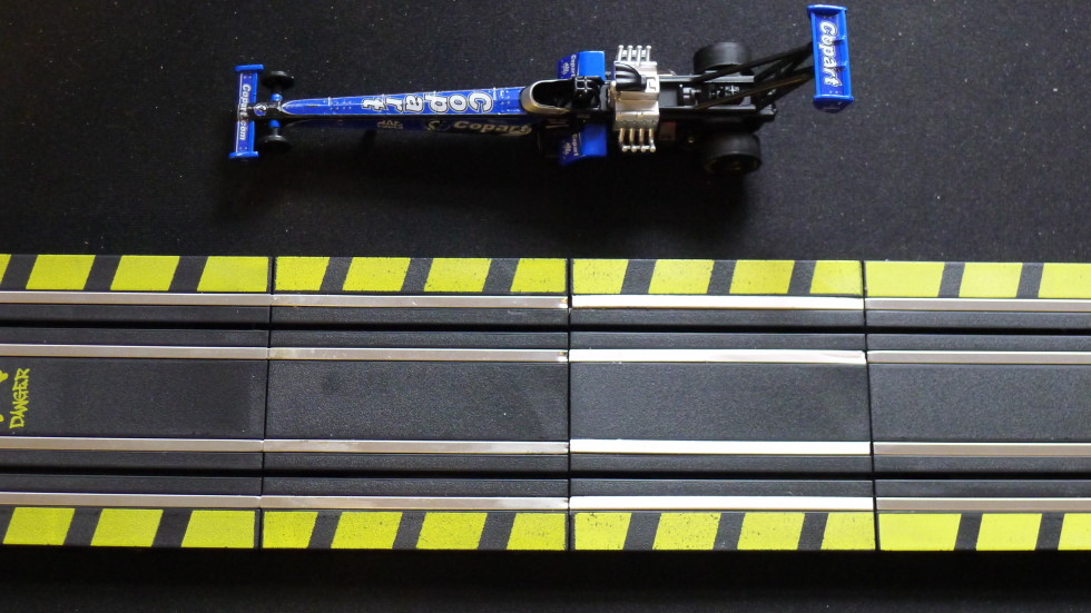

What we have is - from right to left - a final powered section with metal lugs removed at the end; a short dead section with rails removed and strips of plastic sheet glued in their place; a short section with rails shorted out underneath and metal lugs removed towards the dead section; and finally a normal, unmodified straight. Dragster shows direction of travel. The plastic sheet is important - removing the rails leaves quite deep recesses that cars' braids will drop into and catch the edge of rails on the next piece of track. I mashed up a few braids before I made the modification. The only issue now is the plastic being a little too high and cars that sit very low (eg the Auto World Funny Cars) lifting up and de-slotting. Some further tweaking is required.

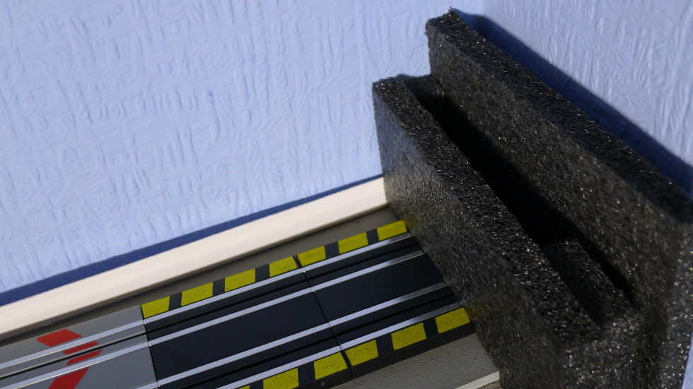

The basic padding I have at the end of the strip (a proper catch box to follow) has foam sheet glued to the wall, a gap and then another sheet which deforms back into the gap. The track goes underneath the front sheet, but stops in front of the sheet on the wall. The idea is - ideally - for the car not to stop instantaneously or for it to bounce back too far - especially with close lane spacing where one car can bounce back into the other. So some 'give', but not too much springiness. The foam I've used is not bad.
[attachment=6357]

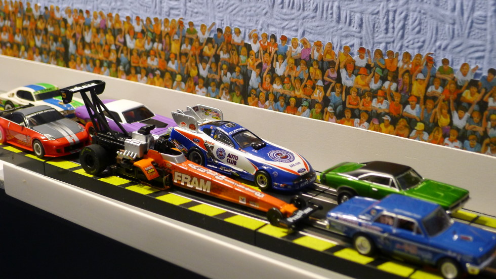

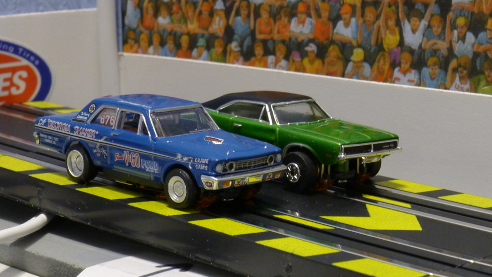

I braided up and tested cars on both 12v and 13.8v to evaluate the shutdown and the foam...
- Various T-Jets (mag and non-mag) hit the end with a small bounce at 13.8v and merely ran into the foam and stopped at 12v.
- Aurora AFX Magnatractions (no traction magnet) and AW X-Tractions did pretty much the same.
- Auto World Top Fuelers (magnets, but tall tyres) 'banged & bounced' at 13.8v and hit with a slight bounce at 12v. They are 3-inches longer at the front.
- Auto World Funny Cars (magnets, but very low to the track) stopped 16-inches after the end of dead section at 13.8v and 14-inches at 12v.
- A rapid Tomy SRT (with strong magnets and tall tyres) didn't stop as quickly, hitting at 13.8v and tapping at 12v, rather like the T-Jets.
- Stock Micro Scalextric (1995 version) were stopped quickly by their magnets - 12-inches at 13.8v and about the same at 12v. Even at 15v, they were stopping well before the end.
I tried to use drag set-ups where I could, certainly in terms of tyre heights. The Funny Cars need some work to get them back to their prime - they are pretty tuckered-out. However, that seems a nice range of cars to race - focusing on the Auto World pancake cars, plus the old Micro Scalextric cars and possibly some 6-ohm Tomy and Tyco inline cars. I do think it's the T-Jets that will look the part on the strip...
[attachment=6358]

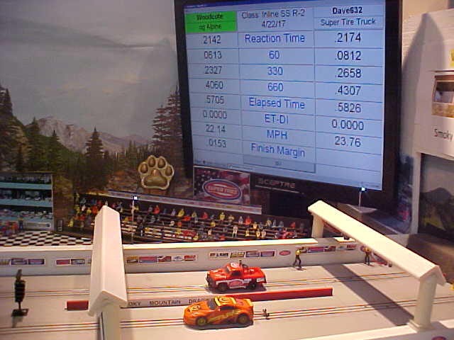

Top of the range is the Trackmate DP3000HO timing system (there is also a 1/24 scale version). This has six sensors per lane - Prestage, Stage, 60-foot, 1/8 mile, Speed Trap and Finish - plus a six-inch high tree. The software requires a Windows PC running XP or higher. Everything you need comes in the package, which costs US$795. Slightly cheaper is the DP2000 system, which has an older module that only handles four sensors per lane - Pre-stage, Stage, Speed Trap and Finish. Otherwise the features are the same. It costs US$549. Both systems will print proper time slips with an additional time slip printer (US$369).

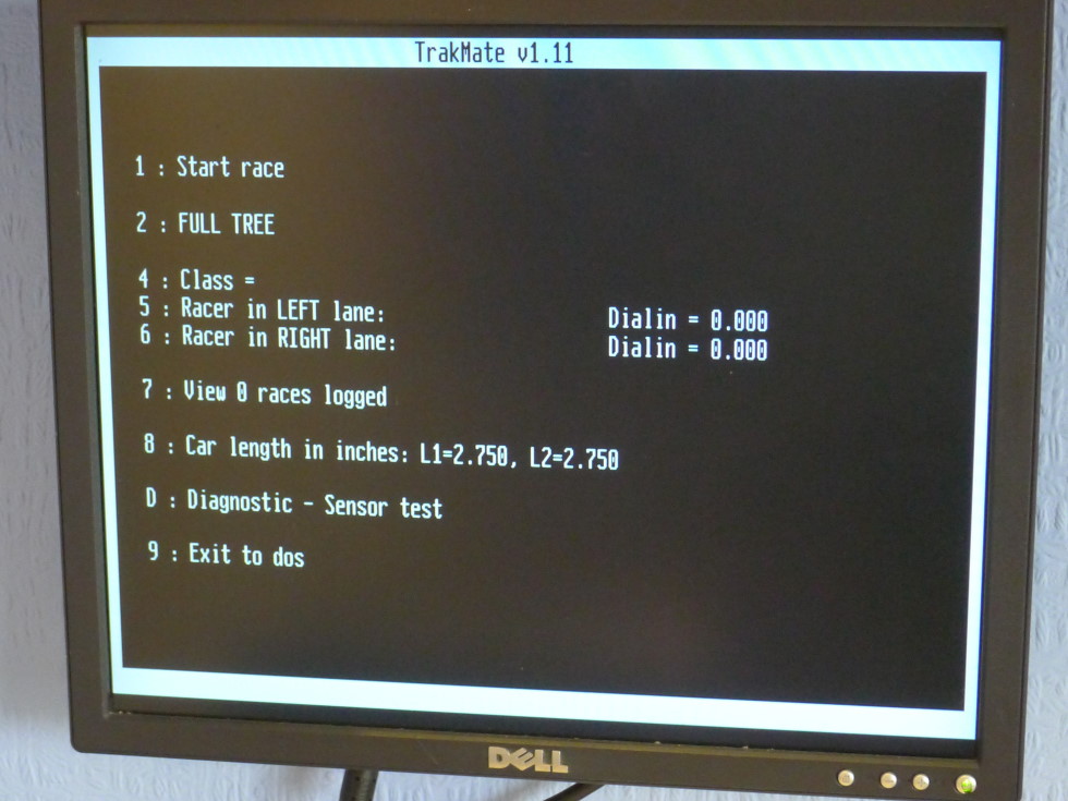

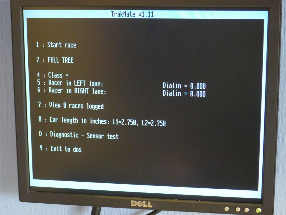

I have the oldest version of the Trackmate drag race system, which was then sold as 'Drag Basic' until about 3-4 years ago. The software is DOS-based and no longer available. There are only two sensors per lane - Start and Finish - with speed estimated at the finish line if you enter the car length. The tree is on the screen, with no way to use an external tree. There is the option of Full or Pro tree, plus full bracket racing features - dial-in and split tree. Results for the session can be logged and sorted. It is recommended that the software is run in a true DOS environment (available in Windows up to 98SE). Sensors are wired to a 25-pin D-sub connector and plugged into the computer's parallel (printer) port.

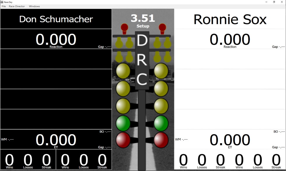

The new kid on the block is Drag Race Coordinator. This has been gradually put together over the past 2-3 years as a stand-alone program. As you'd expect from a Race Coordinator app, it looks great and has some cool features. The software is the usual donation-ware and you'll need to set up an Arduino to communicate between the sensors. At the moment, there is very little documentation (it's all in Dave's head) for either software or hardware, so it a challenging journey to get set-up. However, the aim is to offer a DIY alternative to the features in the top-end Trackmate systems. With times shown only to thousandths of a second (rather than ten-thousandths) and the speed averaged over the entire strip, we're not there yet...
I do intend exploring Drag Race Coordinator for the future. However, with racing to be organised, I am going to stick with Drag Basic. It is a very solid piece of timing kit. Daniel knows his drag racing - he also produces timing systems for full-size drag racing.

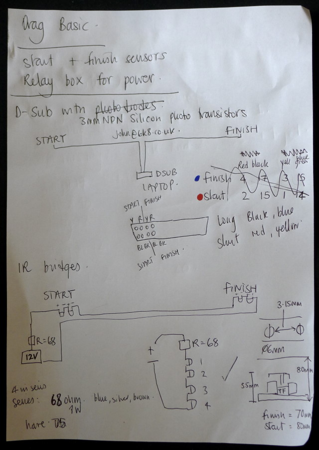

There was work I needed to do - making a sensor set-up to fit my seven-foot strip (yes, I've stretched it to 84-inches) and two IR LED gantries for the start and finish lines. Here's my working-out sheet...
[attachment=6396]

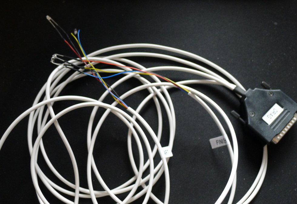

I needed to test combinations of emitters and receivers with my old 1996 Toshiba Satellite 110CS and Drag Basic. A neat pairing of emitters and photodiodes I was planning on using didn't work. Thankfully I had a choice of two options of photo transistors and I chose the one that worked at the furthest distance. It was then a case of soldering everything up. It's been a while since I soldered up a D-sub...

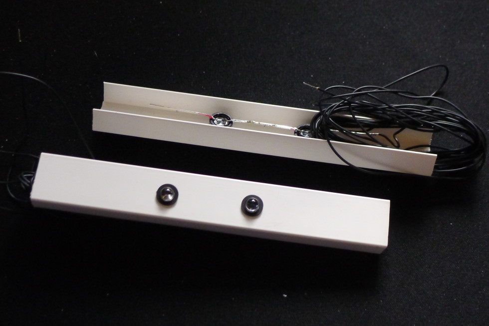

I then measured up and fashioned two gantries from PVC ducting and installed the 5mm IR emitters so they will sit directly over the receivers...
[attachment=6398]
Everything seems to work and I'm not far off installing everything on the strip - then testing, tidying-up and making it a bit pretty. Might get 5 of those new plain black straights for the first part of the run. They will look better.

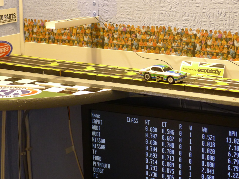

I have a messy, but fully-functioning drag strip
[attachment=6451]
Lots of cabling to tidy up, sensor bridges to complete, relay box to build and a week's worth of finishing touches. It still looks like a construction site, but it works - which was the aim of today.
It was fun to get some timing done with Drag Basic. At 12 volts, Elapsed Times (ETs) are around the 0.700s mark for dug-out-of-the-box Micro Scalextric cars on road course standard Super Tires. I threw in a decent Tomy SRT on high-ish tyres, which did a 0.506s. A little bit too quick for the shutdown - a bang & bounce... A pretty good T-Jet went 0.875s. The top Fueler looked good and managed a 0.809. None of these cars (apart from the T-Jet) have been tuned - they are simply to test the strip. Some representative times will hopefully be set next weekend at the trial run. And then on to the first official event - the sign-up thread is here:
