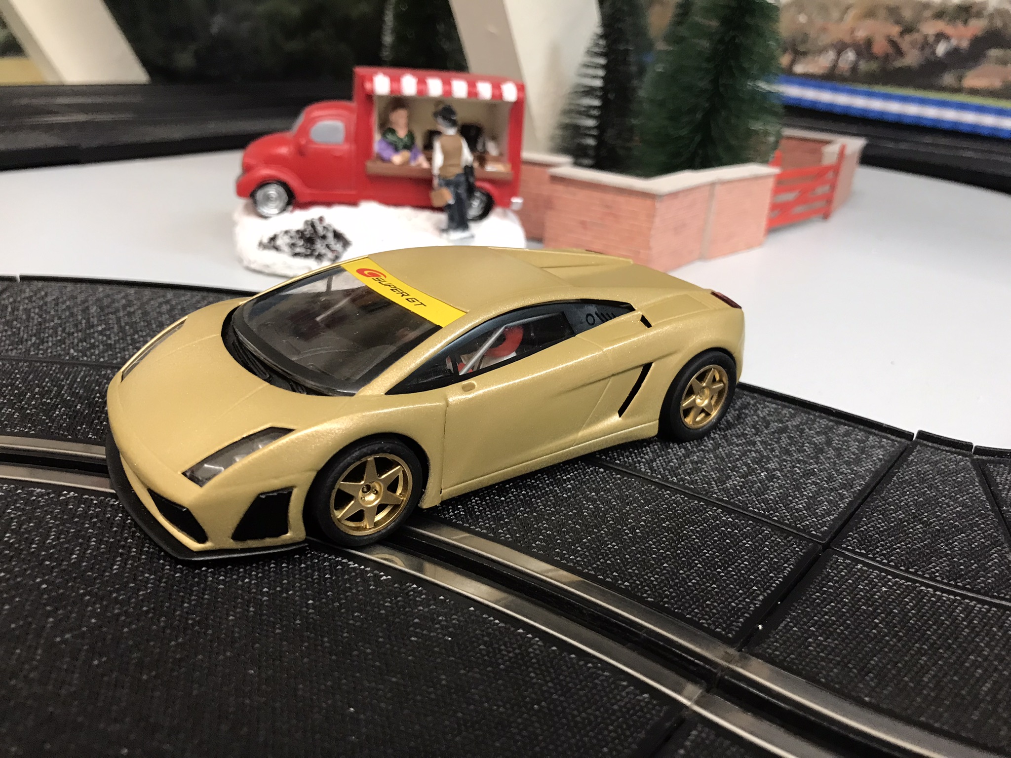

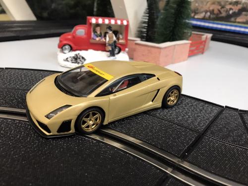

Tyre clearance was another issue , on some of the cars the clearance was ok on the setup plate but put on the track and dependant on chassis roll in the corners the car was loosing pace by the rubber body contact. ( the Gold Lamborghini was guilty of this flaw ) .

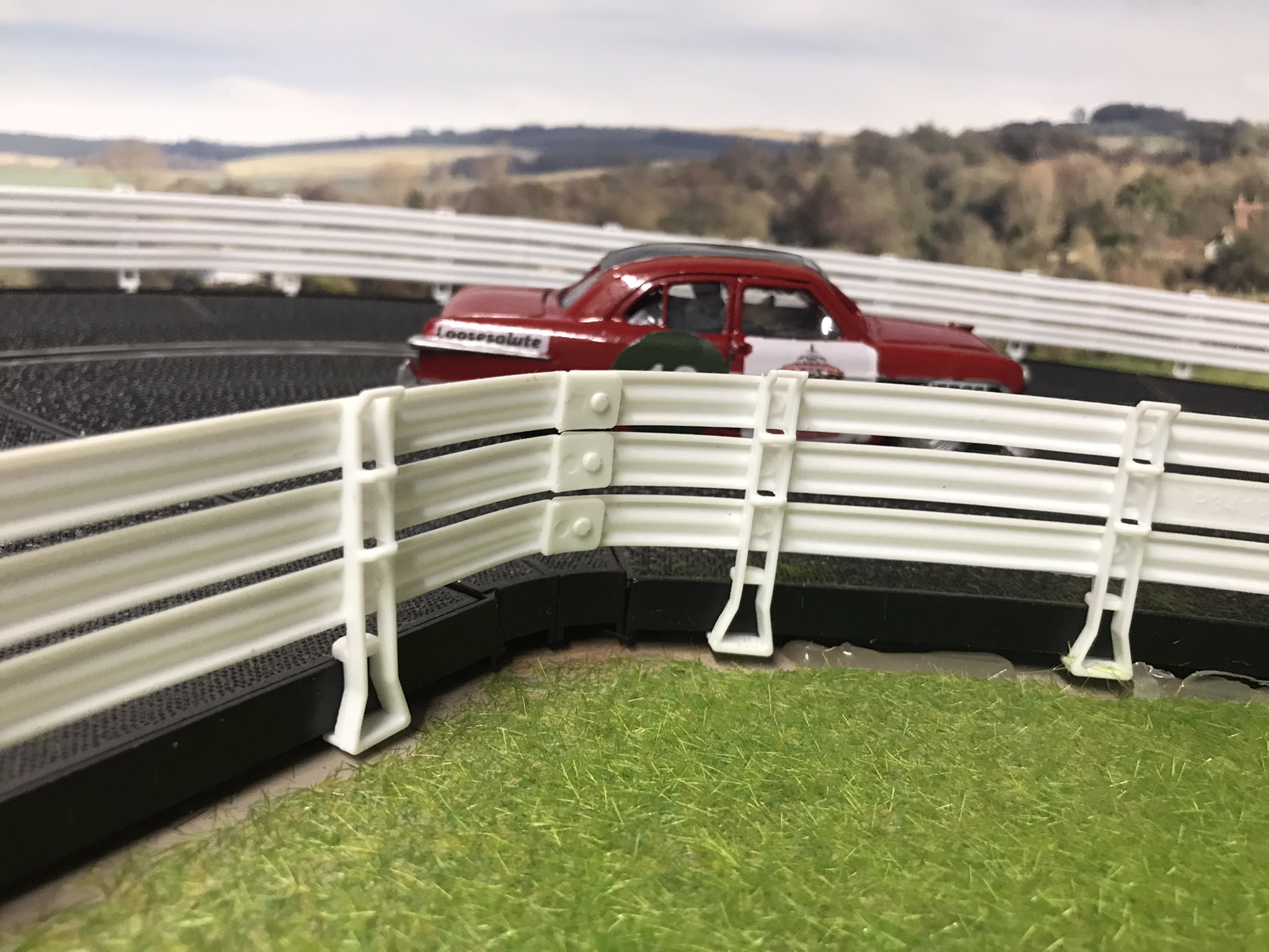

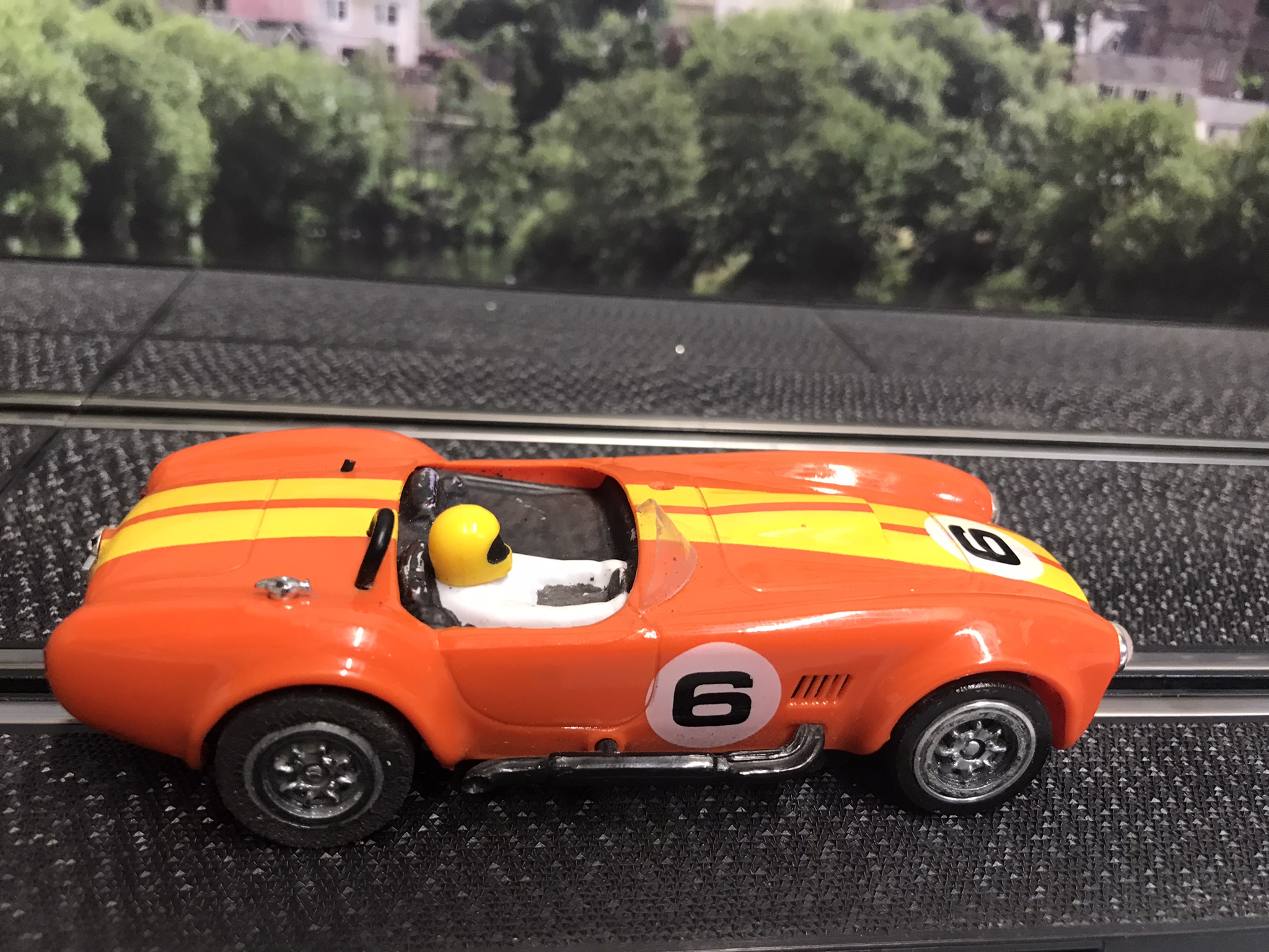

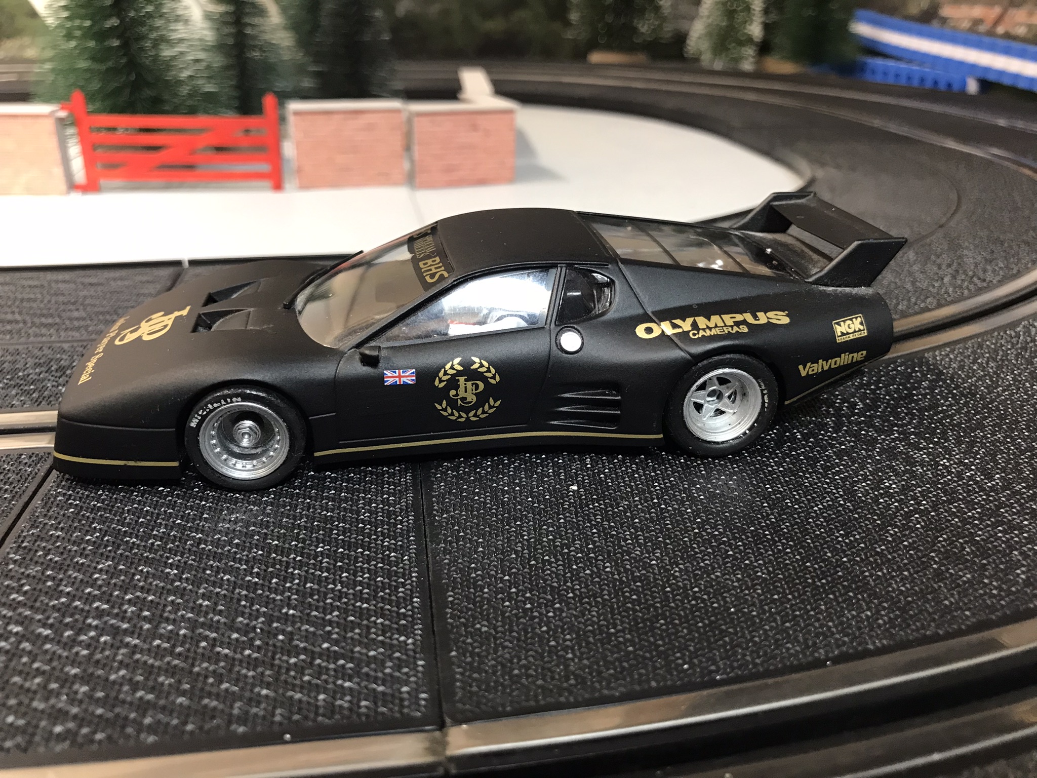

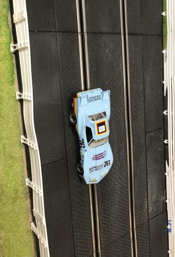

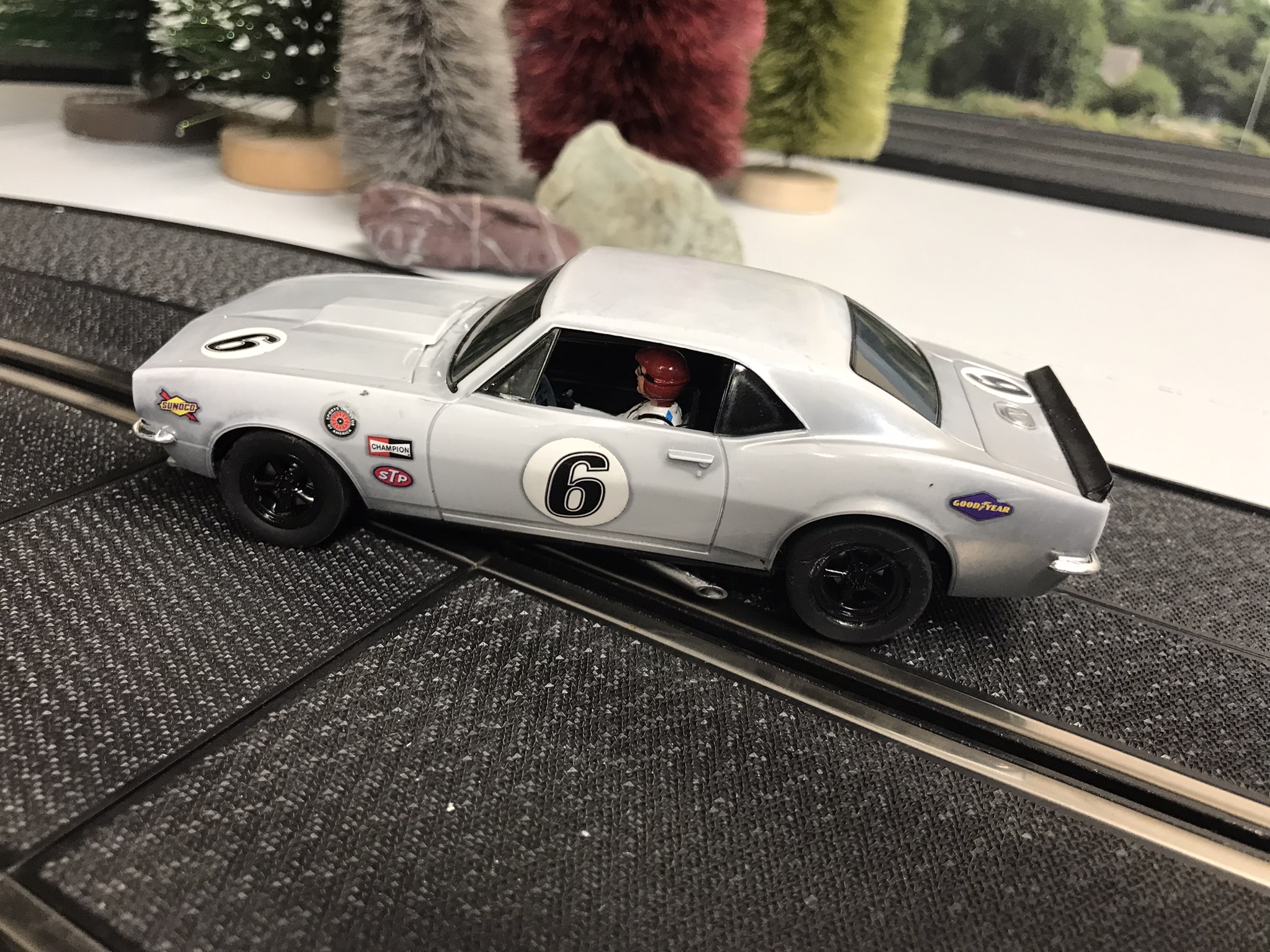

I did not have time for any video but I have took some still photos of several cars on the track .

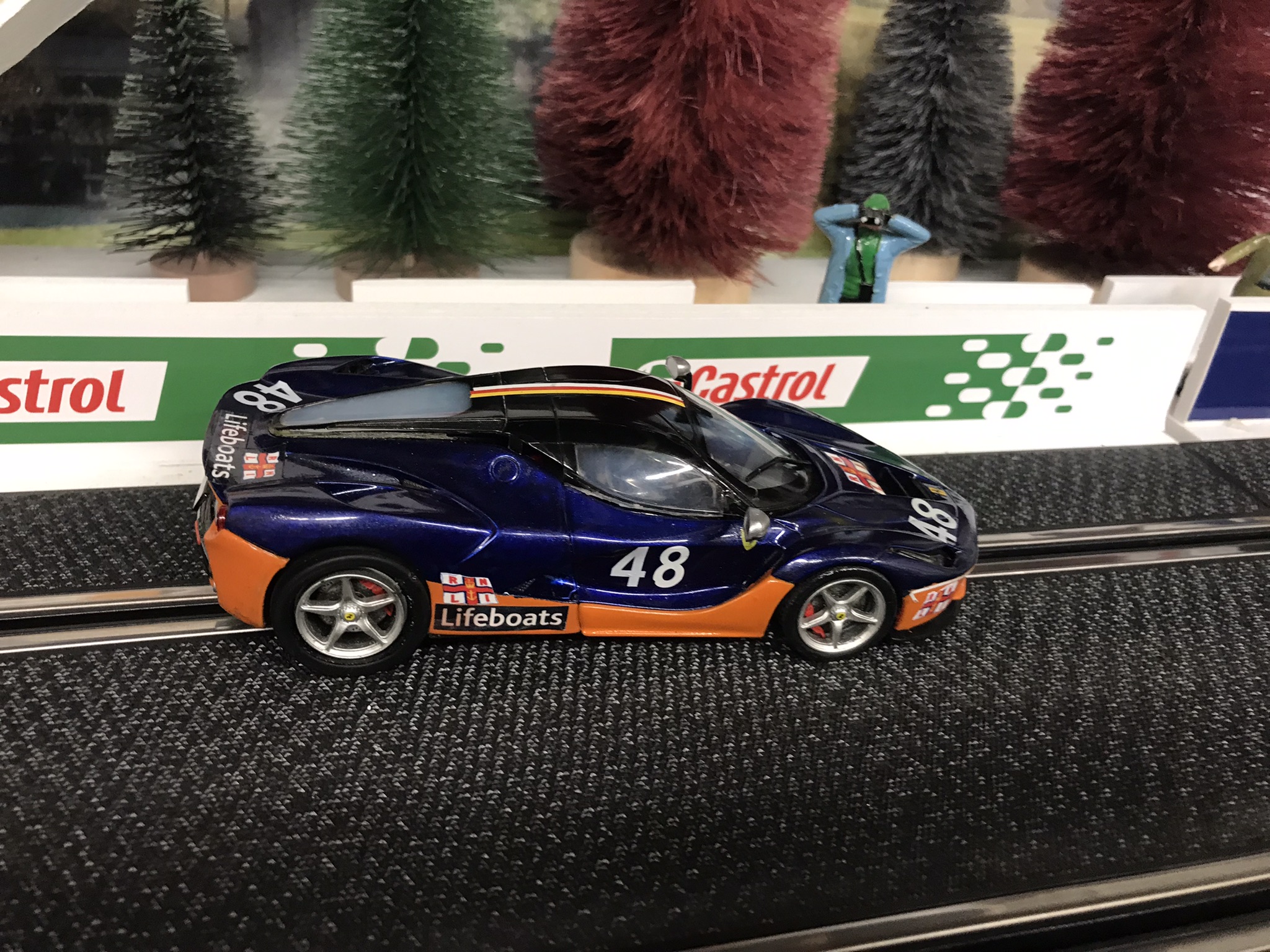

We're having some issues getting the Team RNLI Ferrari to run, is anything in this pic obviously wrong?
[attachment=23143]

I'd try two wires straight to the motor first to see if it actually runs.
RE: Triple Crown - American Road Race Slot Car Proxy Tour -
tatter06 - 1st-May-22
Well we tried our best to get it running, body off it could be coaxed into life, albeit a bit tamely, as soon as the body went on there would be no or very little movement, I guess that means some of the wiring was fouling something or another, but we couldn't figure out what. the motor did run with wires straight to the motor but of course that was body off too. Apologies to Team RNLI.
Makem - 1st-May-22
Are those two suppressors on the motor possibly shorting?
Graham, can you get it sent to me and I will get it fixed and return it to weherever next round is?
(1st-May-22, 06:55 PM)Makem Wrote: Are those two suppressors on the motor possibly shorting?
It's very possible, the behaviour was like a short somewhere, but was difficult to track it down to exactly what, it ran best when the wires from guide to chip were raised up and out the way, we unplugged/re-plugged everywhere we could and moved wires/braids about to narrow it down but I can't say we knew exactly what the problem was. There was no smoke or big sparks so I don't think it is terminal.

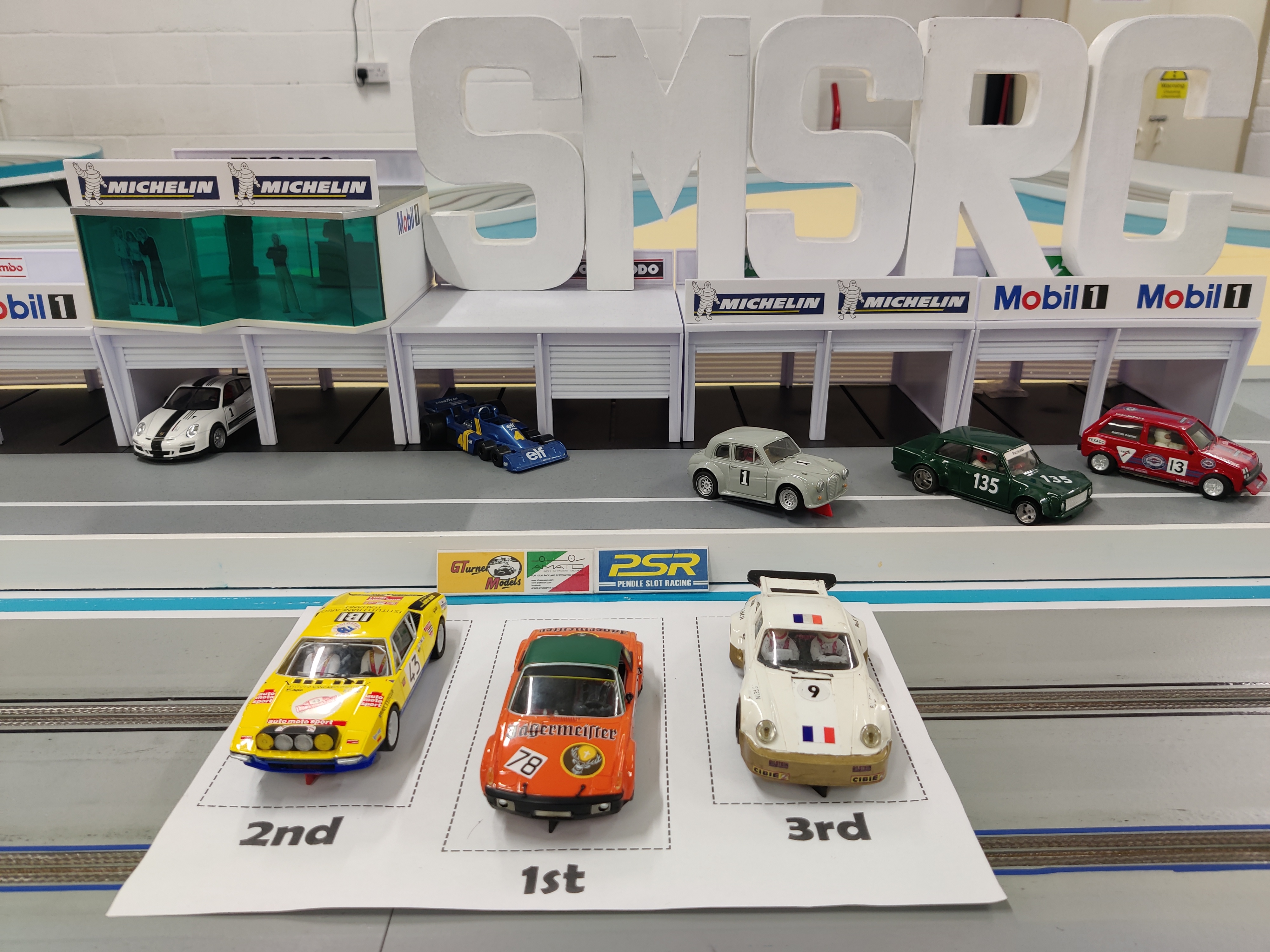

Class A
Podium
[attachment=23144]

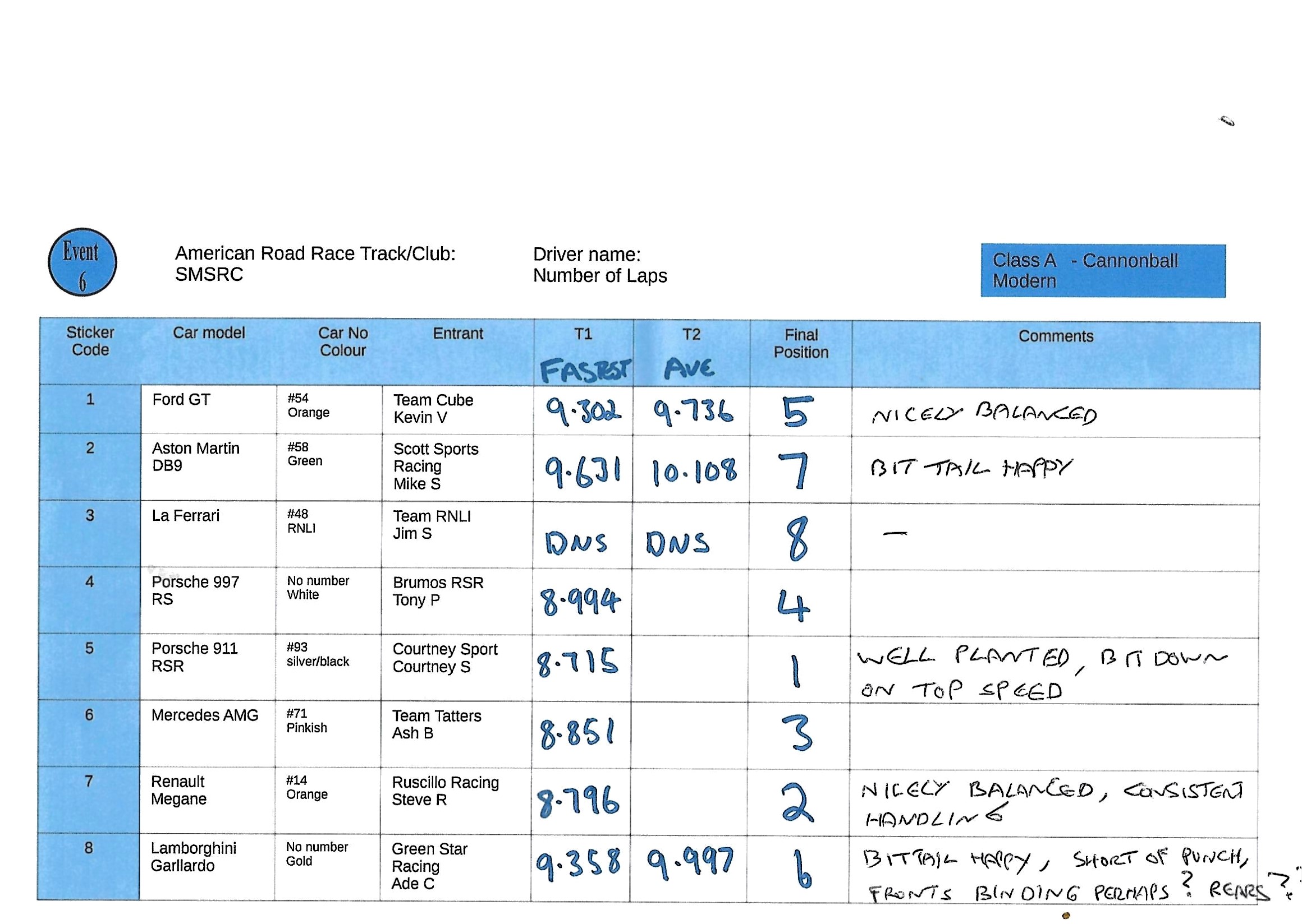

Time Sheet
[attachment=23145]
Very close class, less than a second covering everyone and 3/10ths covering the top 4 (Average times to follow, I forgot to take a picture but I do have the xls files, luckily no ties so not needed for the result)

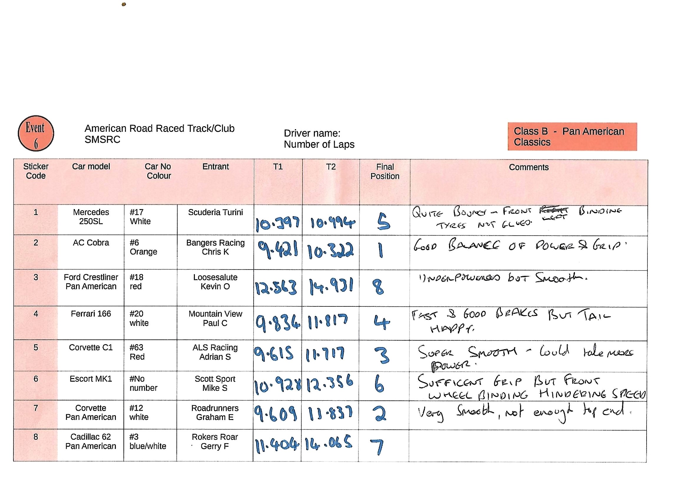

Podium
[attachment=23146]
Time Sheet
[attachment=23148]
Another close podium, the Cobra of Bangers racing just taking it, some were quicker, some had more grip but the cobra was perfectly balanced.

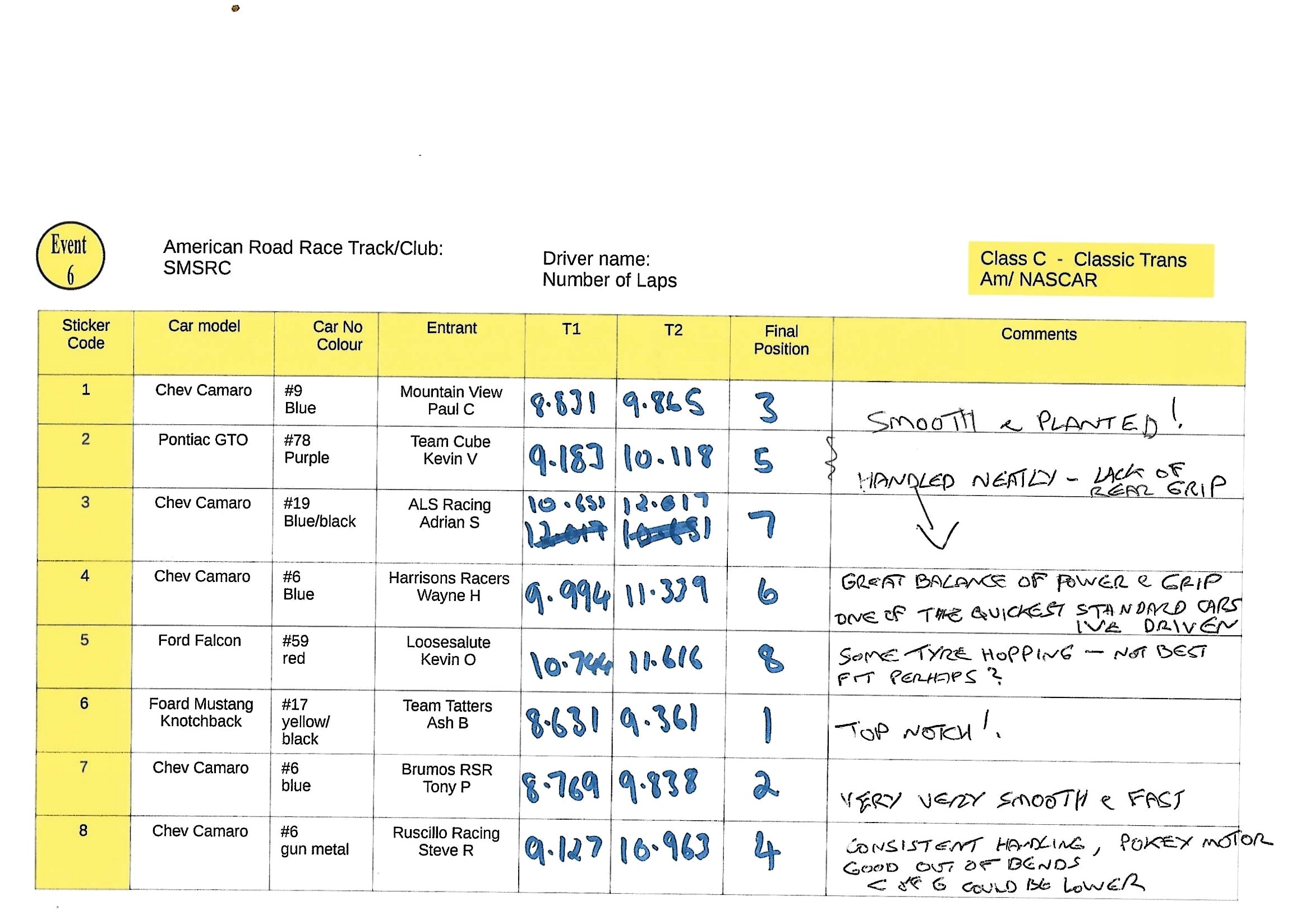

Time Sheet
[attachment=23149]
Bit awkward my car came first to claim it's first win but as one of the previous hosts mentioned; not entirely surprising as this is the track the car was tuned for (John ran the classes I was involved in), next up a trio of camaros but interestingly all with different chassis/motors/layouts and all still quite close. The pontiac GTO looked at home on the Catalunya track!

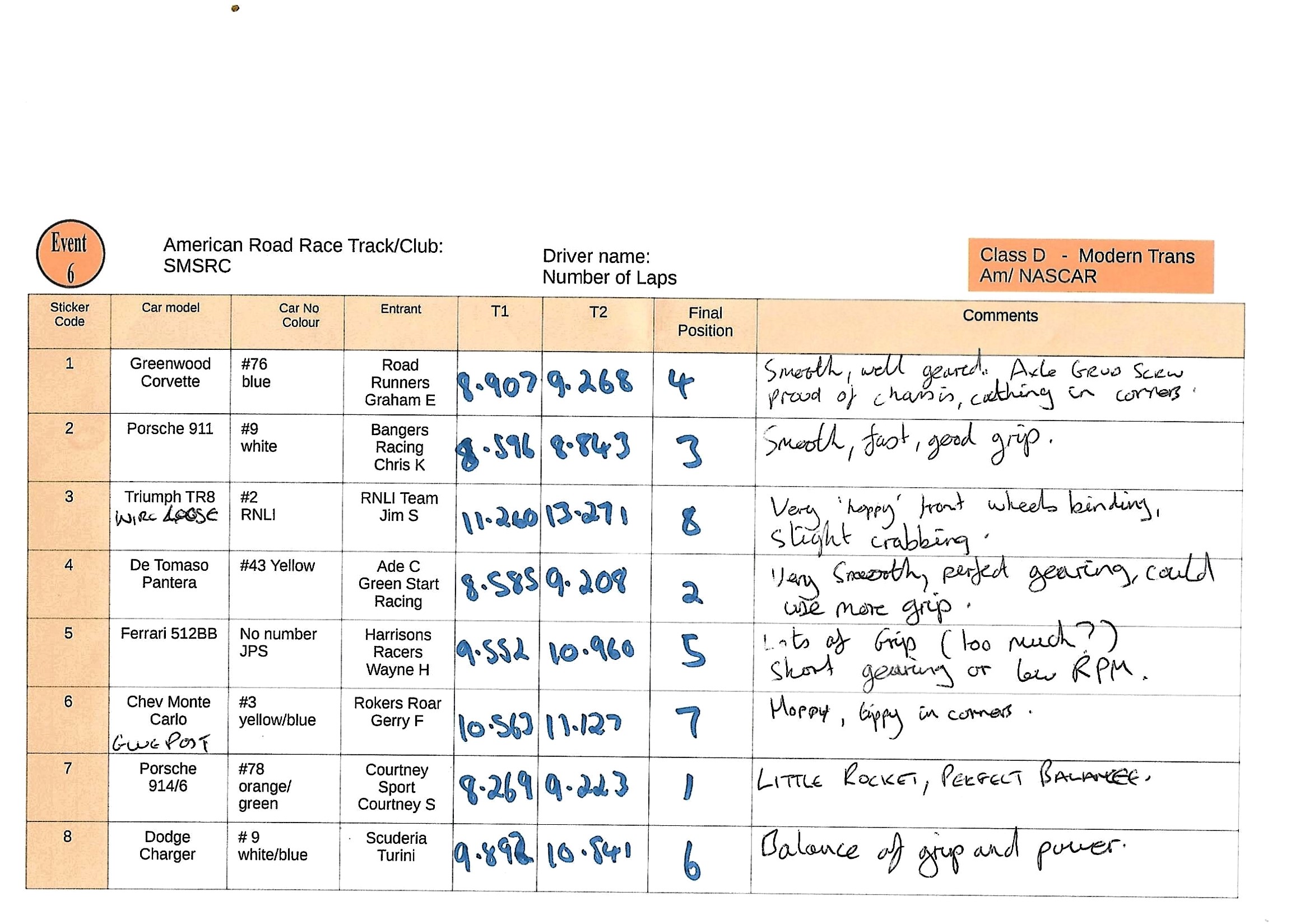

Podium
[attachment=23151]
Time Sheet
[attachment=23150]
An incredible diverse class but some real gems in there, tip of the hat to the Bangers 911, as far as I could tell an old 80s scalextric body and a generic chassis, but it ran beautifully which is no mean feat. The Road runners Corvette looked fantastic on Catalunya track.
