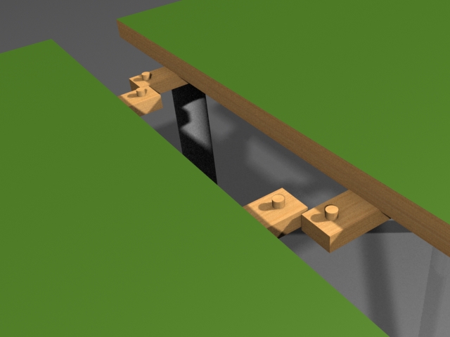

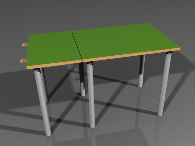

Something like this might work though...

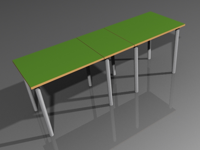

Here are your three pieces all set up.
[attachment=5265]

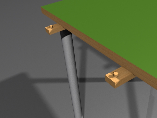

The end piece has two battens screwed to the underside of the table top, with two pieces of dowel glued in.
[attachment=5266]
The middle piece also has two battens which slide inside the battens on the first piece.
[attachment=5267]

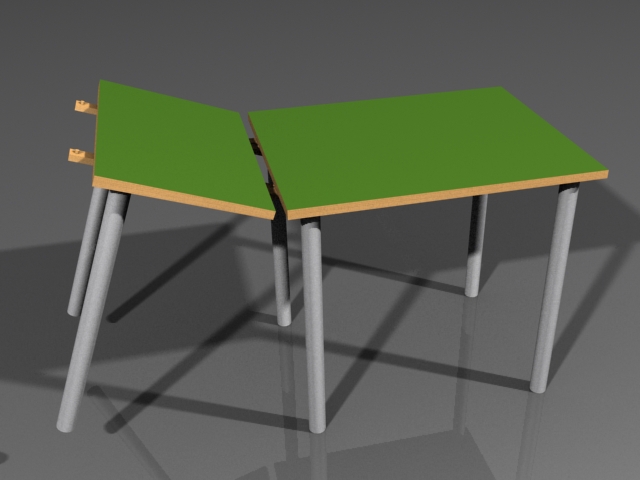

Each leaf has holes in the underside which the dowels slot into, so you angle the second piece upwards...
[attachment=5268]
... slide together, and lower to locate the dowels into the holes. The dowels would need to be rounded off at the ends for this to work.
[attachment=5269]

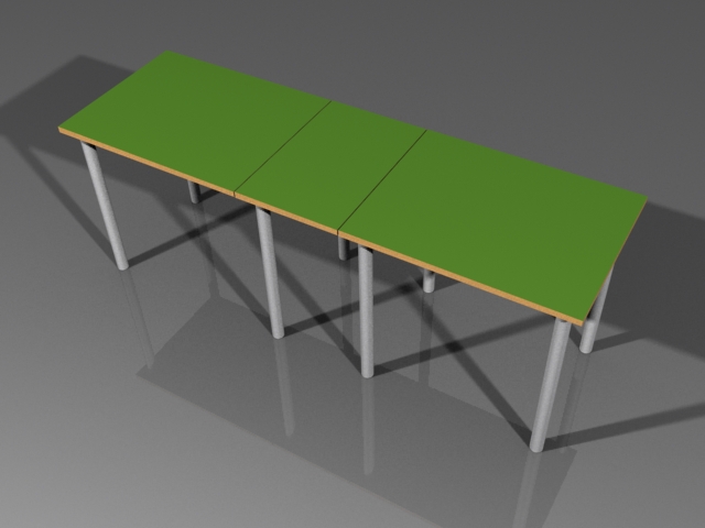

Repeat for the third piece...
[attachment=5270]
... and build your track.
[attachment=5271]
The second and third pieces would ony need two legs as each would be supported by the piece before.
