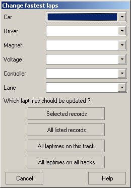

#Change entries in the list of the fastest laps
This dialog is used for updating information about the entries of the list of fastest laps. Only those columns are altered for which a value in the corresponding selection box is given.
If a selection box is left blank, the corresponding column stays untouched.
You can choose wether to change only the currently selected rows, all rows of the current list, all laptimes on this track or all laptimes on all tracks.
