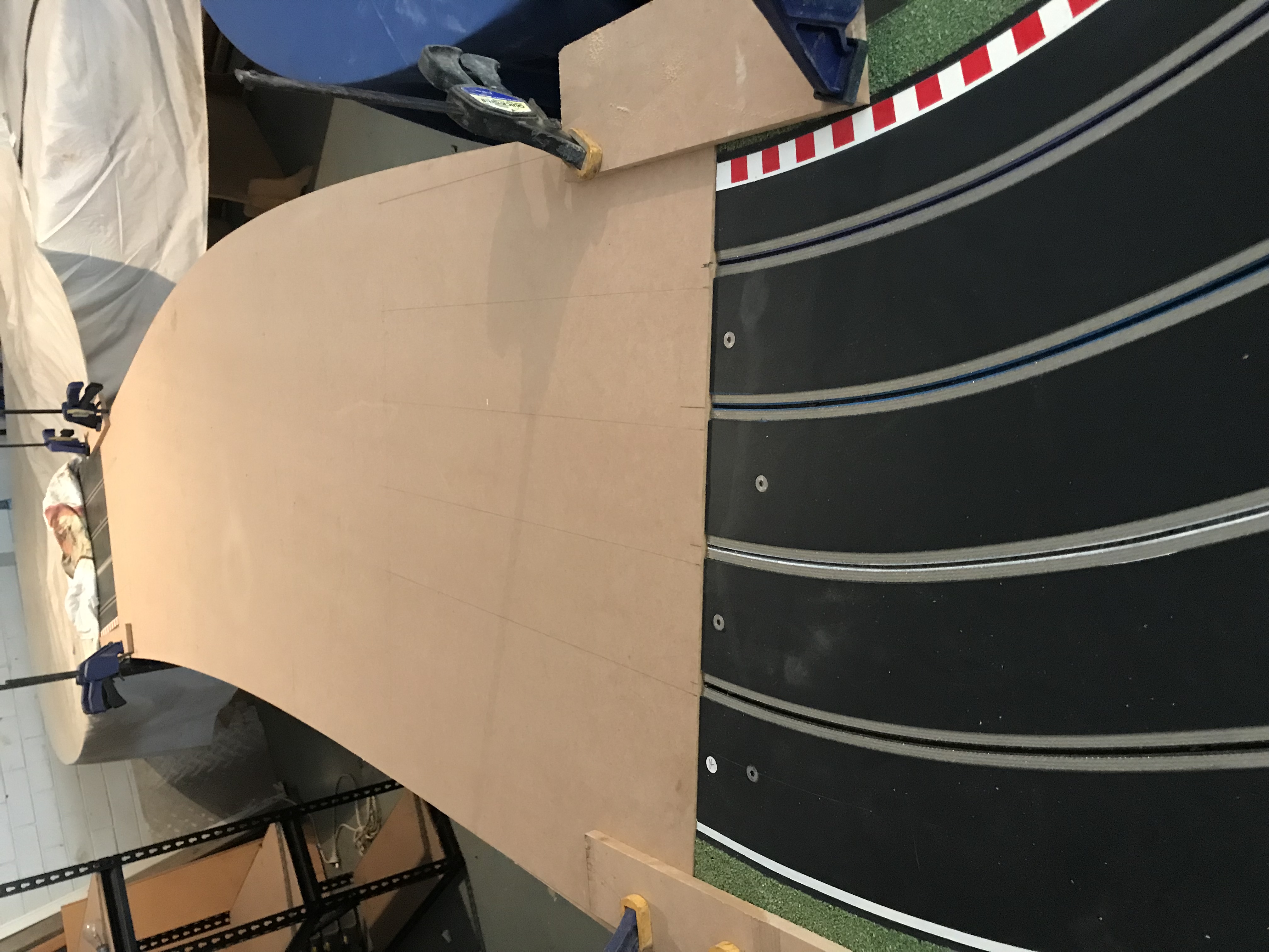

Firstly the design. Its a previous track made shorter, previously 45m now 33m or 100’
Footprint 9.5x4.2m.
I’ve had to make one new piece to make it all fit together.

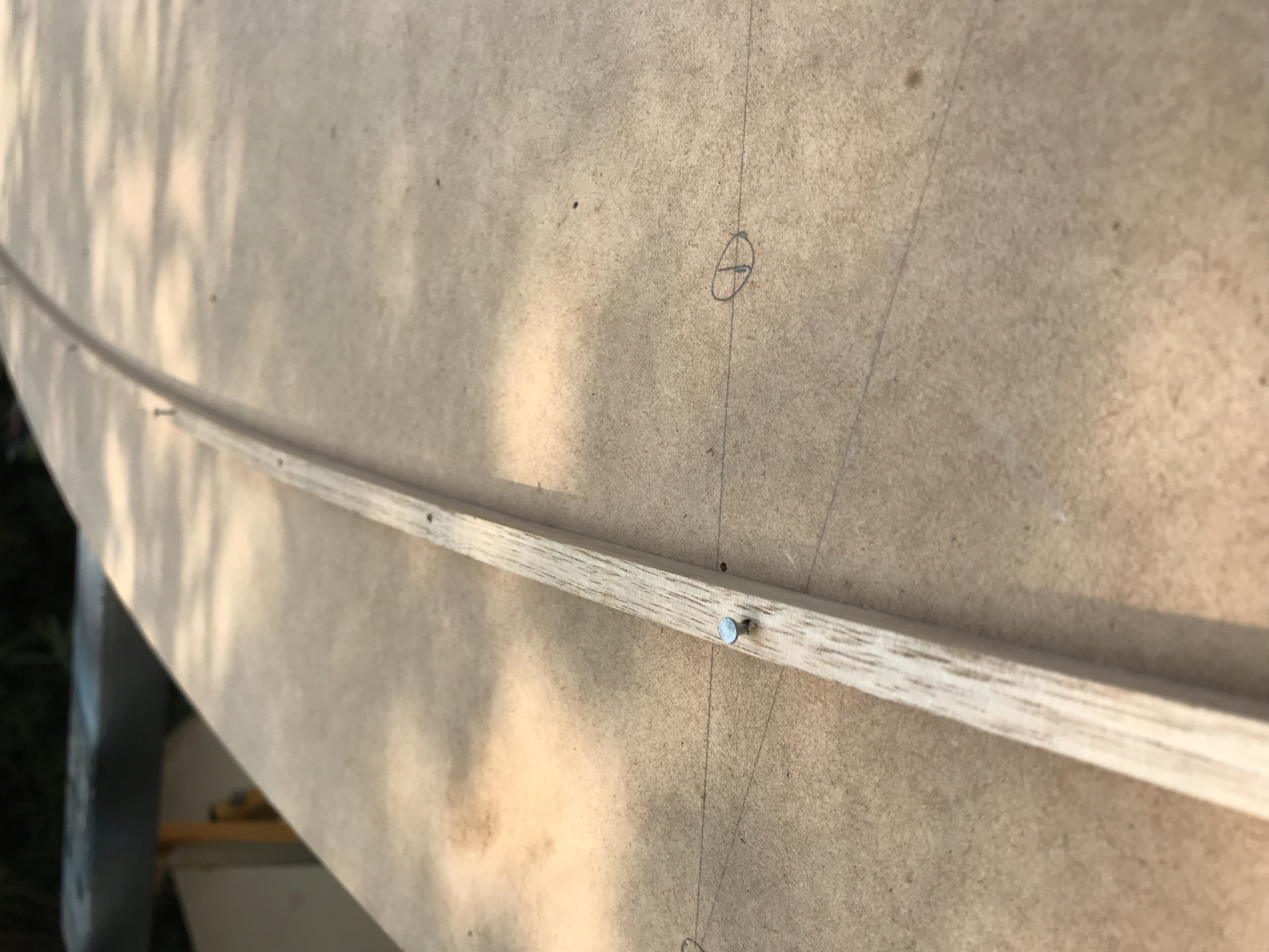

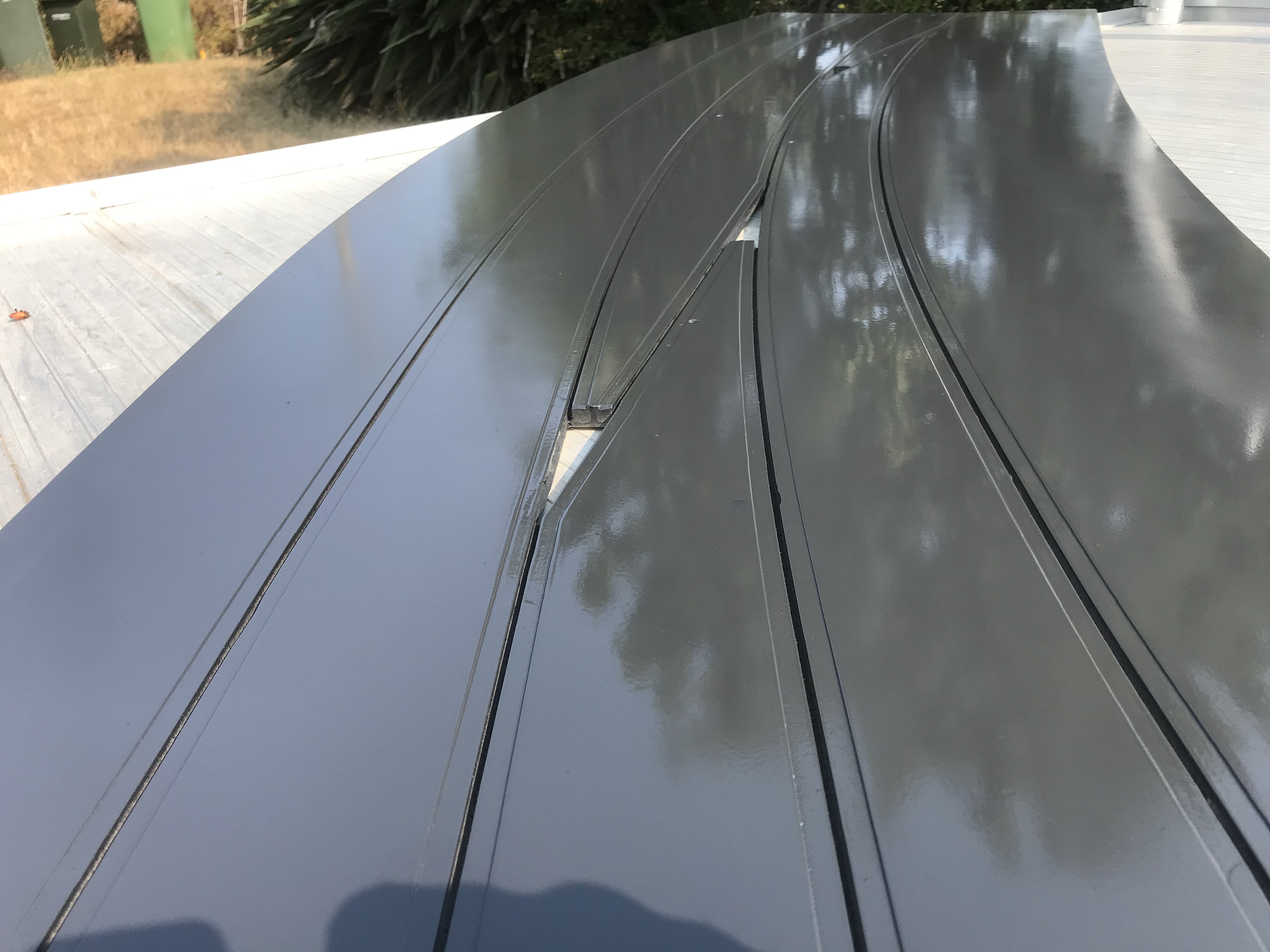

I generated X and Y coordinates off the CAD drawing and then plotted key points on the board, and then joined the dots using some 12x12mm hardwood nailed with panel pins at 200 centres. Holes are tiny and easily filled prior to sealing.

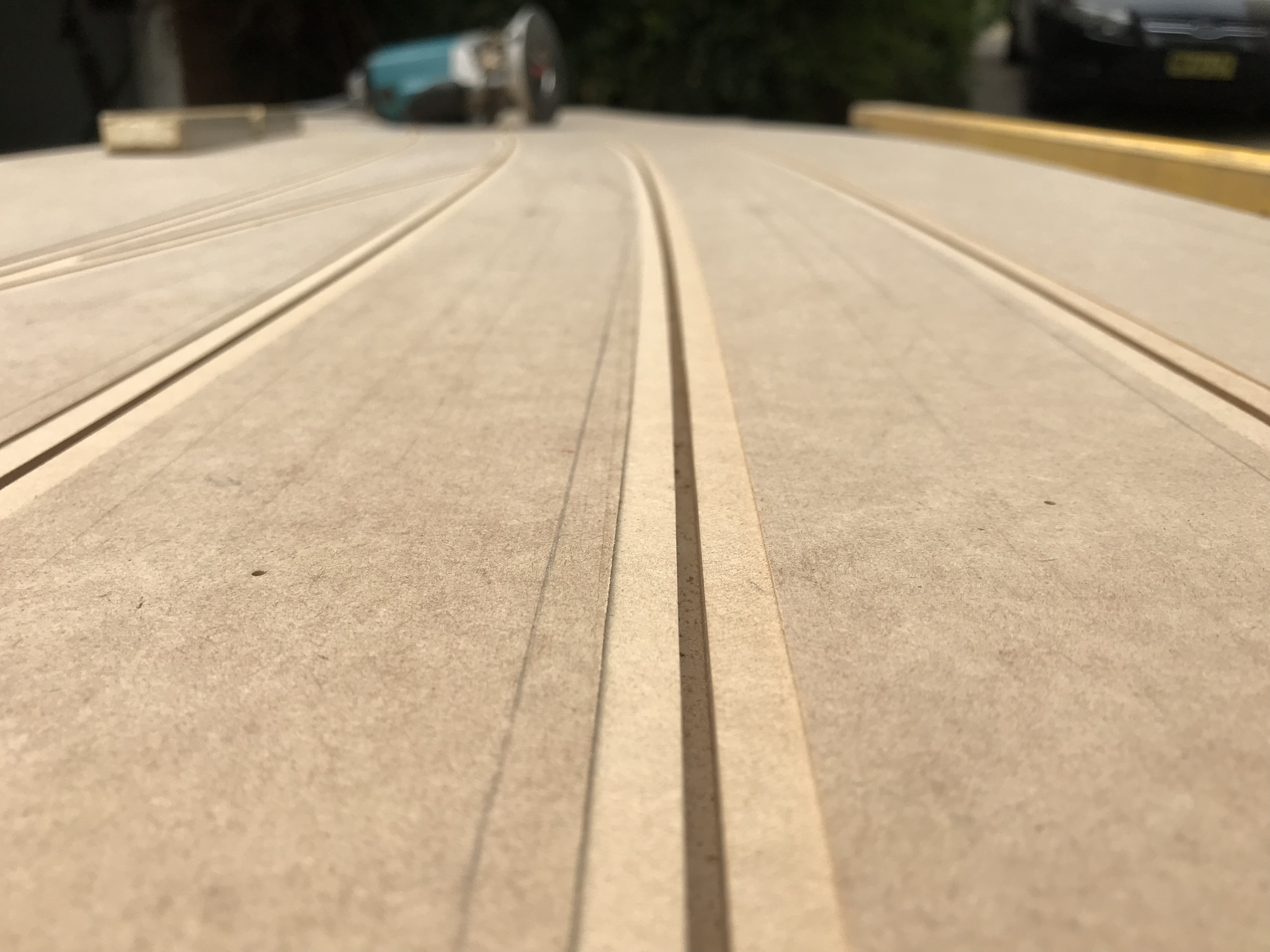

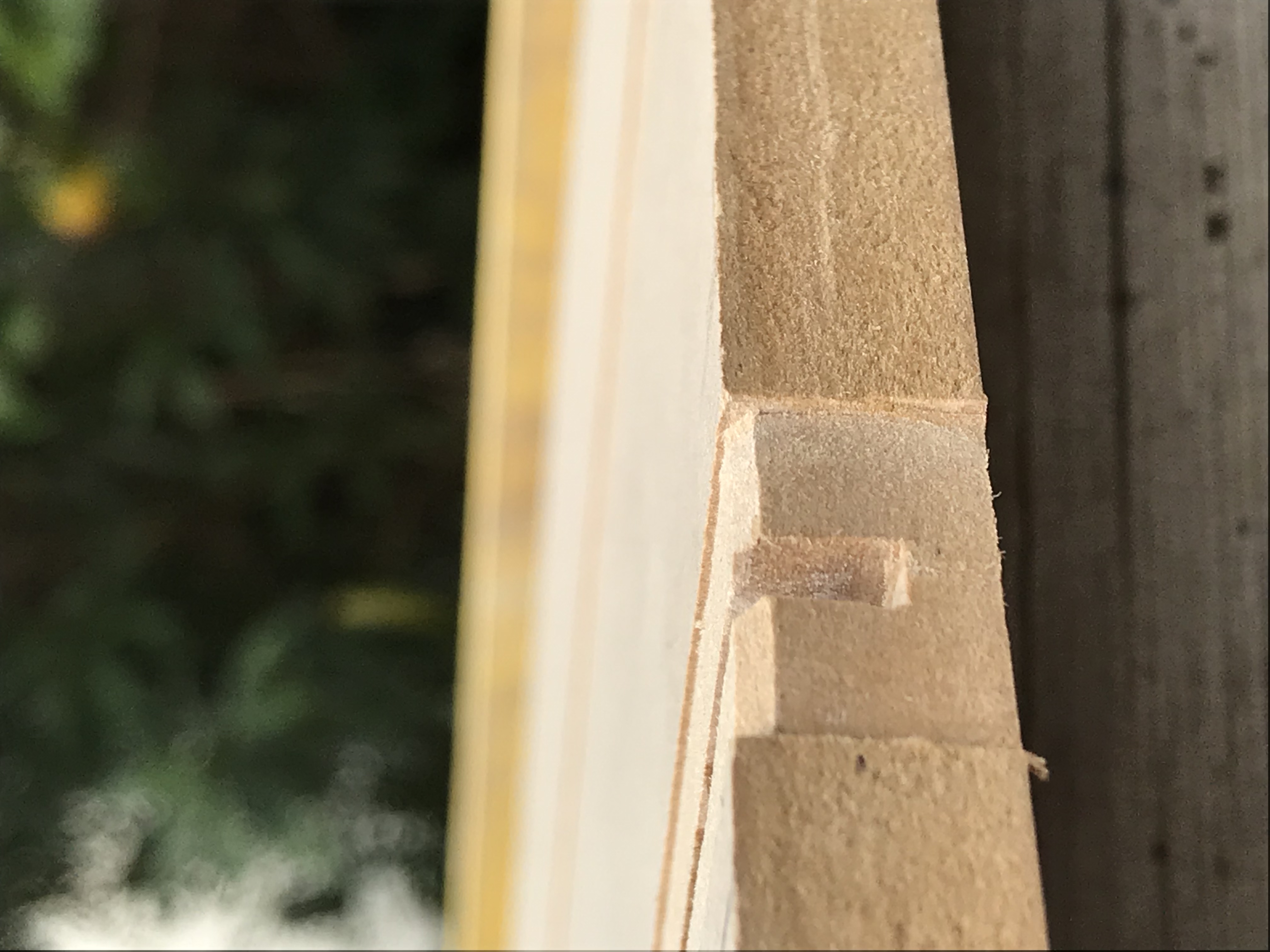

Slot is 1/8” or 3.2mm x 8mm deep.

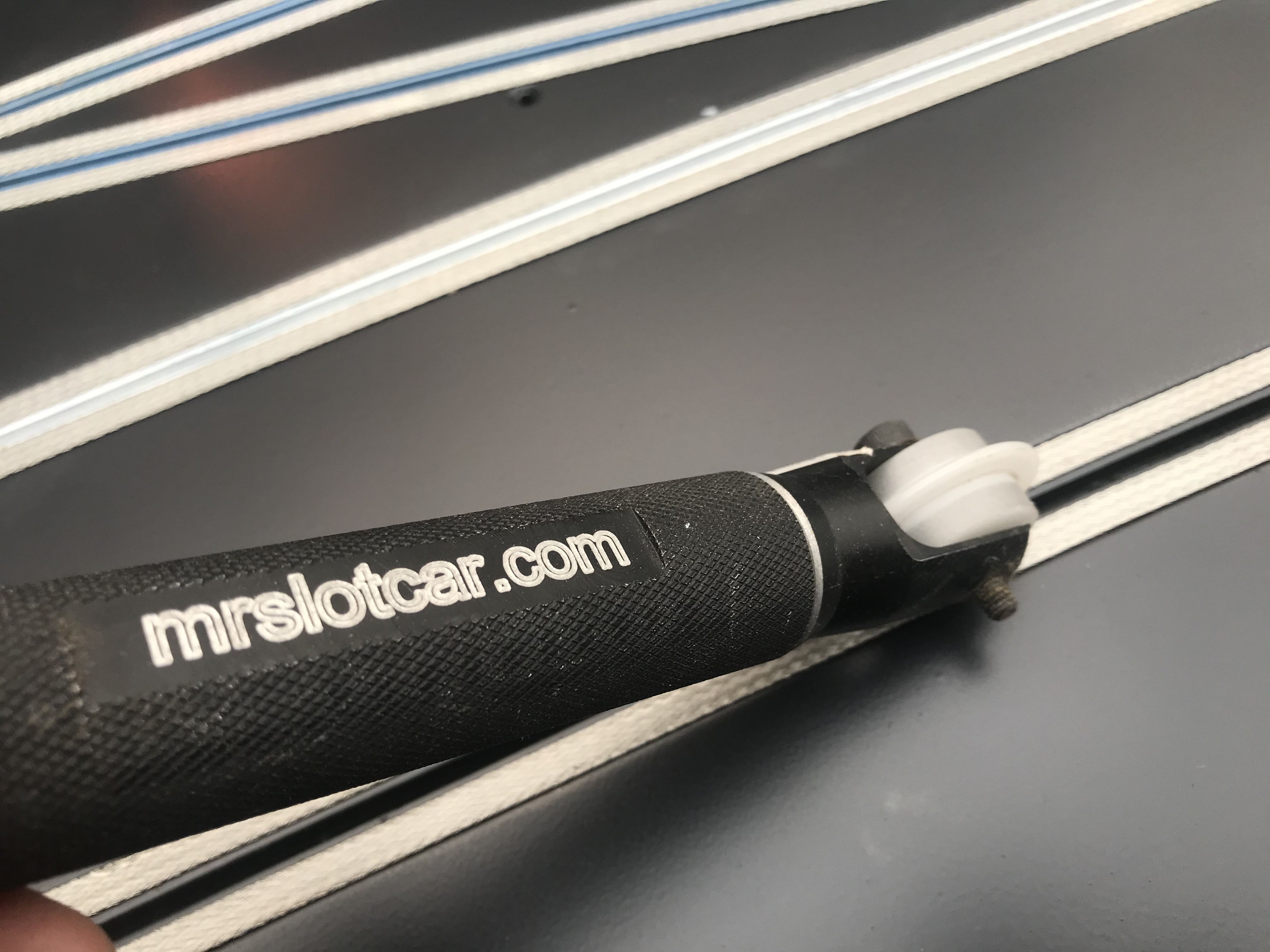

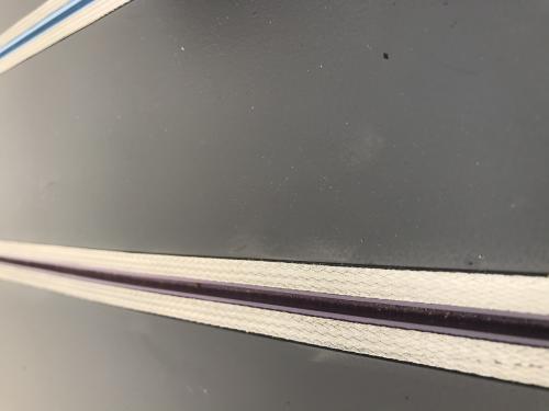

Braid recess is 3/4” x 0.8mm deep.

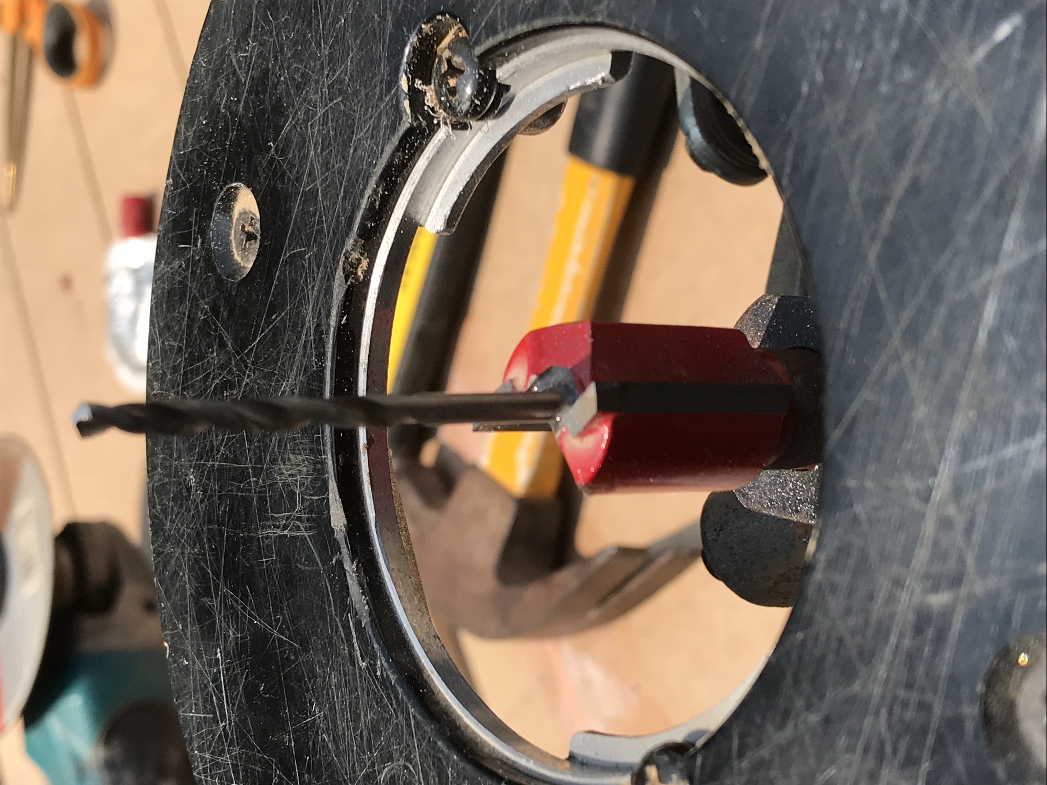

Firstly the slot was routed then I customised by own router bit but taking a new 3/4” router bit and drilling a 1/8” hole in the end. Epoxy an old drill 1/8” drill bit and then cut to 6mm long.
Now route your recess with your eyes closed literally.

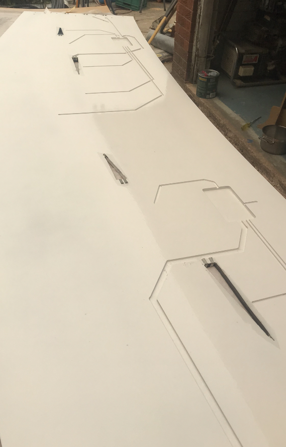

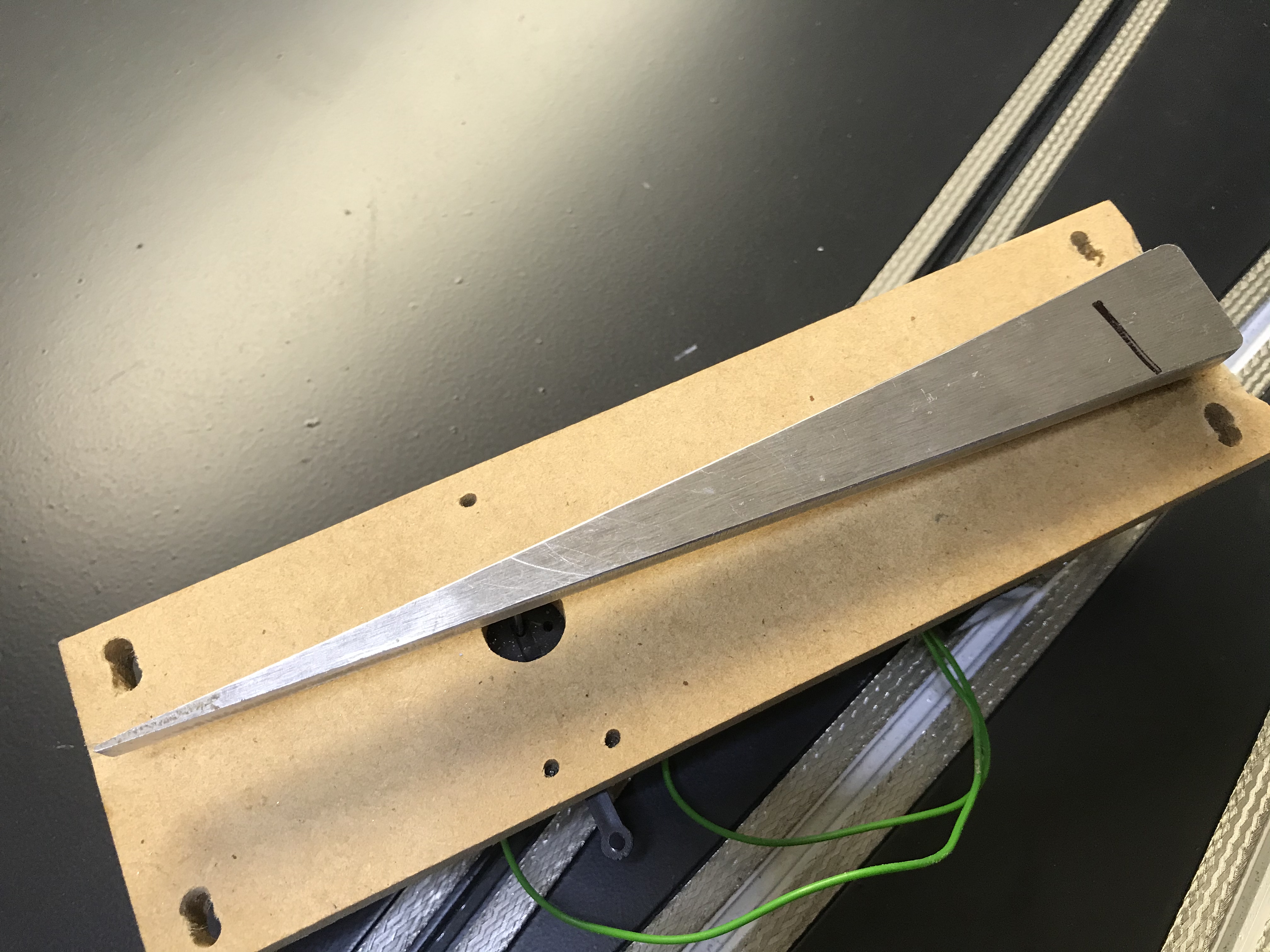

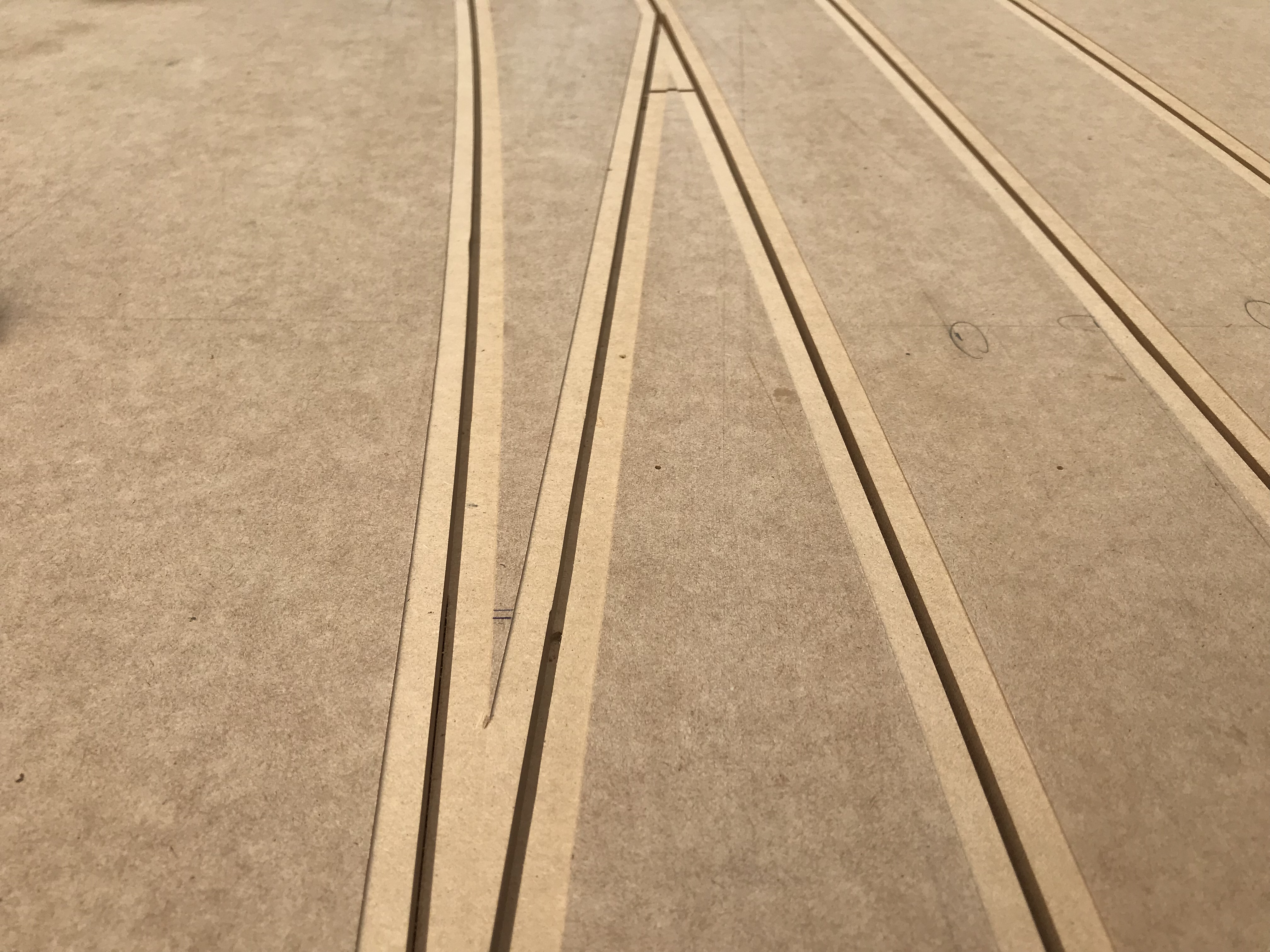

Lane change areas including cut outs for flippers done as also.
Sand and seal as soon as possible.

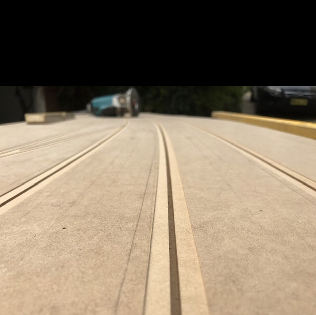

Somee more pics.

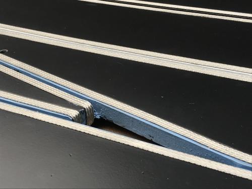

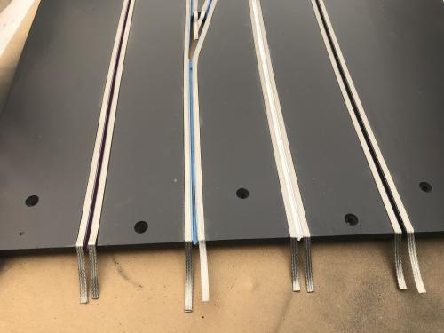

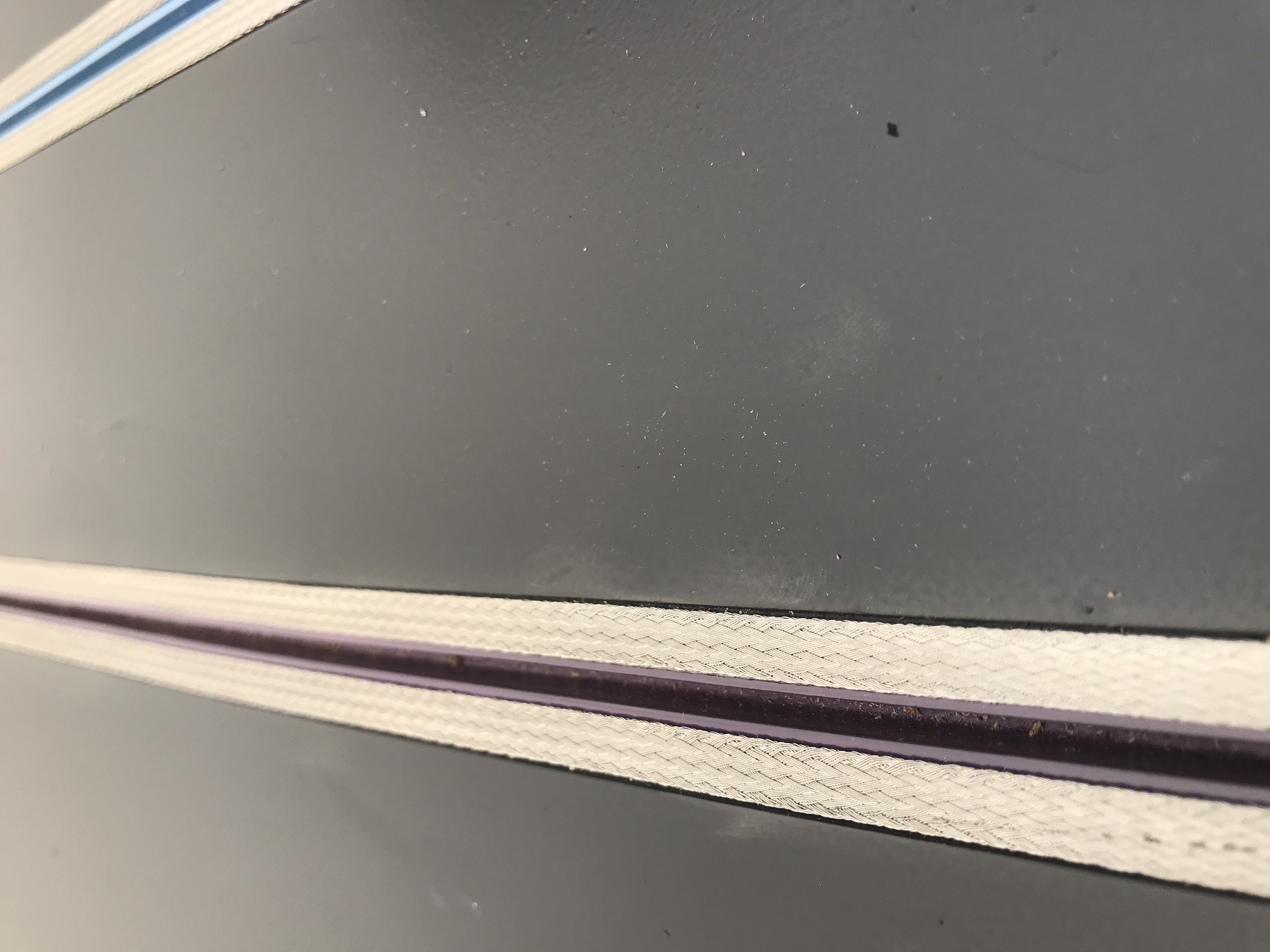

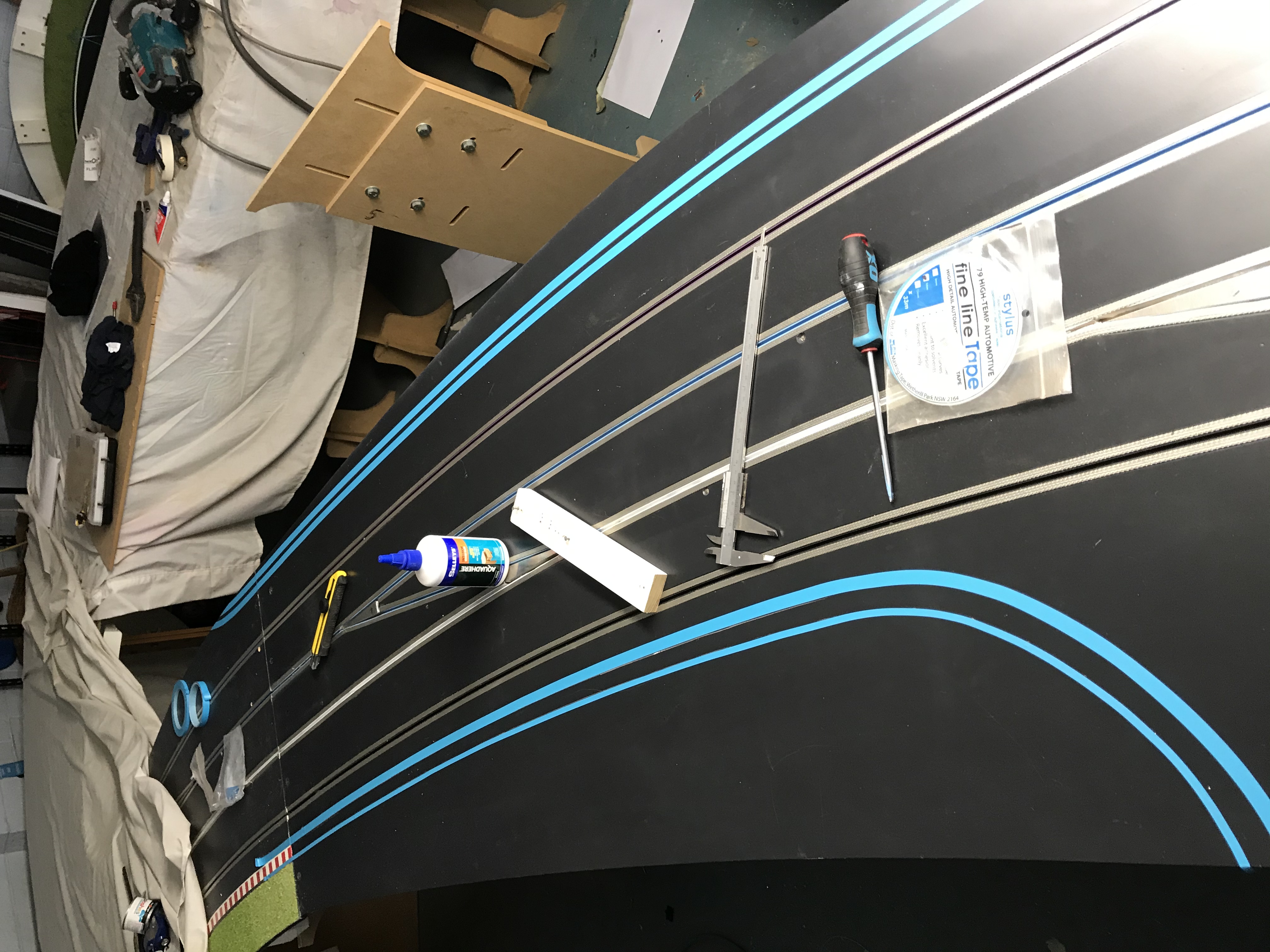

Lane colour coding completed.
Braid going down.

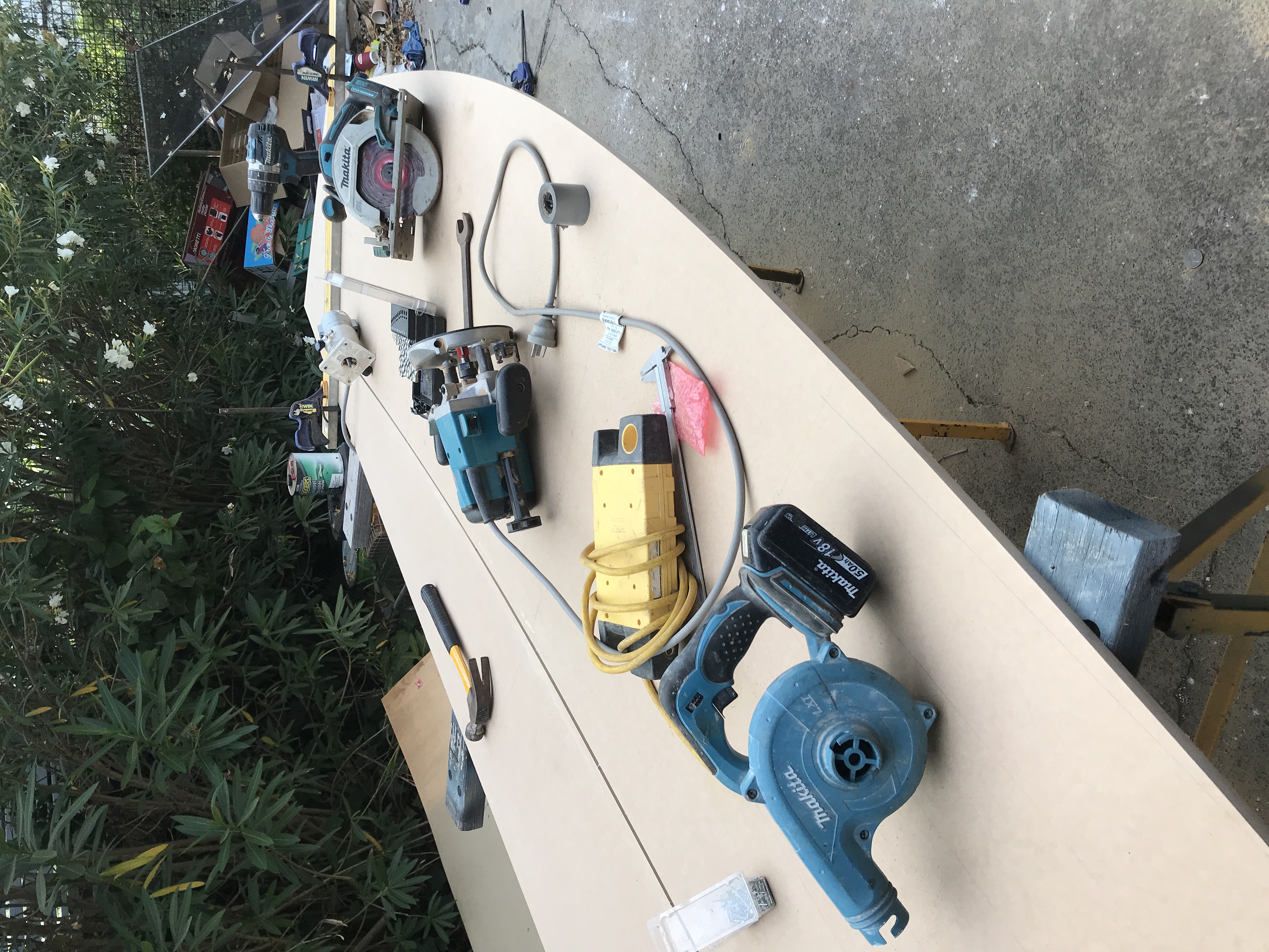

Pics of custom made recess router.

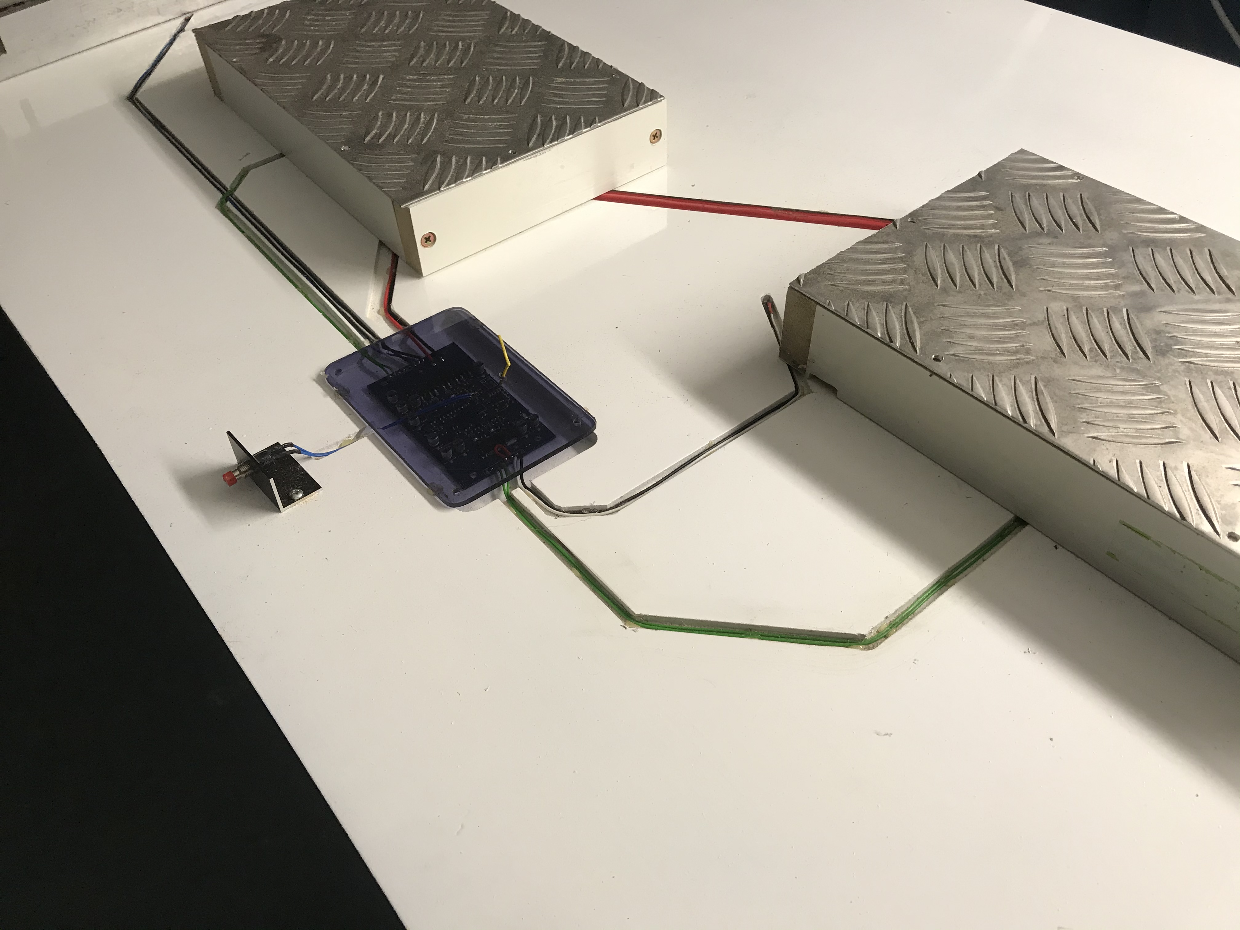

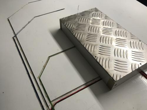

Underside.

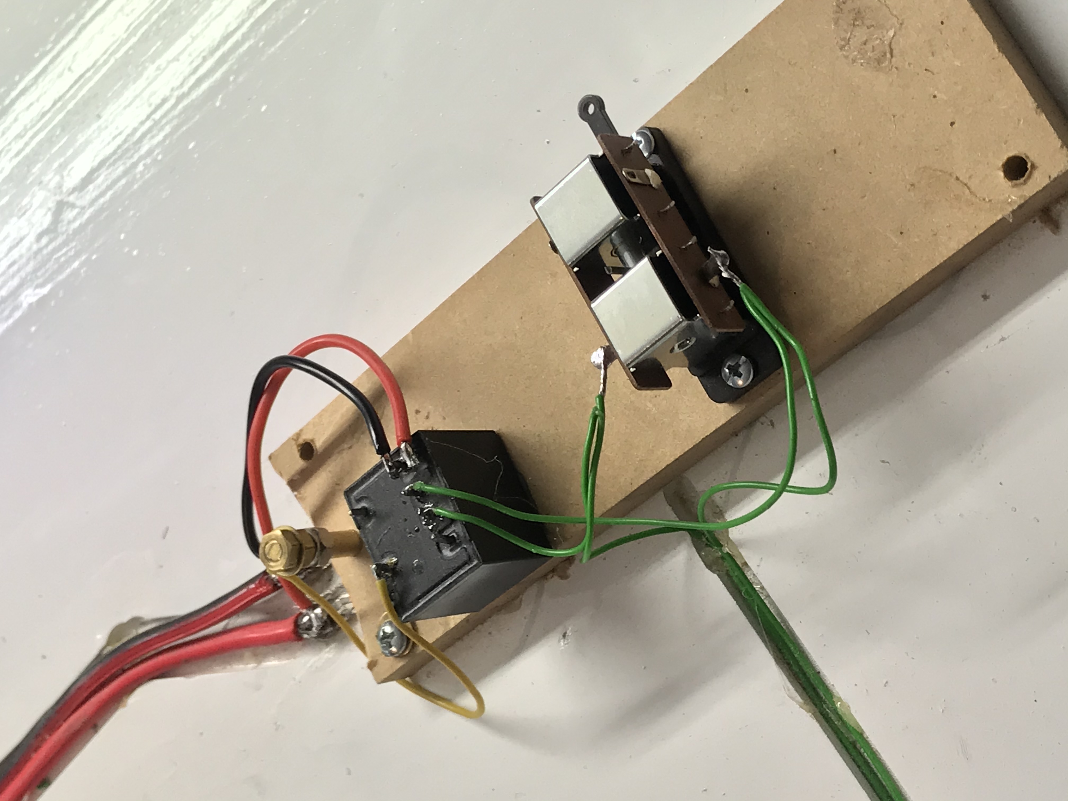

Lets route some channels for wiring so it looks neat and professional.
I always seal all sides of the MDF also so 2 coats sealer underside plus 2 coats full gloss white oil based enamel.
It will be easy to isolate wires and troubleshoot in the future.

Time for wiring, fit track joiners, lane changer electronics etc
