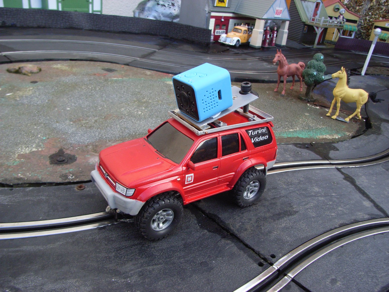

My SQ23 Camera arrived and I have had success with it. It is a little bit fiddly to work with but overall will do the job. I attached it to the roof of a tall car and so the height needed for clearance is more than I anticipated (100mm). No prob for your clever camera chassis though/

My Camera Car is battery powered and has a slot-guide so it functions a a bit of a rail-cleaner as well :-)
A Tamiya Mini 4WD 1:32 Toyota 4-Runner with home-made roof-rack.

I like being able to see the hood of the car. Makes the perspective cooler.. :-)
#14
Leo, thanks for the videos - i think they look really good. one can even see the high car tilting in the corners - i like it.

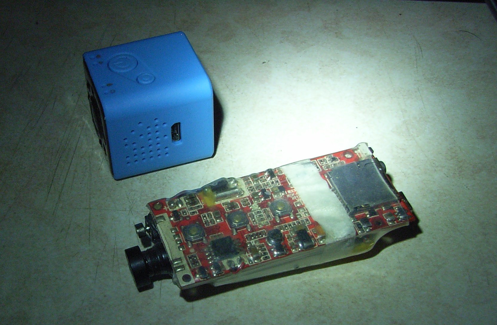

SQ23 is 31mm deep (front to back), 29mm wide and 29mm high.

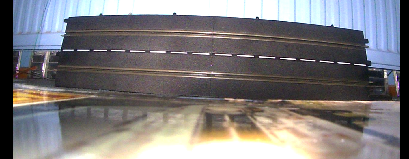

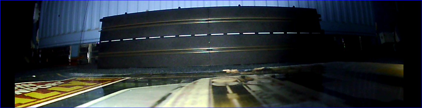

I tried a comparison of the view-angle with my "Wing Camera" as below. Wing is slightly narrower angle but much the same.
The Wing-Camera is as fitted to some drones and rc aircraft. I believe that a wide-angle lens can be fitted but not sure what mine has.
SQ23
Wing

Leo, i think it is possible that the "wing camera" already has a wide angle lens fitted?
