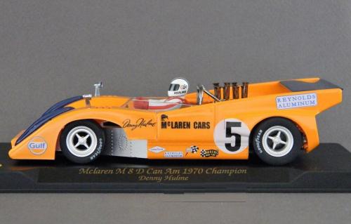

The bulk of the production consisted of McLaren M8 variants with 16 versions produced but there were also 5 Lola T260s, 5 Shadow Mk2s, 2 BRM P154s and a single BRM P167. Towards the end of production they also branched out into Group 5 Le Mans sports cars with 3 Gulf Mirage M6s and Formula 1 with 4 Lotus 72s and a Brabham BT49C  but it is the Can-Am cars for which they are mostly remembered.

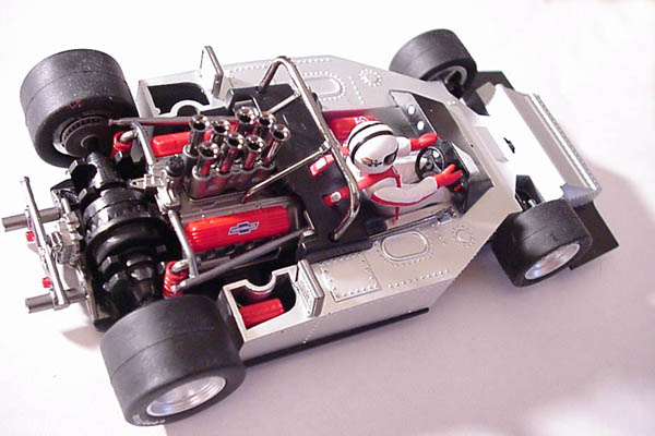

At that time the mighty Can-Am cars were largely ignored by the major manufacturers so this seemed to be an excellent choice for a new range of slot cars and Vanquish surpassed even Fly with the interior detailing. Underneath the body was a complete monocoque replica and the cars were about as close to a static diecast display piece as a slot car could get. From the air intakes on the carburetors to the tampo printed Chevrolet logos on the engine valve covers they were simply amazing. Even the seat belts were separate mouldings instead of being painted on the driver.

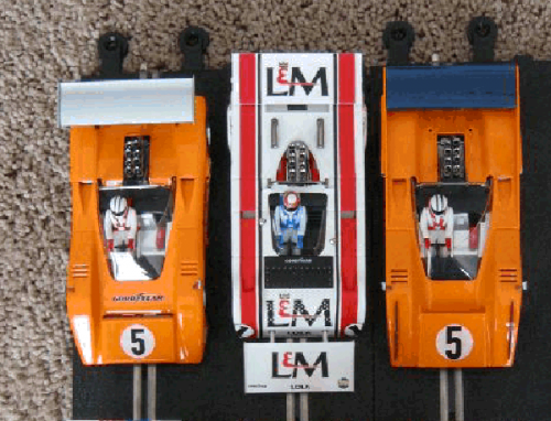

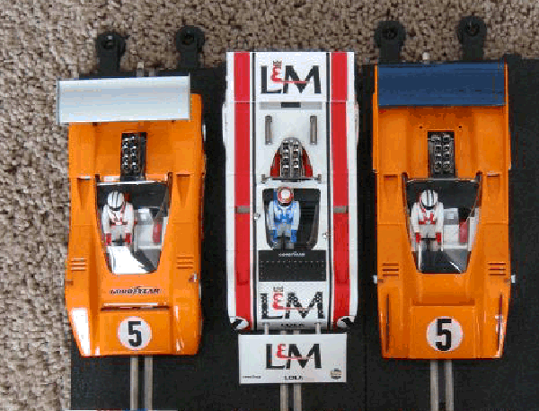

It was at this point that things started to go downhill as it soon became obvious that the things were very large - 1/28th scale as opposed to the claimed 1/32. The real cars were enormous and over-scale ones made things worse so you could only just manage to get two of them side by side on standard Scalextric track and overtaking was well nigh impossible.

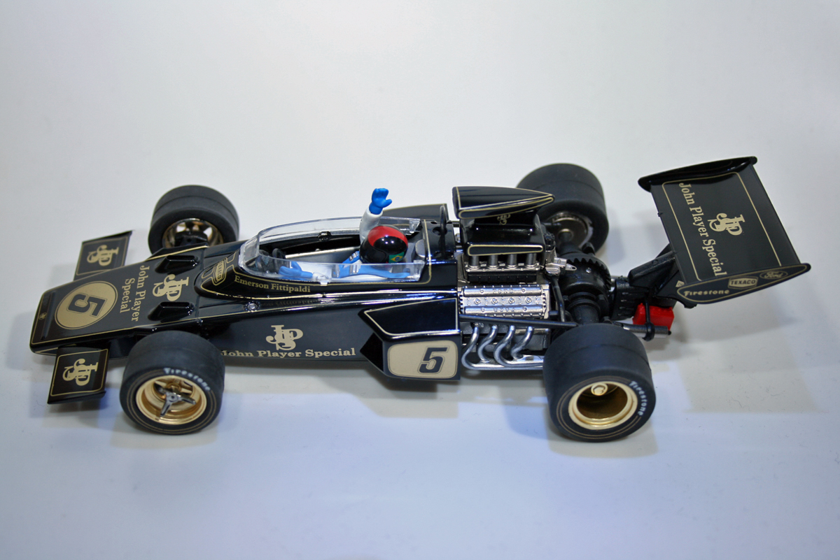

The Lotus was very pretty but extremely fragile and better suited to display than actual racing while the Brabham, which was their final offering, was nowhere near their usual standard. Their time was up and they became an ex-parrot before the year was out. Perhaps if they had stuck to 1/32 scale and not bothered with the diff then things might have been different but the price premium of £10 more than their competitors and the bankruptcy of their UK distributor with, presumably a lot of stock which was never paid for, probably hastened their end. Does anybody know whether a 2004 catalogue was produced? I have never come across one.
