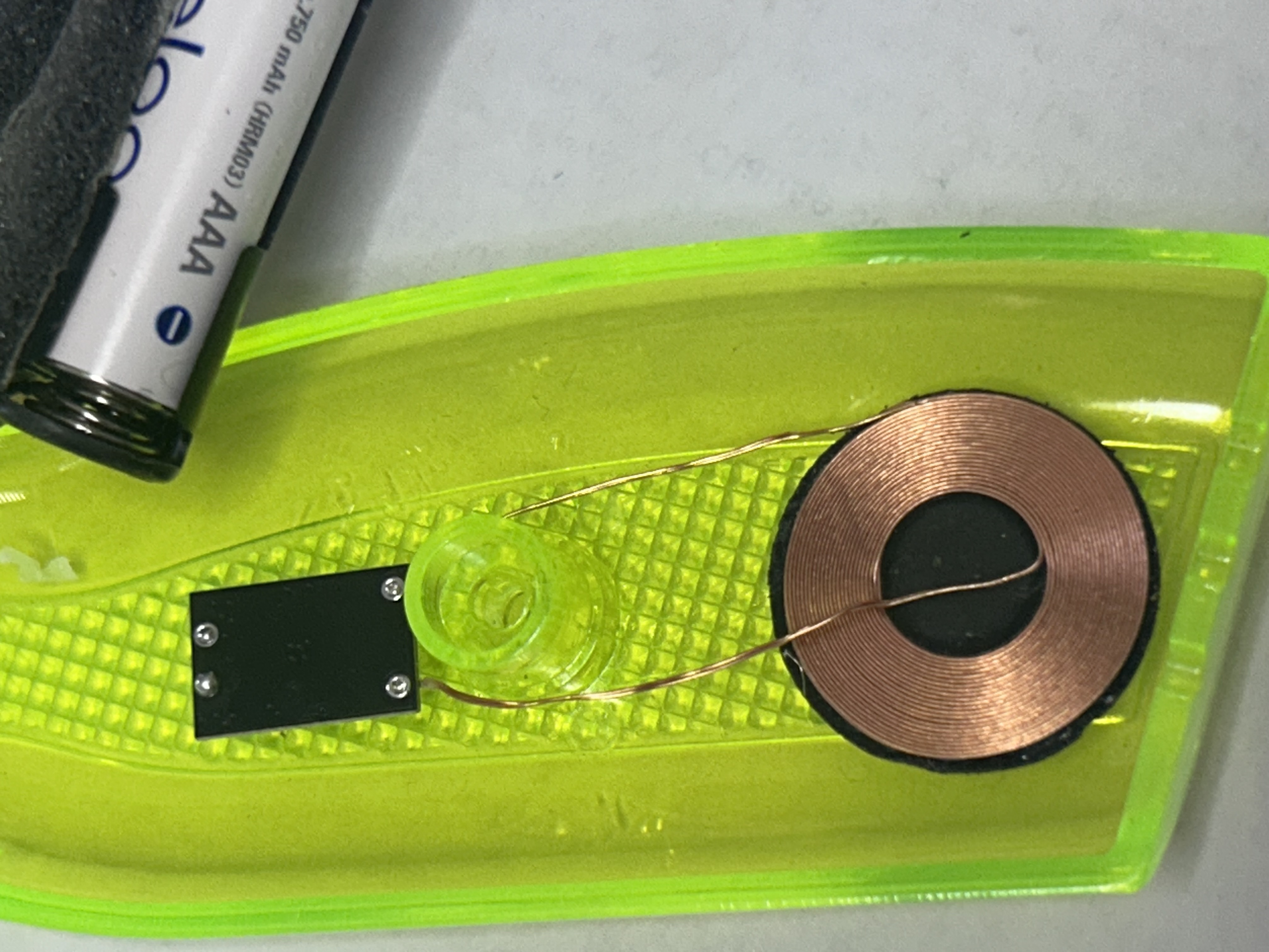

A few of the RC guys have been using Qi coils in the controllers to get wireless charging. The price of these has dropped dramatically and are now very affordable. My friend David Caille showed an install online for a controller.
The Qi coils are 25x25mm and can fit almost anywhere. Capacity is around 80% of AAA batteries. Price $10-15 online. Charging would required every 8 weeks of average use for 3 hours.

Wireless coil arrived today.
I must say it doesn’t look much.

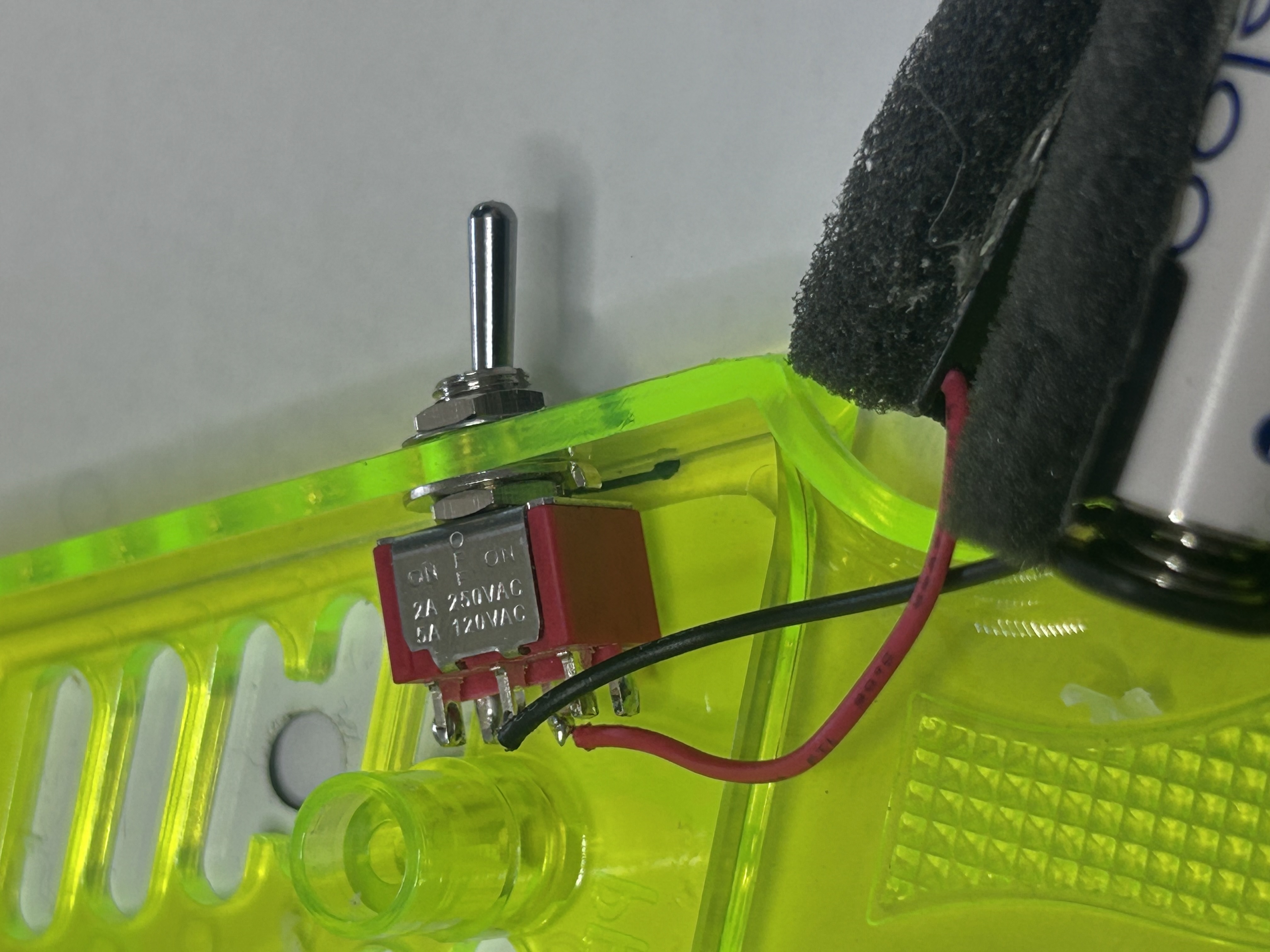

After thinking about I thought of a double pole double throw switch that could switch battery to coil PCB or controller PCB. If a 3 way switch is used an “off” option” becomes available as well.
Onto recap the 3 switch positions are:
1. On
2. Off
3. Charge

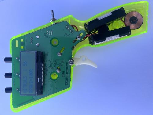

So first mount a DPDT switch.
Then mount the coil and its PCB.
Here I was able to pull the copper wire off the base plate to get an extra 16mm or so ti be able to mount it as shown. This was crucial and there was luck it fits so snuggly
Next from the switch solder 2 wires  to the coil PCB.
Next solder 2 switch wires to the controller PCB.
The switch looks pretty good.
Done.
Put it back together.

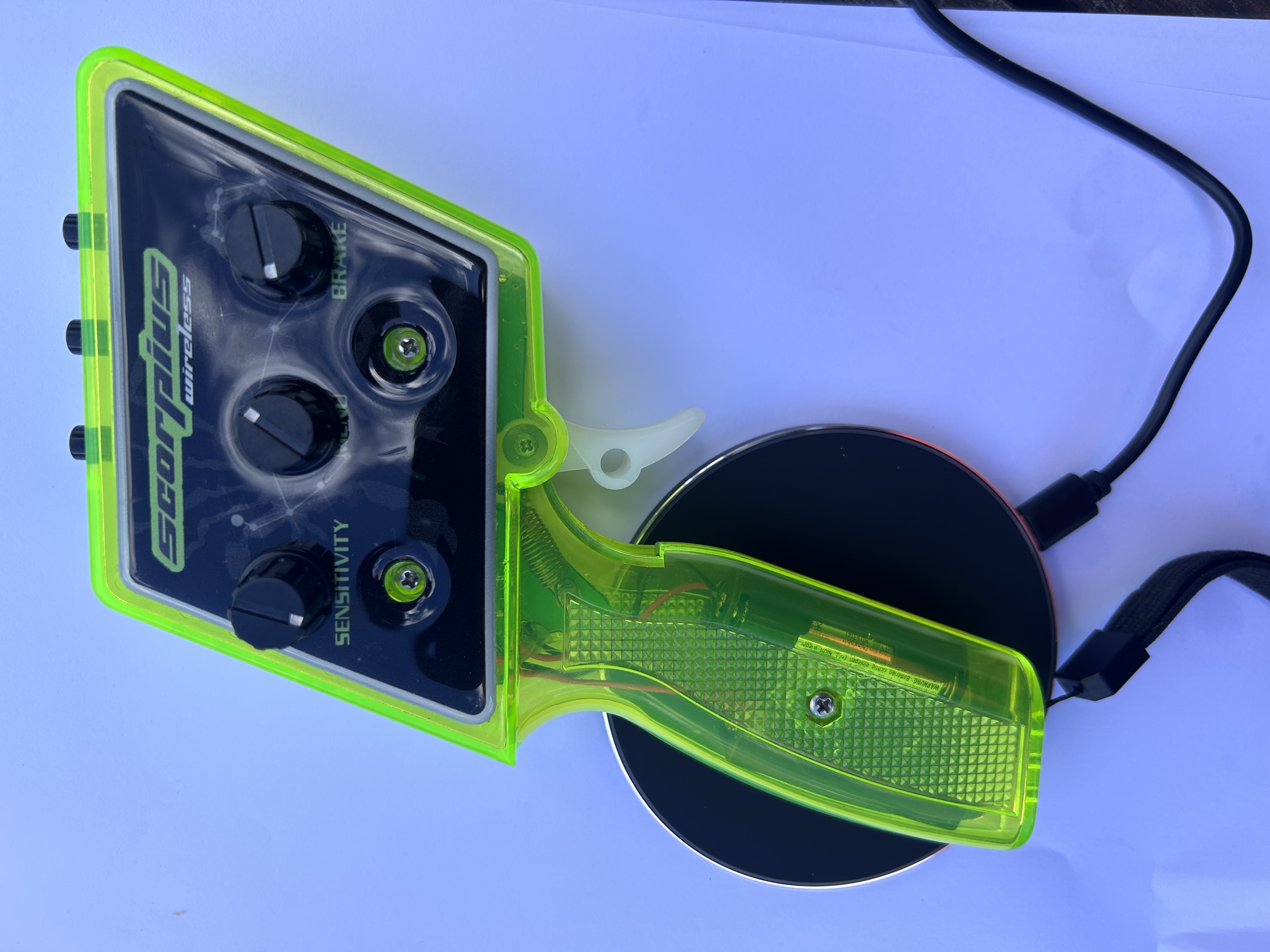

Ok I set the controller into transmission mode on Sat 11th October at midday and it’s just died on Wednesday 15th at 4pm
Exactly 100 hours like the previous system so it passes the test.
Now charging…….I’ll take a voltage reading first.
