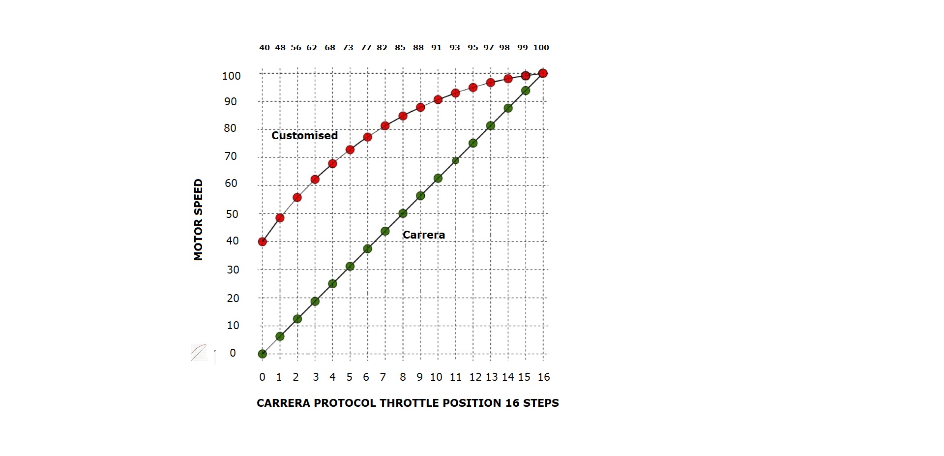

Let's start with throttle mapping.
We cant change how many steps the Carrera controller puts out. It will always be limited to 16. But we can take those steps and change the power output in the MPD Nitrous decoder.
This has never been attempted before. How ever it is simply a variation of the Scorpius Throttle Set Up program.
Instead of using this configuration program to upload to the Scorpius controller it is uploaded to the MPD Nitrous decoder.
In the diagram shown we compare a Carrera linear map to a customised one. The amount of possible maps that can be written is almost infinite.

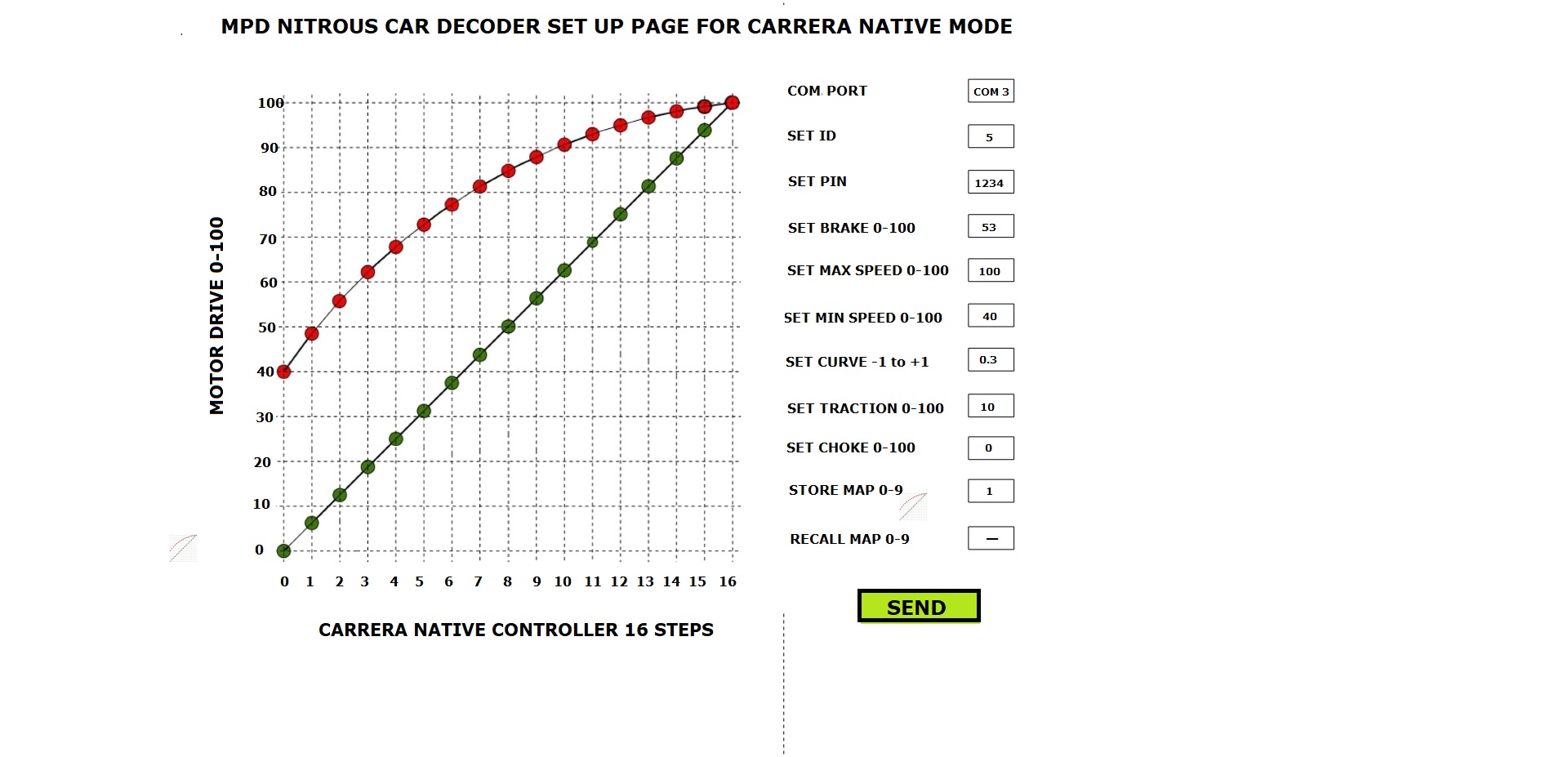

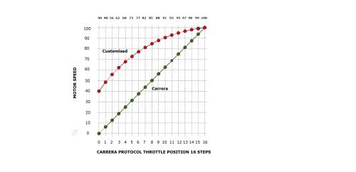

We can set brakes 0-100, a minimum, a maximum, a choke set up, add a driver name (used in RMS functions), select ID, select a PIN, we could even implement traction control. But I'll go into those later.
The map could be recalled, re-edited and re-uploaded to the Nitrous car decoder.
As you could imagine this proposed software and firmware opens up an entire new world for Carrera users.
