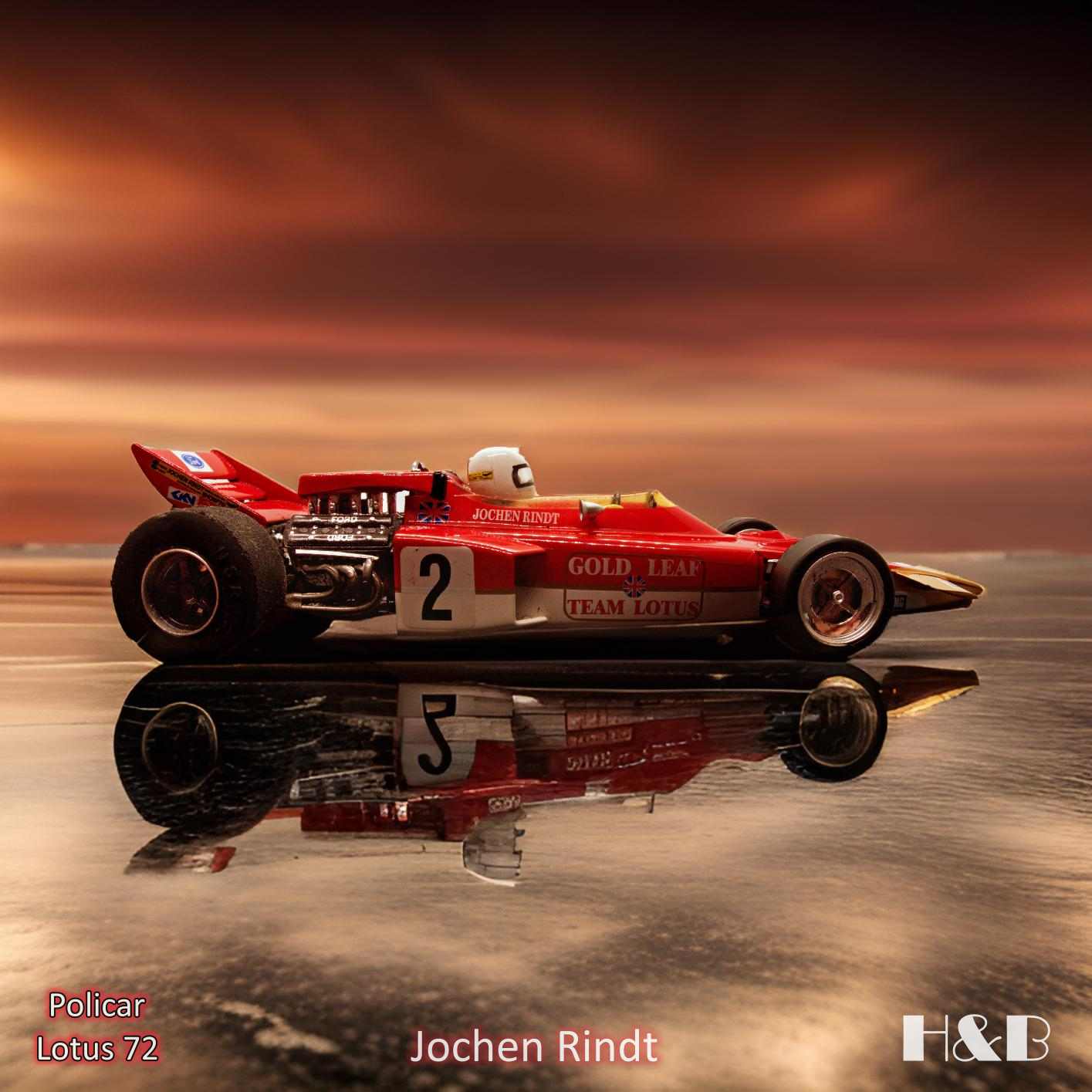

after weeks of practice...finally a photo
after weeks of practice...finally a photo of which I can say...this is starting to look like it...you all know my great role model in this. Doug Johnson...that man makes beautiful photos truly art.
Since I don't have gear like a professional and don't have expensive subscriptions to expensive Adobe software, I had to rely on many hours of YouTube, learning how Gimp works and other tricks.
a lot led to frustration... Gimp has a very difficult learning curve, and light can become your biggest enemy with photography.
However, you learn how to take photographs from every session.step by step.
[+] 8 members Like HB Bench's post
Nice pics HB,  Thumbup
Doug Johnson has inspired many people to come out of the dark dungeons and take better pics. He's absolutely amazing and super talented.
I had a crappy background, no proper base, dim lighting, and no camera stand. After a blunt whack on the head with a little common sense. I took Doug's advice.
Mind you, I've also raced on Doug's track (nice track too). I peeked at his photo booth/setup.  Wrench Just don't tell him.
Very nice indeed HB. Really well done. Thumbup
Doug does indeed take beautiful photos, and it's great to see that several people have been inspired to make an extra effort with their photography. This is a hobby that I believe benefits greatly from that extra effort, so keep up the good work.
I've also been struggling to learn GIMP, so I wholeheartedly sympathise.

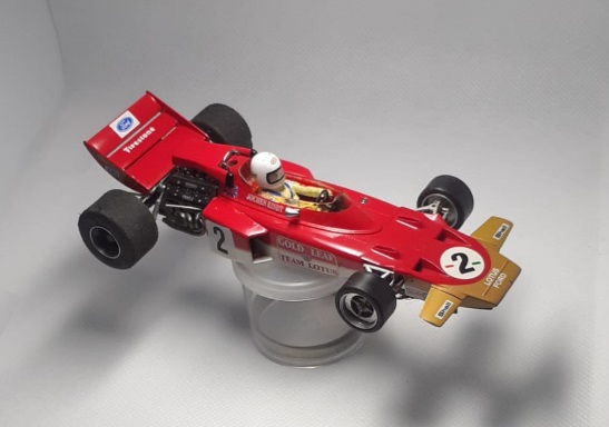

HB, I decided to put my money where my mouth is, and went to the dollar store today, bought some foamcore (or foam board as they called it in the dollar store), and built a softbox (that's what they call them in a studio)!  The opening is 20" square, and covered with a white garbage bag that was large enough to have both sides between the car and the light.  My light here in Vancouver is an old led light for video's that I never used for video's.
[Image: nqO8FOl.jpg]
Here is a slightly closer look at it...
[Image: IEoJV48.jpg]
...and you can see, off to the side, a small styrofoam reflector to bounce light into the front of the car.  The foamcore cost me $4.00 CDN, and I used packing tape to assemble it!  It might be a little heavy for a desk lamp, but halogen construction lamps are really cheap these days because everyone has gone to led's....and they usually come with their own stand!  Give it a try, you will be surprised by the results!
