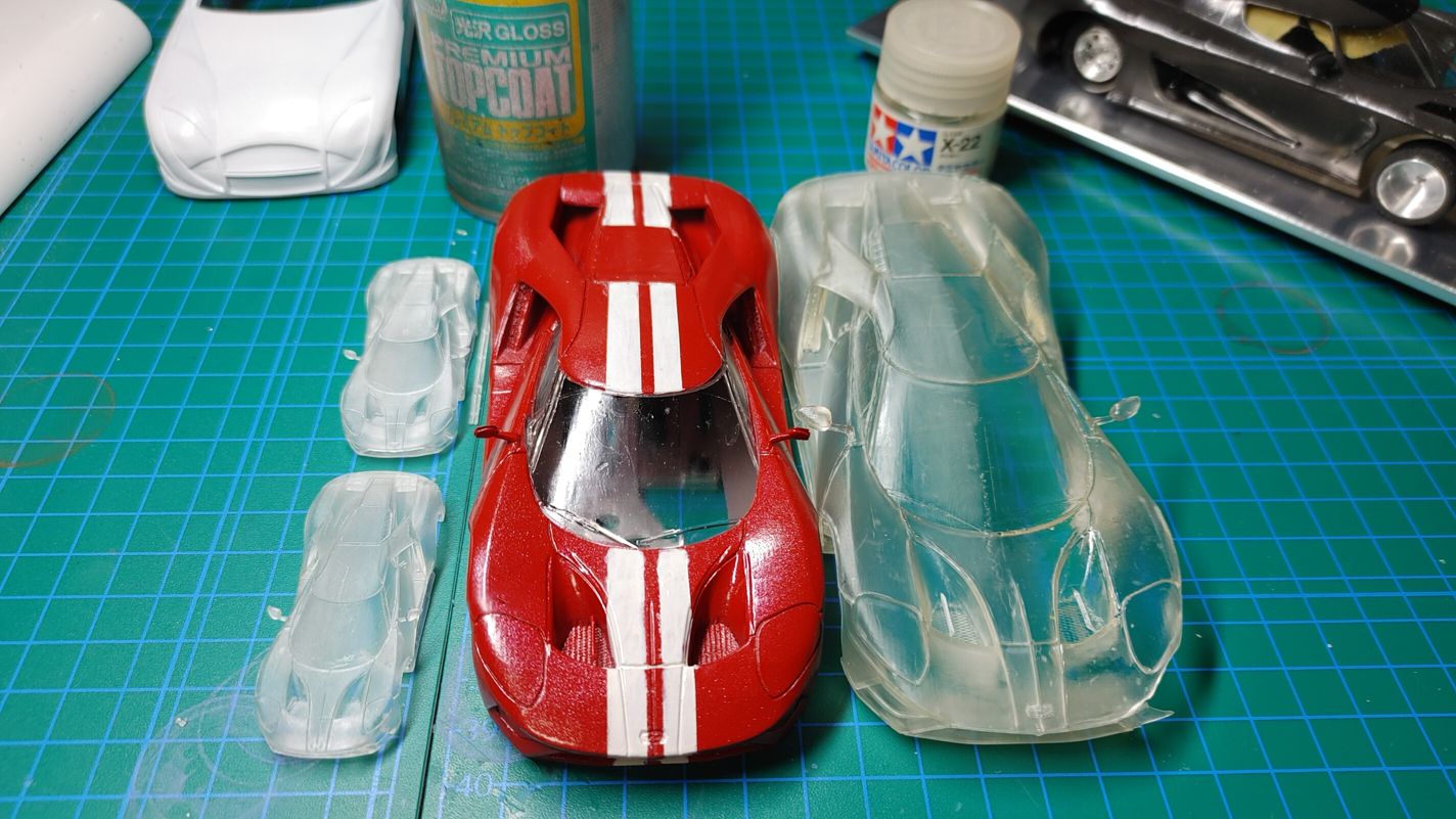

I just got some Elegoo transparent resin in to try printing with the windows left in.  After coating with a clear topcoat the result does not look too bad to my old eyes.  Hopefully the coating will help against yellowing over time.
Going to let this one get some sunlight while I tweek the model a bit and fix my errors.

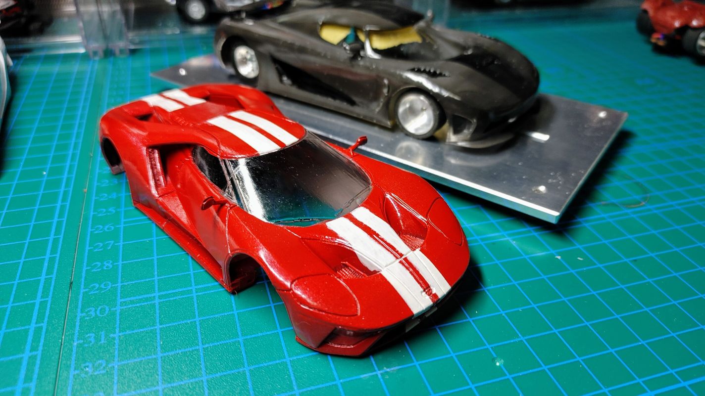

The whole car was printed with clear resin.  I then masked the windows while painted the rest of the body.

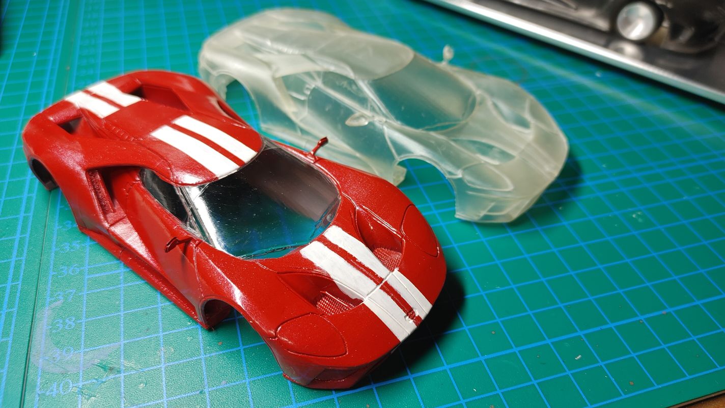

The unpainted body has more of a yellow tint as it has over cured - this was before I did the wonderful Cones of Calibration which reduced the exposure time per layer from 2.5s to 2s.  This gave me much more accurate prints, saved a bunch of time, and for the clear resin took away some of the yellowness.

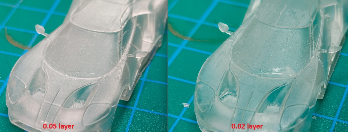

I printed a couple of smaller versions while I was trying to fix some errors in the model itself, and also tried to dial up the fineness of the print.  My thought being a finer print may get clearer results.
I went from a layer height of 0.05 to 0.02 as a compromise between wating to see increased smoothness ad the time it would take to print.
While this has increased the smoothness of the print, it has also introduced some yellowing.  I am assuming this could be a result of the increased uv exposure when printing as previously printed layers still receiving exposure from the current layer printing?  But if that was the case, should't I see a colour gradient from the first layer printed through to the last??  My brain itches.
I think the post print process should also improve the look.  At the moment just testing and you can see I did absolutely no prep work when painting.  Just cleaned parts and set about it.  Some fine sanding of the parts I think will improve it too.

The painted car was sone with Mr Hobby Premium Top Coat.  The misty side of the unpainted car just one coat of Mr Hobby to protect and the glossy side Tamiya x22

I can't speak for any of the chemistry behind it, just from what I have experienced so far.  If I leave the printed parts under the UV lamp for curing, the transparent resin will have a stronger tint - will see what the failed part currently in curing will look like when I take it out later.  Should reproduce a long time exposed to daylight I guess.
