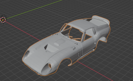

i do not remember  where i found the (free)file,i  went that far,not sure if  dimensions are correct:
I could email you the blender file
[+] 1 member Likes AlexisGaitanis's post

File emailed.When you check the file please tell me if my dimesnions are correct

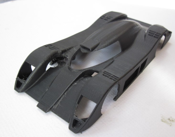

Toyota GT1
Wanted a club racing GT1 chassis to go under the MRRC GT1 for myself and a fellow club member and remembered I had a half finished GT1 shell design that I created some years ago and thought it would useful for testing purposes. Dusting this off and a few revisions later, is shown below fresh from the printer with the supports removed.
Shell is 0.9mm thick vertically printed no section, as the back has a flat face to print off. Material is my current flavour of the month JAMG HE PLA+ at 0.1mm layers.
            John
Mr Fit for Function.
[+] 5 members Like JMay's post

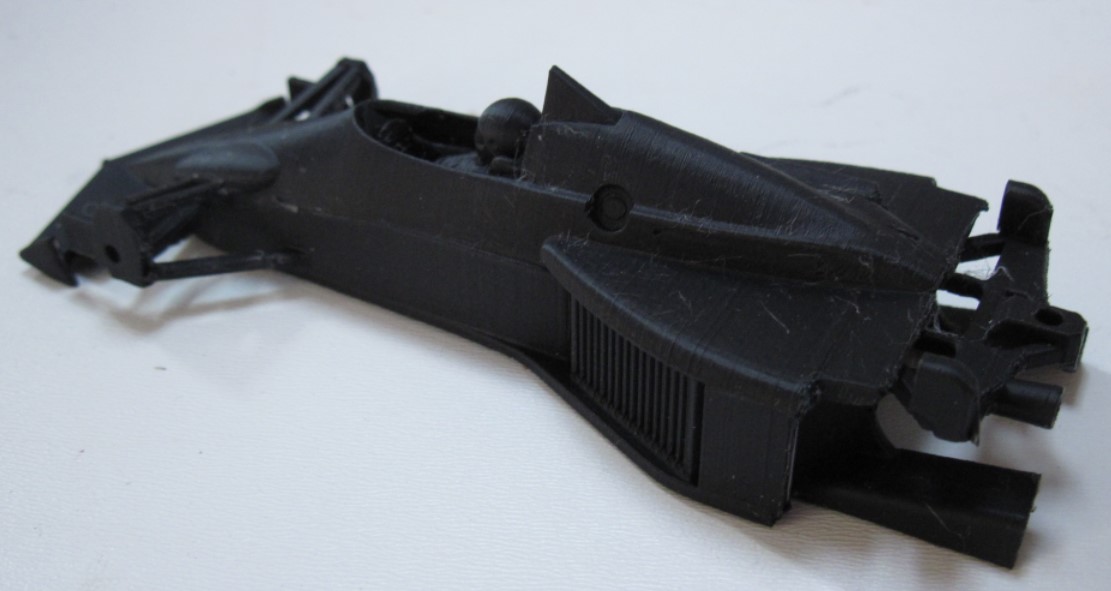

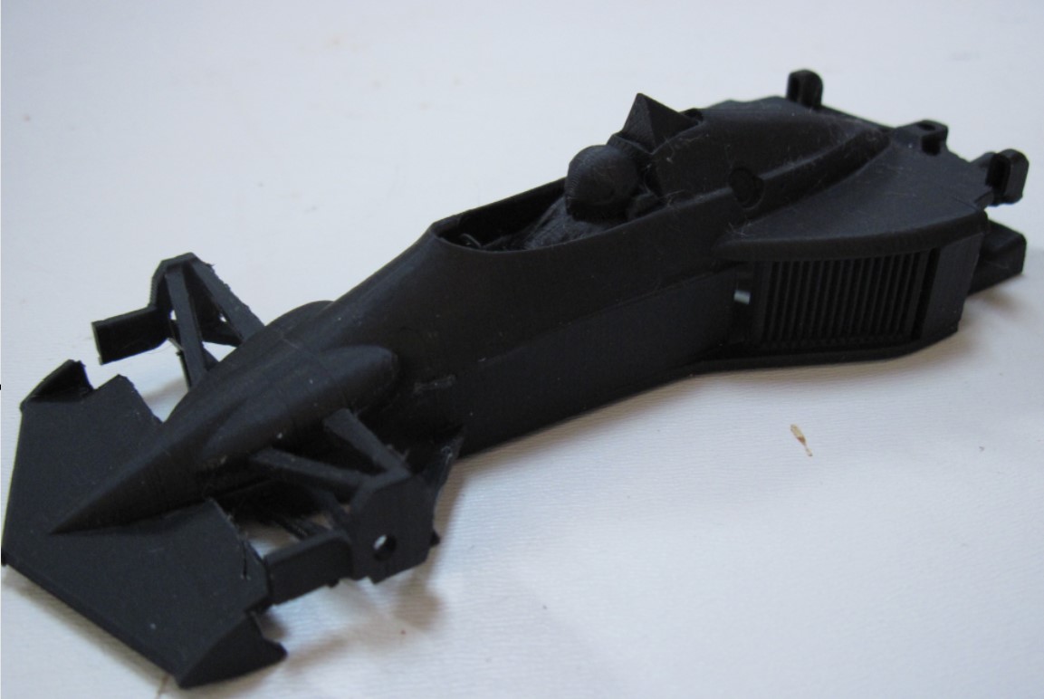

Brabham BT52
Had a request for a BT52, so did some trawling and found a file of a complete car with wheels springs etc. Much dissecting later using CAD and replacing everything from the side pod backwards we have this.
File printed using P1P vertically shown with the supports removed awaiting trimming & sanding.
              John
