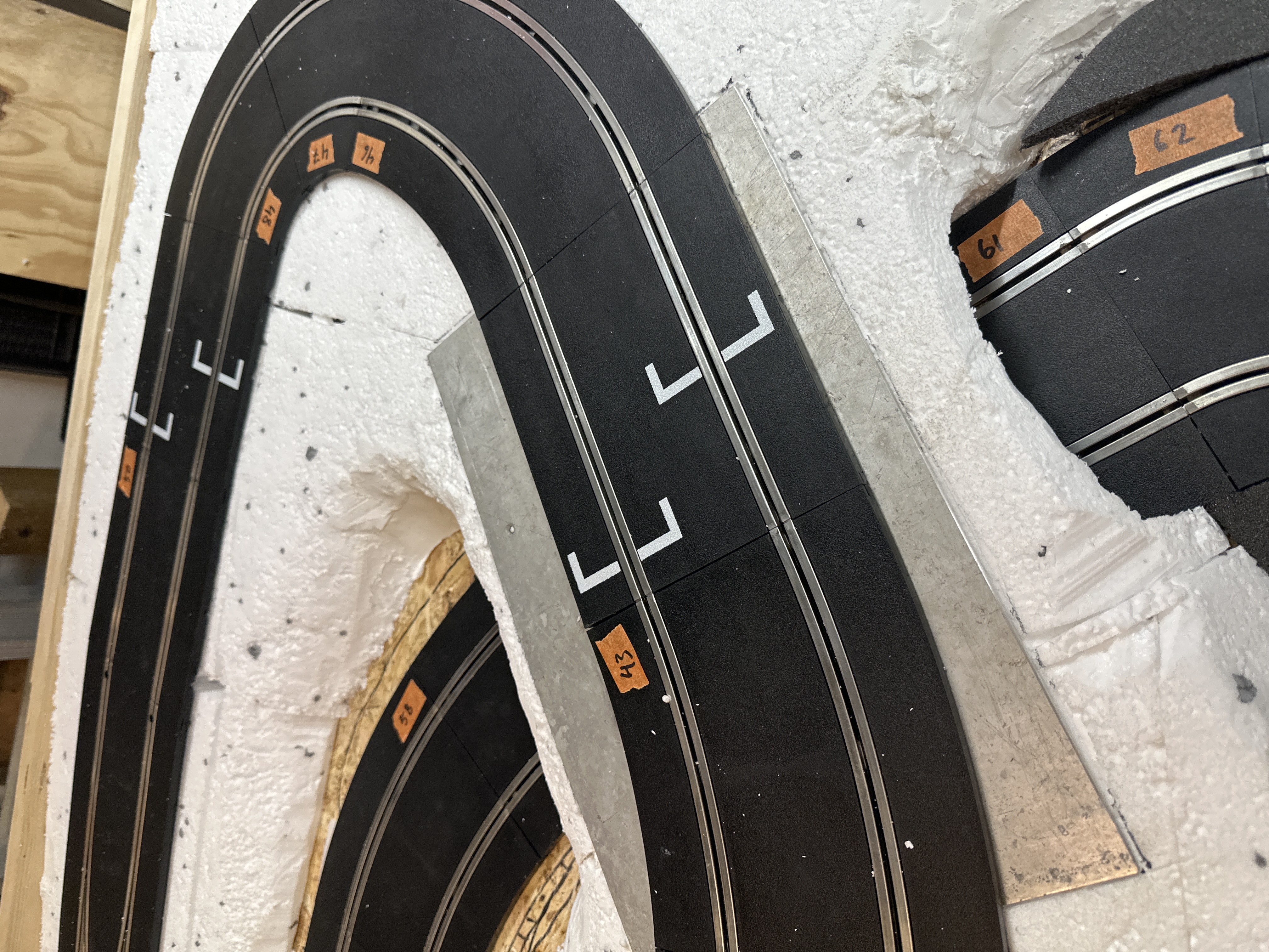

Anyone got experience with removing paint from Scalextric track pieces? I have used start lane pieces in the middle of the track and want to remove the paint.
Suspecting that solvents might damage the plastic?

I did it, for a similar reason, but it was 10 years ago now and my memory isn't the best.  Try laying a piece of plain white kitchen roll on the track, dribble meths or isopropyl alcohol onto the paper and leave it for 5 minutes.  Then remove the paper and rub at the print with Scotchbrite, or similar.

Just the stuff I have on shelf too. Thanks! Will try and report back.

(31st-Jan-24, 03:03 AM)chappyman66 Wrote:  Or use a large black magic marker.....
The black markers I've tried leaves a weird shimmering effect in the plastic :(
