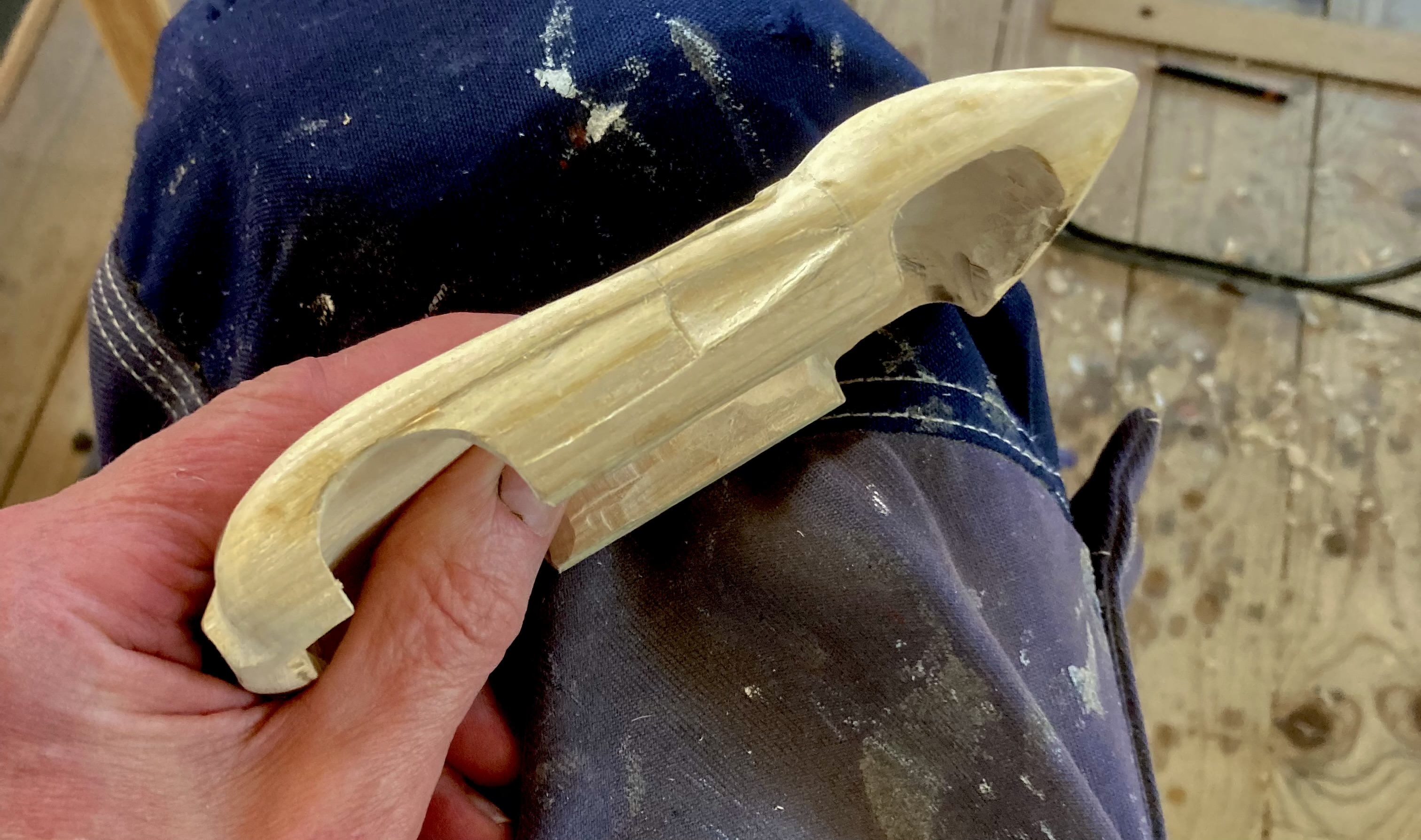

Working on the tricky side panels.

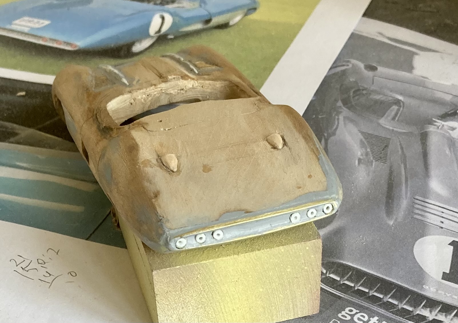

Coming on slowly, I am in no hurry. Time

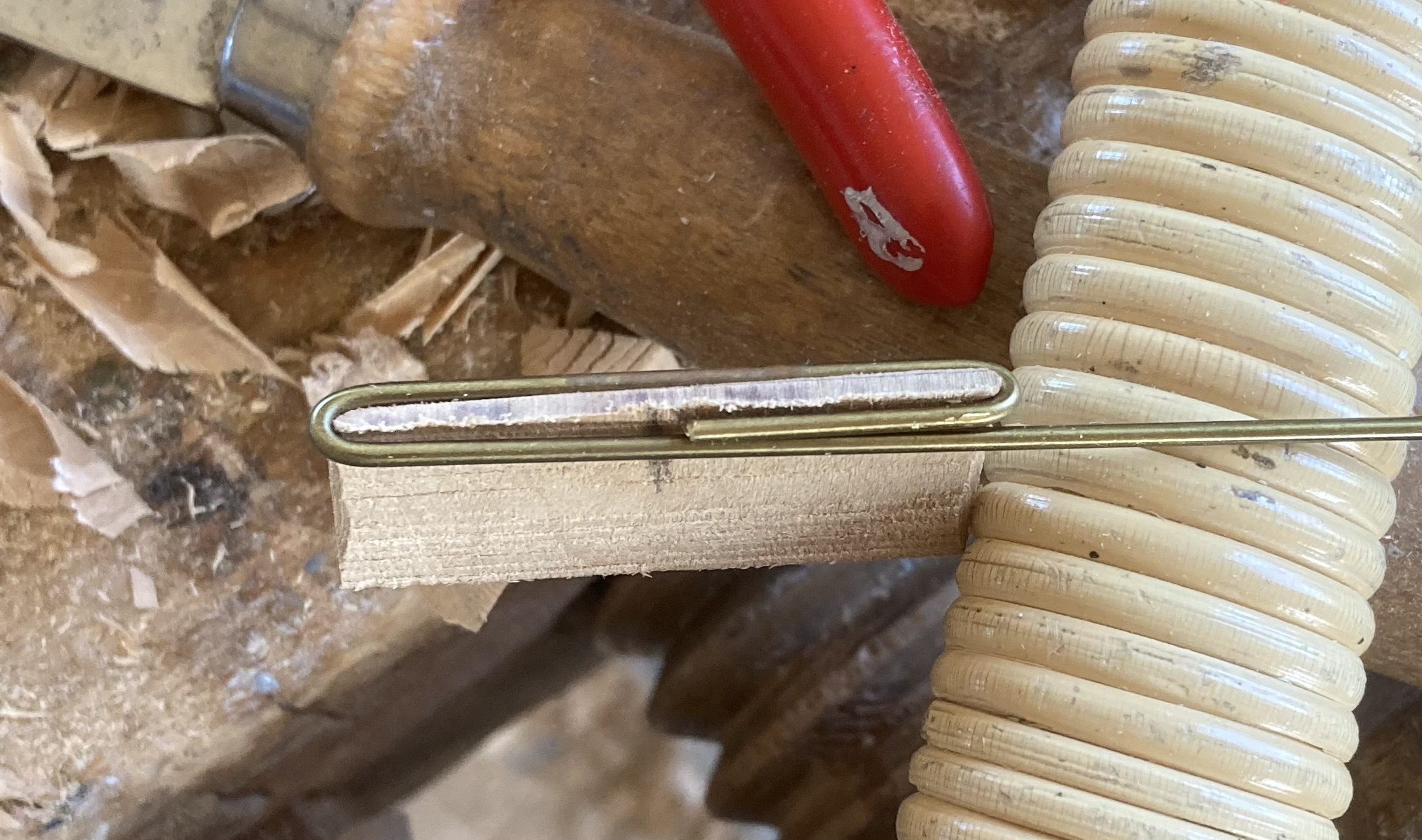

For the sharp tail, I could not use only wood.
A piece of 1,5mm brass was bent...
...and then glued on and shaped. More to do inside the frame.

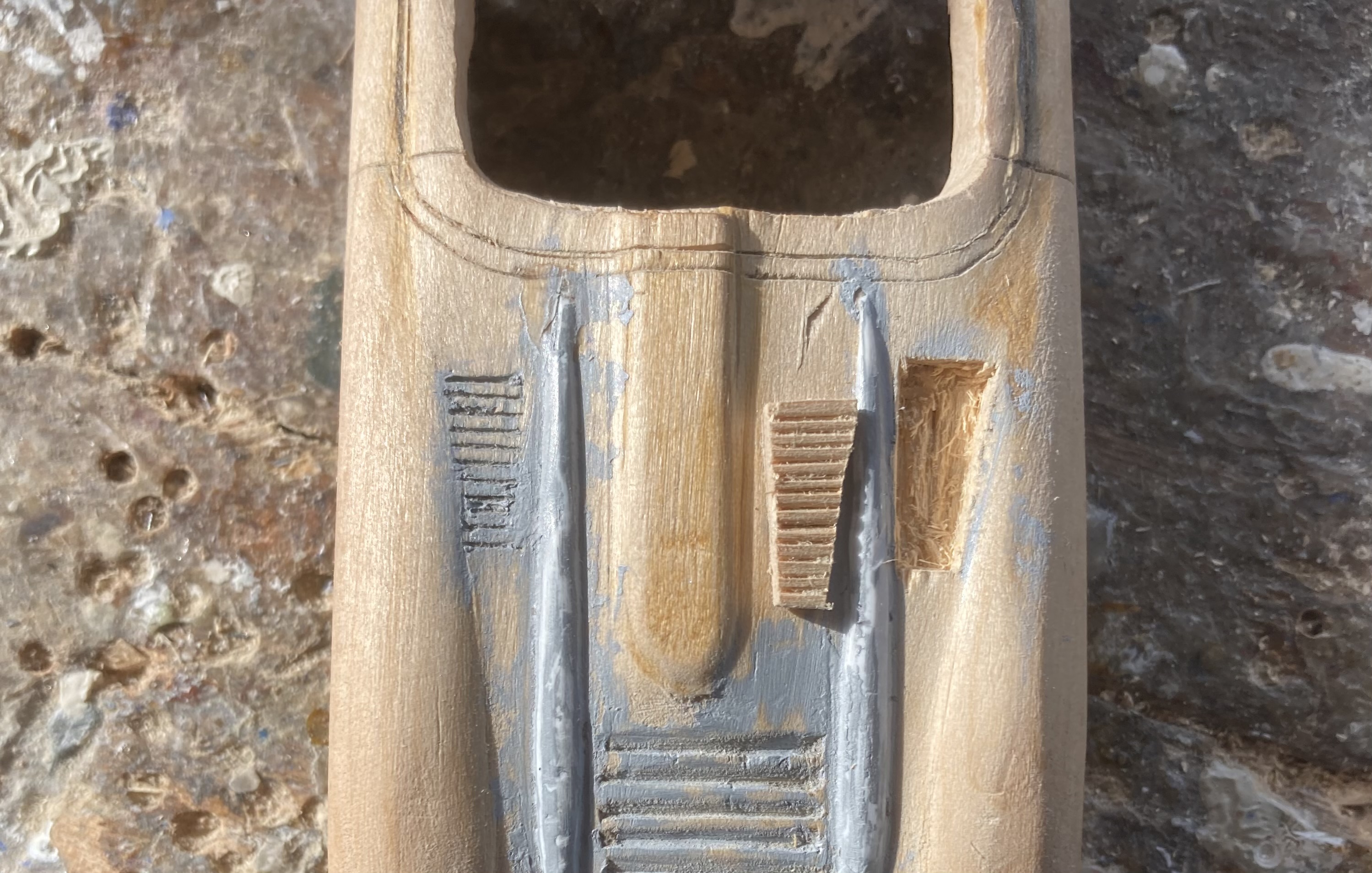

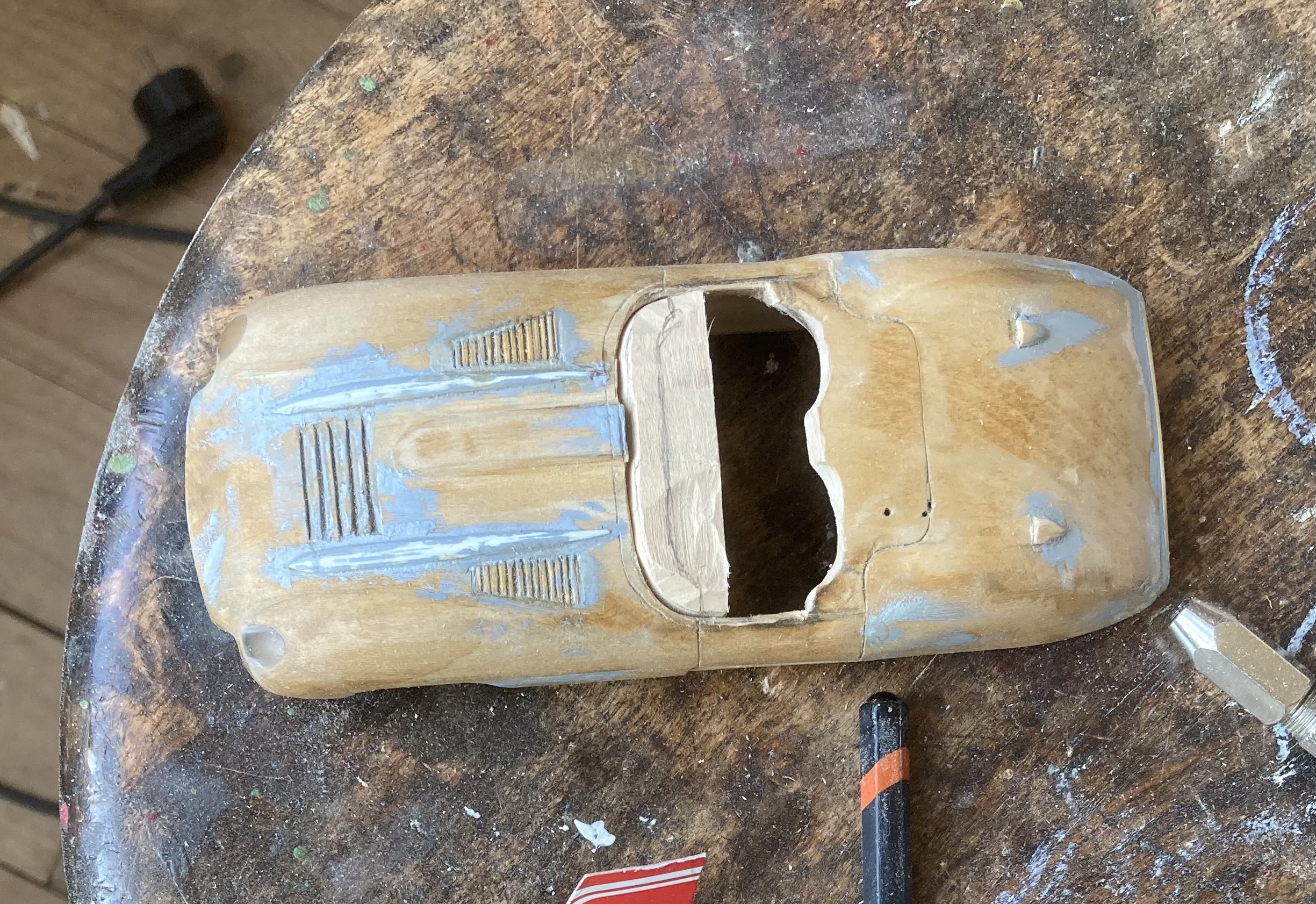

With a little luck, I often find a suitable piece of plastic for louvres, but not this time.
Trying to make the smaller louvres cross-grain was not a brilliant idea! Tappingfoot
 I cut out and laid down small bits grained in the other direction instead.

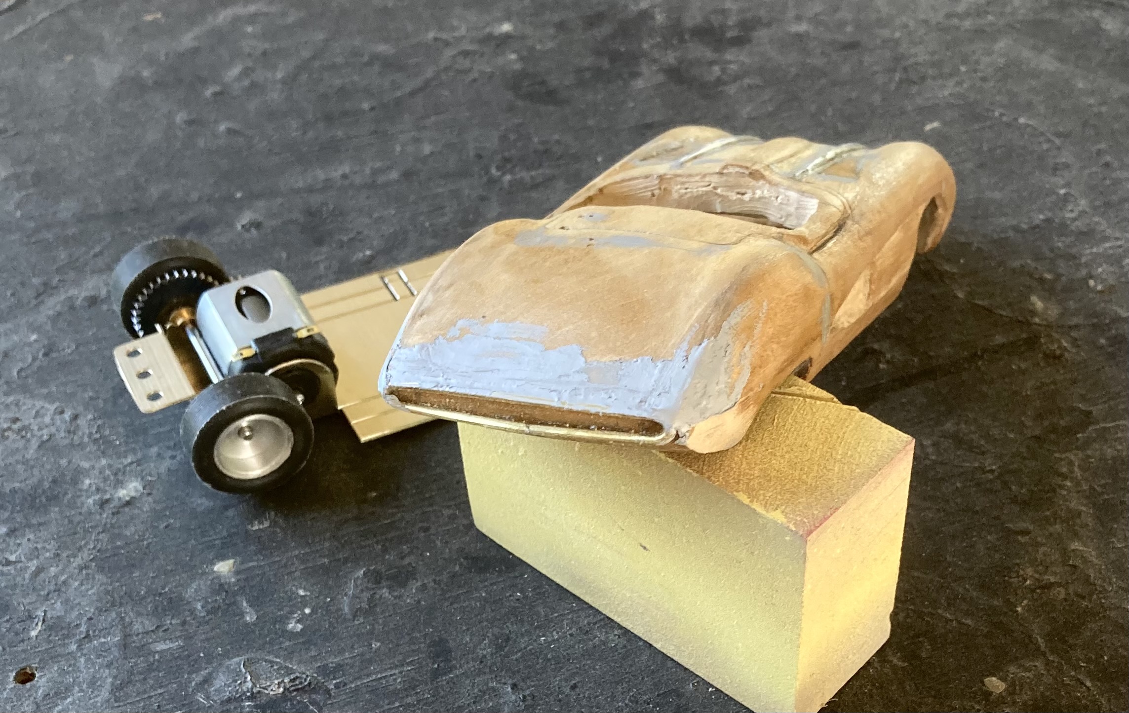

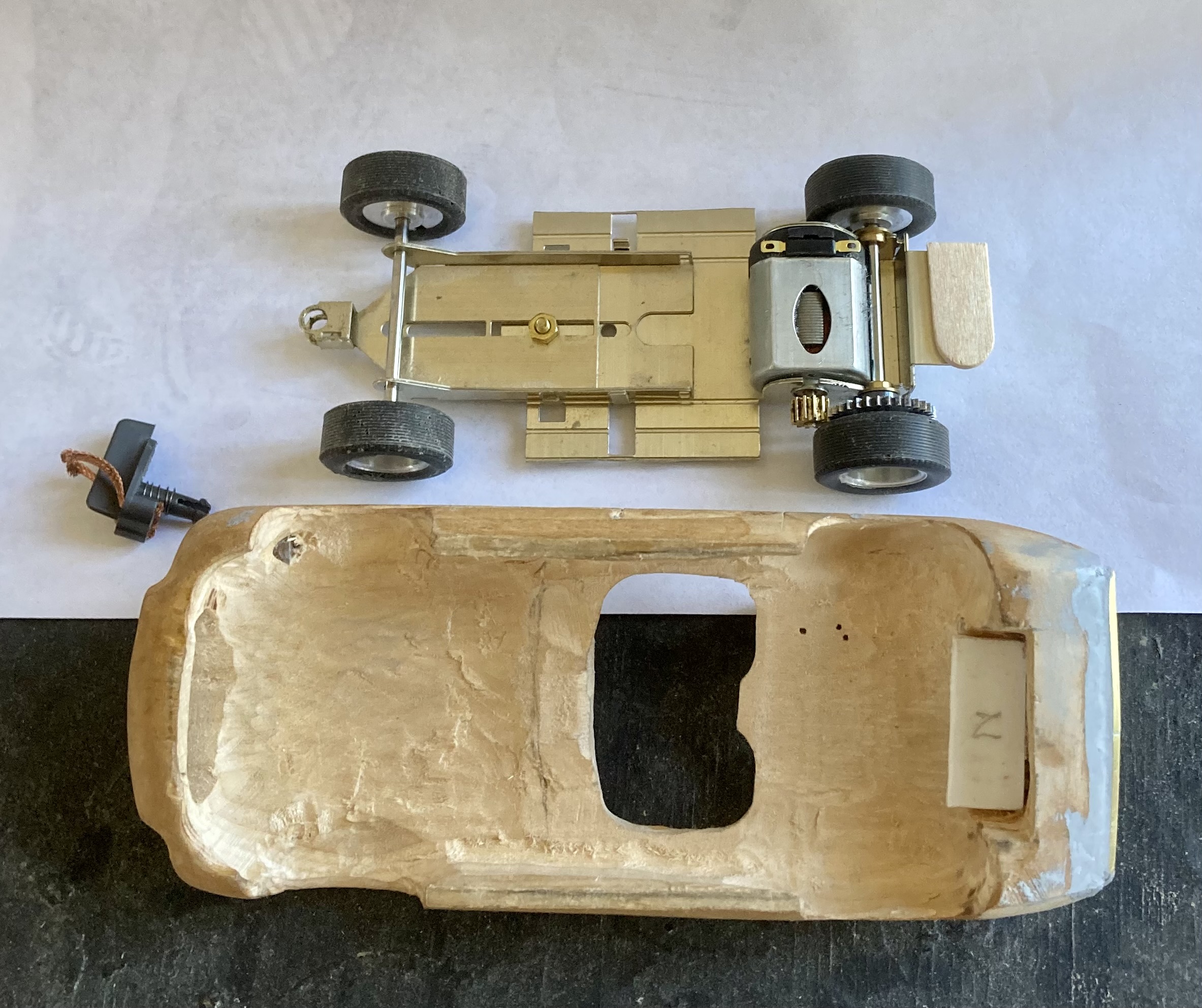

For the chassis, I am using an old PPL sidewinder that has been laying around too long.

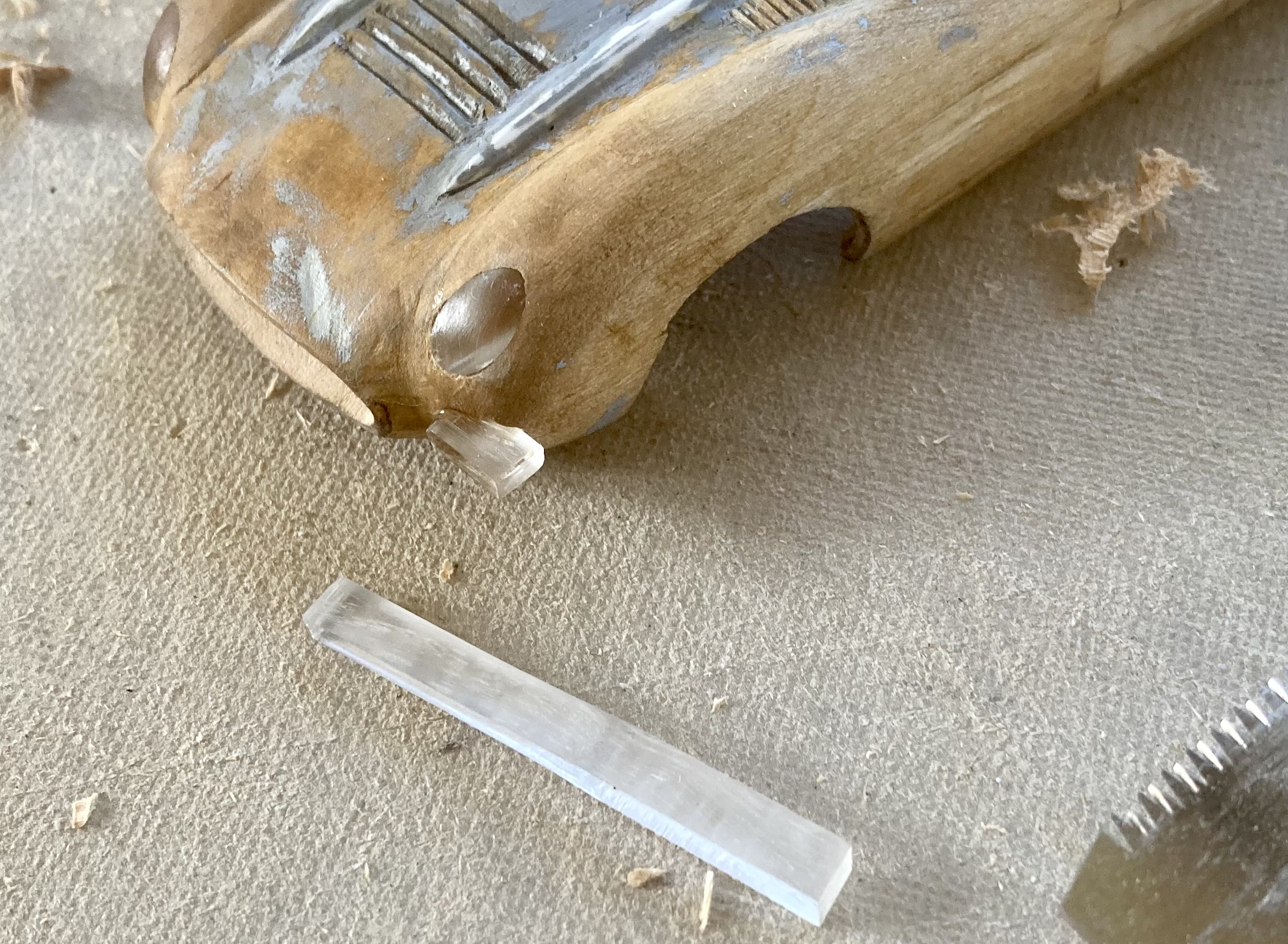

Making blinkers of acrylic glass...
...and detailing the tail.

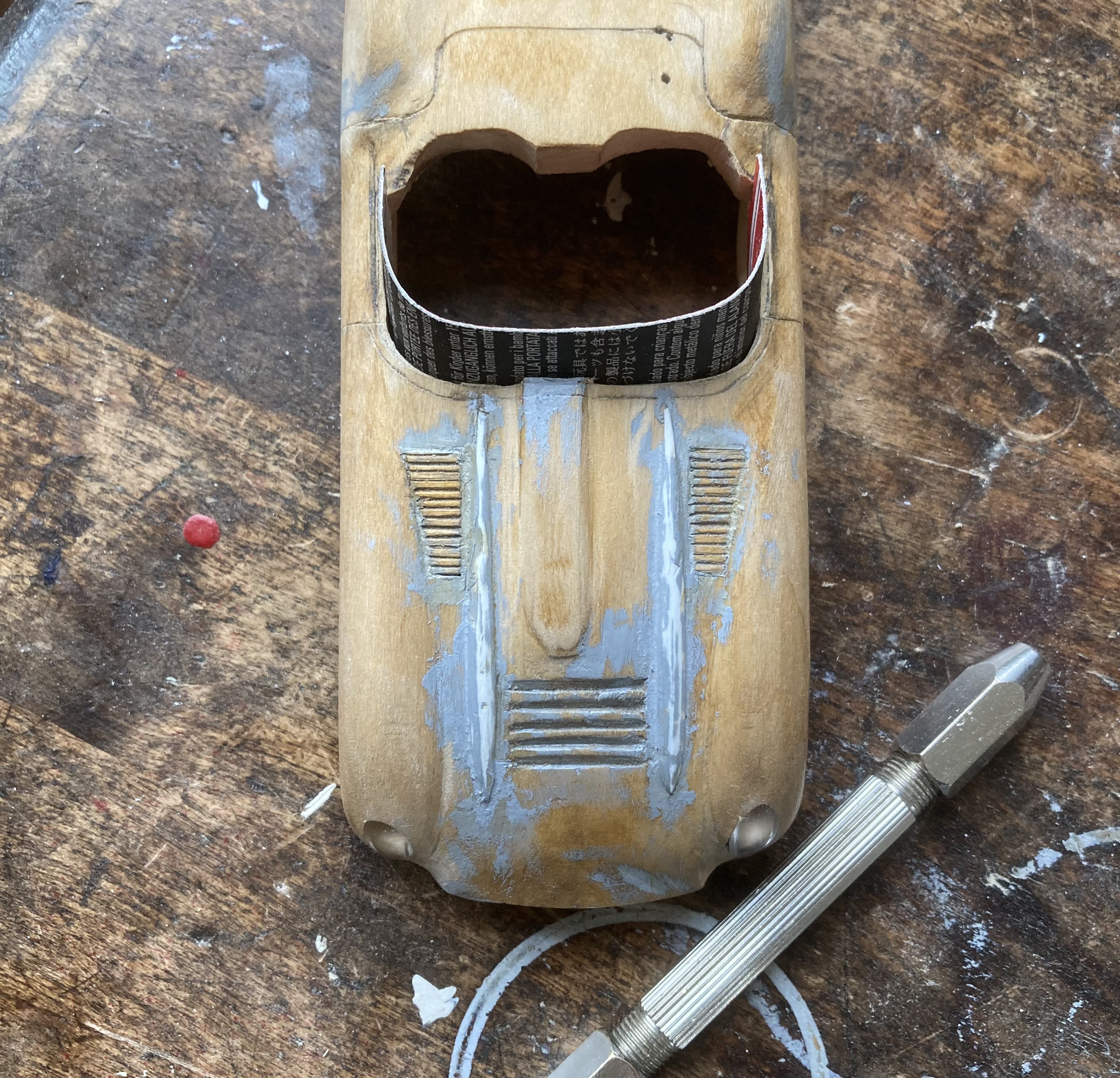

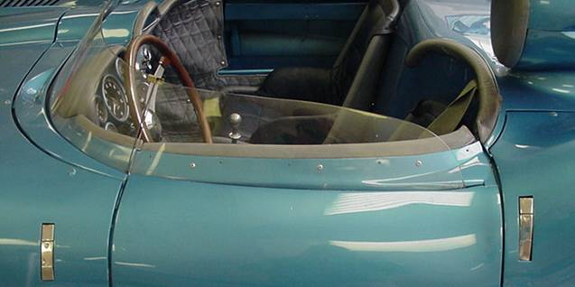

I often mess up my builds when it comes to mounting the screens. The way this car looks...
...makes me quite sure I can't get a nice fit if mounting the screen on top of the body.
So I've cut away the body part behind the screen, and made a slanted opening for the screen, to be mounted from the inside.
Testing with a piece of paper.
I will finally carve small wooden pieces to fit inside.
