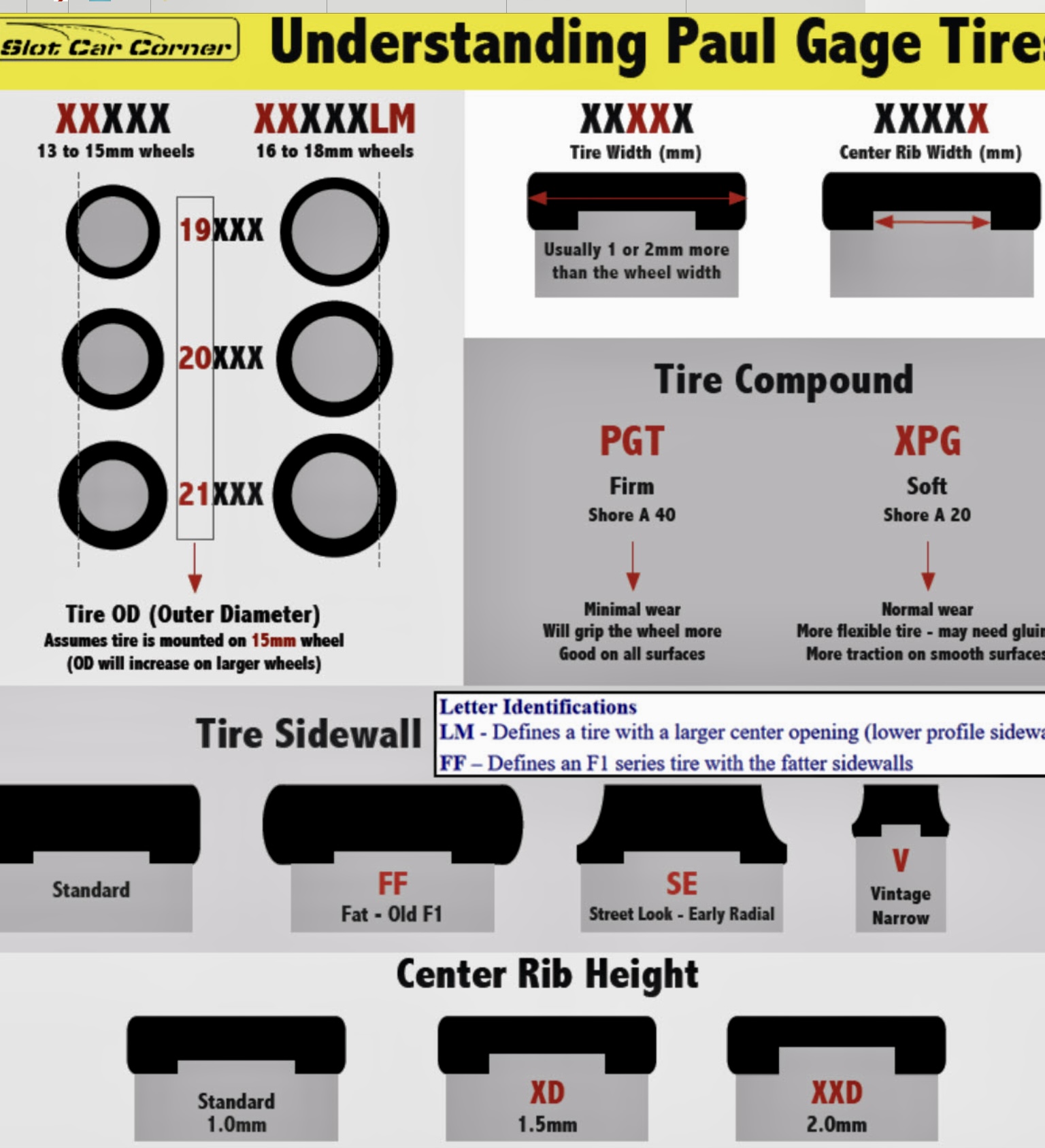

Any lessons on how to determine correct tyre size for a given wheel?
I love puttering with gears
https://slotcarcorner.com/pages/paul-gage-tires
The www.slotcarcorner.com link will take you to Paul Gauge the chart should also help
21125 XPG would be an example of a PG
21 mm in diameter 12mm wide with a center rib opening of 5mm in a 20 shore compound
Hope this helps

I still don't understand it....it's got numbers on it. I don't do numbers.
I too buy from Slotcarstyres and he has nice pictures of the car alongside the tyres. A dummy like me can understand that as it reflects my reading age Bigsmile

That's no good when you have a set of alloys that you're wanting tyres for, diameter + width + rib width seems simple enough, just measure your wheels.
Gordon, use the link, you can pick based on the car your wish to re tyre.  PM me if you need additional help.
He does have a section with measurements as well that I have used for some wheels my brother in  law made me. But again, there are diagrams with the dimensions to help dummies like me.
I just like things simple.
