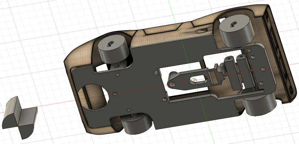

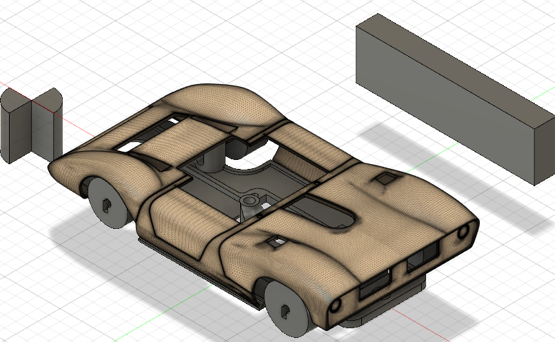

You have many scale options to choose from, the 1/32 one was way too thick, the 1/24 one when scaled down to 1/32 has a wall of 1mm so willing to give that a go in resin.
SlotIt SW pod is my preference for such a big beastie, the body is 70mm wide at the maximum (2.24m wide the full sized version).

This will be built to our Sport rules, 12mm max width tyres and 64mm overall width across the outsides of the tyre sidewalls, the image shows the wheels/tyres at the max width allowed.
NSR Moslers are 65mm wide but again we stipulate 64mm across the tyres.

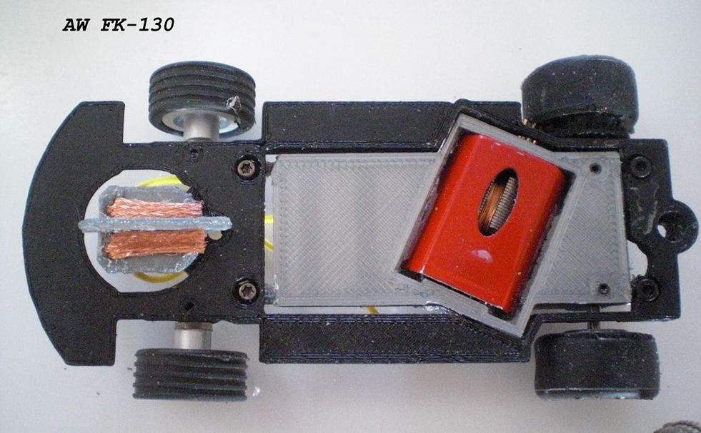

I make AW for FK130
Trouble is that one is specific to the chassis you have put it in if you put that in a slot it chassis it will leave gaps everywhere as a slot it anglewinder pod is designed for a boxer or flat 6 which is much bigger than an fk 130 to be a direct fit for slot it it would need a redisign ,looks like quite a good chassis though
All my chassis are designed for SW or IL Slot.it pods as I don't like AW setups.
