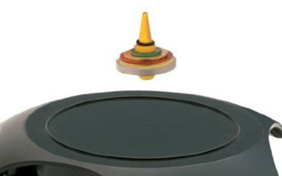

I doubt that "magnetic drag" between the motor and axle is a real thing. If the motor's magnets really were able to induce eddy currents in the axle, creating a drag force, the Levitron device wouldn't work.
