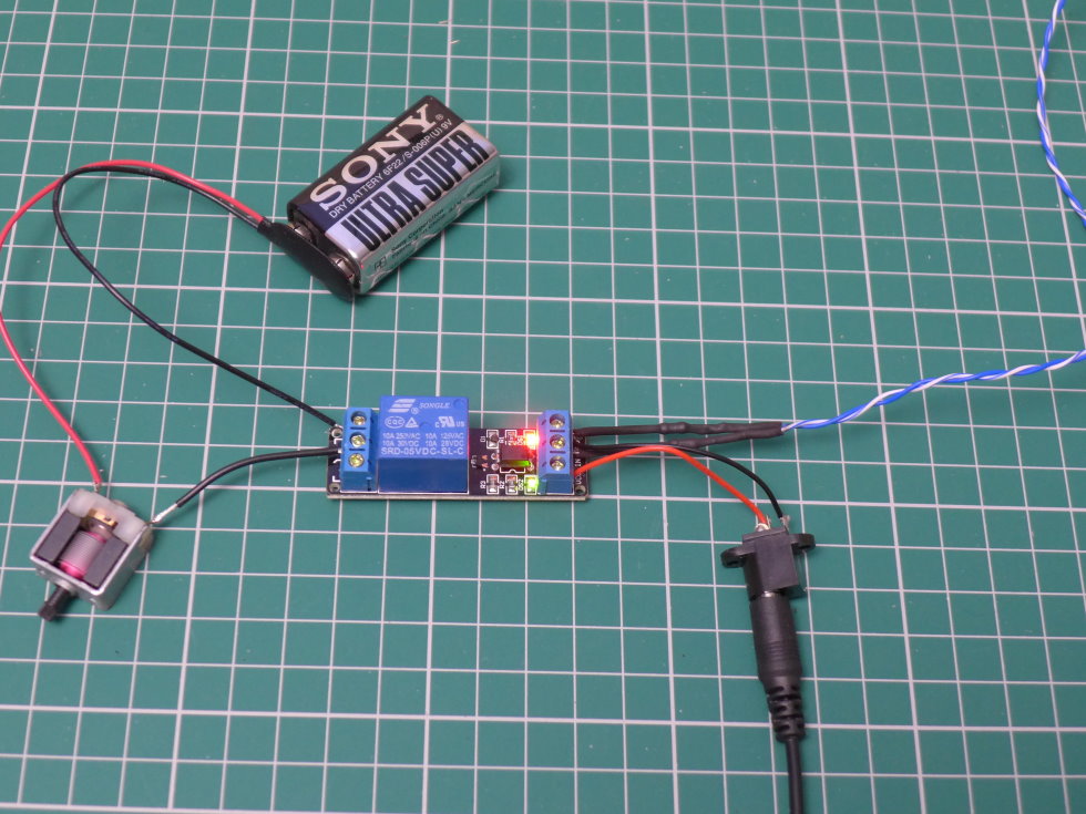

A bit further down the page on Greg's site is this diagram for using an old-fashioned solid-state relay...
Those pins should work with a modern day relay module like this one...
