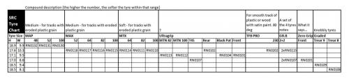

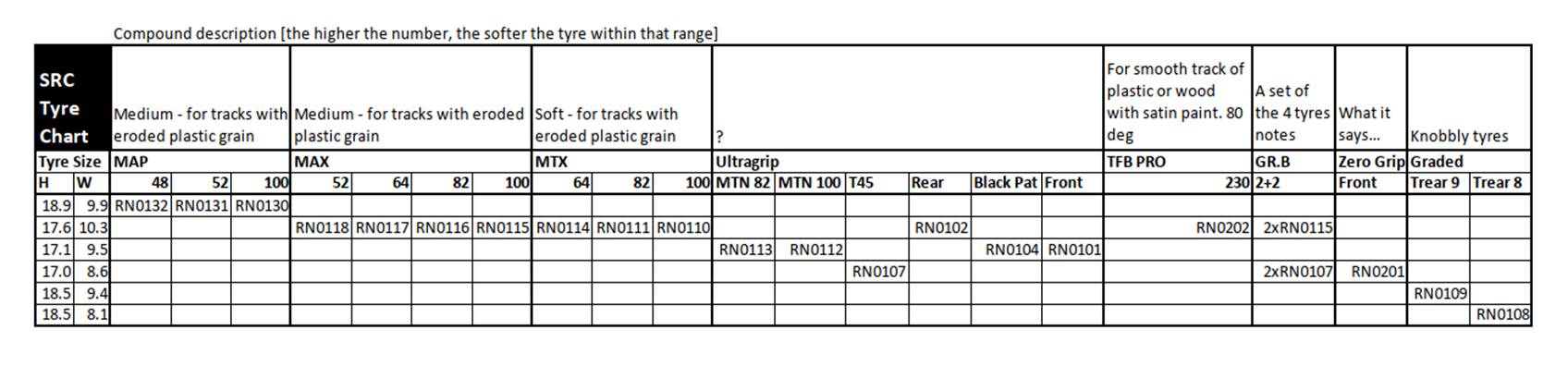

Any excuse to show off my SRC tyre chart...
I love puttering with gears
[+] 2 members Like BARacer's post
Hi Jeremy,
You have put a lot of work into your enlightening tyre chart.
It wouldn't be nice if I appropriated your work for publication in the magazine.
I did make a table of the test results.
Hub Thumbup
