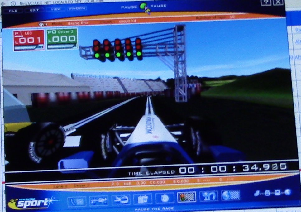

I set up a small test track earlier and tried a few things from the PC. Race formats and setting power on/off options worked ok. The race formats all make sense but the user interface leaves me cold. I would like to see a clear count of laps completed or a countdown to finish but something odd happens after a few laps and the (tiny) lap count is removed.
With a 10 lap GP race set up it starts well:

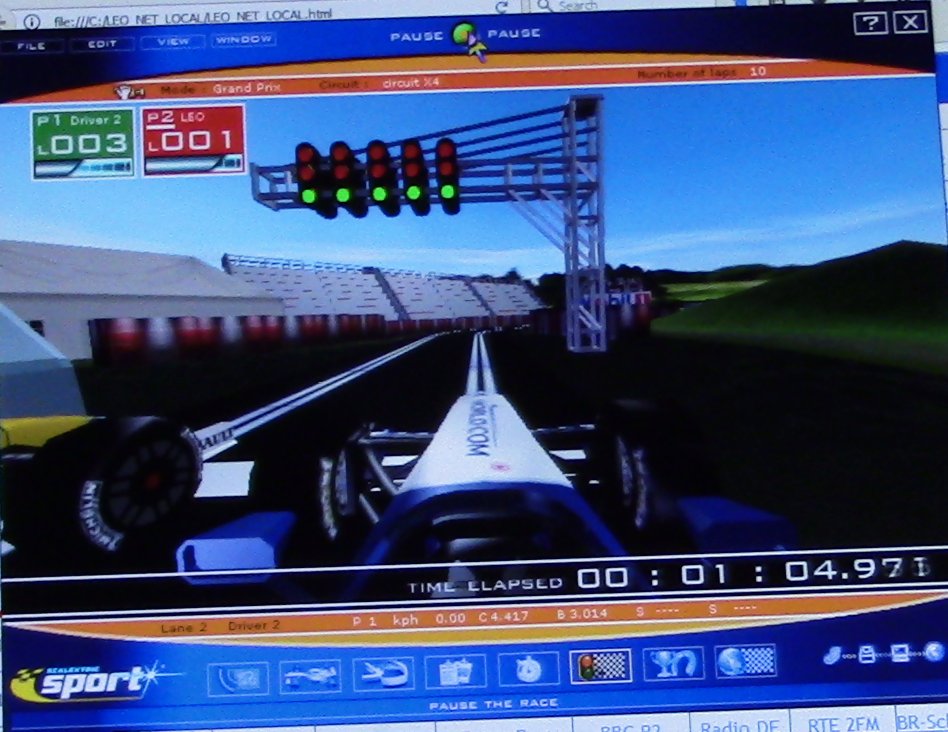

With 3 laps completed in Lane 1 and 1 lap in Lane2:

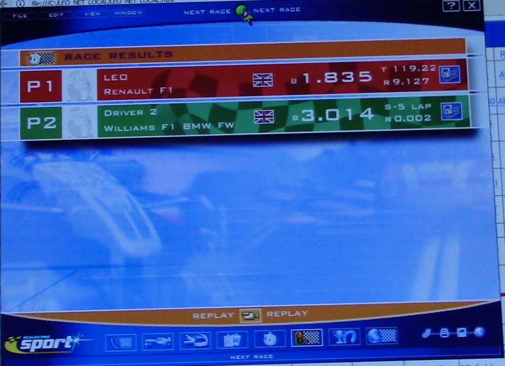

The finish screen shows how many laps the 2nd car completed.
