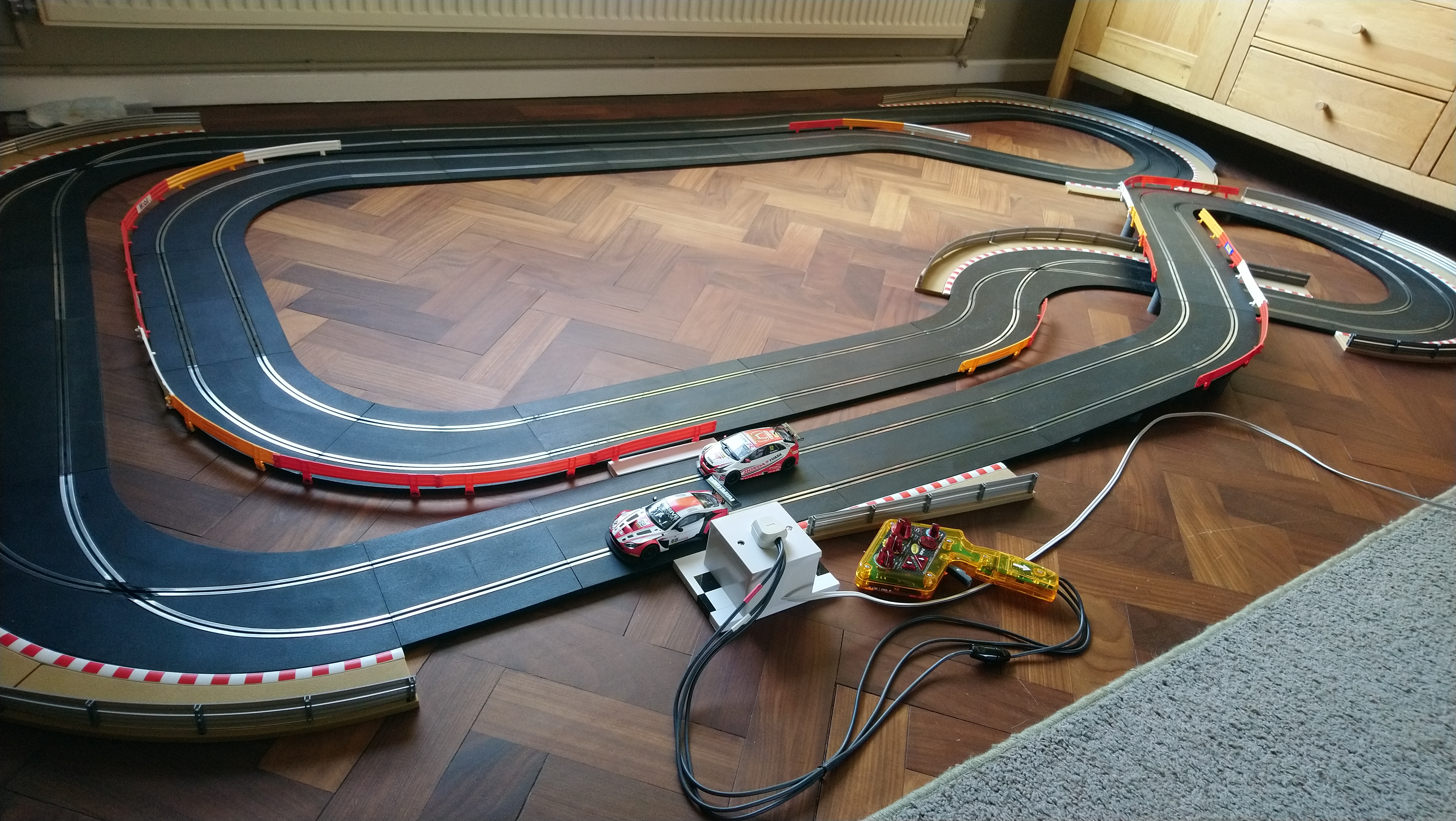

All set up with my UK Club Controller Box for some weekend proxy car tuning...
Armco barrier in place for protection!
Thank you Andy for the early birthday present!

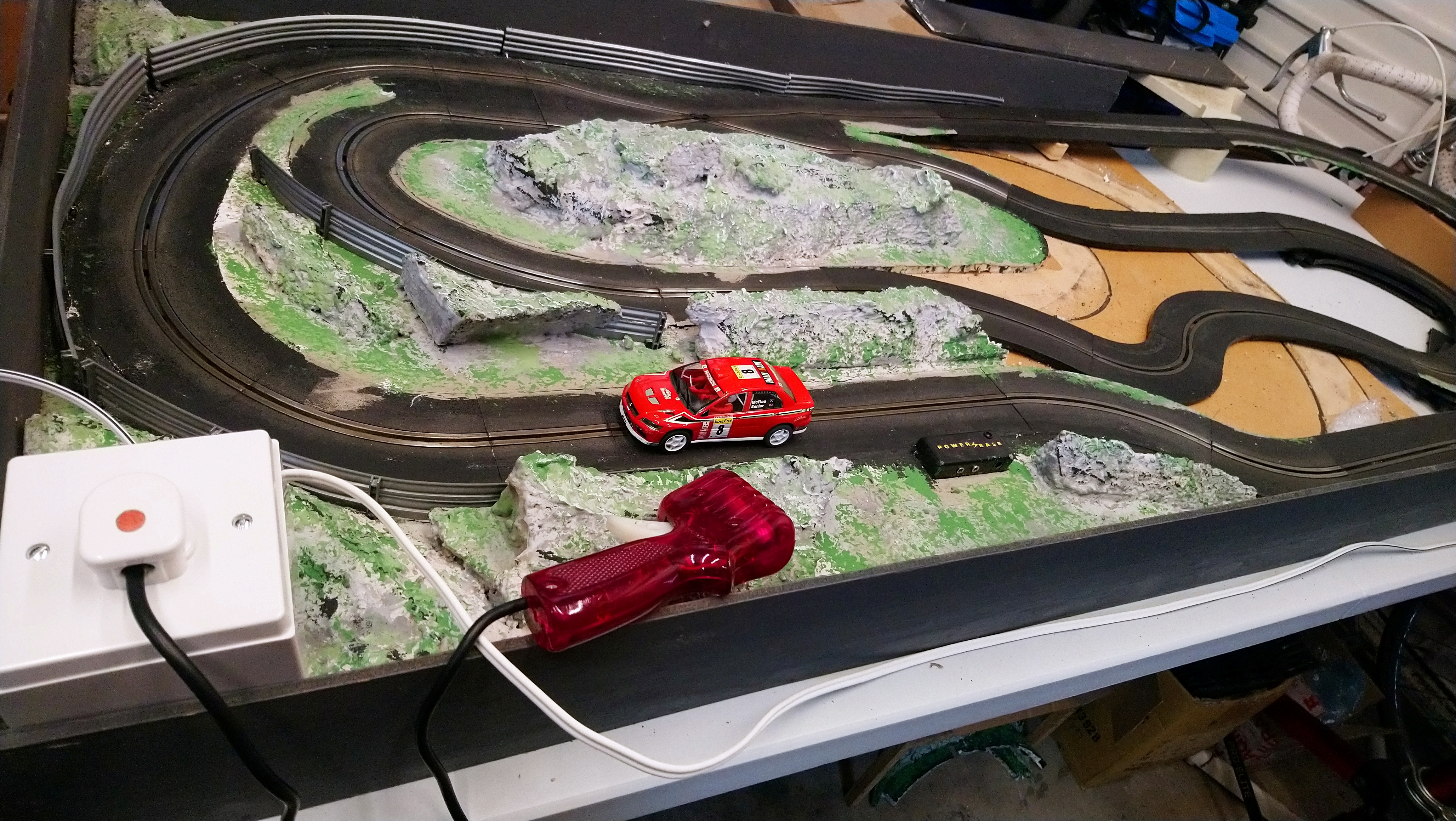

And here is the result of my morning's effort...
It's a temporary set up on the rally track at the moment, I'm going to introduce some inline sockets at the track end so I can reverse the track voltage and run the cars the other way round as well.
And it looks like it's a 60 ohm track when running standard Scalextric.
