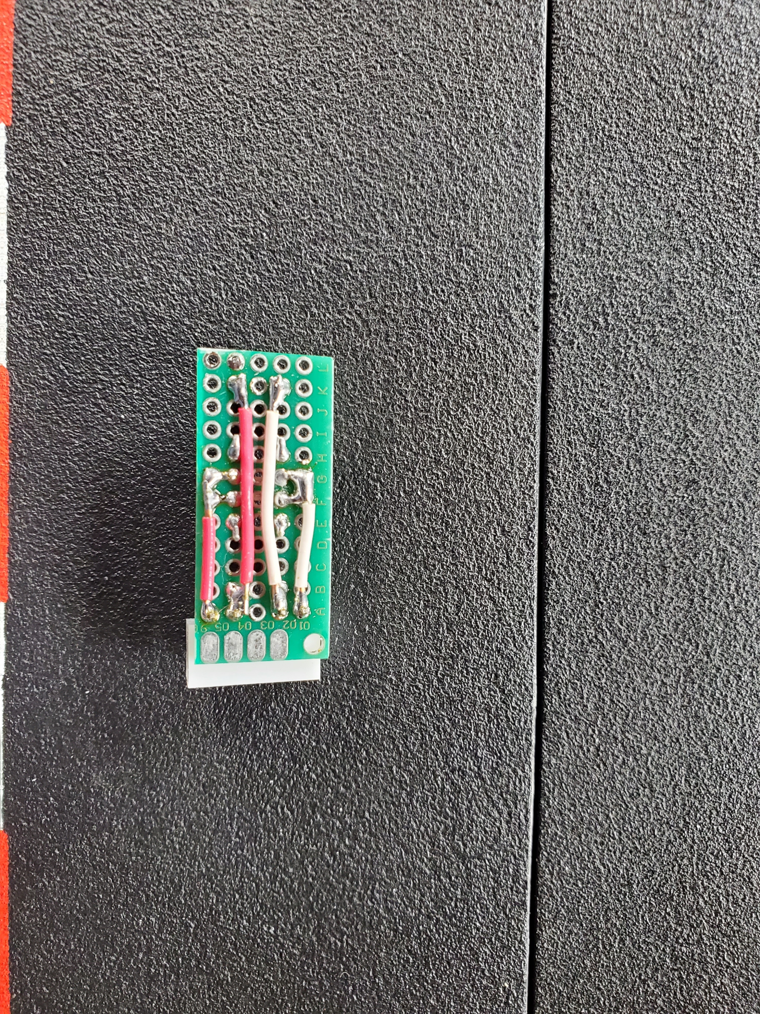

I took apart my control unit and soldered a wire to both sides of the start switch contacts and ran it out of the bottom of the track connected to the control unit. I added a male JST 2 pin connector to it so I could easily connect and disconnect to the external switches. From here I ran to a distribution block where all of the switches will connect.

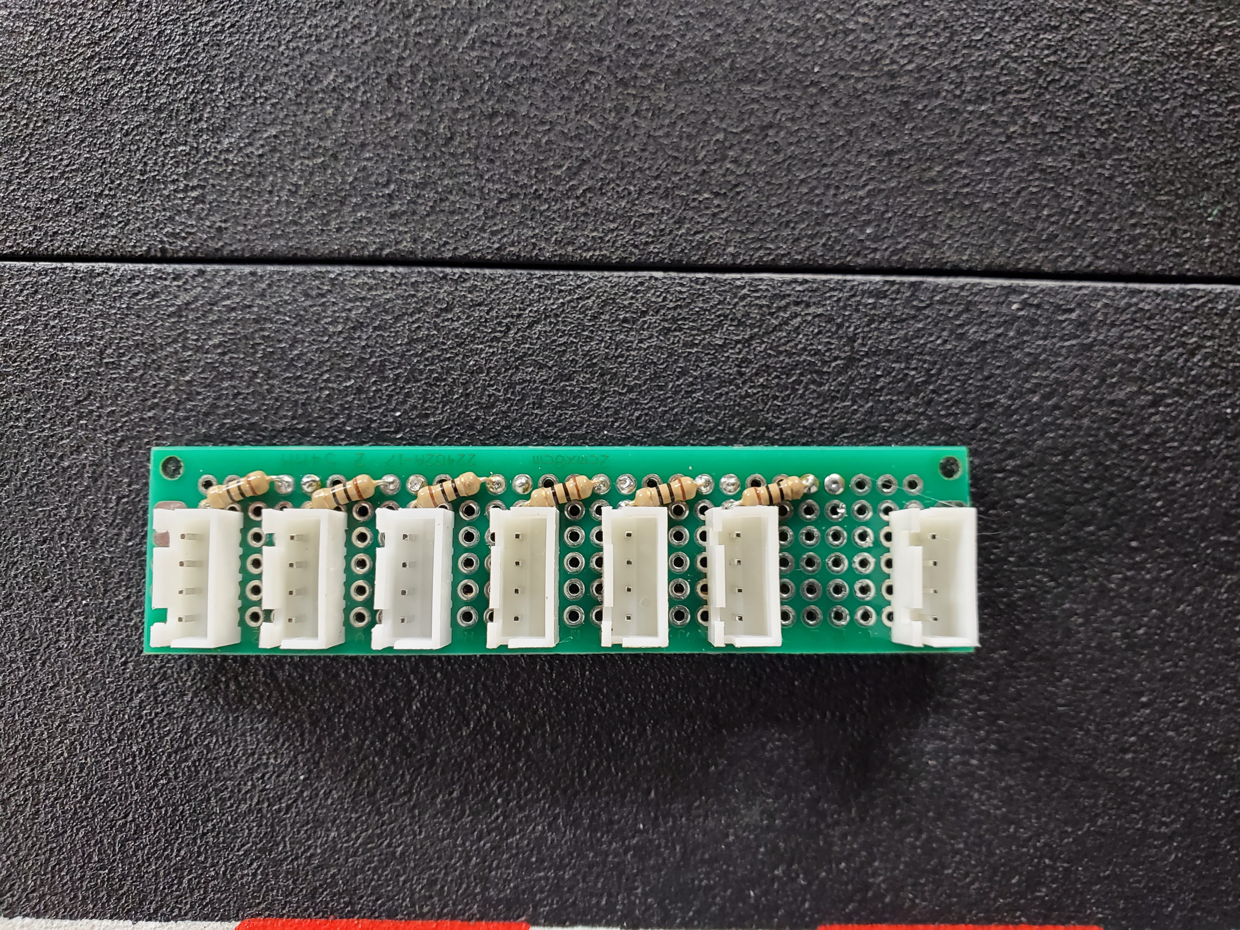

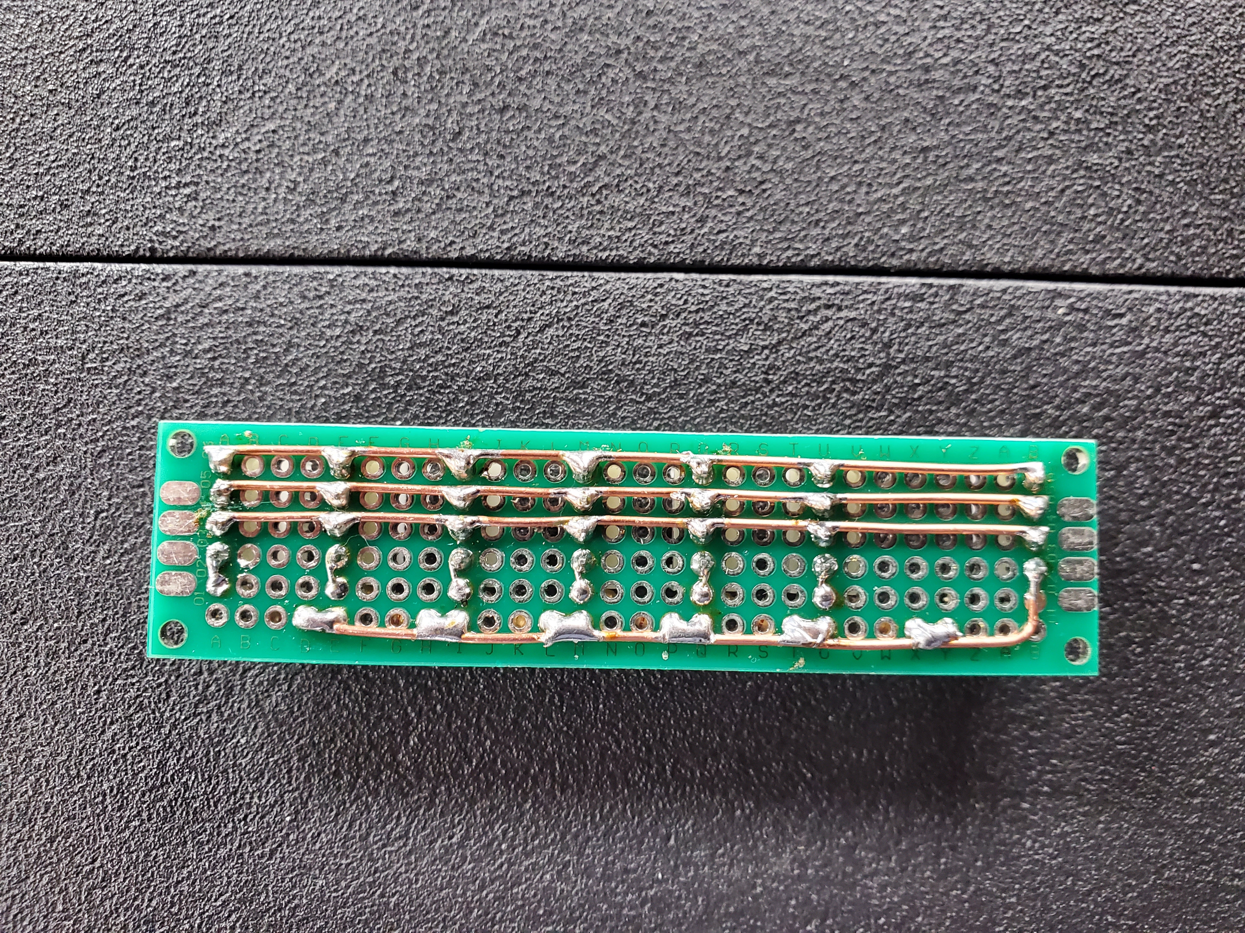

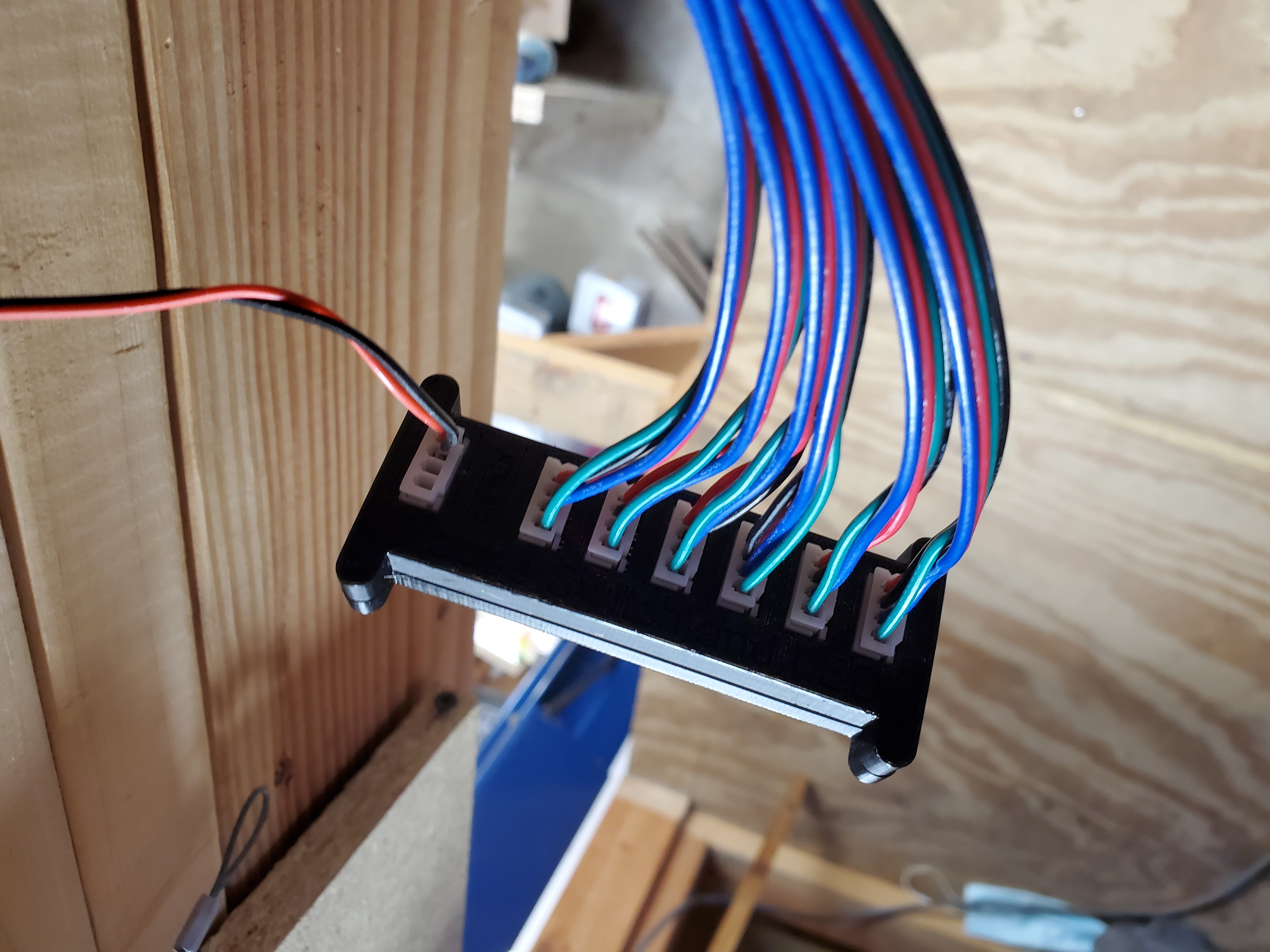

My distribution block has 4 wire connections because I will be adding a ATX power supply to my panel to use the 3.3 volt power for back lighting the switches with SMD LEDs. (Future Project) From the distribution block I run to each individual switch.

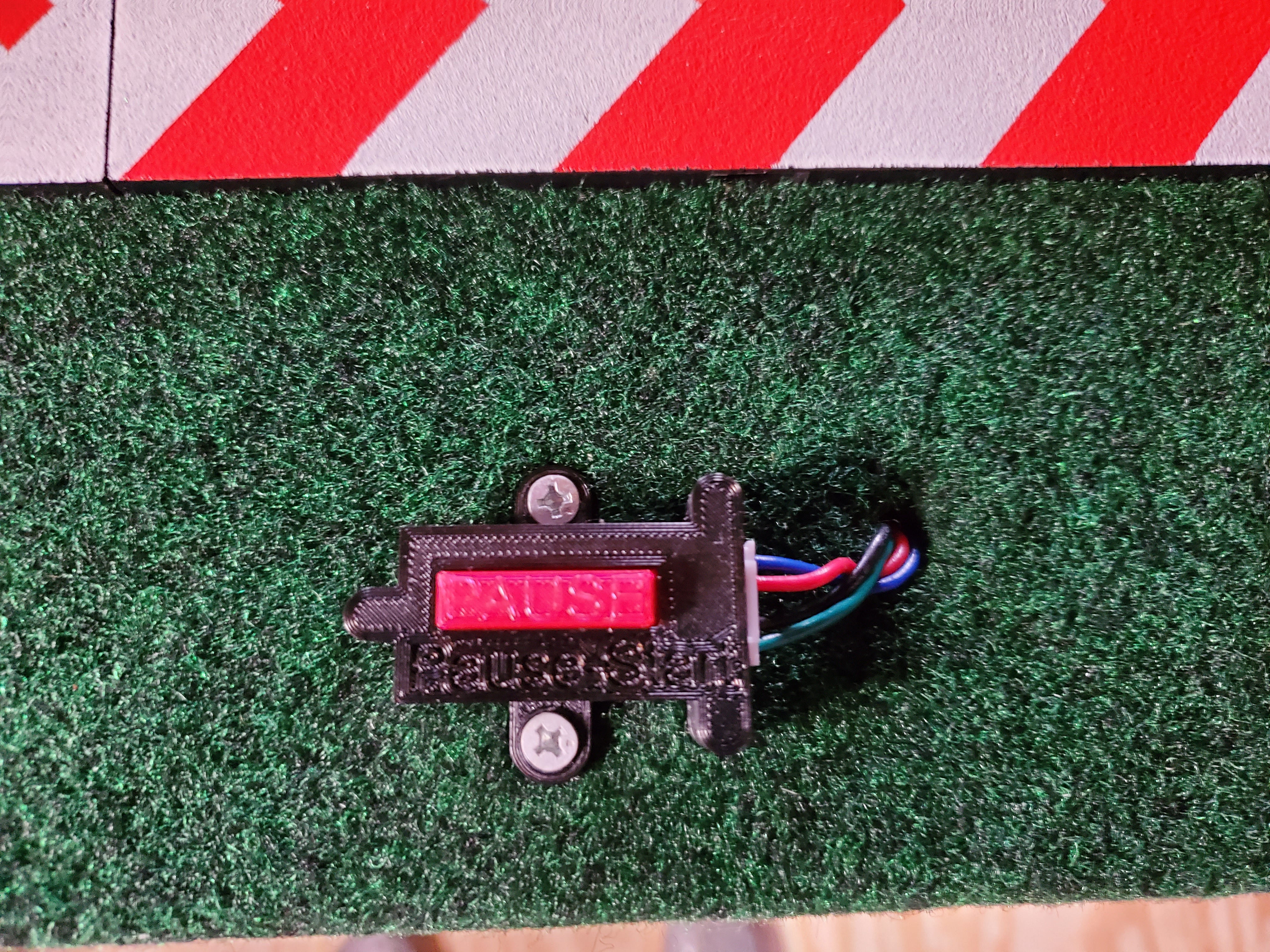

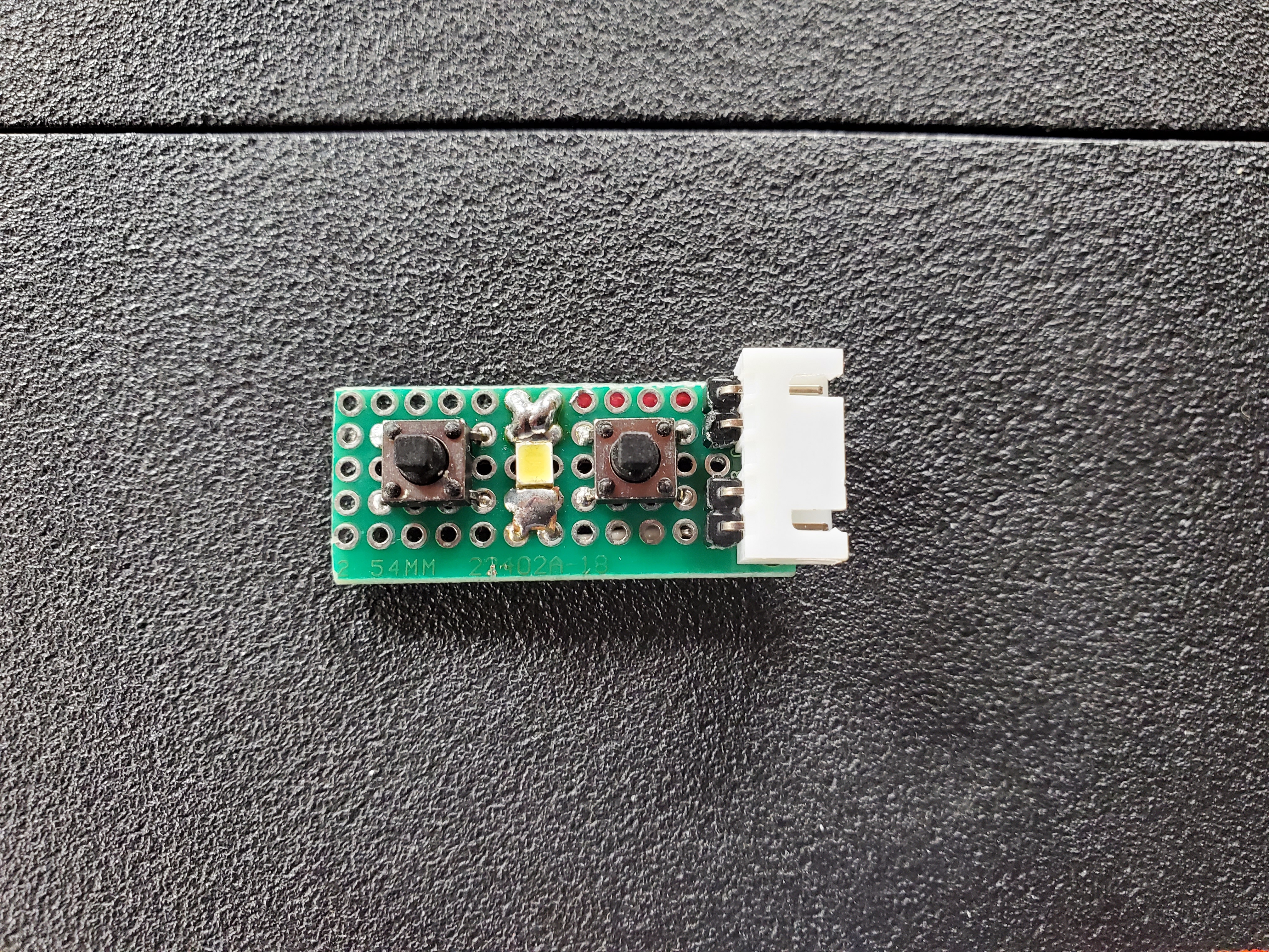

The switch is based on how Carrera does the switches for the control unit as a matter of fact the switches are from a blown up control unit. I added 6 switches, one for each driver. This now allows any driver to pause and restart the race when they crash. While this might not be for everybody, I find it very useful for racing with my kids.
