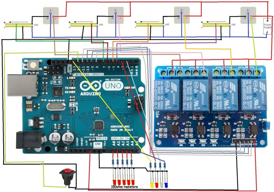

The Arduino Uno will work with Race Coordinator to count laps on up to four lanes - and control the track power via relays. Track call buttons and start light LEDs can be added very simply. For this, you will need a PC running Windows 7 or above and have an available USB port (ideally powered).
There is an extremely clear guide (with photos rather than circuit diagrams) included as a pdf in the Race Coordinator zip file (download page here: www.racecoordinator.net/download). Once the files are extracted, you are looking for Race Coordinator > data > arduino > lap counter - and then in that folder are the pdf guide and the 'sketch' that is the program you upload to the Arduino board so it works with Race Coordinator.
The pdf document walks you through how to wire up the Arduino board with various sensors - phototransistors, reed switches, slotted sensors and dead strip. The dead strip instructions are incomplete - but I'll add to those in a minute (it's what I used). The diagrams also show how to add a power relay for each lane, a track call button and external LED start lights. It is very straightforward.
The dead strip option is more problematic and you don't really want to wire the dead strip direct to the Arduino input. A dead strip can create spikes of current that can damage a board. The pdf simply states "It’s important that steps are taken to ensure that no more than 5v can ever reach the Arduino input." The easiest way of doing this is to route the signal via a single channel opto-isolated relay board (eg Bitsbox here). The optocoupler circuit isolates the relay from the input signal and the output from the relay triggers the Arduino input perfectly safely. This is what my set-up looks like...
I did add 150-ohm resistors to each of the cables coming from the dead strip. Probably not essential, but it's added protection.

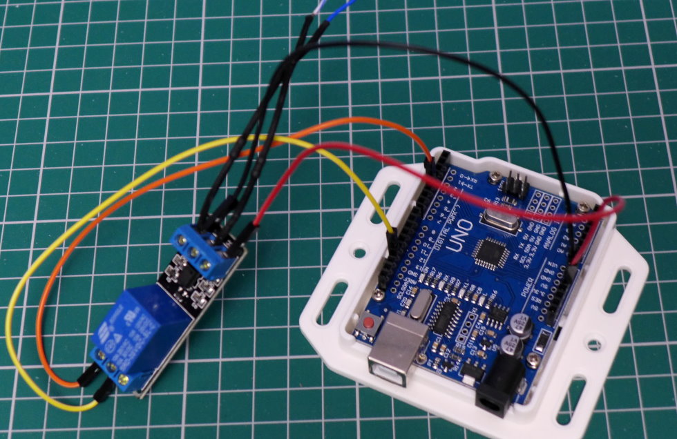

The relay is powered directly from the Arduino Uno (so you'll want a 5 volt relay board) and the Arduino is powered via the same USB data cable that links to your computer. If you're using a laptop, a separate 5v DC supply might be better if the USB ports aren't putting out the full 500mA.

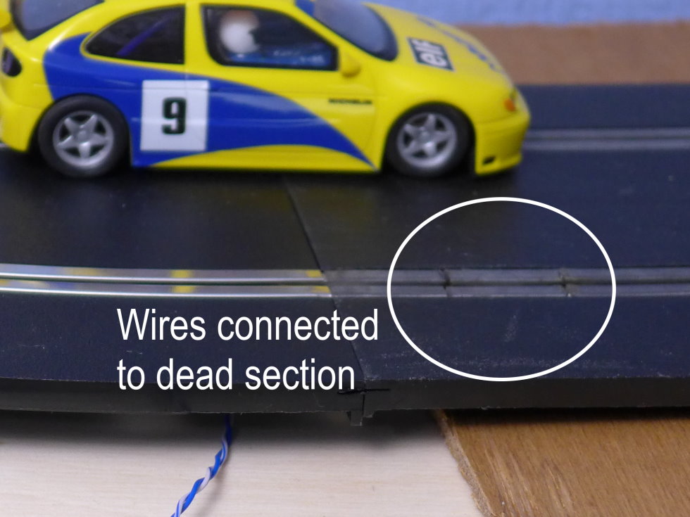

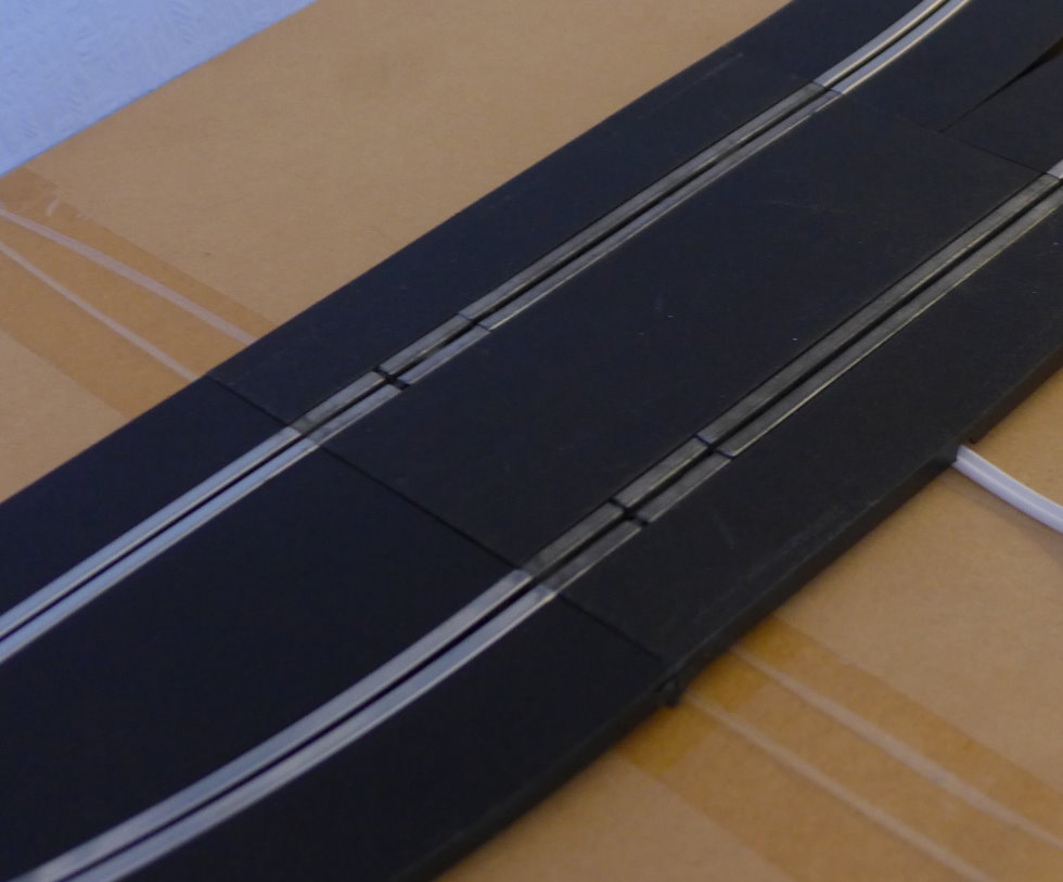

I created the dead strip by removing the rails from the track, then made two cuts - 1-inch apart and either side of a tab - using a cutting disc on my Dremel. I tidied up and smoothed the cut edges with a file. When reinstalled, this gave an isolated 1-inch 'dead strip' on each lane...
I then used some contact adhesive to glue the rail to the track and tightened the tabs underneath. I also clamped a piece of mdf on the top to make sure everything was flat as the glue set. Gluing ensures the cut edges of the rails do not lift and catch the guide or braids of a car. It also maintains the isolating gap. Finally, I soldered some thin wires (I used a Cat5e twisted pair) to the tab of each dead strip rail underneath the track. These wires attached - via a 150-ohm resistor - to the input of the opto-isolated relay board. When a car crosses the dead strip, it both closes the circuit and creates a current which triggers the relay board to signal the Arduino input for that lane. The Uno has inputs for up to four lanes using Race Coordinator.

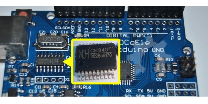

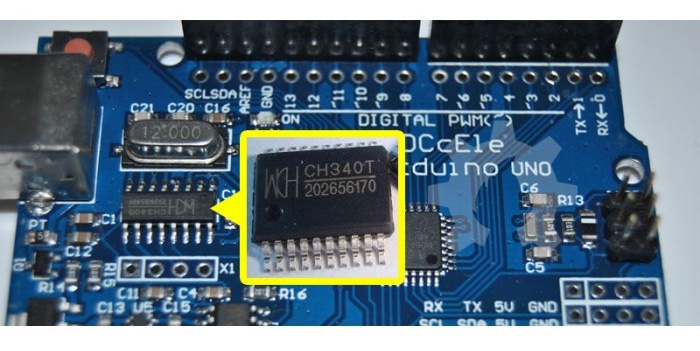

- Most Uno clones use the CH340 chip for USB communication and the driver must be installed to your computer (chip manufacturer's site here).
- Attach your Arduino Uno clone to the USB port on your computer you will be routinely using. It should power up and be recognised via the CH340 driver.
- Check in the IDE window that your Uno clone is recognised (tools> Board> "Arduino Uno") and linked with a port (tools > port> COM).
- Check in Device Manager (settings> devices in Windows 10) on your computer that the Uno is showing as "USB-SERIAL CH340 (COM_)" where the COM port matches that in the IDE tools menu.
