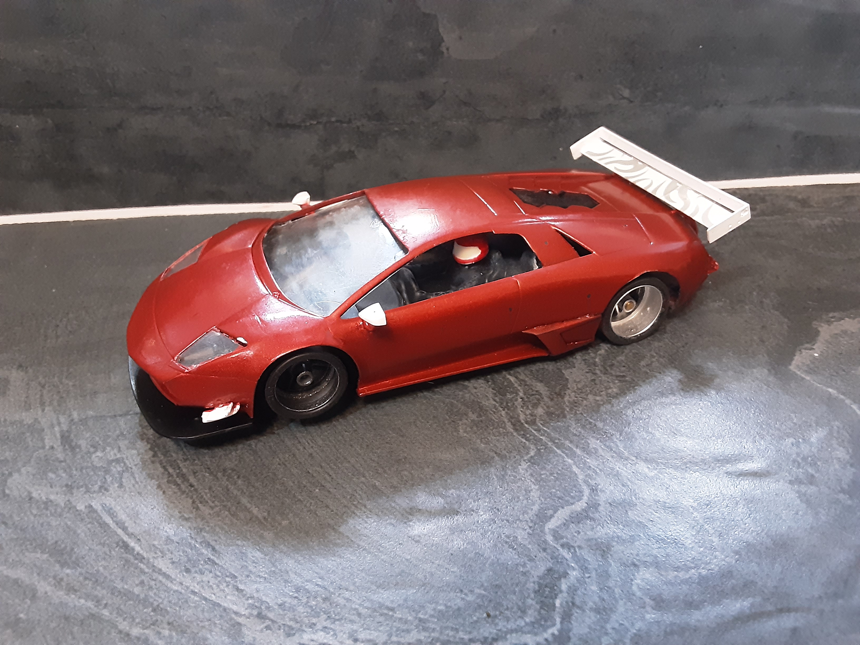

Update 2022.
Revisiting the Black bull
A year since I built the Black bull kit.
Changes at LondonSlotCarClub left me looking for cars into which I could fit a handful of NSR king30 motors.
King 30 are no longer permitted for "class b" inline racing.
I did just "too good" a job of proving that inline king30 as an unbeatable weapon (in many classes) last year.
Added to that , the knowledge that the factory fitted Sioux motor (anglewinder) was no match for an inline mosler with a King25 led me to rethink where I could use this car.
The inline motor mount for black arrow doesn't look as well thought out as the Anglewinder.
The solution is to step the Black Bull up to "sportscar" class.
Very high power anglewinders are permitted.
This pits the Black Bull directly againt NSRmoslers, very formidable opponents.
So, a complete stripdown and a repaint was on the table.
To complement the king30 , an nsr 12 tooth pinion was fitted.
Initial testing showed that the 13 tooth was too long for LSC.
If it's too long for LSC, it's going to be too long for anywhere.
Lightweight interior fitted.
The hex window set at the rear of the body painted over just in case a rivet counter notice that the motor can be seen through it.
(Many clubs have rules requiring the interior to obscure the motor)
Wheel trims removed
Current testing shows a lot of promise but not quite predictable enough to use in a race night.
Very similar weights (in the mid 70's) and similar guide lengths make this every bit a match to the mosler (on paper)
To do list
BALExx lexan KIT to replace my DIY hack job
Rubber Wing , you know that fragile factory fit wing will never survive an impact.
Etchwork. New gold etchwork will freshen the look.
Flash of laquer to make her shine
Investigate ways to further shorten the gearing. Currently testing at 11 metres per second. Toooooo looooong.
