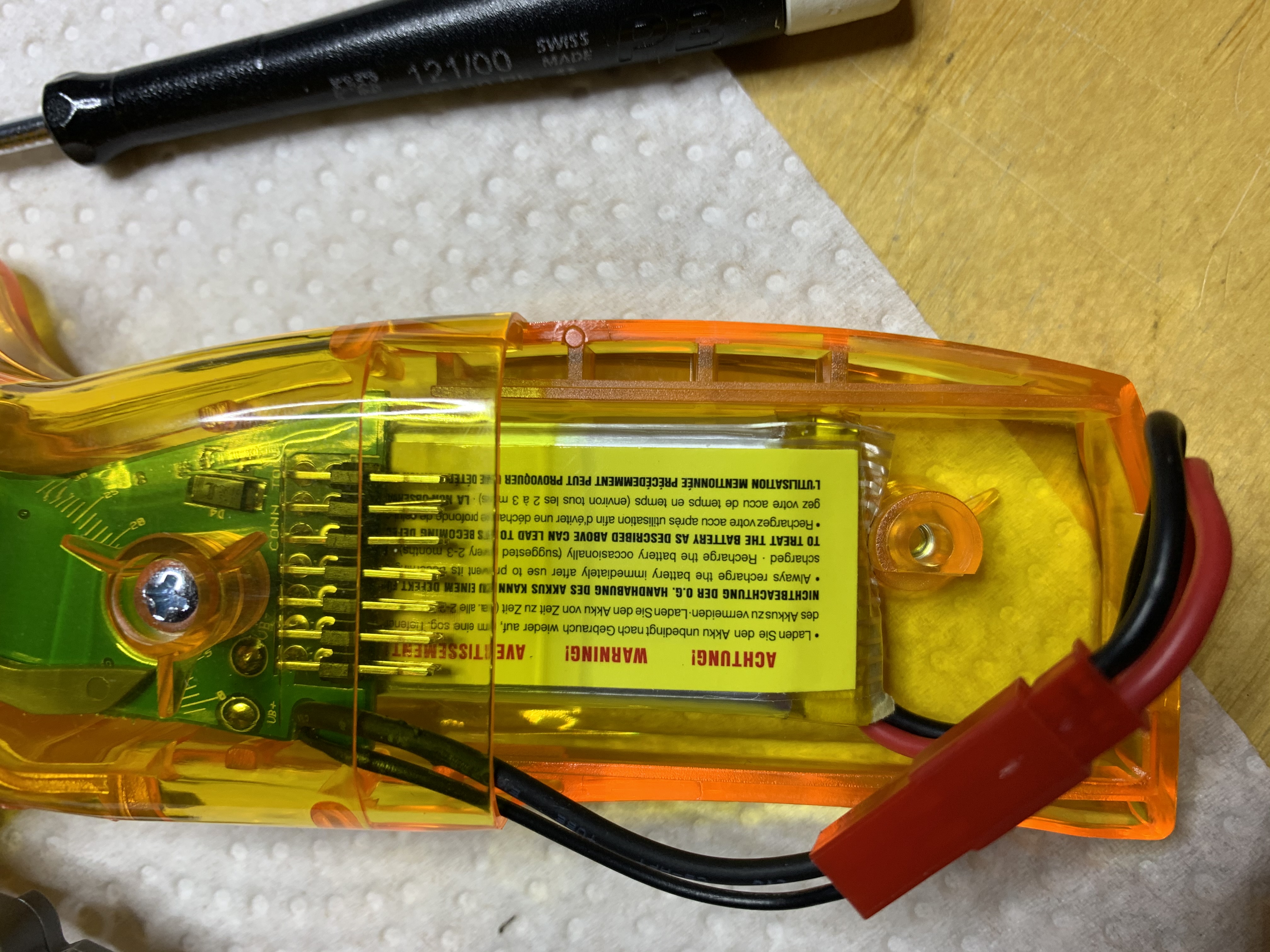

Just purchased 2 SCP3s, also purchased the recommended rechargeable battery to fit into the handle however it does not fit . Before I start surgery on the controller with my dremel am I missing something? Any assistance would be greatly appreciated

I don't have the SCP3 (yet), but have browsed the user manual. The max dimensions the manual recommends for the battery are 45 x 28 x 10mm. The Turnigy Nano-Tech Plus 750mAh 1S 70C Lipo Pack that is illustrated in the manual is 54 x 31 x 8.4mm - too big!
There is an older, almost identical Turnigy pack (Nano-Tech, but not 'Plus') that measures in at 43 x 24 x 9mm - I wonder if this is the one Slot.it used? The SCP3 was in development for a while. Here's a pic...
There don't seem many around. I found one on eBay
here. A Radio Control specialist retailer is going to be the best bet - either to source that older Turnigy Nano-Tech pack or something else that will fit.

You can to use the one that Carrera used in their wireless controller, my dealer sold me one an put it in for me.
I can check it tomorrow and make a picture.

(30th-Oct-20, 07:49 PM)Henk Wrote: You can to use the one that Carrera used in their wireless controller, my dealer sold me one an put it in for me.

@Hank That would be great thanks
@Woodcote kinda sucks that the recommended one is too big makes me think that they didn’t do their homework

Thanks guys I was able to find the older
(Smaller) battery online seems to be a perfect fit. Battling the next issue pairing the SCP3 ver 3.11a with type c chip ver. 3.10..

I apologize. The manual has been fixed, it was an error I made personally...

(30th-Oct-20, 01:38 PM)woodcote Wrote: I don't have the SCP3 (yet), but have browsed the user manual. The max dimensions the manual recommends for the battery are 45 x 28 x 10mm. The Turnigy Nano-Tech Plus 750mAh 1S 70C Lipo Pack that is illustrated in the manual is 54 x 31 x 8.4mm - too big!
There don't seem many around. I found one on eBay here. A Radio Control specialist retailer is going to be the best bet - either to source that older Turnigy Nano-Tech pack or something else that will fit.
This is exactly what happened. I just looked at the picture and didn't read the fine print of the new dimension.

There's nothing worse than when a supplier changes something after you built and designed your own product to fit the way it used to be.
Maurizio. I offer my respects to you for being an honest man. Admitting a mistake also prevents speculation.
