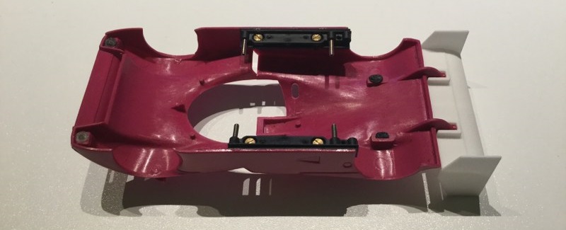

The BODY
The body was found quickly, the older SCX SRS2 range had just the thing I was looking for.
The dimensions were very similar to the any Slotit Group C car.
Width : 63mm.
Lenght : 154mm.
Height : 33,5mm.
Body Weight : 29gr.  (allready glued in the slotit "SICH57B" Chassis-to-body kit)
A bit heavy yes, but this gave me a mission on how to drop the weight without actually using any tool to thin the body out,
and to get as close to the required min. 21gr. body weight (club regulations).
The only thing that was removed from the body were the 4 SRS body clips that hold the body and chassis together.
As this was done quickly, their were only 3 other loose body parts I had to work with, being:
* Interior
* Windowunit
* Rear spoiler
For that last piece on the list I turned to Steven (SV workz), and asked If he would design a 3D model to get printed.
As the original SCX rear spoiler weight about +/- 5gr.,  the 3DP model was only about +/-2gr.
That saves about +/-3gr. less weight hanging behind the rear wheels, which will definitely improve handling.
For the ohter 2 pieces on the list, Only one thing could be done with it, "Lexan".
The interior needed to be adjusted a tiny bit, as the motor was a bit more to the front now when using a Slotit HRS Inline chassis.
But that is only a minor adjusment, which I'm working on as we speak.
After this has been done, it's time to get some vacformed parts, hoping this will drop the bodyweight as close to the 21gr. or lower!

Some very cool modifications, Tom.  Thumbup
We race group-C in our club here in Toronto too. Rules are box-stock except for wheels/tires/braid.
We have several scratch built classes where anything goes. That's where we can stretch our legs a bit.
What do you mean think outside the box? Where did you even get a box? Where's my box?
That rear spoiler is a monster of a thing!
