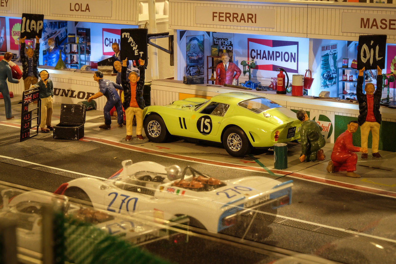

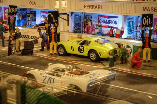

Hi All
Every picture tells a story!!!
150 Limited Edition Fly Goodwood 250 GTO arrived today, managed half a really slow track lap and then stopped.
Magnet far too strong for a front engined chassis.
The 908/2's rear engined Targa Florio cars to coin a phrase FLY round.
So will be in the pits and until a weaker magnet arrives.
Be interested to hear if anyone else has the same issues on a Scalextric track?
Graham

The car is front engined so has no weight over the rear axle, without a magnet the car has no traction. I could weight it down but Fly should fit an appropriate strength magnet.
It has nothing to do with whether you run with a magnet or not. The issue is with the magnet supplied it doesn’t run, if you take the magnet out it doesn’t run!
#16
Magnet now gaffer taped higher up in the chassis, car runs well with a healthy tail slide!
