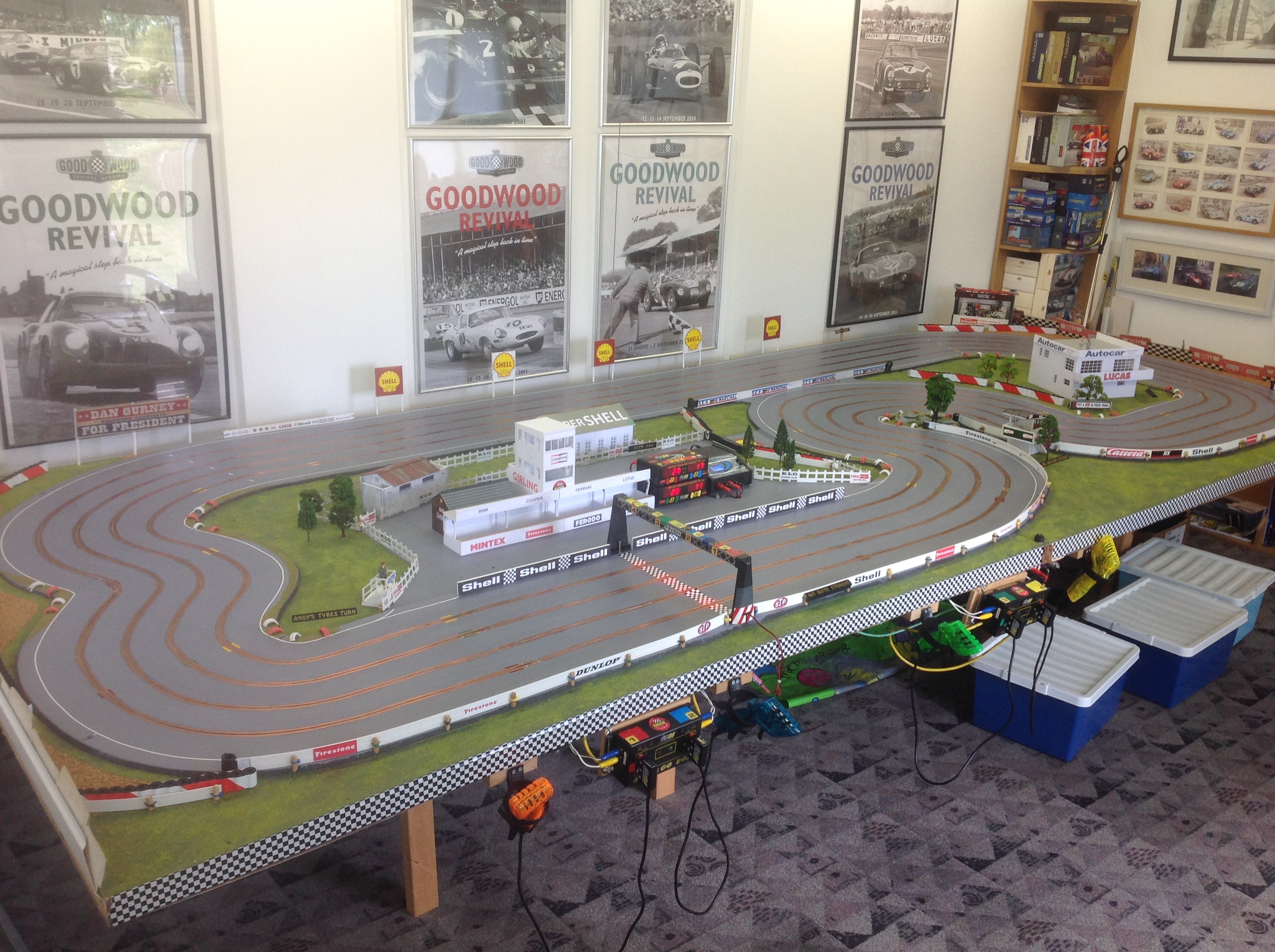

The Routed Raceway.

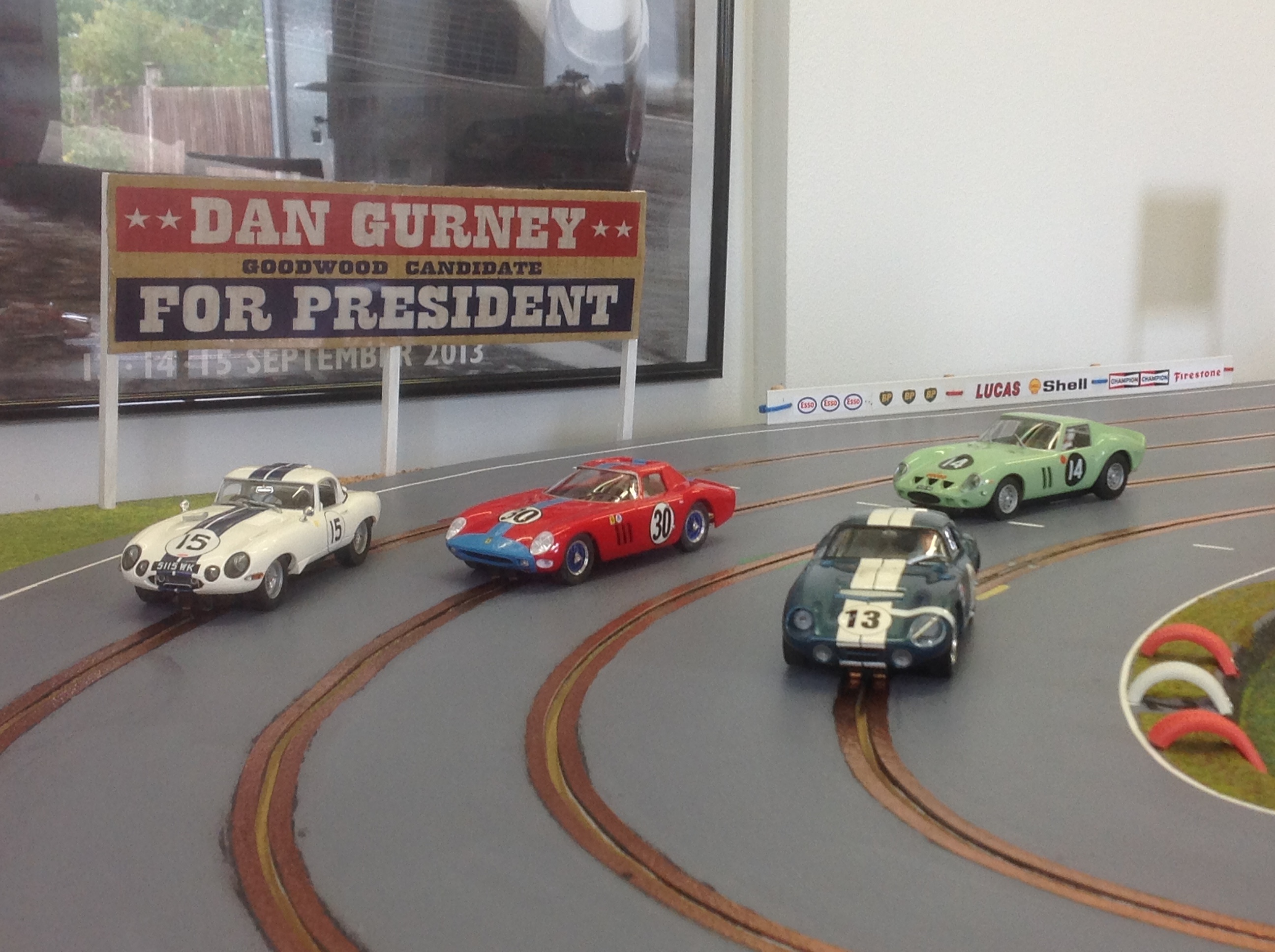

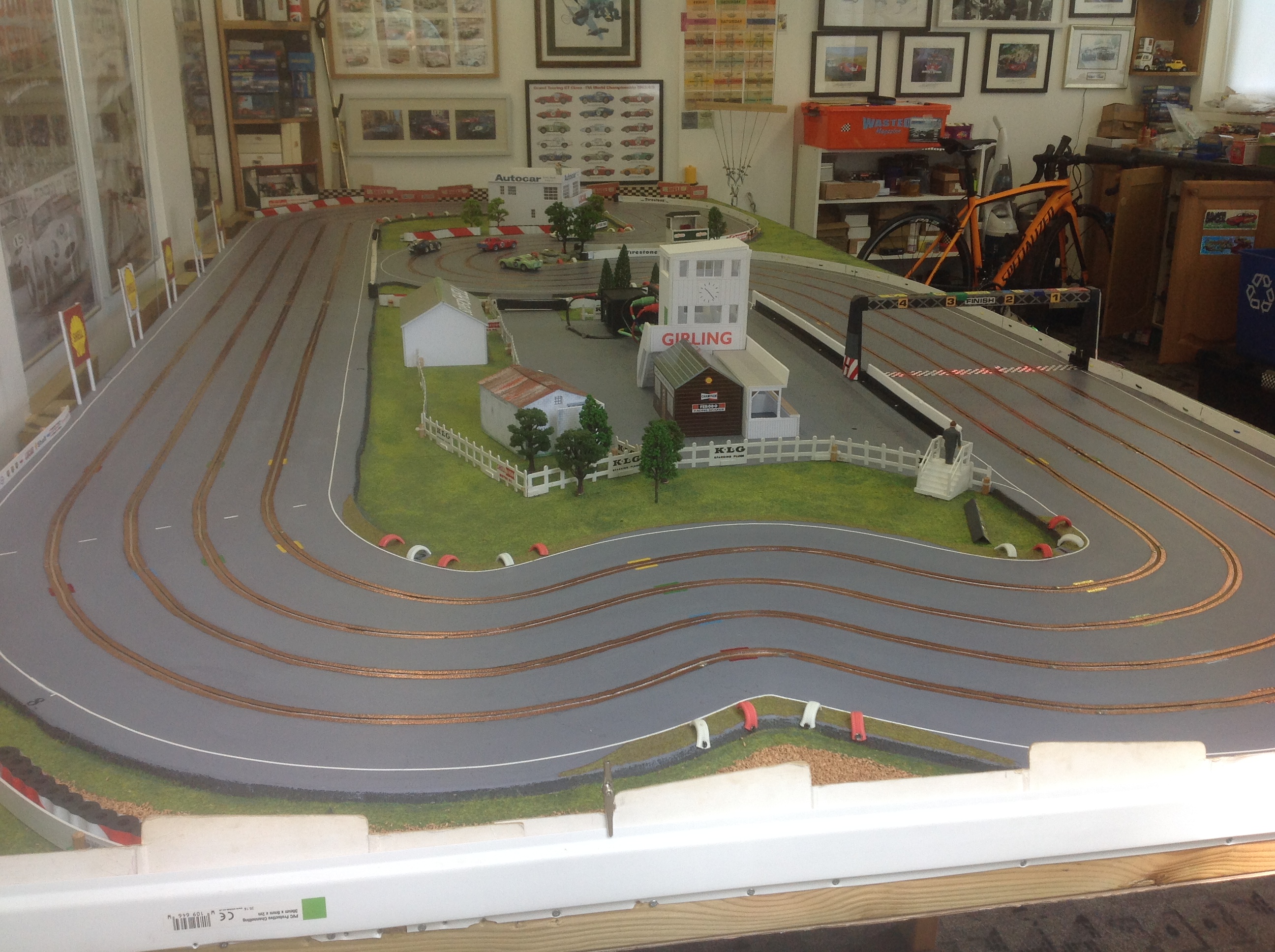

My first track we  built.   4 lane analogue, slot Routed into MDF. Cooper tape for power pick up.
Surface painted with Ultra smooth masonry paint.

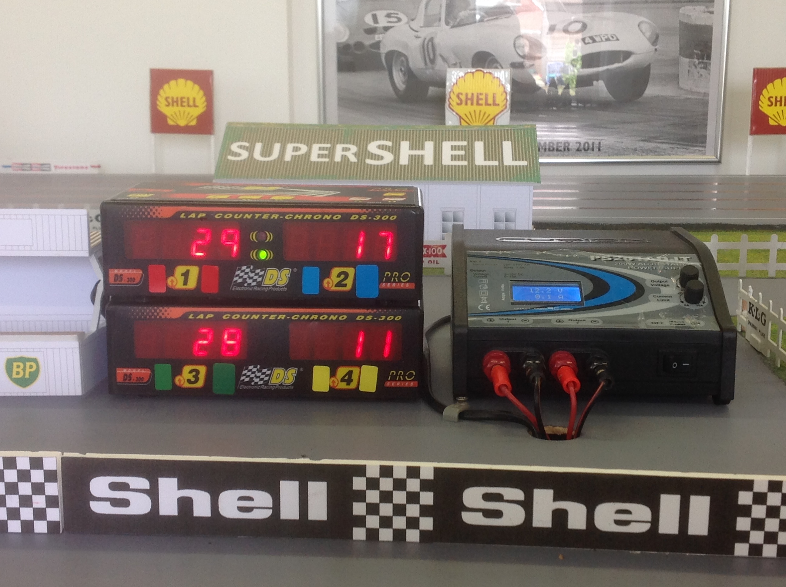

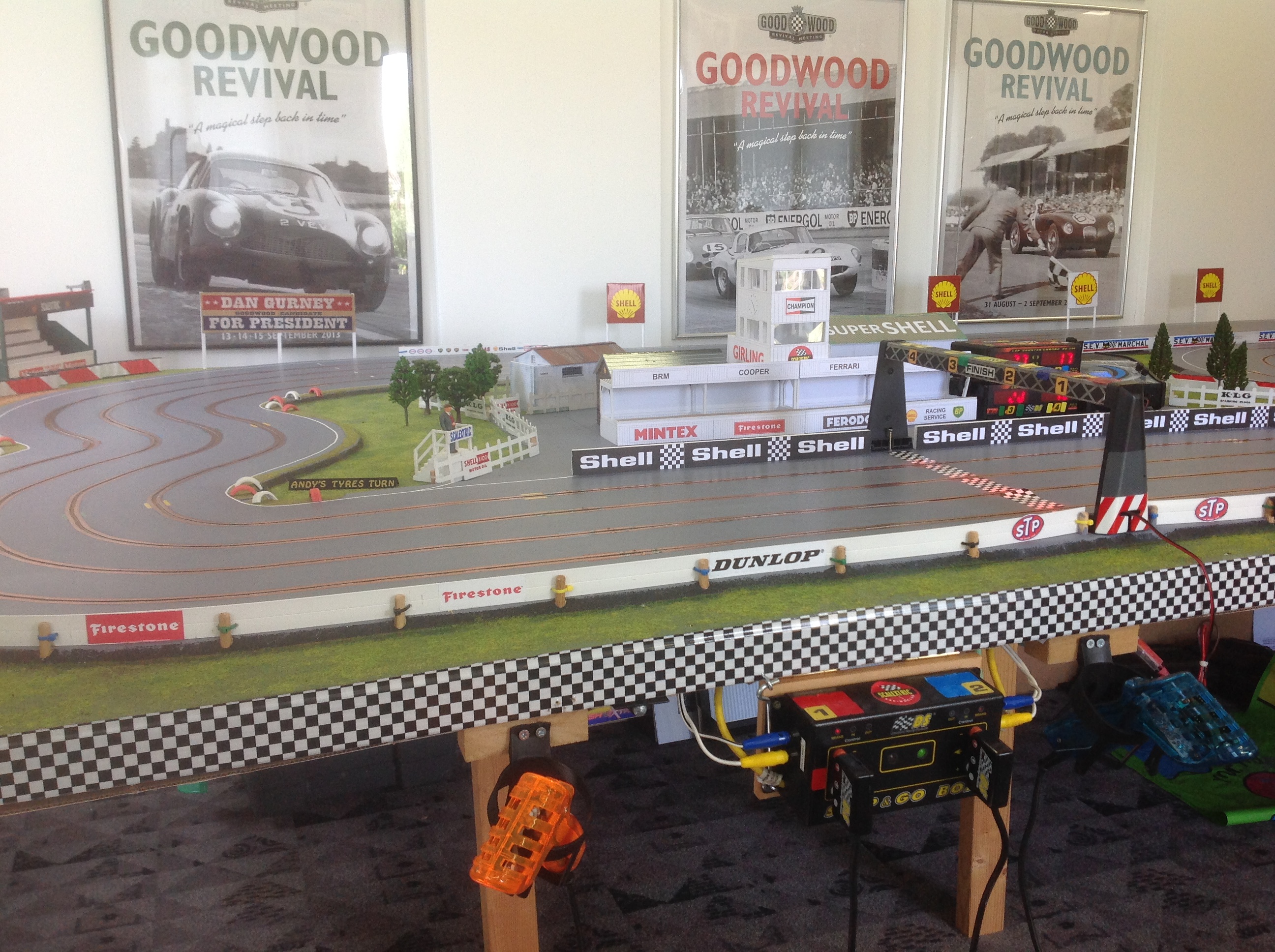

Power via a Fusion PS201 adjustable power supply. 5 - 15 volts, so good for all classes and levels of racers.
Timing/ Lap scoring via a DS 300 Pro series lap counter and Stop & Go boxes, using DS hand controllers.
Design brief - This track folds against the back wall, so had to be flat. Mounted on a board 4.39 metres long, 1.80 metres wide, and lifted via an electric winch.

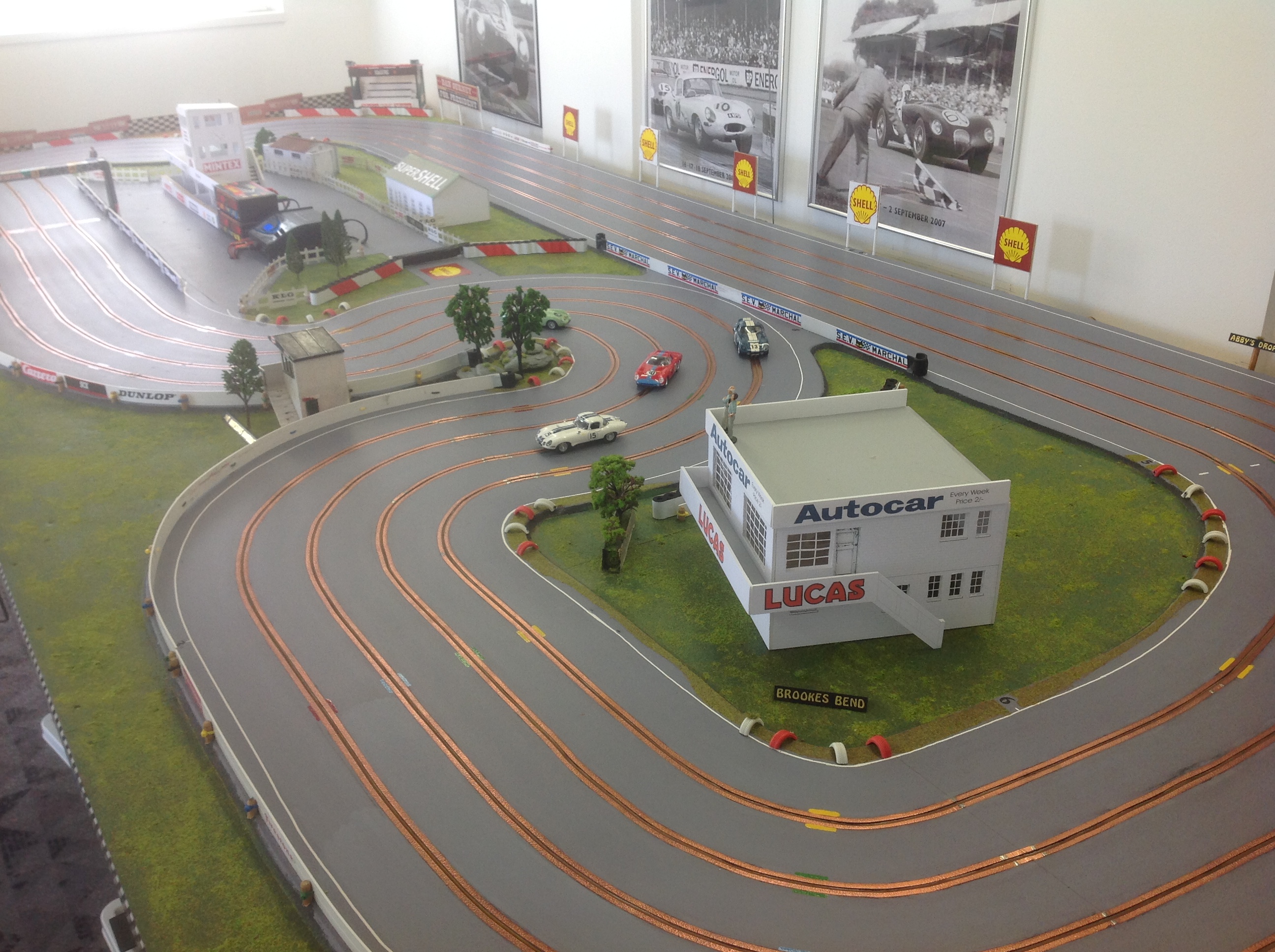

Track design - Fast , flowing, easy for all to use. No pinch points.
Theme - 1960's style racetrack. Goodwood themed buildings. All scenery other than fencing has to be easily removed and stored. Lane lengths - inside 32ft 11, outside 37ft 8. Big difference but mainly negated by the way the lanes drive. Red is hardest, the others very even.
Skill required - Much more than I have! Designed between myself and best mate Andy.
All the clever technical bits by Andy, who is by trade a Handy Man. He has all the tools, all the skill, and can do anything. If you want to to do a layout similar to this I can not stress the importance of having an Andy!!

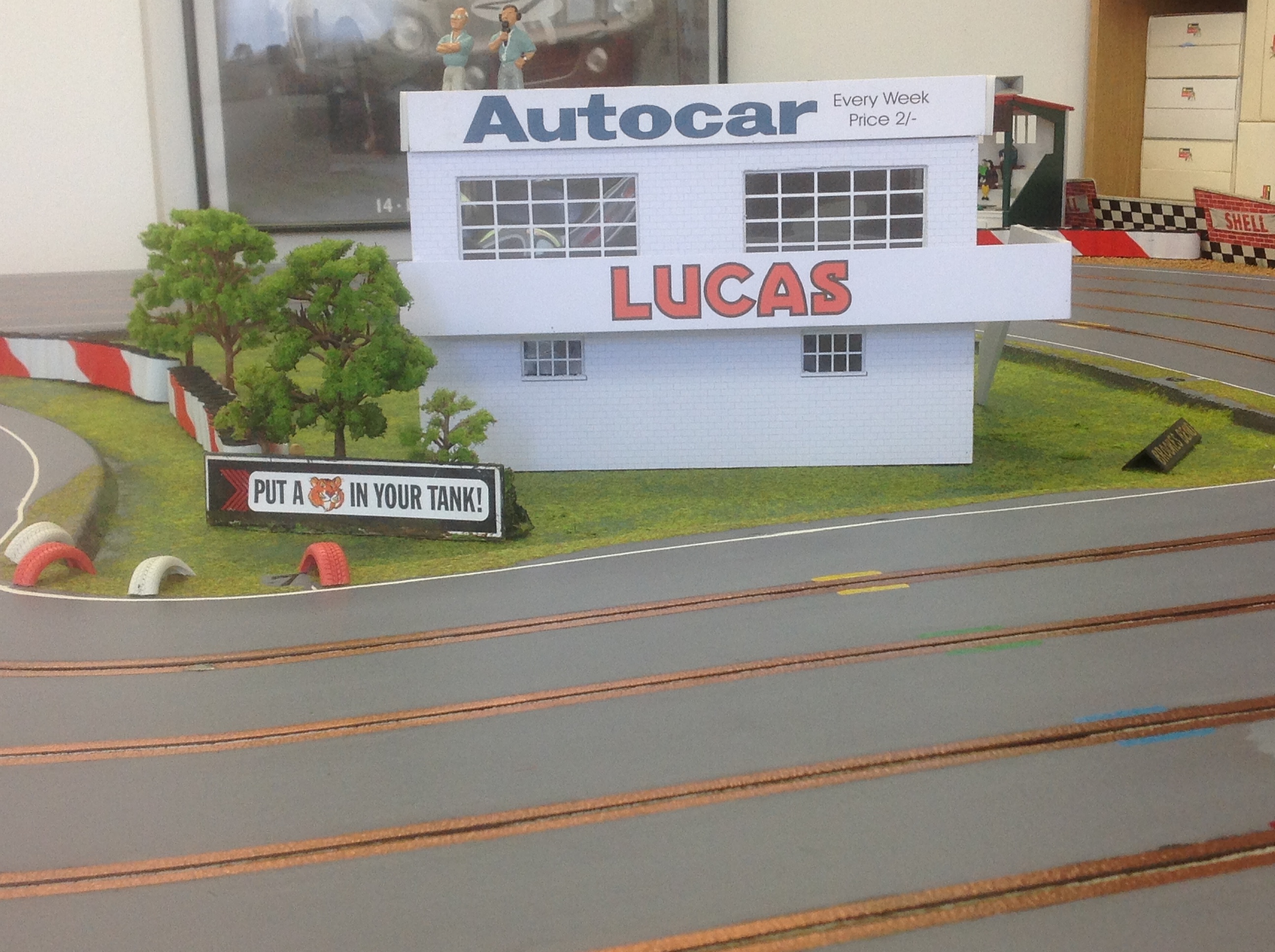

Are the buildings from GP Miniatures?
That looks great, very  attractive layout and a good variety of corners.

Jason, yes the buildings are from GP Minatures. Graham is a really nice chap, and produces some really good looking buildings. I first met him a few years back at Gaydon, when he started his building range.
There are a couple of old Scalextric grandstands either end of the main straight, and a marshalls post.

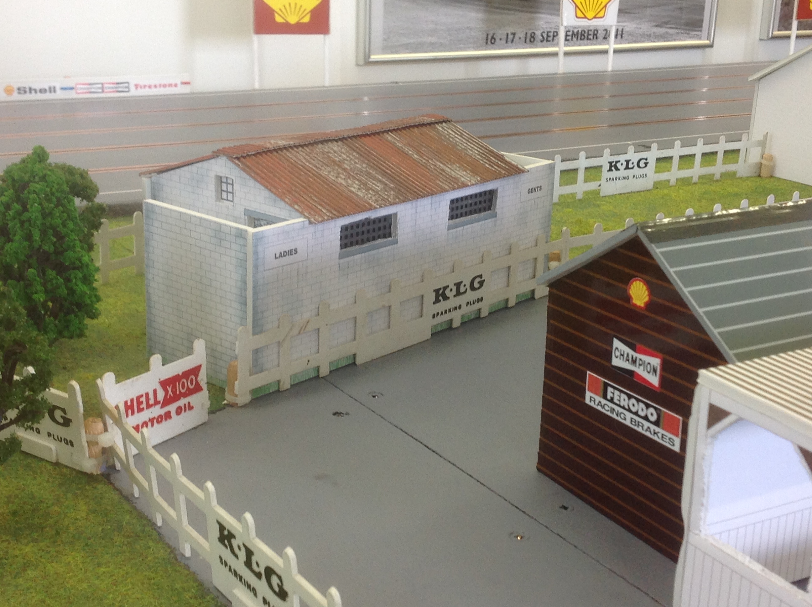

As this was my first go at anything like this I spoke to David & Guy at Slot track scenics. So helpful, full of good ideas, and their grass and gravel traps worked a treat.   Barriers on the side of the circuit are plastic strips with wooden dowls, courtesy of Wickes. All the scenic stuff, other than the barriers/ fencing has to be easily removed as the track folds flat against the back wall.
