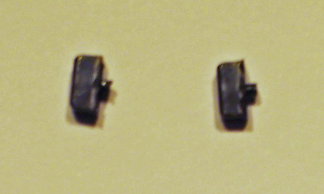

Question What are these bits?

I think I have seen adverts for things like these which allow you to adjust the height of the front axle.

Yes they go under the front axle, over the moulding that you can, if you want, insert a grub screw to adjust the axle height. I always use the grub screw method with two underneath and two on top....

Fiddly little blighters, better off replacing with grub screws.
I get mine from ebay, get yourself a 20 or 50 pack each of M2x3mm and M2x5mm (5's at the chassis bottom, 3's at the top). Link
They are the same size allan key as standard slot it grub screws.
Note these are best used for axle adjustment only as they are cone point.
For replacing wheel and gear grub screws, use these cup point: Link for Wheel/Gear screws
I prefer M2x2mm as then there is only a tiny bit, if any, sticking out. You could use m2x3mm if you prefer.

6th-May-20, 09:48 AM
Thanks for the info folks. The reason I removed the axle was to fit grub screws but the plastic bits just confused the issue so I thought I would check before proceeding.
