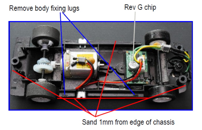

1. Body float - There are two things to remove from the bottom of the body and cockpit to aid body float - the four lugs that clip onto the chassis and the axle brace. The latter pulls out (lever with a small screwdriver), the lugs need cutting with a scalpel.
I have sanded down the corresponding tabs on the chassis. They could be removed with a scalpel. I have also sanded about 1mm from the each edge of the chassis - each side, front and back. I used an emery board on a flat surface. The exhaust pipes on the Javelin mean this isn’t an easy a job as with other cars. ‘Minor sanding’ could be specified more specifically in the guidelines, but 1mm is enough and is hardly noticeable from an aesthetic point of view.
One final thing to do is not to tighten the body screws fully. Loosen them by ½ to a full turn until the body ‘floats’ sideways, back & forth and 'rolls' a few degrees.

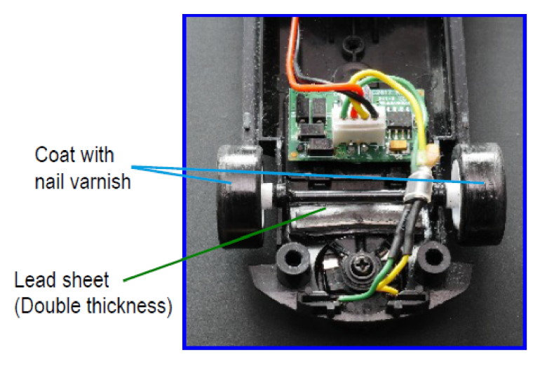

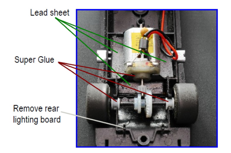

2. Ballast - With the traction magnet removed, I found I needed to add more weight than I usually like in four places - behind the motor (where the magnet was), either side of the motor and just in front of the front axle. I have used 2mm lead sheet stuck down with E6000 flexible glue (Shoe Goo is better). I added, removed and moved the weight around until I got the handling right for the big WHO circuits. I am not sure of the total weight - but you can see the sizes of the pieces in the photos. It is a double thickness at the front. The overall weight of the car is 89.50g - 12g more than the out-of-the-box weight.
3. Gluing motor and bushings - I have glued the motor to the rear of the motor mount using a couple of drops of Gorilla Super Glue Gel on a cocktail stick. I used the same method to glue the axle bushings into the pockets on the chassis. Do this only after you’re 100% happy any weight behind the motor is secure.
4. Varnish front tyres - I coated the front tyres with clear acrylic nail varnish. I haven’t trued the front wheels or tyres.

7. Braids - Fit as per the stock braids, but don’t tuck the lower end underneath - leave them so all four ends point backwards. It gets the front lower.
8. Digital Chip - We have got on better with the Javelin using the older ‘RevG’ version of the chip. The car isn't so punchy and seems to have more braking that using the latest 'RevH' digital plug that I use on all my other race cars. This one change turned a fast, but difficult-to-drive car into a contender.

10. Rear lighting board - Removing it is permitted. I have removed mine.
