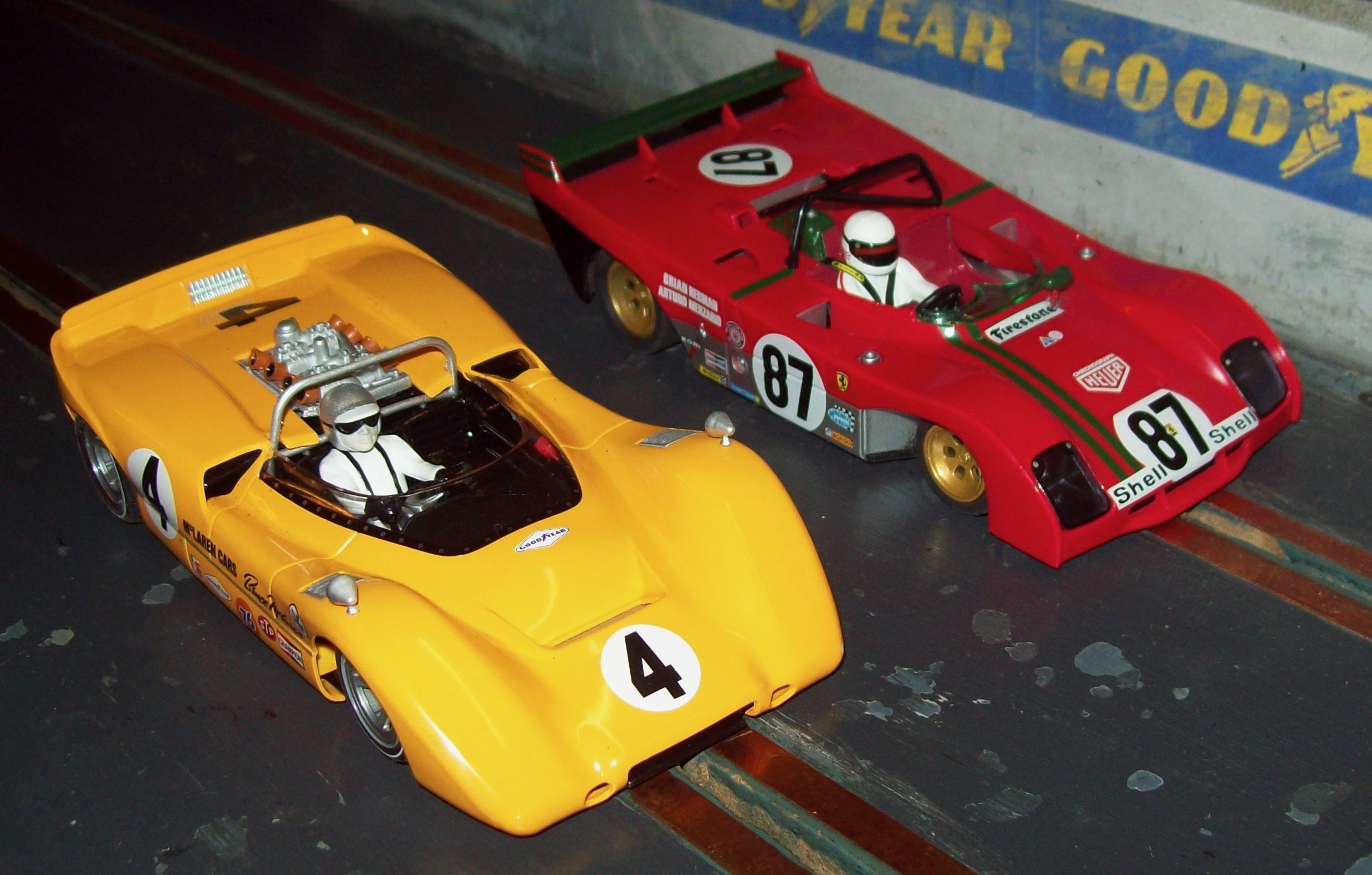

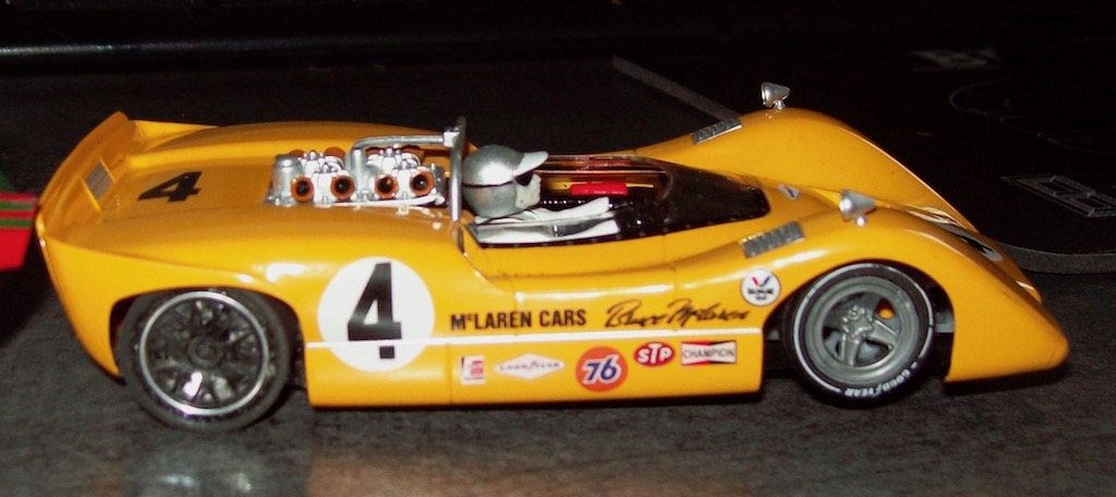

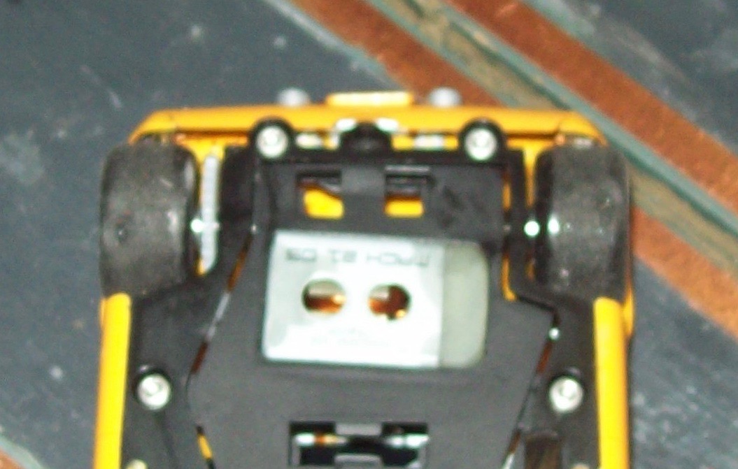

The car itself is interesting. Somewhat over width but nicely modelled. Out of the box it is certainly impressive. Quite quick and handles well. I ran quite a few slow laps just to bed it in before seeing what it could do. As soon as I turned the wick up, it shed a tyre. They are really loose on the wheels. I know most people glue tyres but I seldom do, just buy undersized tyres so they are tight! Also after about twenty laps, they developed holes which is not ideal. I will be fitting some urethanes in due course.
Taking the body off reveals an incredible floppy chassis. Made of much more flexible material than most but does provide the amount of flop that I like with my cars. The motor is only 21,500rpm but seems quite powerful and has ridiculously good brakes. First time I've tempted to ease of the brakes on the controller.
Compared with the Ferrari? Not as quick but then the NSR motor is a bit special, I might get one for the McLaren too. The handling is pretty much the same but then I've been playing with the Ferrari for a bit. Who knows, when it's had more running, it may well be up there.
An expensive experiment then which, right now, may not have been necessary. Time will tell and on the Carrera track at Bordo, it might be different. On my MDF track the Ferrari is ahead at present.

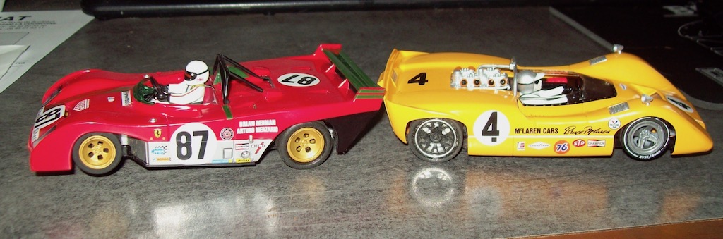

Changed the daft air wheels to some SlotiT kit wheels this morning and they are better. Look naff but hey, performance is the thing after all[Image: smile.png]  The problem with fitting standard urethane tyres to wheels with no solid centre ridge is that the tyres dish so grip is compromised. The standard wheels with urethanes were showing a definite dip in the centre.
The handling is now more consistent and I can stand the look, at least for now. If I get any better matching ones depends on whether I keep the car. If I end up using the Ferrari at Bordo, the McLaren will be for sale on these pages at an un-missable price[Image: mad.gif]

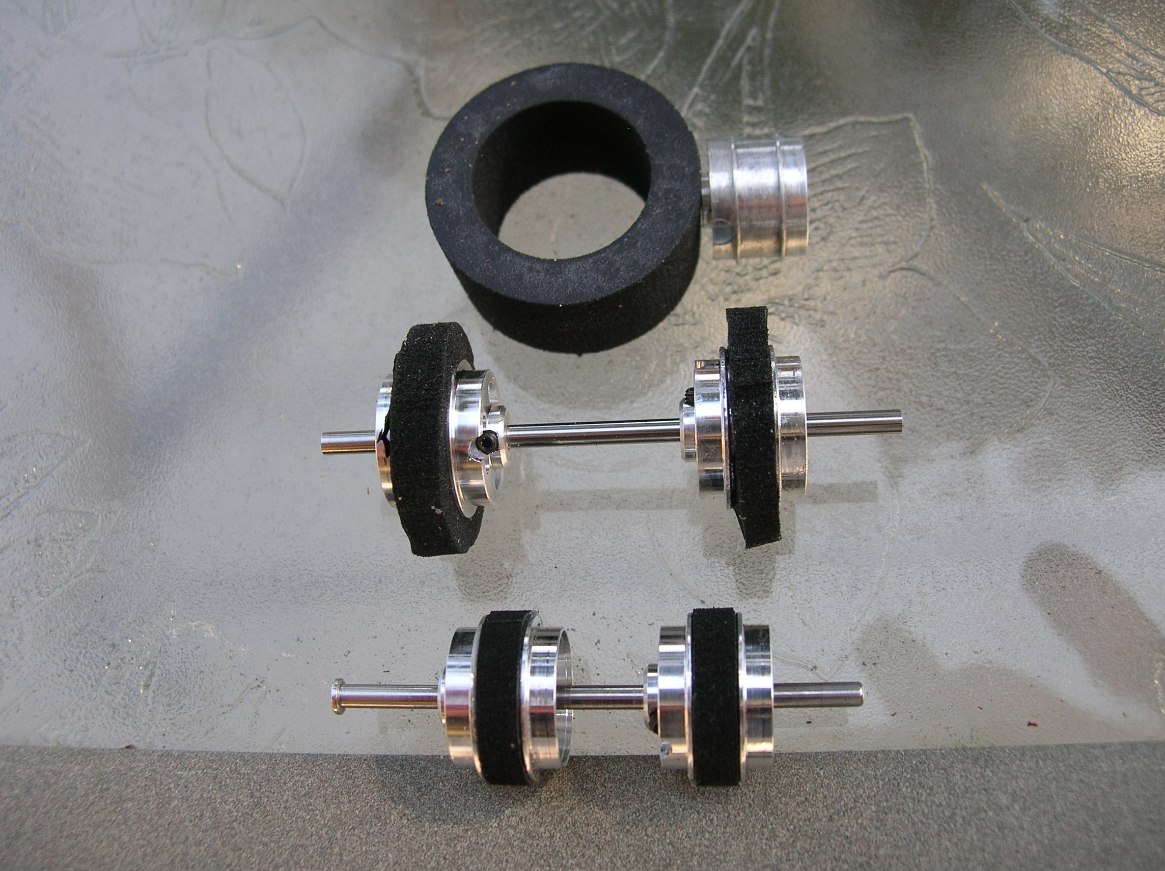

Hi Gordon, there is a fix, and, it does add to the cars' performance. I would not be surprised if some of the quicker Bordo racers will be using it......... Bigsmile
When the "air" wheels were first introduced, it was a fairly common practice to glue the tires around the inside and outside of the bead of the wheel, and use a syringe to pump a bit of air between the 2 inner flanges to remove the concave section of the tire. This "flattened" the running surface, which  provided a couple of very good benefits. 1/ It required less tire material to be removed in order to get a nice round and true tire, and, this "thicker" tread depth resulted in a tire with more compression which aided grip. 2/ The pumped in air also helped in providing more compression to the tire......when a tire can compress a touch, it will more effectively load the outside rear tire in a corner more progressively, adding more, and more consistent, grip.
The tires did tend to lose pressure fairly quickly and needed to be topped up between races/heats, and the sight of syringes on the top of everyones slot box, did not sit at all well with most of the owners of "family" slot shops..........so..........most (if not all) tracks banned the use of syringes several years ago.
So.....a different solution was needed,........ lots of folks are now using the process outlined below
Sponge tire blanks (doughnuts) are cut into strips, and glued (rubber/contact glue) to the gap between the inner wheel flanges.
They are then put into a tire truer, and taken down to size ( a few thou. proud of the adjacent flanges).
This provides all of the benefits of "air injection", and, is permanent..........more importantly, it does not offend the parents/kiddies in the shop  Thumbup
I (and many) have been using this process for several years, and would not think of reverting to a solid ribbed hub.
Chris Walker
Top...........A sponge tire (this is a Scaleauto Doughnut) and a typical "air" hub
Middle.......Sponge tire cut into strips, and glued to hub (use only contact cement or other flexible glue so as to not harden the sponge)
Bottom.......Trued so the the sponge is just proud of the flanges.........I regularly take the flanges down a few thou. to gain even more compression in the tire.
[attachment=4479]
