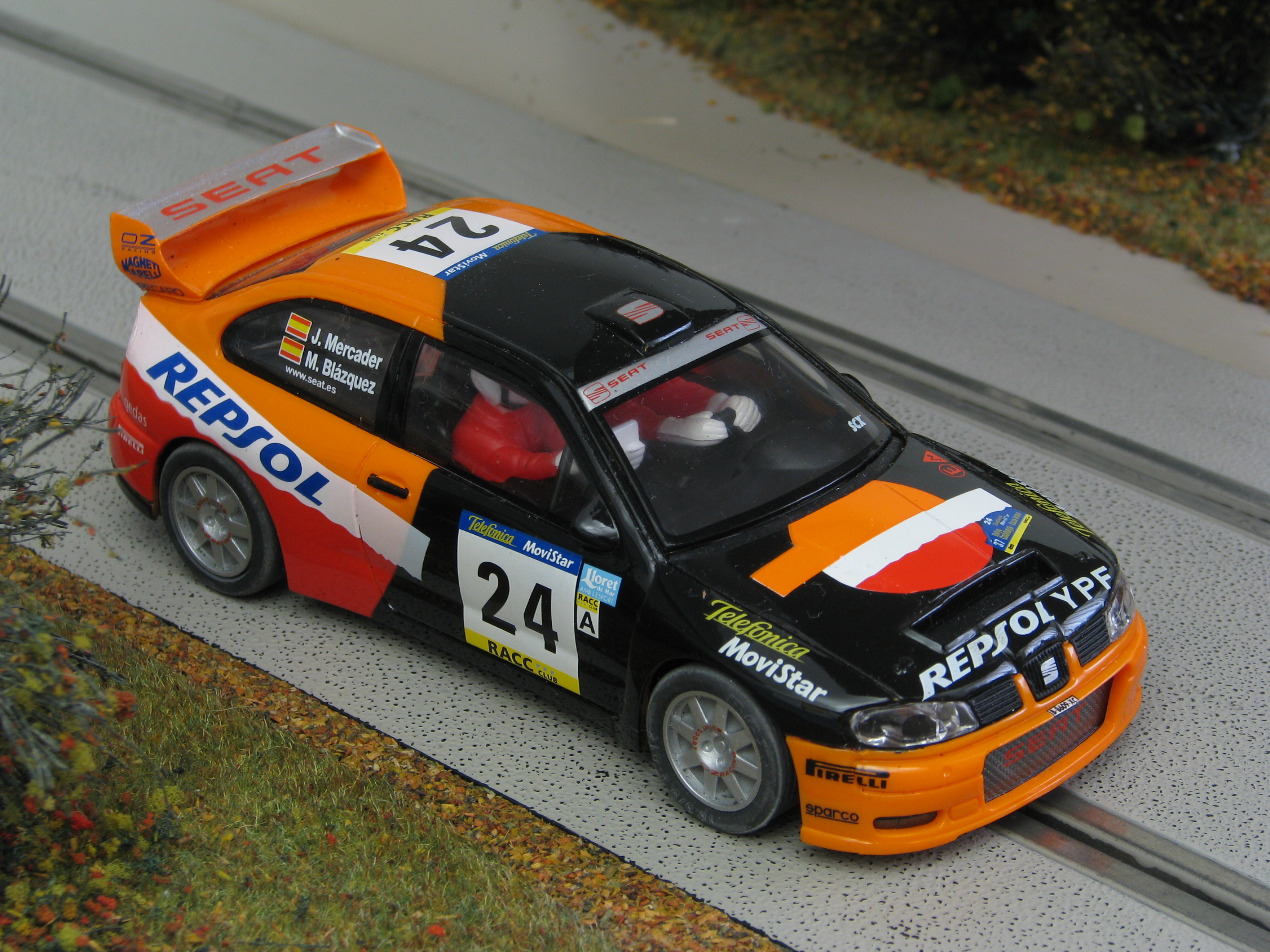

To get a 'speckled' effect you only need to rub gently with a cloth over the still wet painted surface (see photo).
rallyhub Thumbup
[attachment=3222][attachment=3223]
The white wall paint at the Scalextric Classic track.                                                             The speckled effect on the grey painted Scalextric Classic track

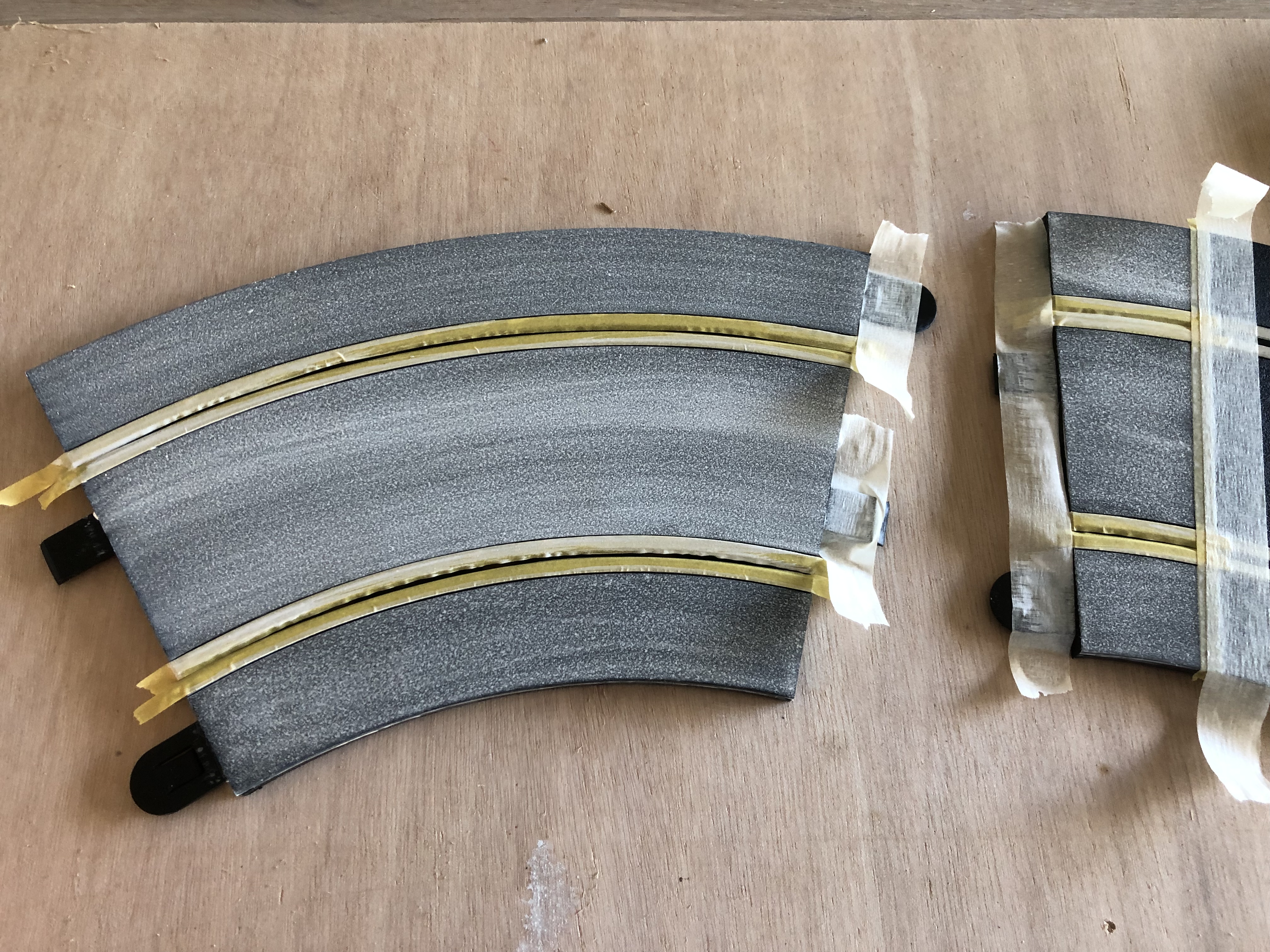

RE: Paint to Scalextric track - A62213 - 2nd-Sep-19
So it begins.
Track have been washed and primed.
Waiting for it to dry and then paint.
Got 20 % discount of the wash, primer and paint cause the shopowner haven’t had the questing “what should I use to paint my slot at track with” in his 32 year career ?
Will update when painted.

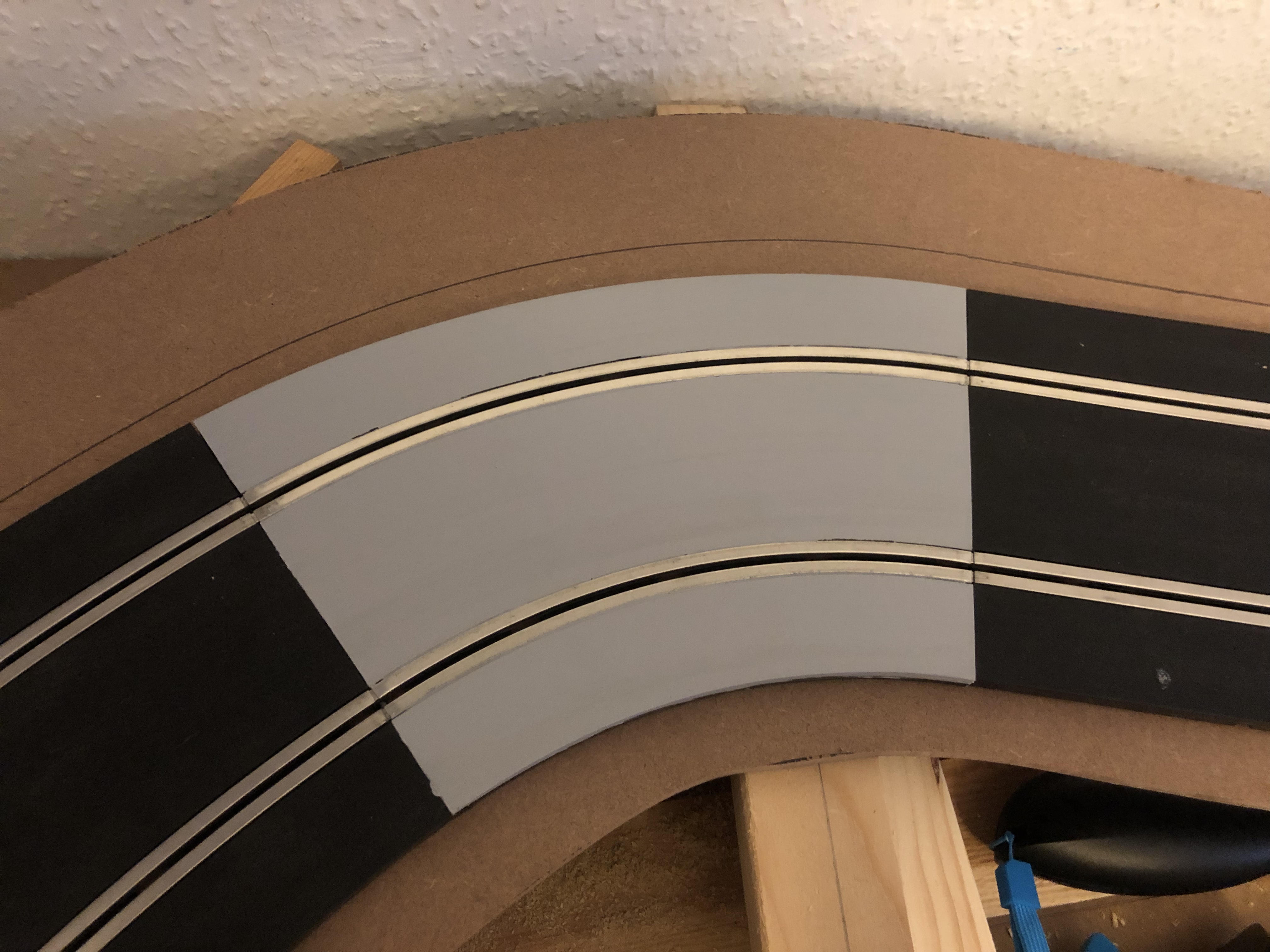

Not to bad i think...
