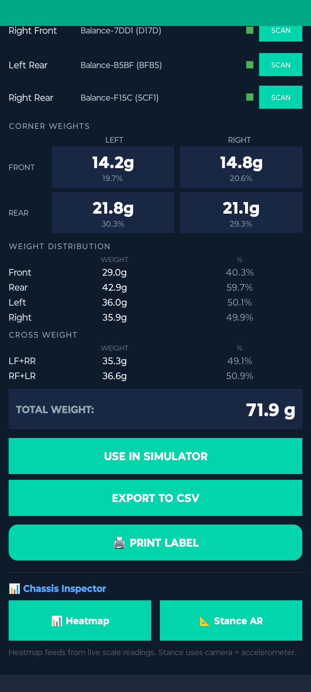

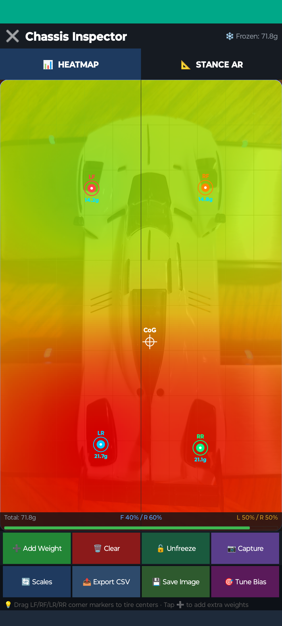

Just finished build 2 of 5.  Car responds very well to mods. Stock it came in at 84g with a 35/65 weight bias Fr and 51/49 lr.

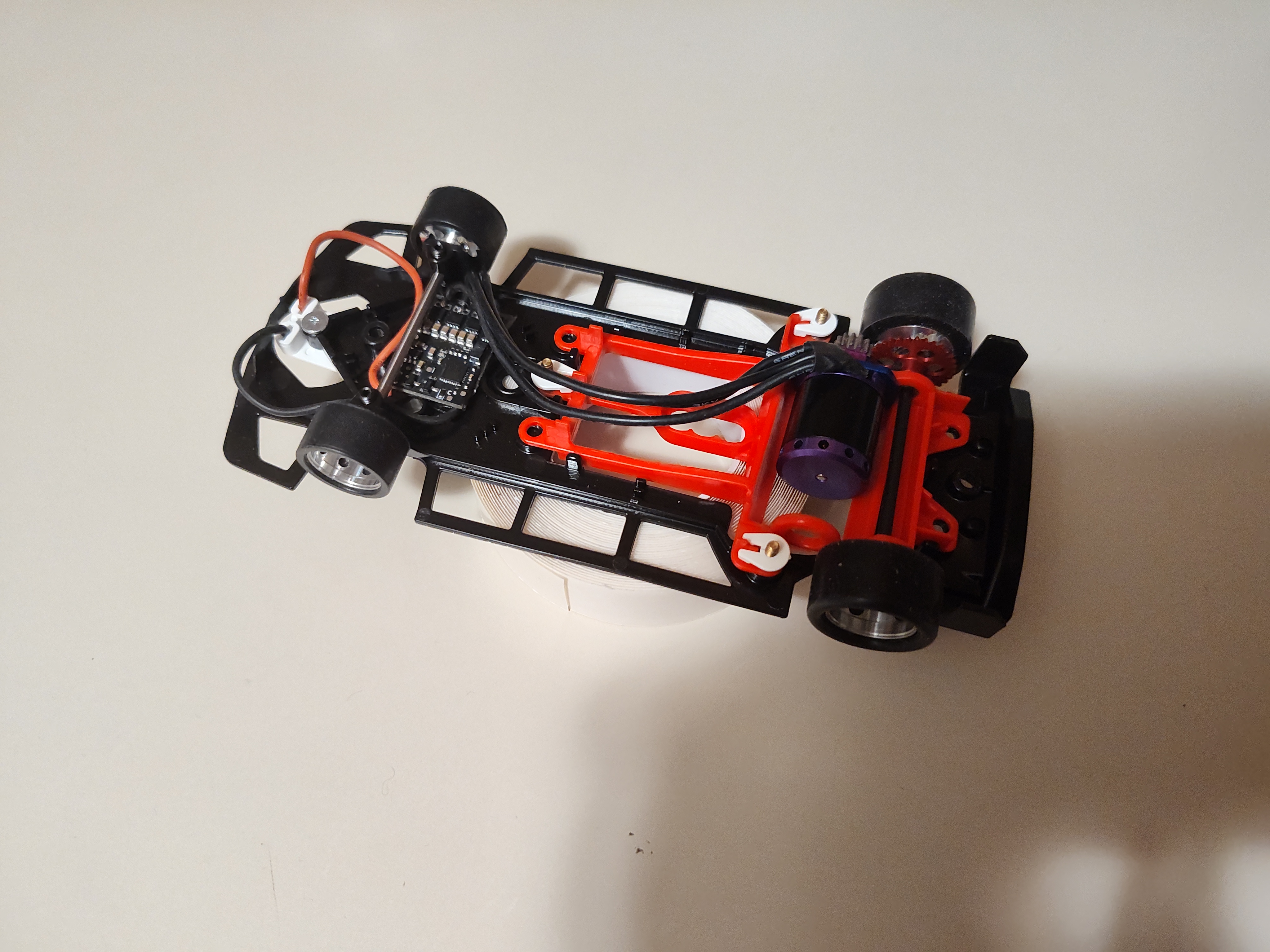

Dropped in a massive brushless system and other parts and it's down to 71.8g  40/60 weight bias from and 50/50 lr. First build set a track record pretty easy with a old tune on the esc for a another car.
Stock I wasn't really impressed with it. Power and speed was definitely lacking. Found the car to handle pretty well due to the better than normal weight bias but still found that if it did get squirrely it would snap pretty hard when it corrected. Now its pretty fast. Excessive amounts of torque and handles great.

what is the 'Chassis inspector ' app ? and how is it used ?
never seen it before
