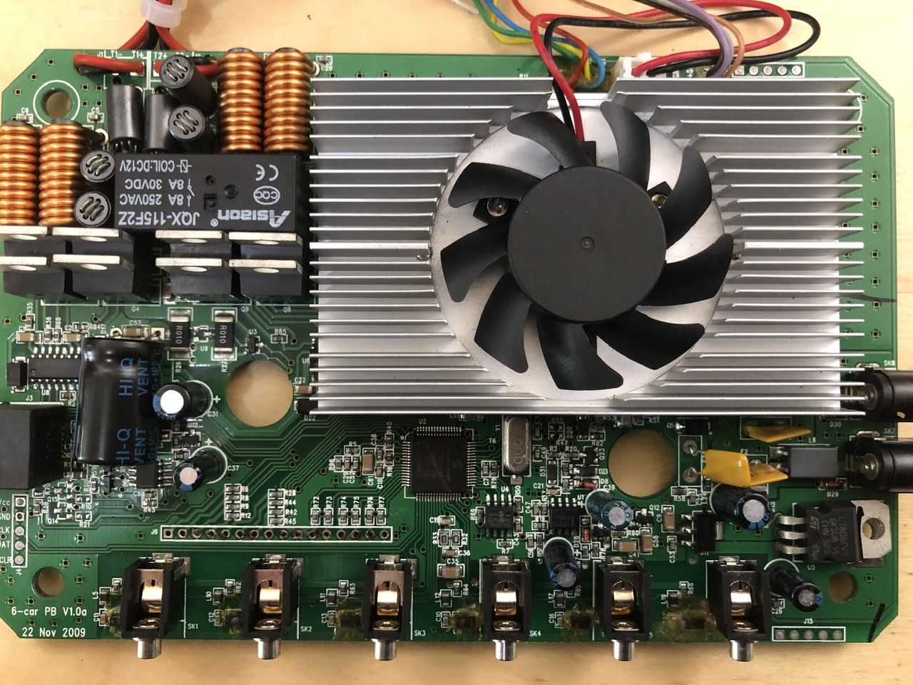

Step 1: Disassemble the APB including removing the power connections tonthe track-piece and the connections to the ID sensors and slot sensors.
Once this has been done the mother board and the top board (LEDs and buttons) can be laid out as per the photo below.
[attachment=42326]

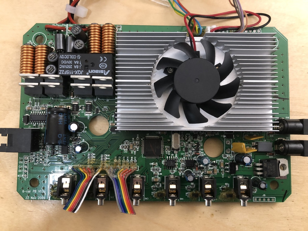

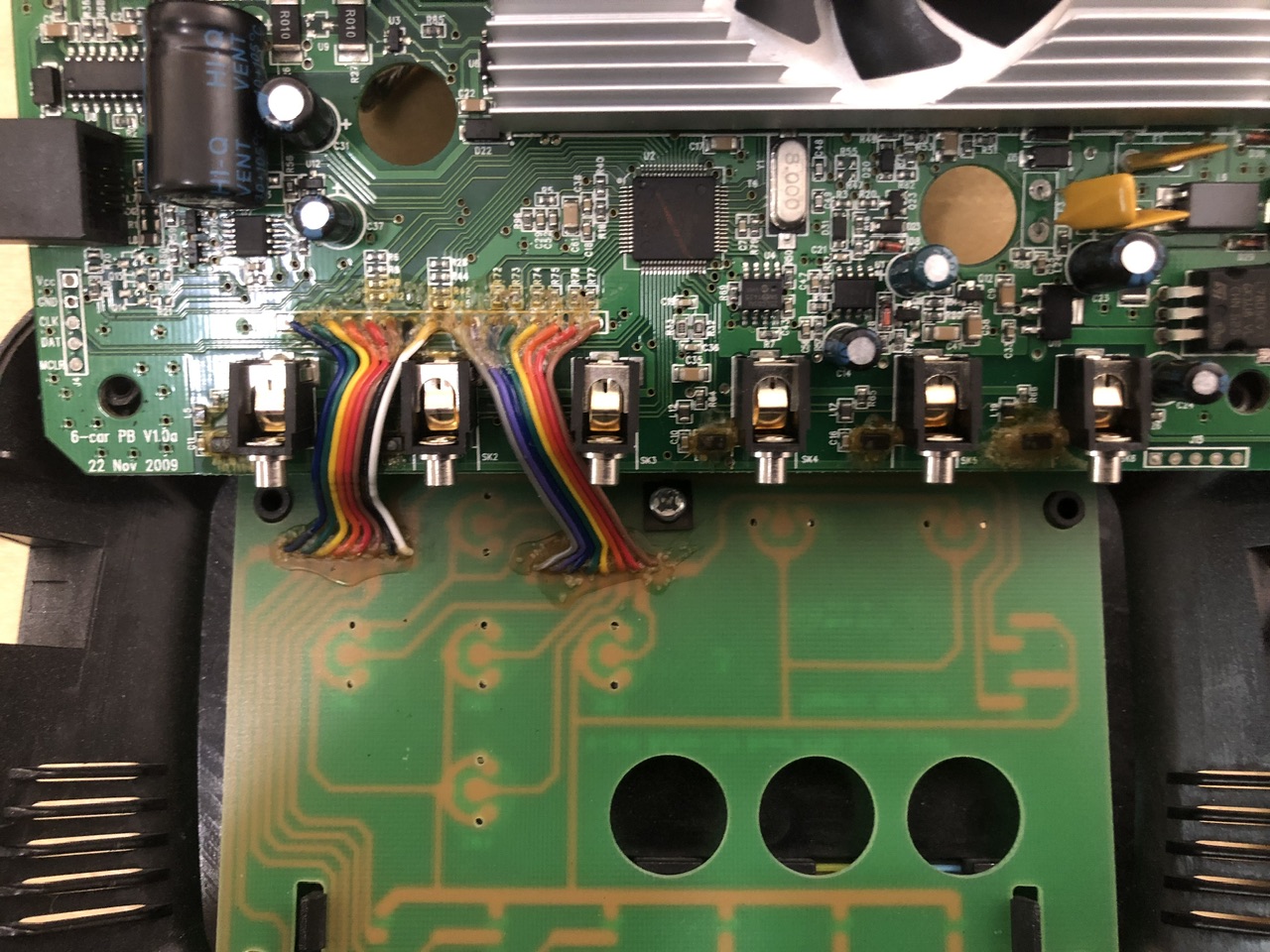

Step 2: Cut the 16-way ribbon cable as shown below. This cable is very short and makes the repair too difficult if left in place.
[attachment=42327]
Step 3: remove the remains of the ribbon cable from the main board and use a solder-sucker to open up the 16 holes. Later we will fit a 16 way header. The main board is now ready for the microcontroller removal and replacement. At this point it should appear as per the photo below.
[attachment=42328]

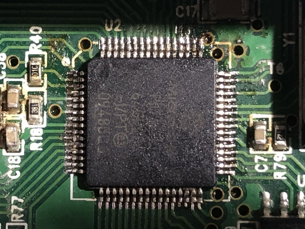

The photo below shows the PIC24 prior to removal.
[attachment=42333]

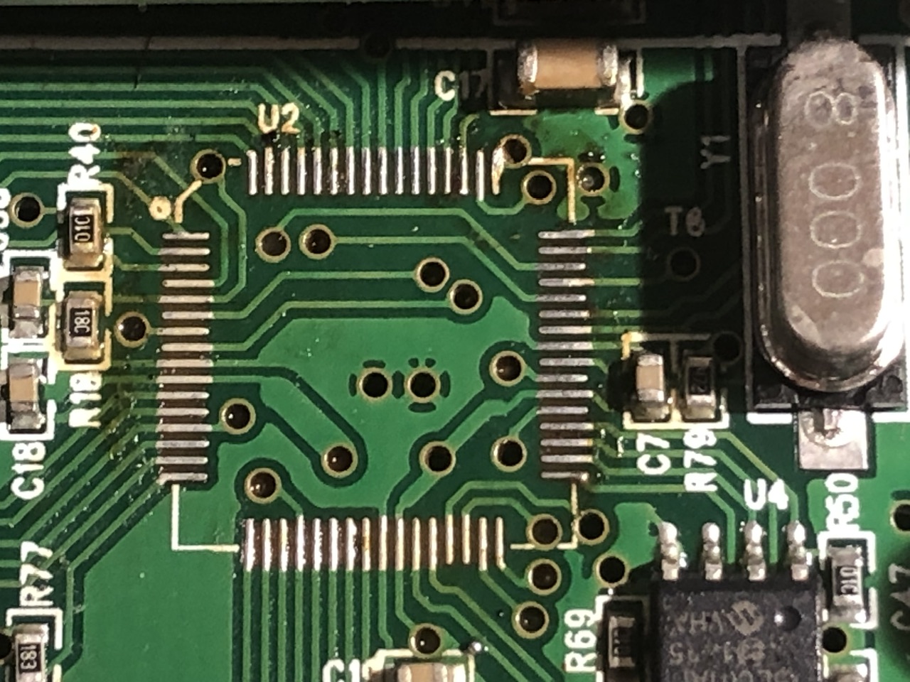

Step 7: Clean the 64 solder pads and then add fresh solder to each pad using a fine tipped soldering iron. This step is critical as this is the solder which will form the electrical connections with the PIC24.
The photo below shows the cleaned and fresh solder prepared pads.
[attachment=42334]

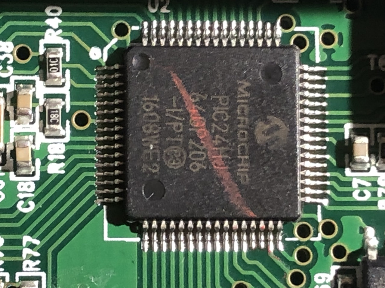

Step 8: Extremely carefully position the new PIC correctly aligned over the solder pads then ‘tack’ solder each of the 64 pins to the underlying pad using a clean tipped fine solder iron. No solder is added at this stage as this would risk bridging between pins. Then repeat the tack soldering again for each of the 64 pins to ensure 100% success.
The photo below shows the replacement PIC24 correctly soldered in place using the above procedure.
[attachment=42335]

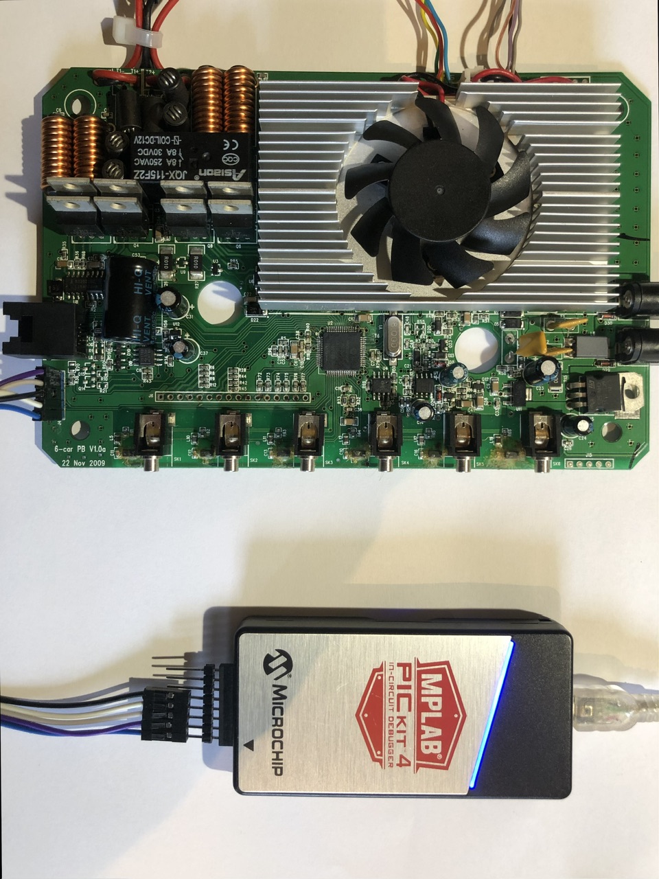

Step 10: Solder into place a 5 pin header at the ICSP interface and then connect a PICKIT programmer. Then load APB HEX firmware that includes a suitable bootloader. We will require this bootloader to be present when later we use standard procedures to upgrade the firmware to version 1.009.
The photo below shows the APB main board connected to a PICKIT4 using the ICSP interface. Power at this stage is provided via the PICKIT only. The required voltage is 3.3V.
[attachment=42336]

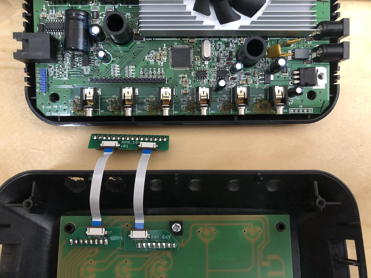

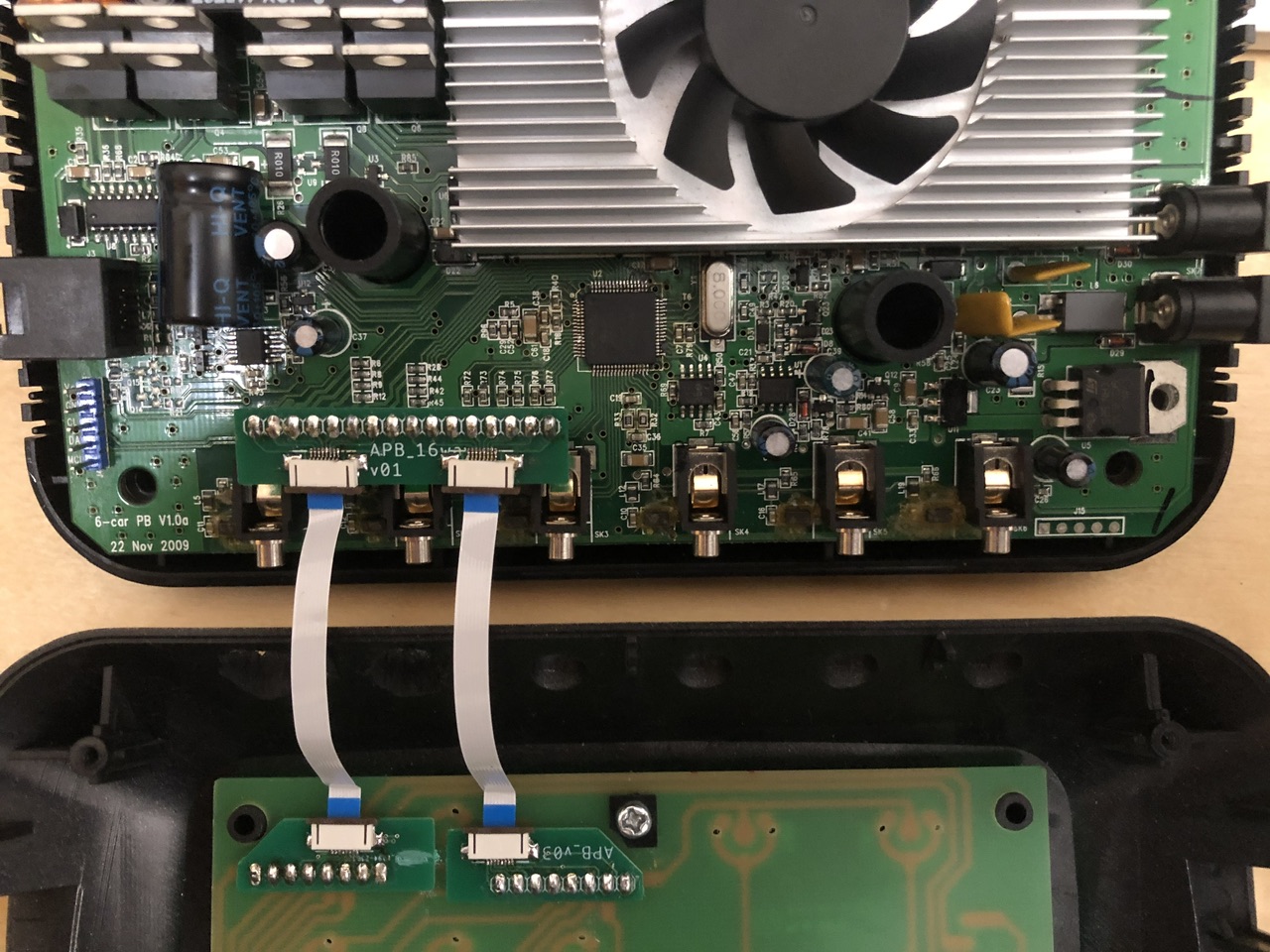

Step 12: Next, it’s time to replace the 16 way ribbon connection we removed earlier. This involves attaching a 16 way header to the main board. It’s standard 0.1 inch pitch (i.e. 2.54mm pitch).
I use small PCBs with FFC 8-way connectors and 8-way FFC cables to make the 16 connections to the LEDs and top panel buttons.
The FFC assembly is shown in the next photo.
[attachment=42358]
Next, the FFC assembly is shown plugged into the 16 way header. This is now unplug-able and replug-able for future maintenance.
[attachment=42359]

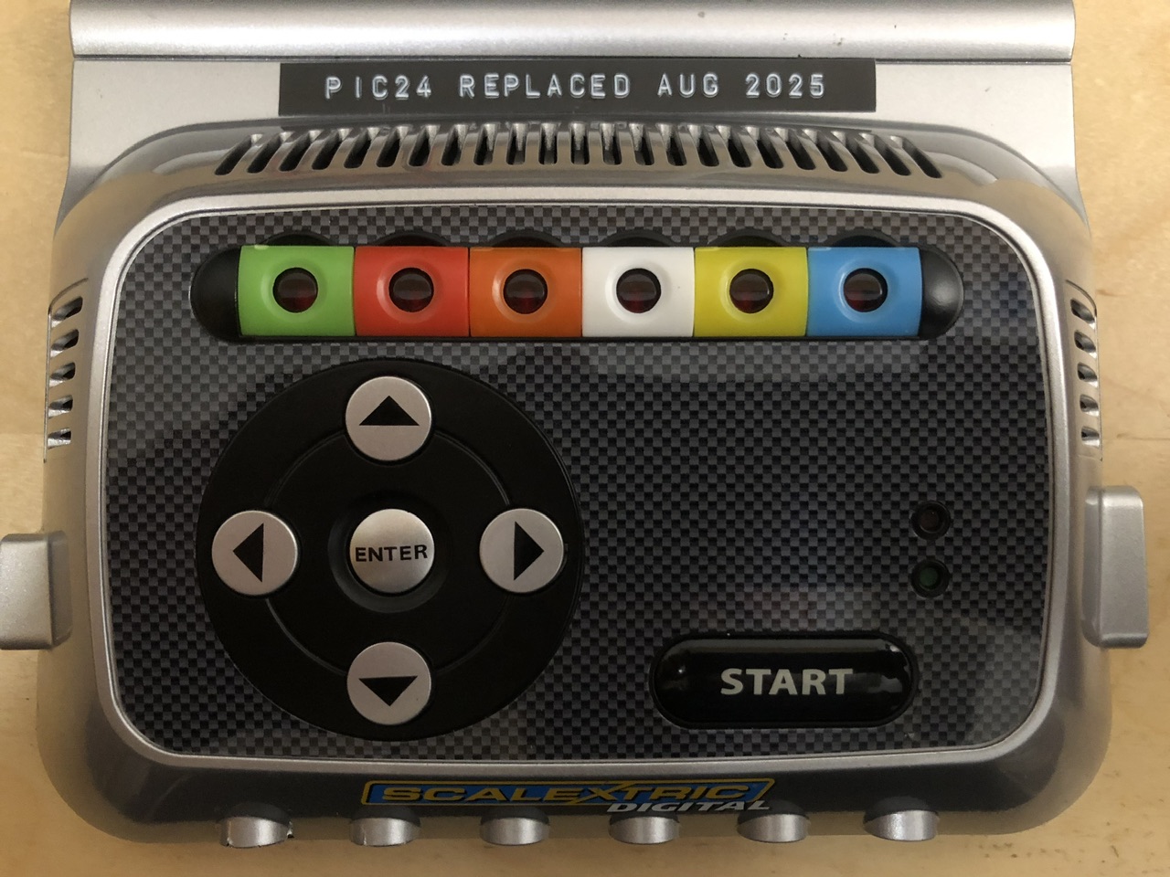

Step 13: The hardware is now re-assembled and ready for installation of firmware v1.009 and system testing.
[attachment=42360]

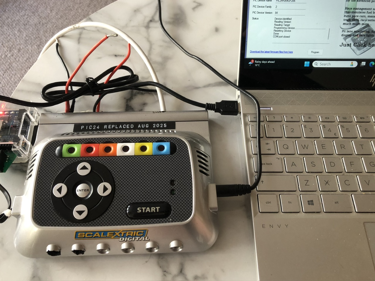

Step 14: There are several methods to upgrade the APB firmware to the current recommended version which is v1.009. An excellent method is embedded in RCS64. Here I use the exe file from the ‘jackaments’ website. It still functions perfectly on Windoes 11 machines all these years later. Acknowledgements to the PBPro team for their excellent work on APB development all those years ago :)
The photo below shows the APB connected to my Windows 11 laptop via the RS485 opto isolator block. I prefer this to the more basic hard wired cable as it blocks static electricity and other forms of signal noise including ground loops. I describe this approach elsewhere on slotracer.online.
The simple start-up procedure is followed and firmware v1.009 downloads successfully onto the repaired APB. It is now a fully up-to-date APB!
[attachment=42367]

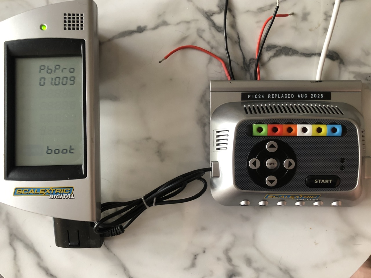

Finally, the repaired APB is powered-up with the tower attached to confirm the current firmware version.
[attachment=42368]
