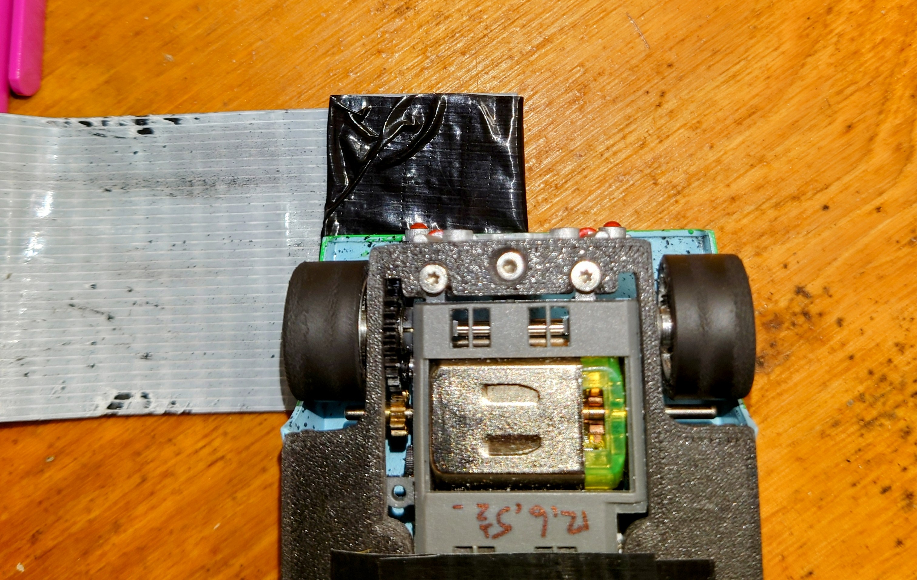

Get another proxy car out, a Fly WSC 95 Joest Porsche with my 3D chassis/pod and tried the 'zero graining' tyres...that's more like it. Did a few laps then decided to try another proxy car which is a lovely runner, a Fly Porsche 908/3 with my 3D chassis and SlotIt SW pod...an immediate improvement, these tyres aren't as bad as I thought, lets keep going and I must have done about 100 laps with them and they were starting to polish with little tyre dust so decided on a proper test.

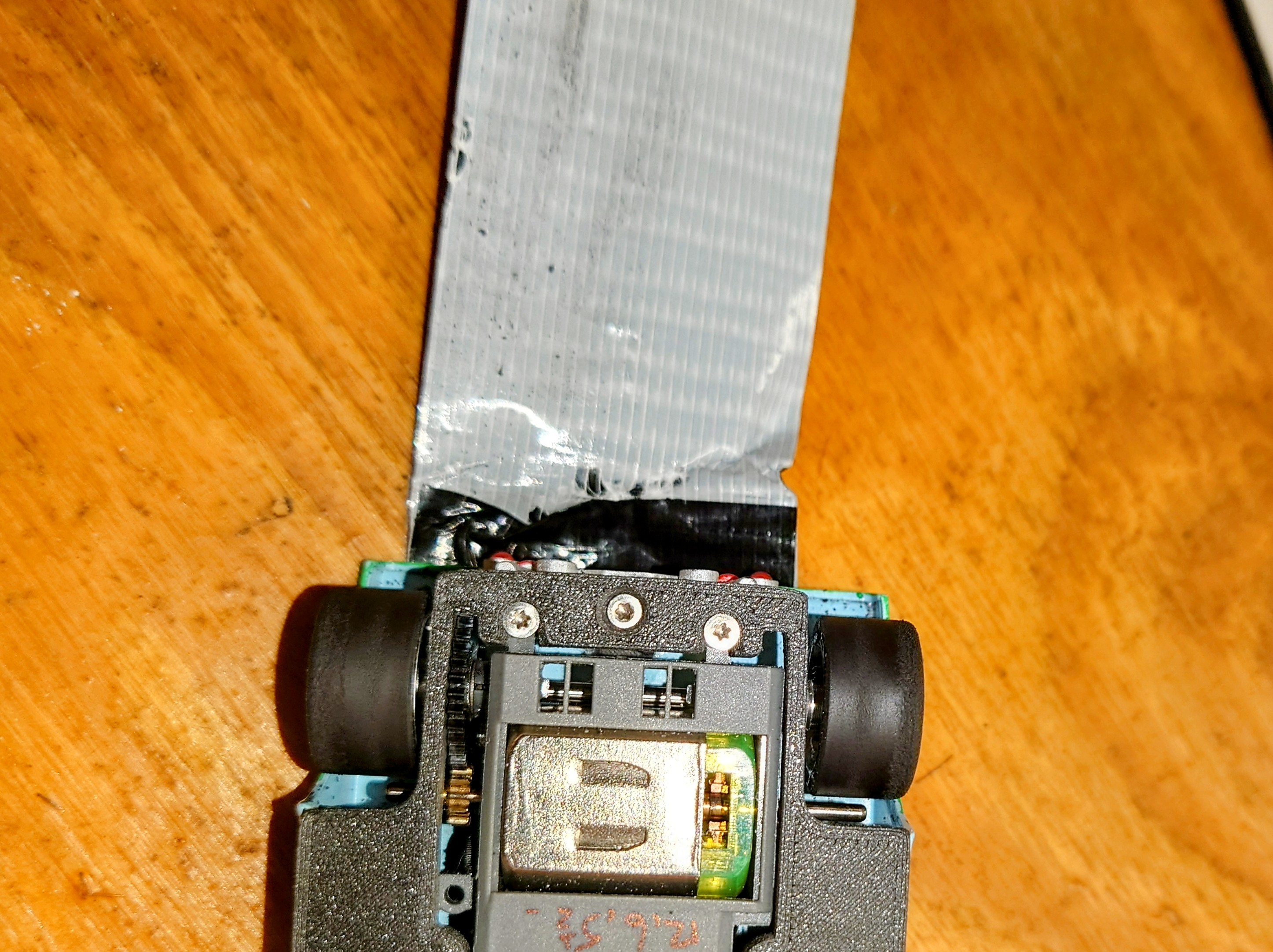

First photo is after about 100 laps on our polyurethane painted wood track.
[attachment=40762]
Those are looking much better than they did after running the NSR Porsche 917.

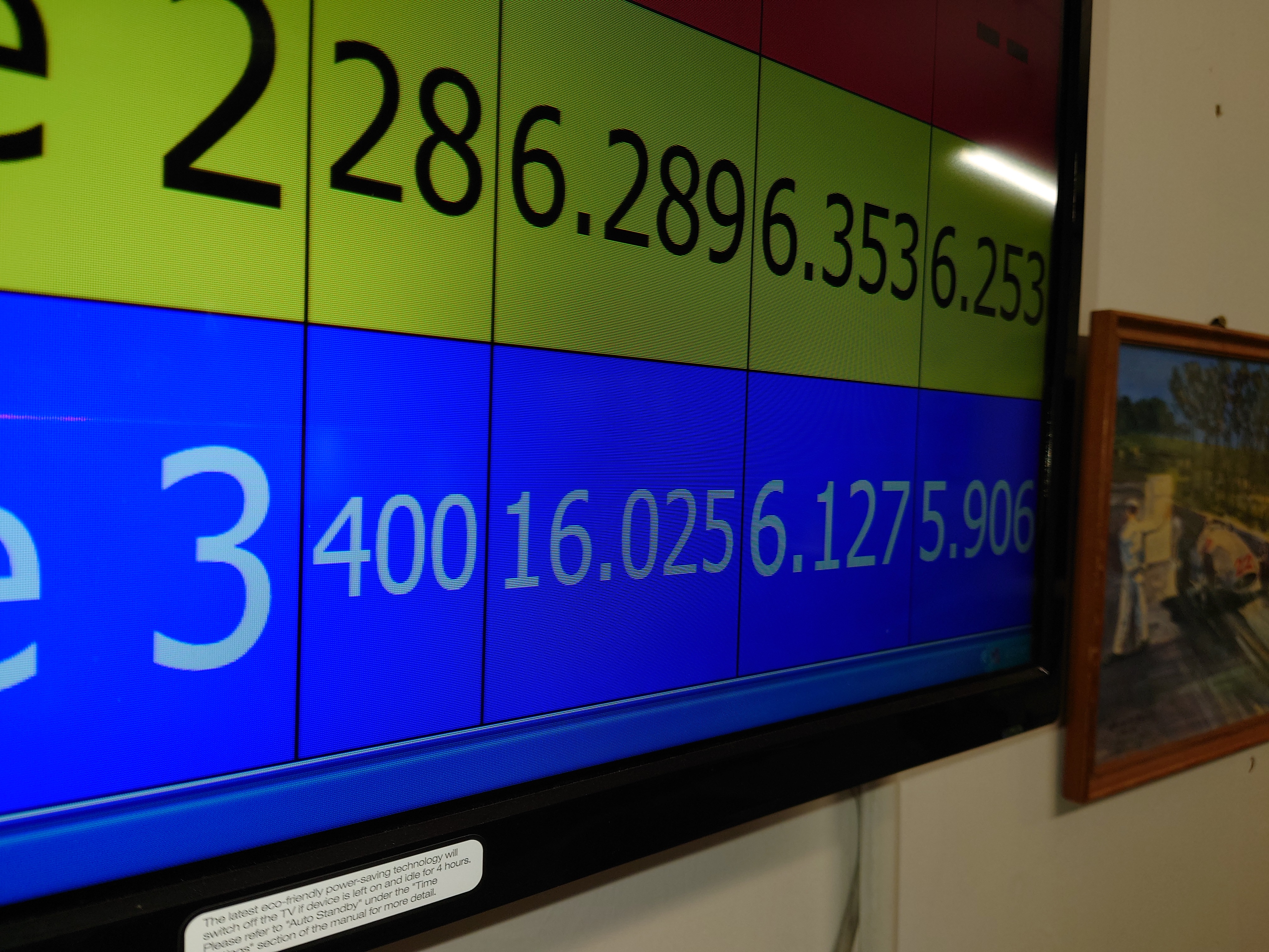

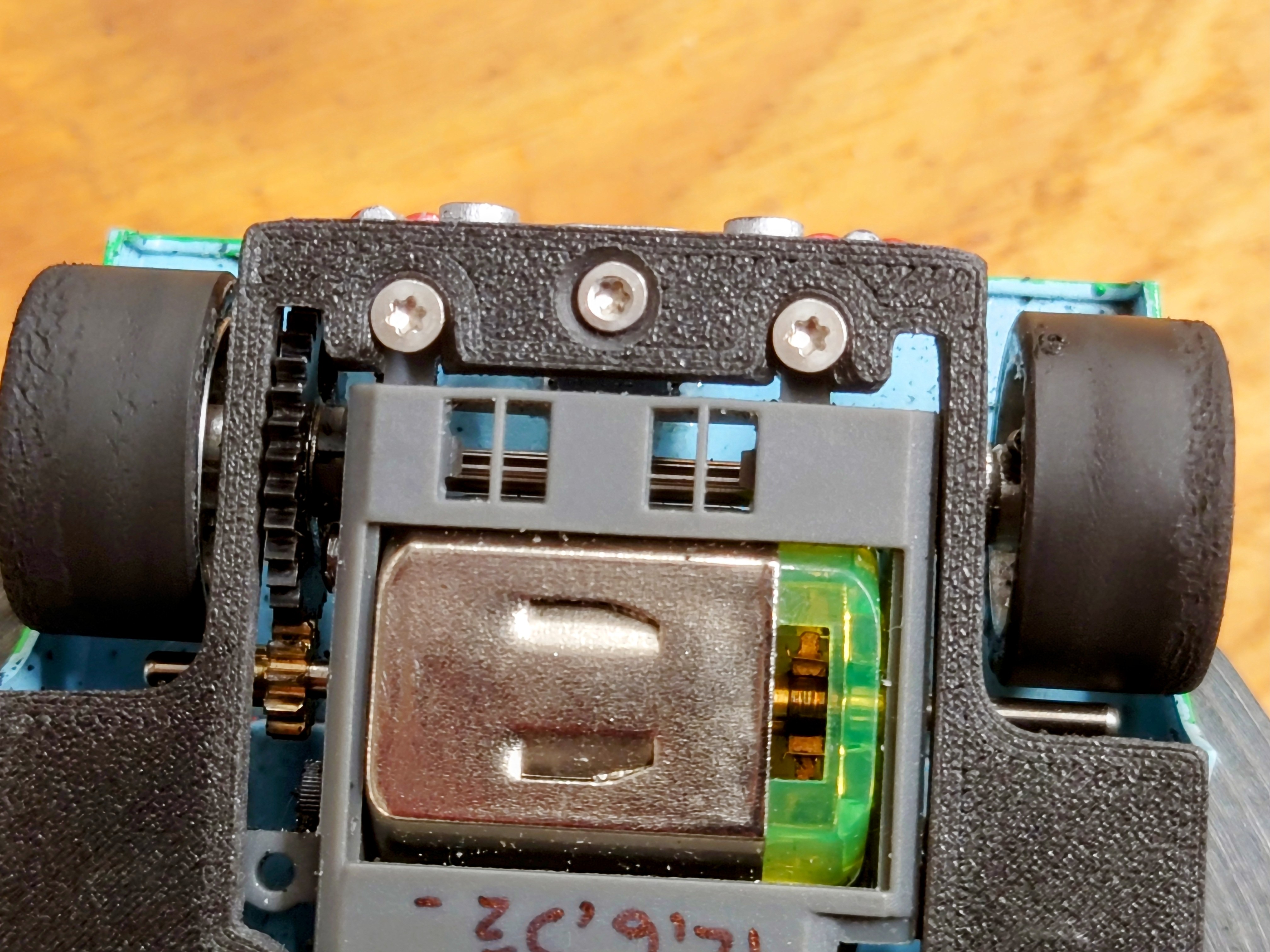

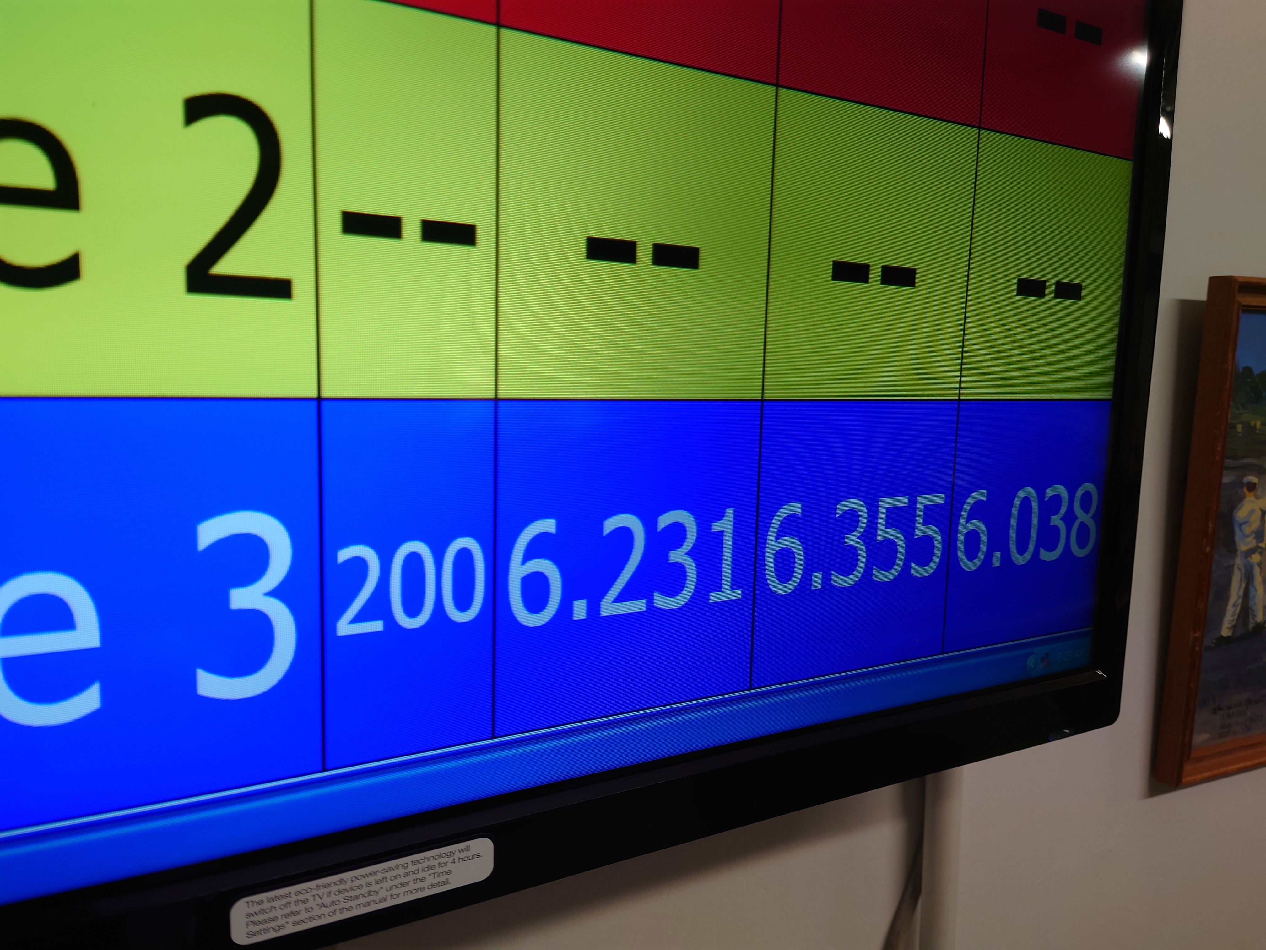

I then did another 100 laps in 33 lap segments, cleaning with tape. This next photo is after 200 laps, fastest lap was 6.038 which is quick for a proxy car on our track.
[attachment=40763]  [attachment=40764]

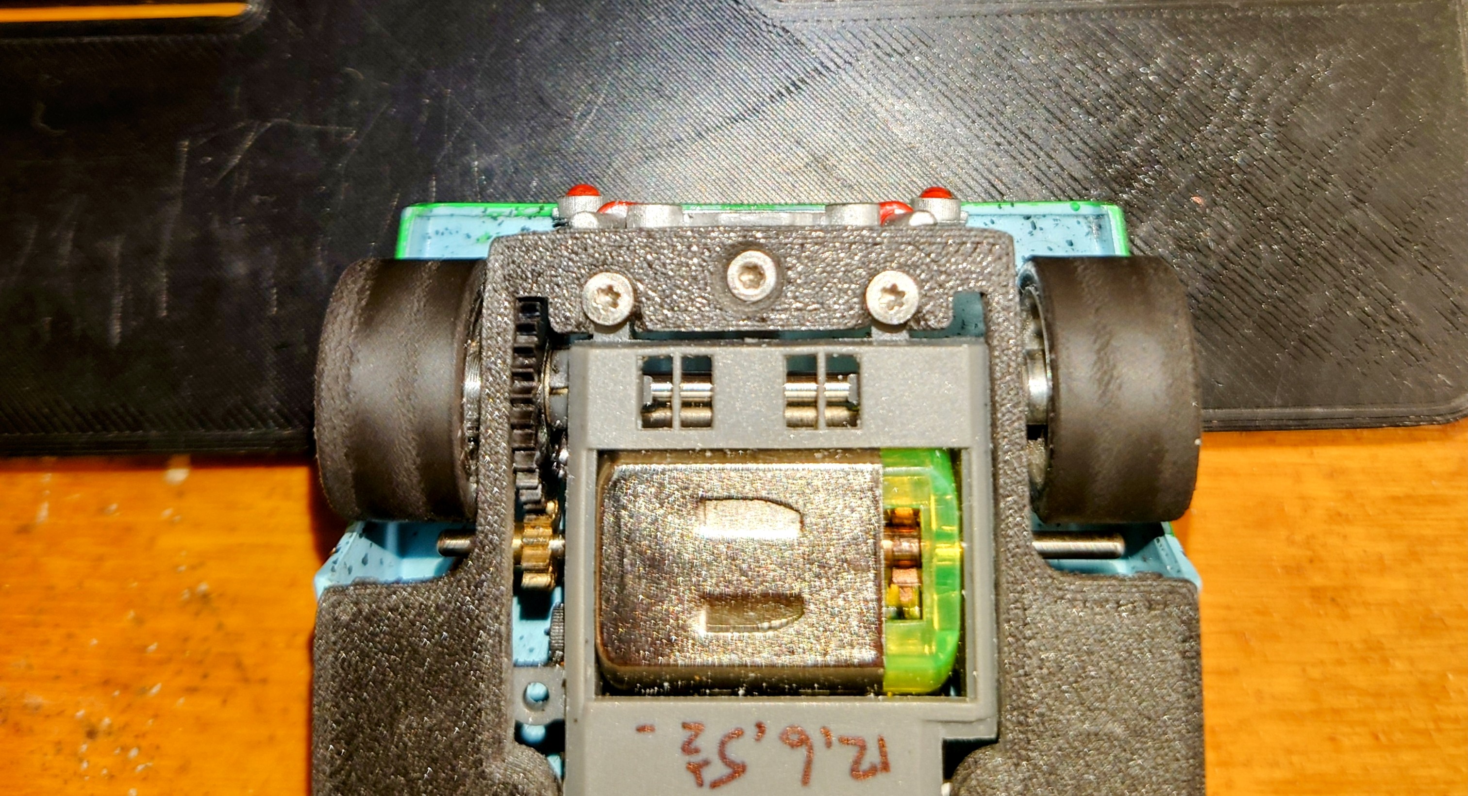

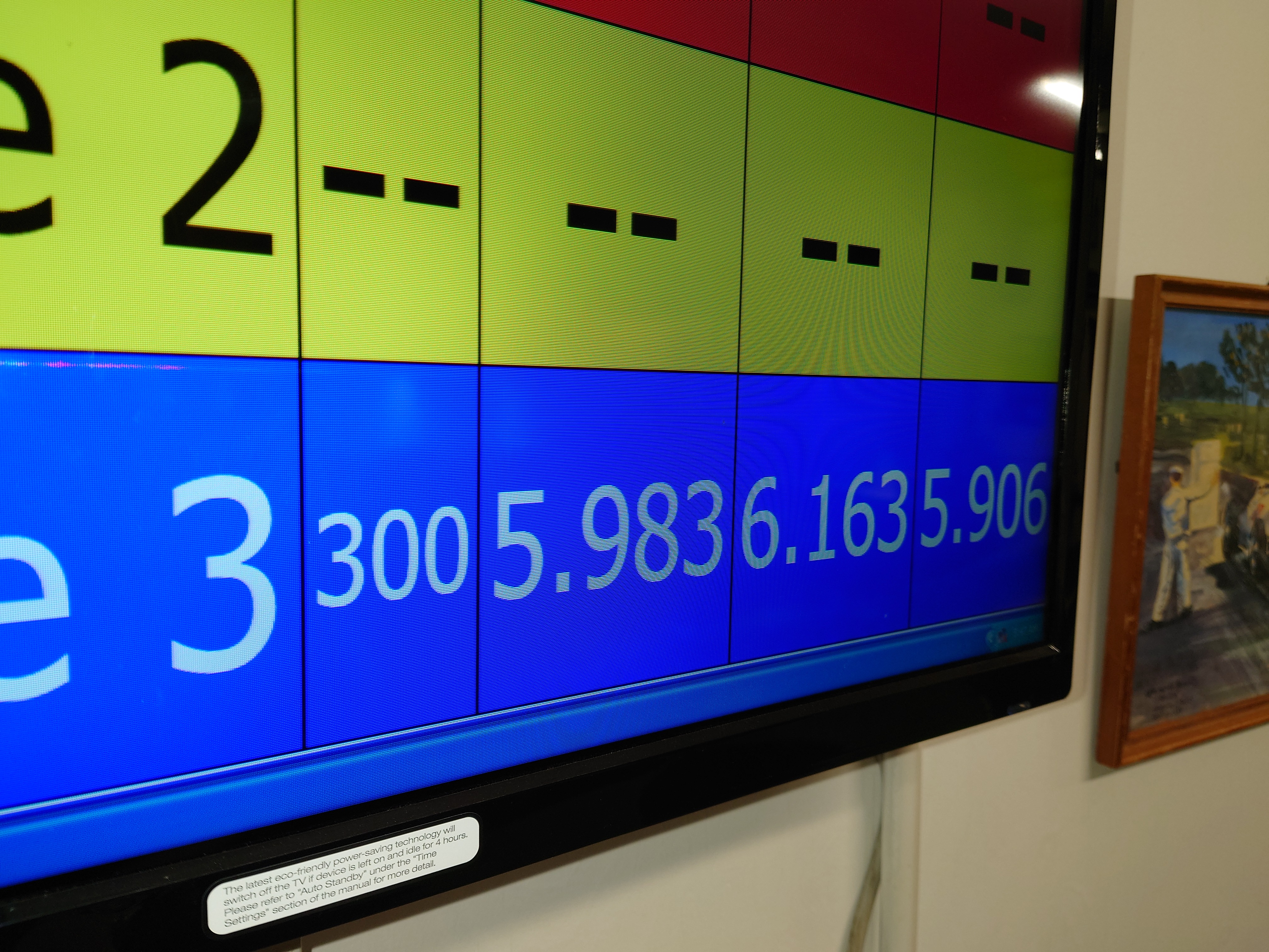

Then I ran another 100 laps in 33 lap segments, fastest laps was 5.906 which is as good as this car has gone on treated original Ultragrips. The rubber cleaned off the tyres on the tape is 300 laps worth.
[attachment=40765]  [attachment=40767]

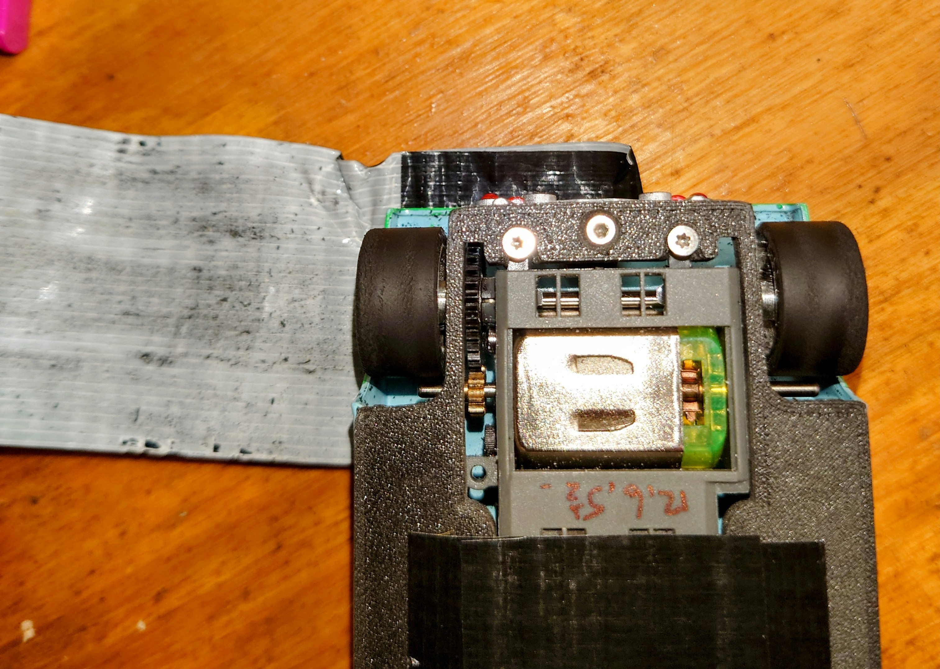

Then I ran 100 laps non stop...fastest lap didn't improve but regular 5.9's is excellent. Rubber cleaned off the tyres is shown on the tape.
[attachment=40768]  [attachment=40769]
