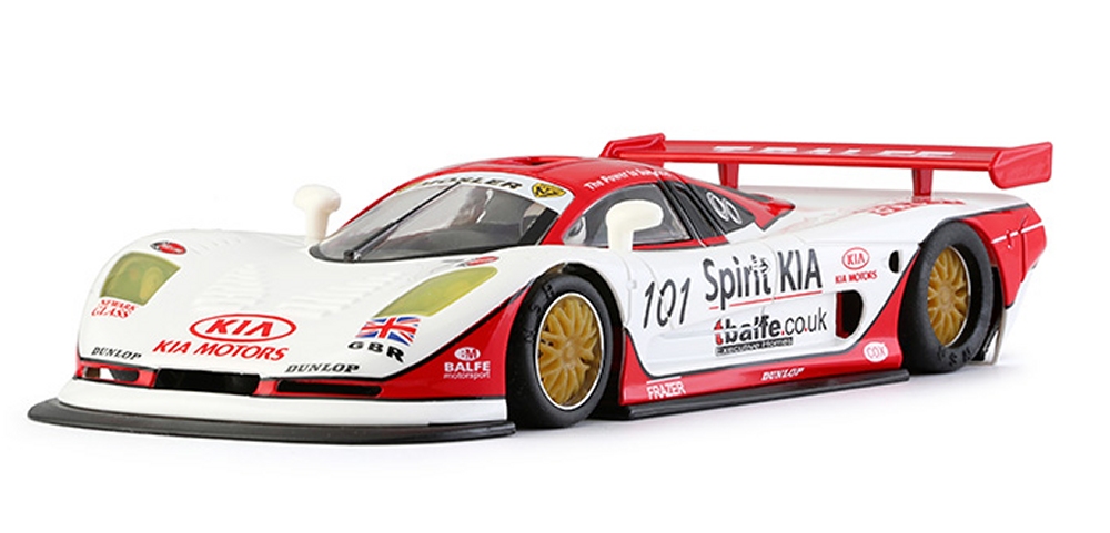

Before:
[attachment=1932]
After:
[attachment=1934]
Just my opinion but the exposed alloys look SO much better than the cheap looking plastic inserts.

Yes, the option was to paint them but on the Mosler the alloy rims look great!
The inserts were easy to pop and do then present another option. The cylindrical part that slips into the wheel could be trimmed down, less on the front wheels, more on the back, to leave more of the alloy rim exposed, giving the appearance of different offsets to the wheels front and back.
Along with painting the inserts gunmetal, black or gold I think this would make a significant improvement!
