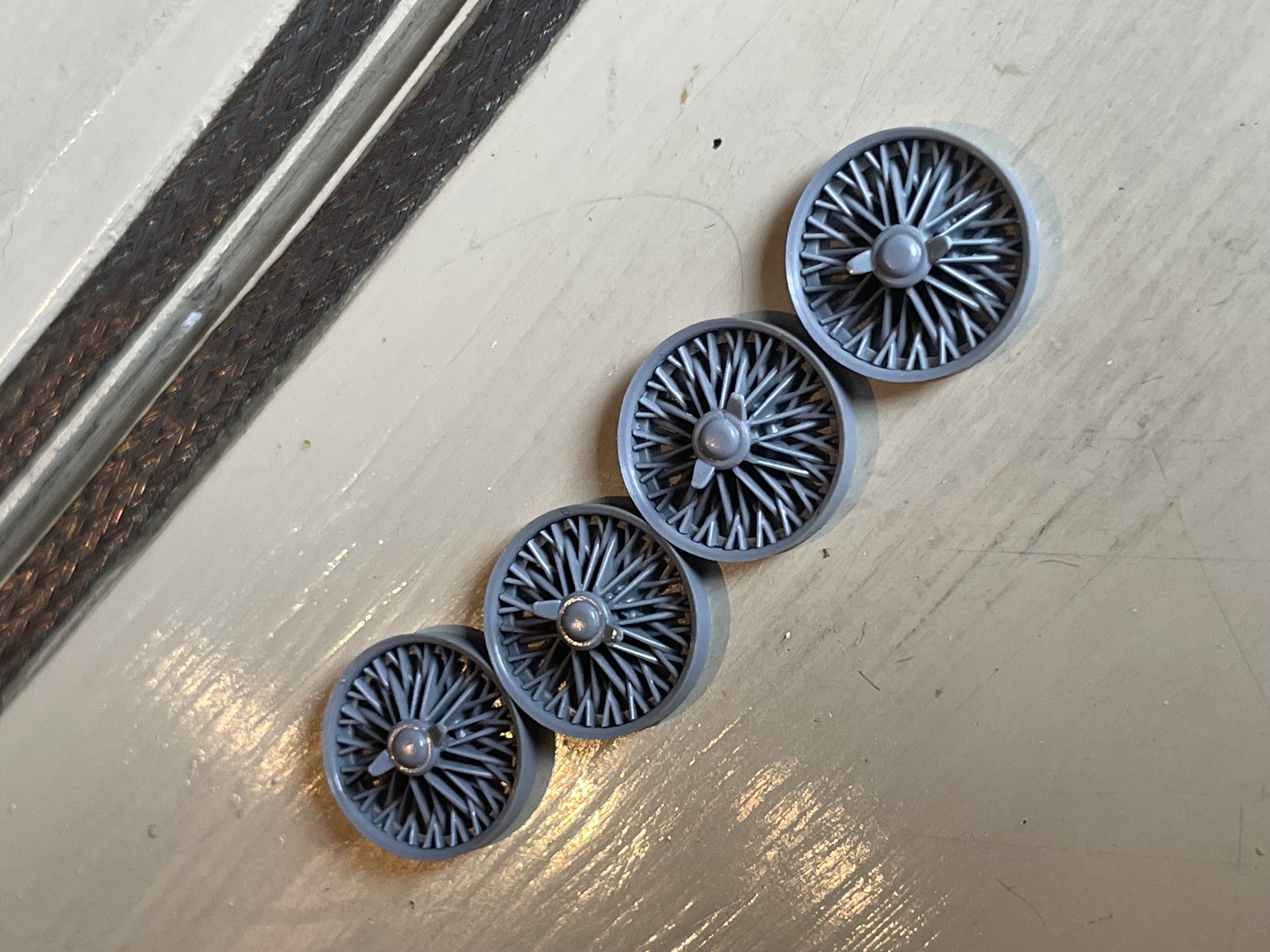

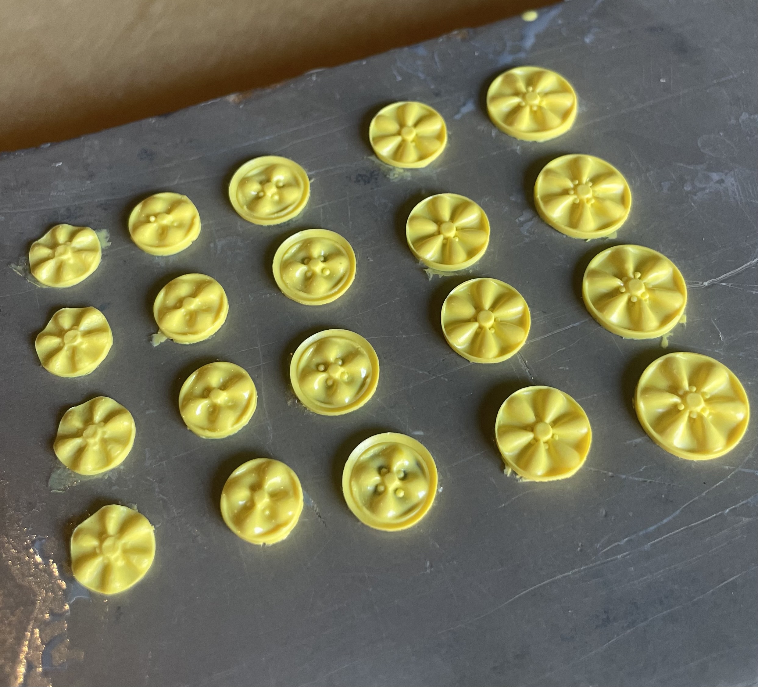

[attachment=39004]
[attachment=39005]
Your resin supplier should have appropriate tints to suit the resin that you are using.

munter - munter - 14th-Jan-25
I have used a small amount of black tint in the past with success but dropped that when I saw the supplier offered a genuine grey.
The inserts in my previous picture are tinted and I have not had trouble with paint adherence when I do paint things.
