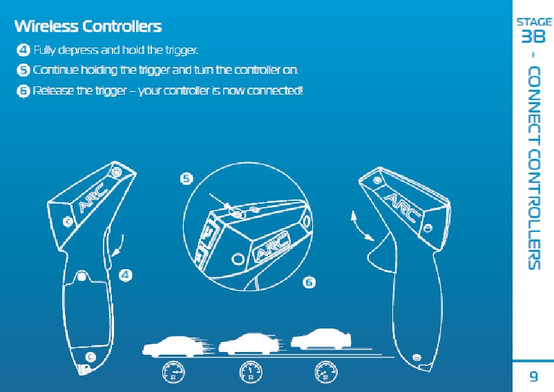

My problem is that when I try to connect it to yellow it flashes green twice but
doesn't actually connect to the Arcpro power controller. No green light permanently on under yellow, Similar problem with the other colours.

Keith - it's a very specific process to bind a throttle to the powerbase, which can be found on pages 8 & 9 of the ARC Pro Quick Start Guide...
[attachment=38893]
[attachment=38894]
That's the same process for connecting a new controller or moving an existing controller to another colour. So if the other two connect to yellow successfully, the new controller is probably faulty.
