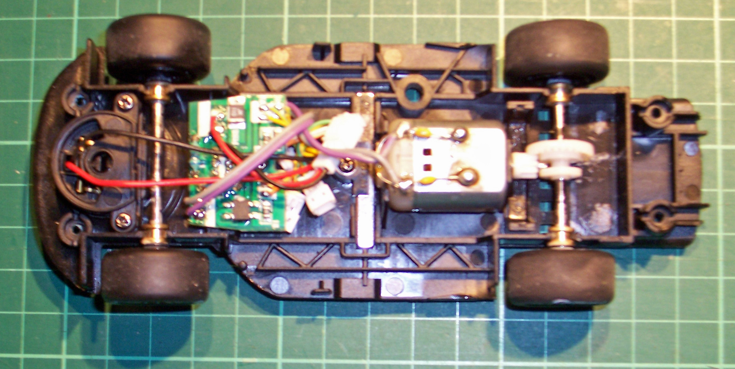

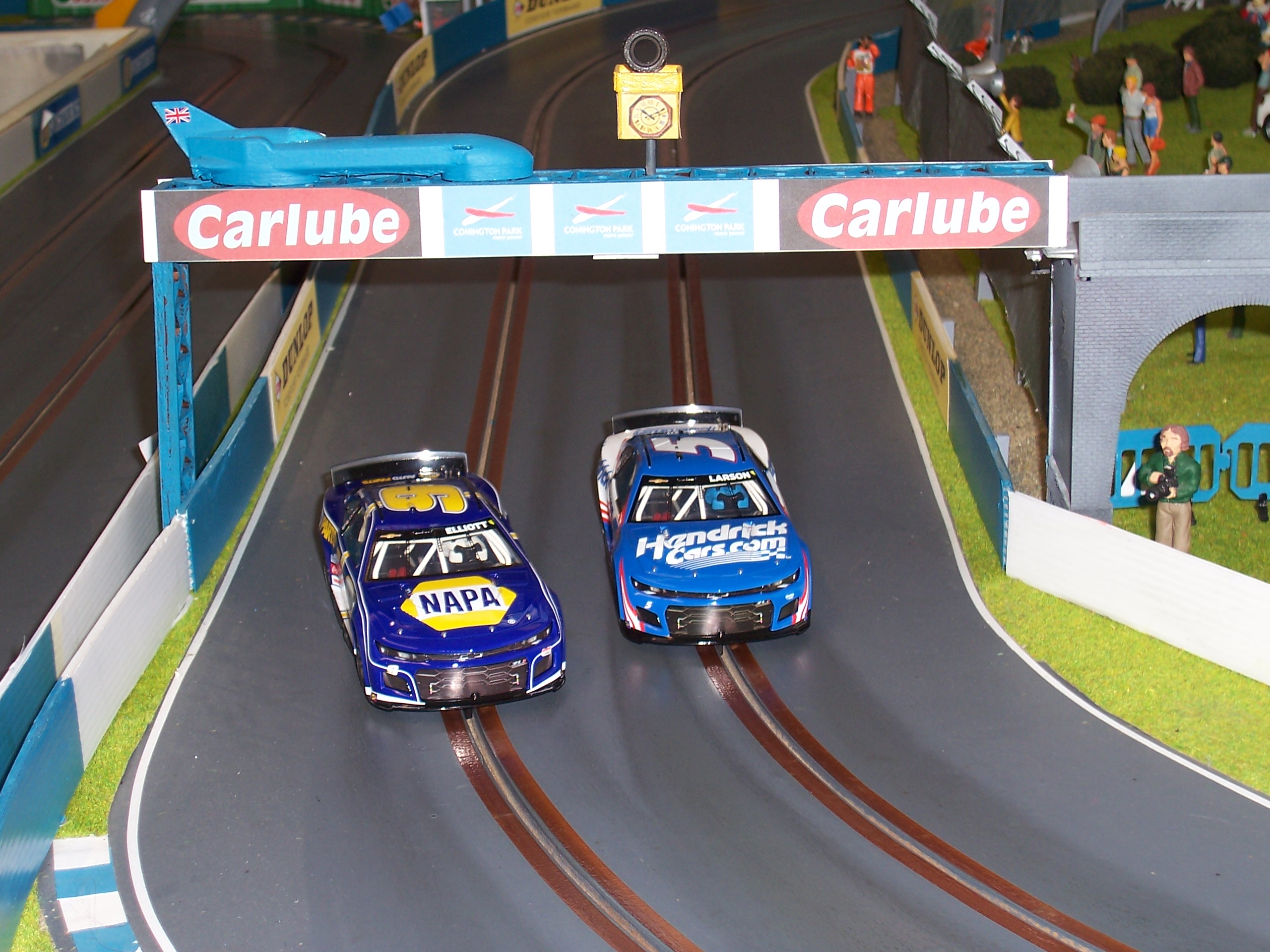

As usual they are a hefty bit of kit with the standard Carrera hallmark of a reverse polarity switch for running the other way round the track. However, there appears to be something like a digital chip fitted at the front end. They are definitely both analogue cars which work just fine on my track and, as with the full size car, there are no lights fitted so what is this stuff? Anybody know?
So far so good but.......

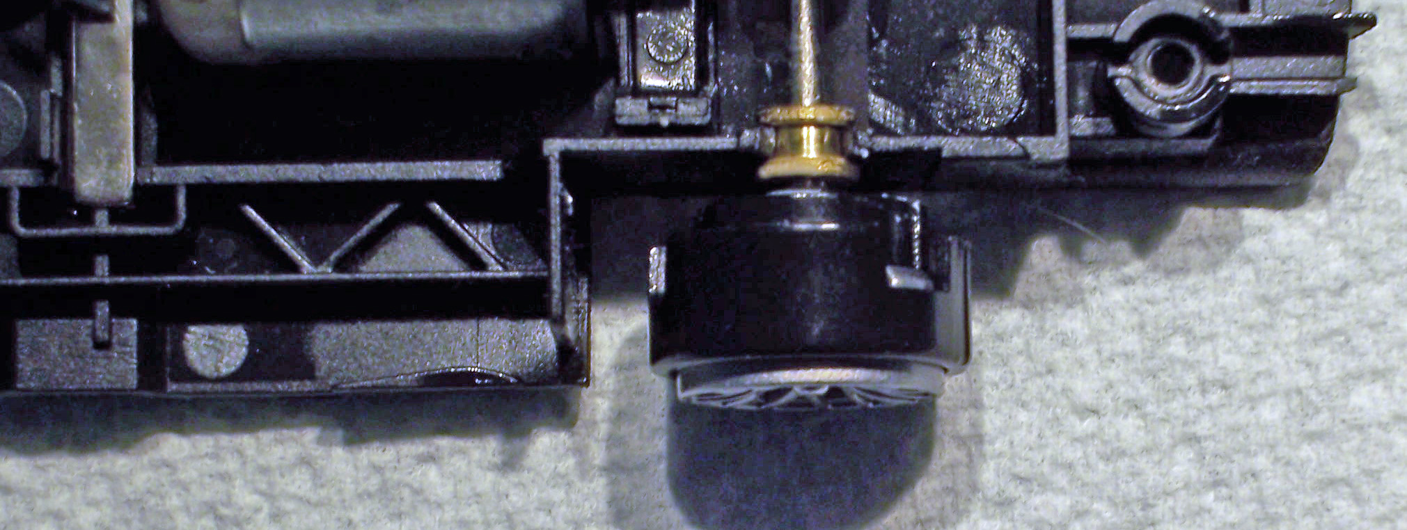

I am pleased to report not a single quality control issue with them, just wish other manufacturers could approach their build standards but inevitably we come to a major downside - the wheels and tyres. First off they have put Carrera labelling on the tyres, talk about spoiling the ship for a ha’p’orth of tar! Having no doubt spent a small fortune on a NASCAR licence surely they could have forked out a smidgen more for a Goodyear one?
On the track, as expected, there was virtually no grip and they slithered their way round my 50ft lap in slightly under ten seconds. A box standard Scalextric car can usually manage under seven seconds so this was particularly bad. Now there is very little you can do to improve things with Carrera tyres as any application of oil usually results in them turning to complete mush in a very short space of time so I would normally replace them with Paul Gage urethanes. This is where things get really bad though, they have non standard size wheels with a different diameter shoulder on each side so there is currently no direct replacement available.
[attachment=38999]
Until Paul comes up with some suitable tyres I am afraid these lovely cars will therefore stay as shelf queens for the present but if you have plastic track I am sure they will perform perfectly well, magnets can hide a multitude of sins!

(13th-Jan-25, 03:48 PM)CMOTD Wrote:  As usual they are a hefty bit of kit with the standard Carrera hallmark of a reverse polarity switch for running the other way round the track. However, there appears to be something like a digital chip fitted at the front end. They are definitely both analogue cars which work just fine on my track and, as with the full size car, there are no lights fitted so what is this stuff? Anybody know?

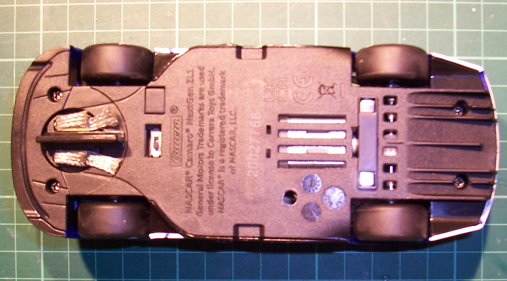

Wow. That checks all the boxes for a digital chip. You didn't show the bottom of the chassis, but I assume you've checked for an LED and found none?
The digitally chipped car will work fine on analog, though usually with full brakes all the time, depending on how the brakes work on your controller. PWM braking can sometimes work on their chips.
RE: Carrera Next Gen NASCAR - CMOTD - 4th-Feb-25
No LED on bottom:
[attachment=39379]
The brakes are fully adjustable as normal with both PWM and non PWM controller. I have also seen an unboxing video on YouTube which  shows the same thing on another analogue version of the same cars so it seems to be standard, not some production error and both my cars have the same thing fitted.
RE: Carrera Next Gen NASCAR - MrFlippant - 4th-Feb-25
Perplexing.
Does that other review show the other side of the chip?
If not, would you be willing to unmount it and show the underside of the chip?
