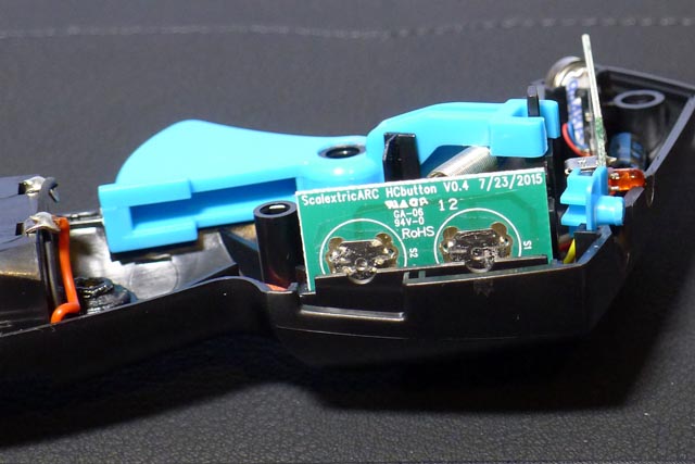

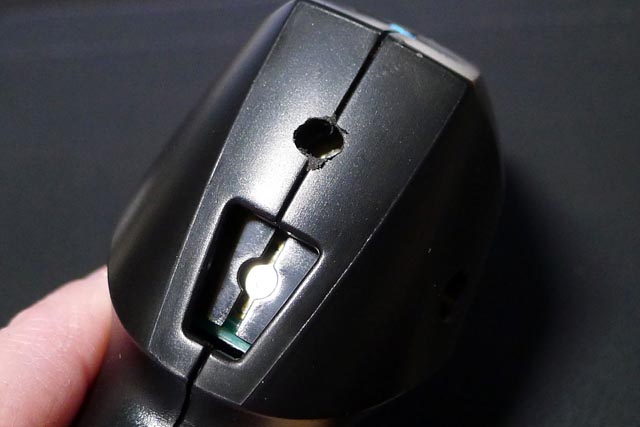

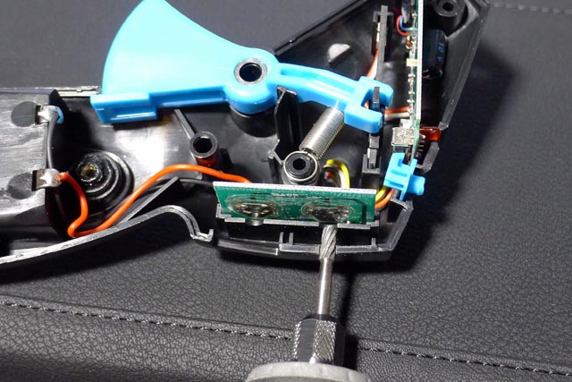

These are the innards of an ARC controller (ARC and Pro are identical electronically)...
[attachment=37767]
[attachment=37768]
[attachment=37769]
If you have a spare Prof Motor / Truspeed / SCP handle, it would be an interesting, but challenging project to transfer the ARC electronics and use the superior trigger and spring tension that is more to your liking. However, I think Brian's suggestion of a 3D printed handle is well worth considering.
