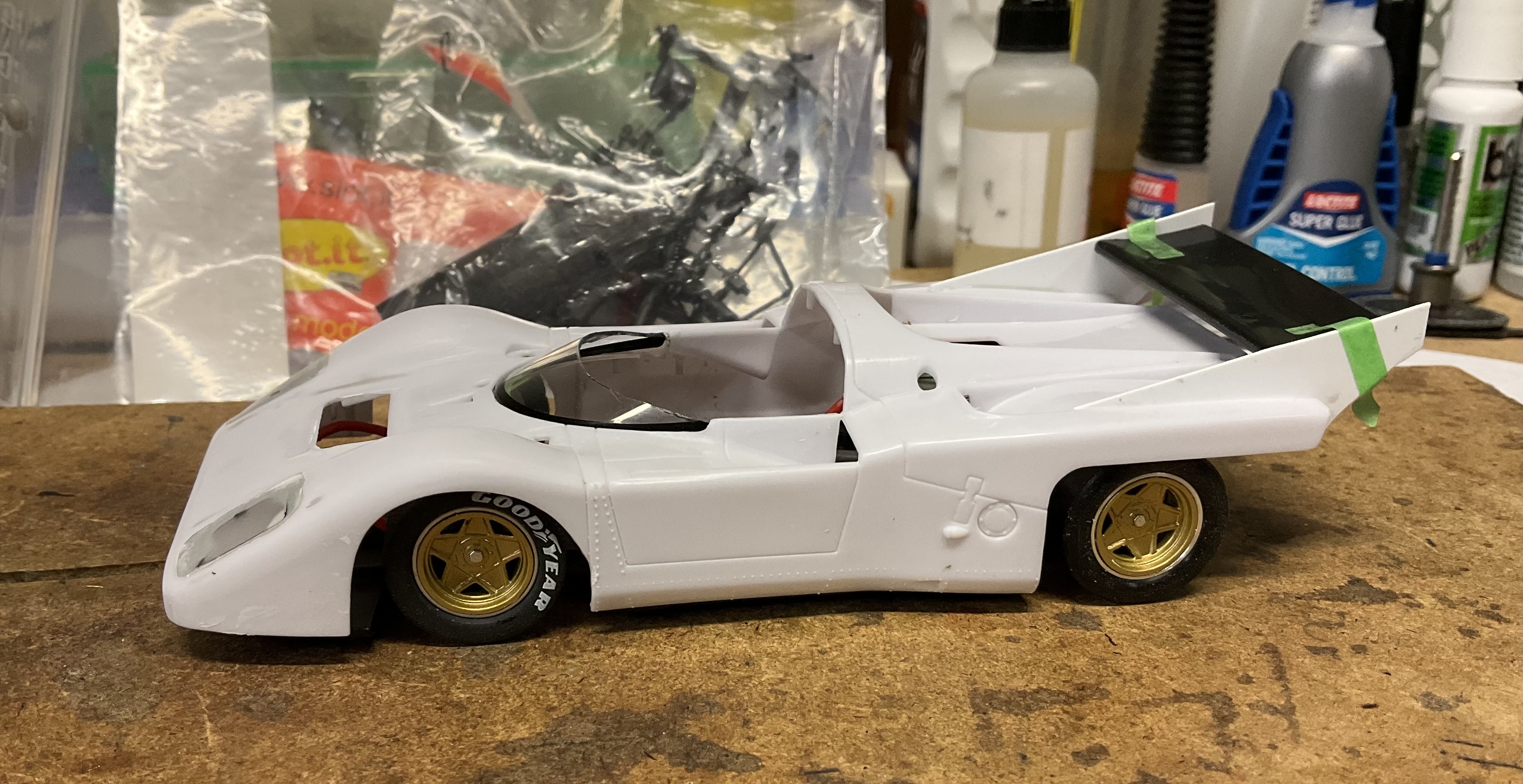

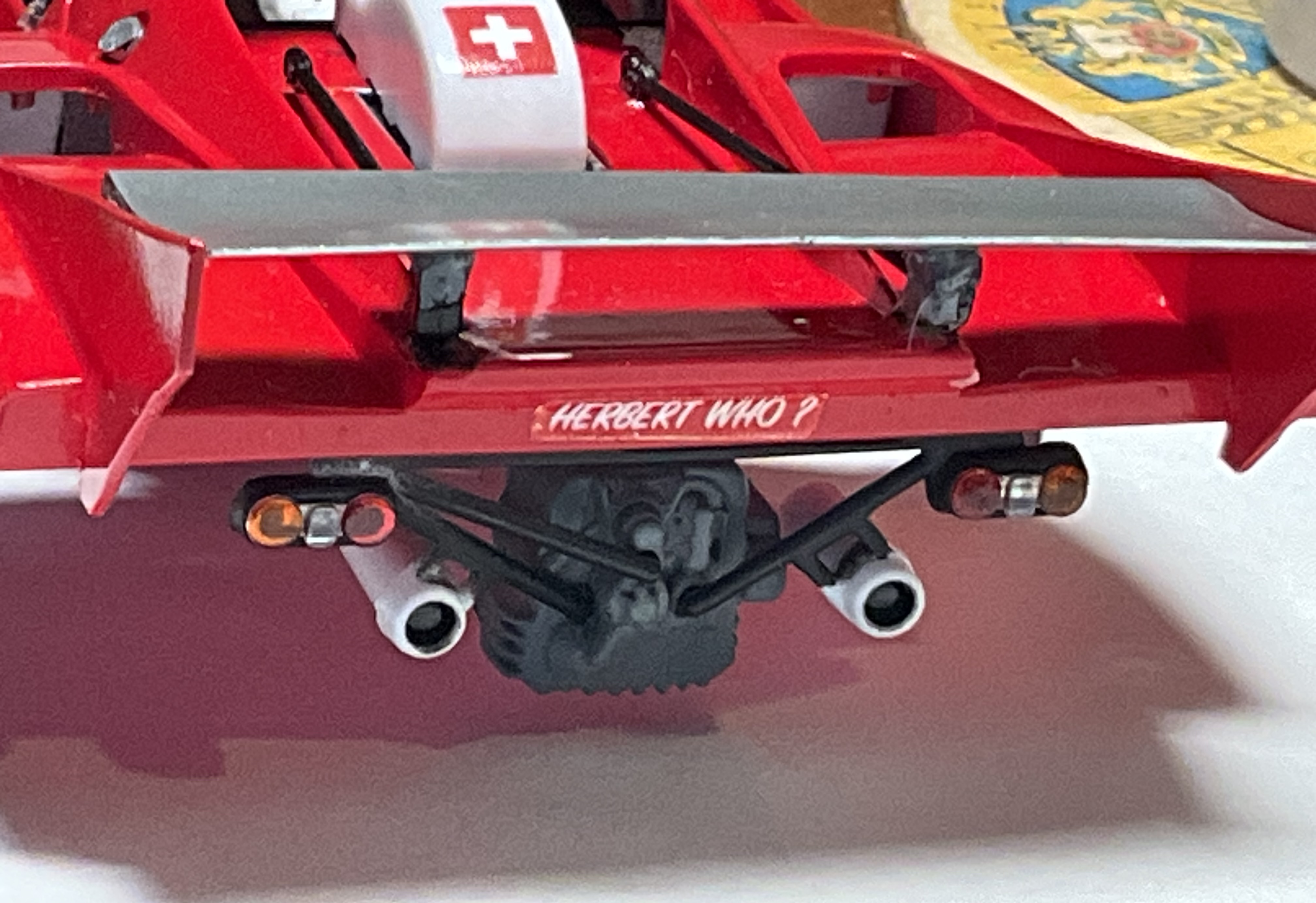

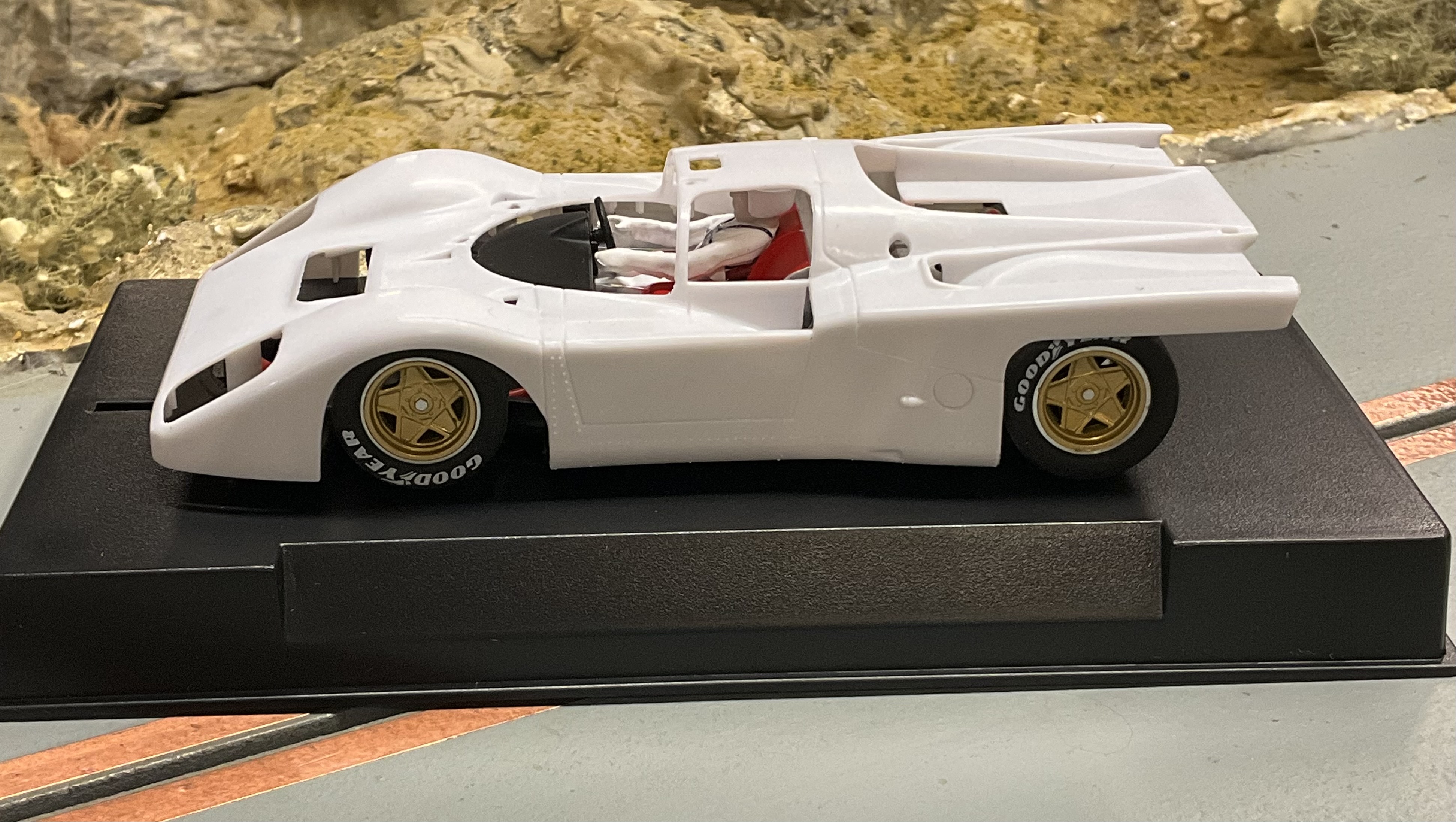

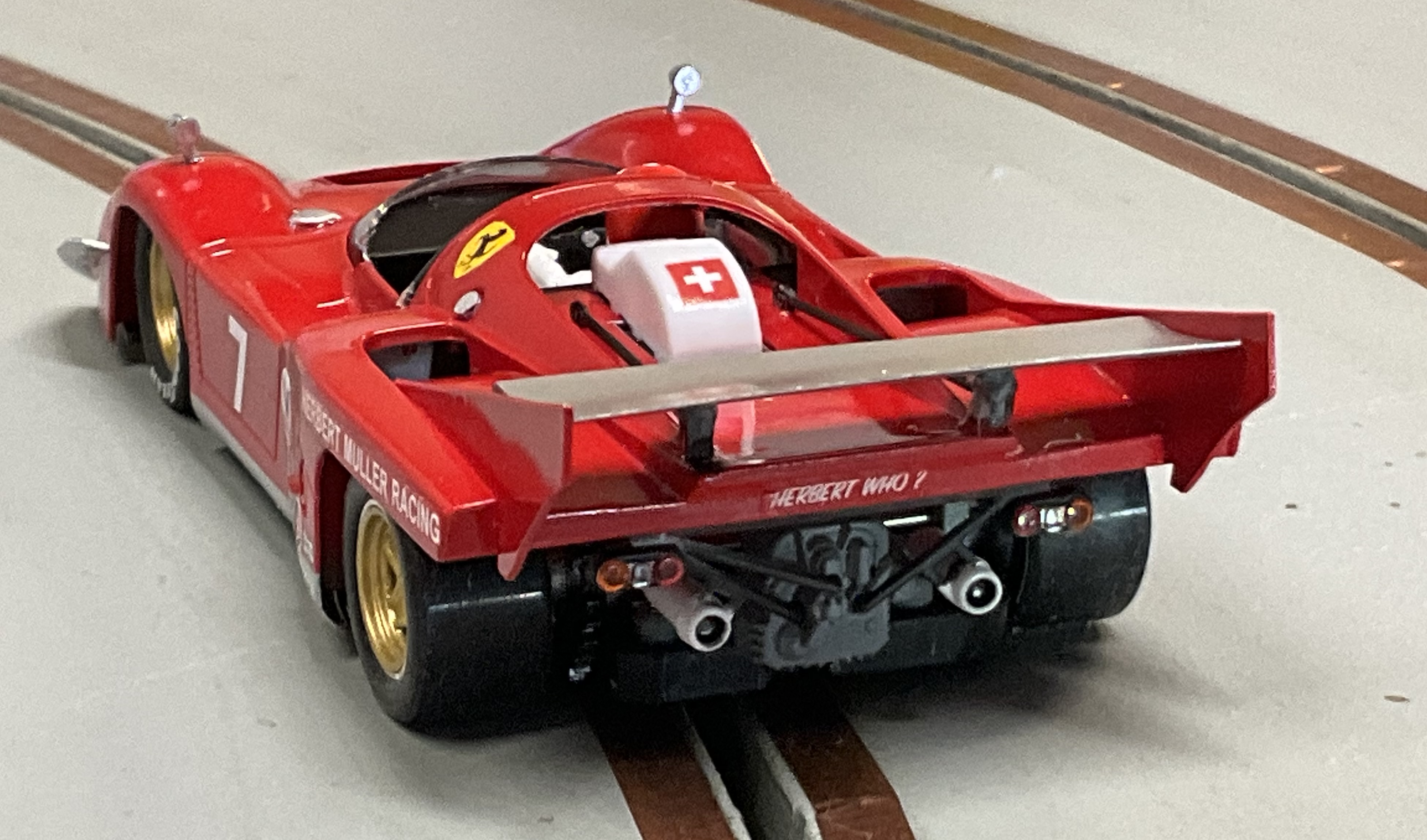

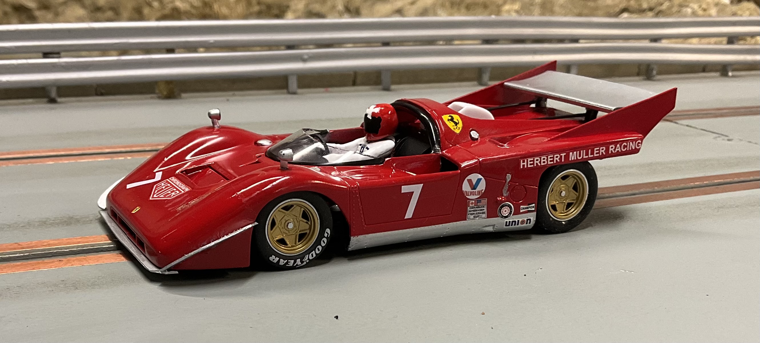

For Anthony B. This Can-Am car was the inspiration for a slot.it white kit conversion.
[attachment=36917][attachment=36918][attachment=36919]

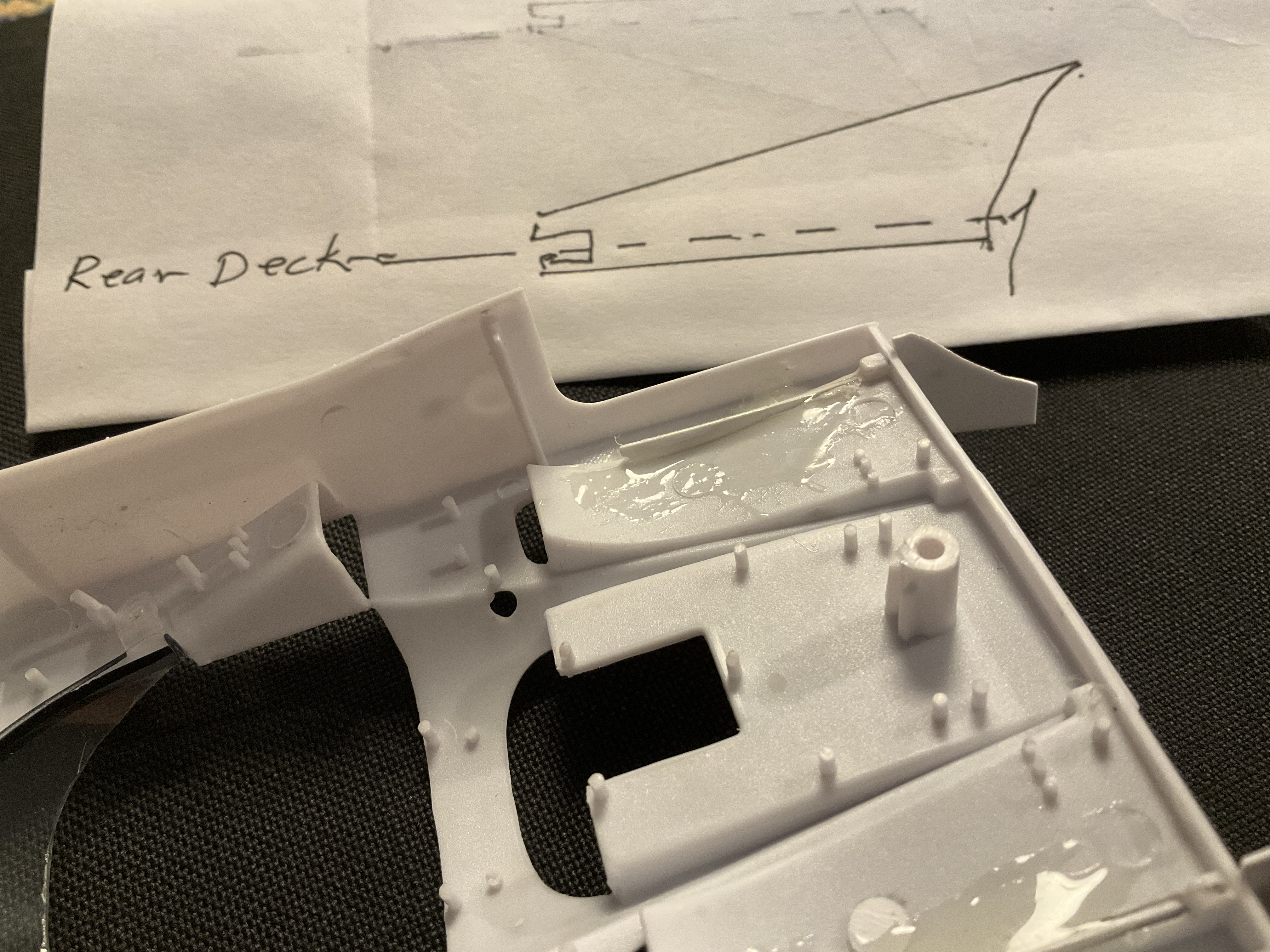

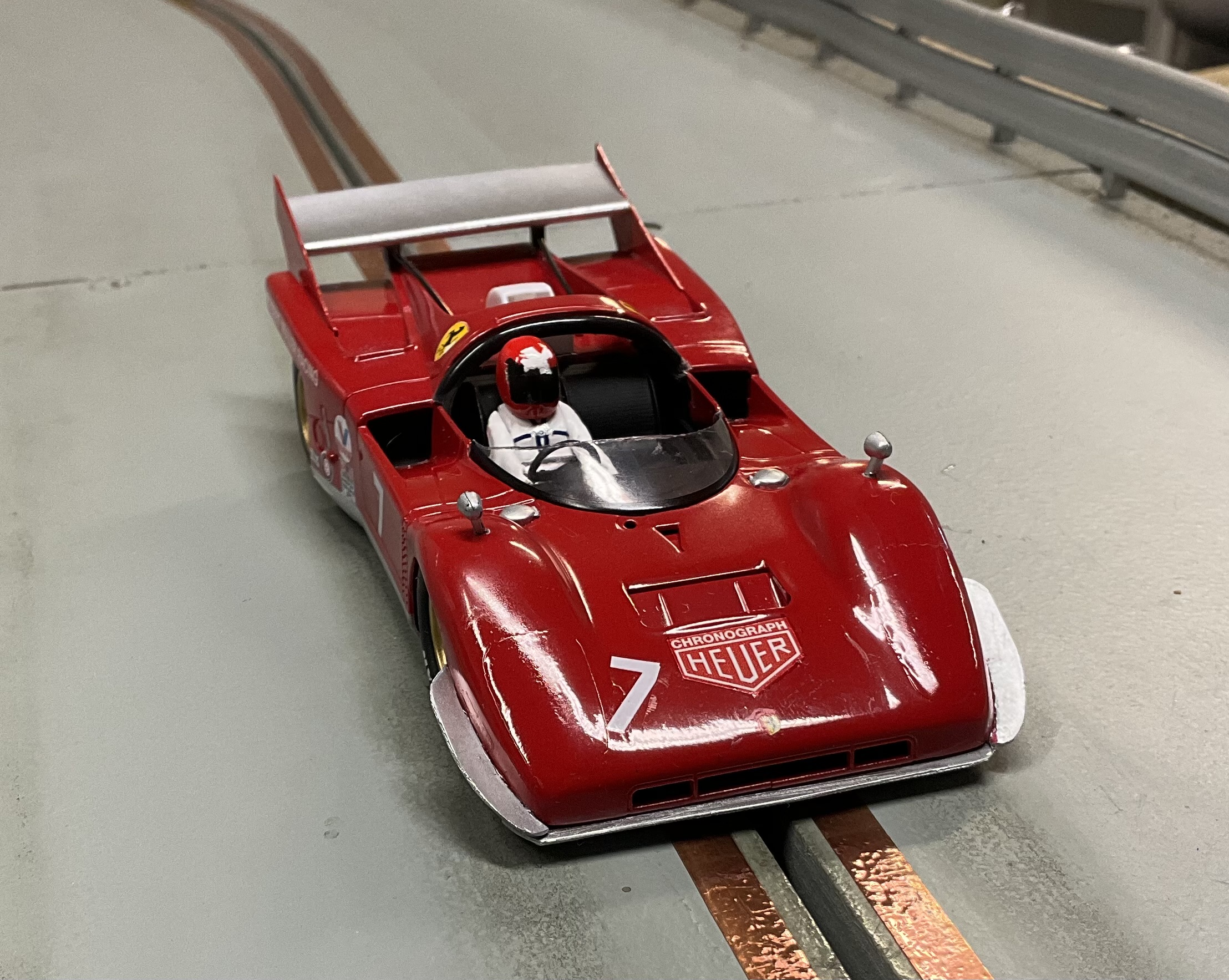

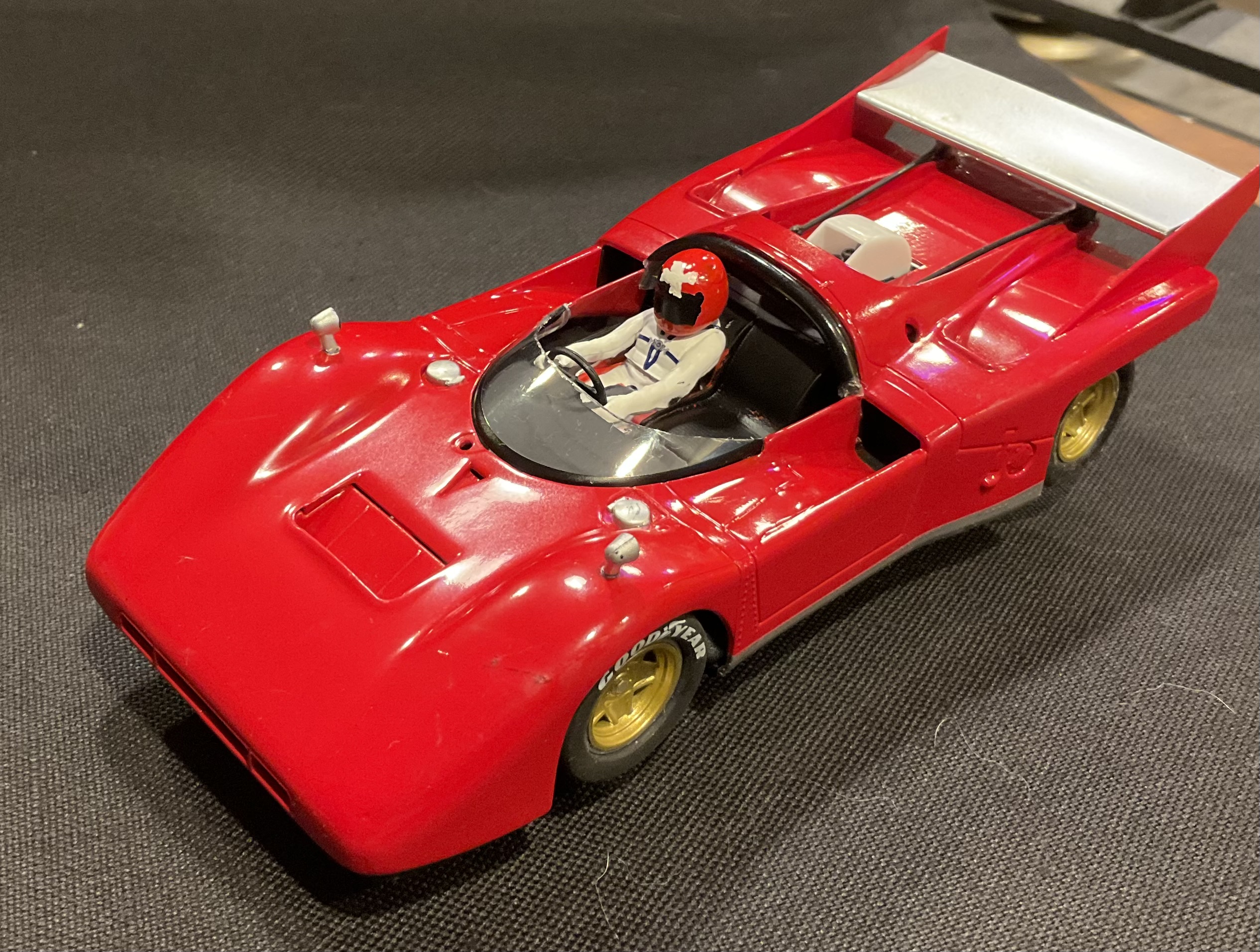

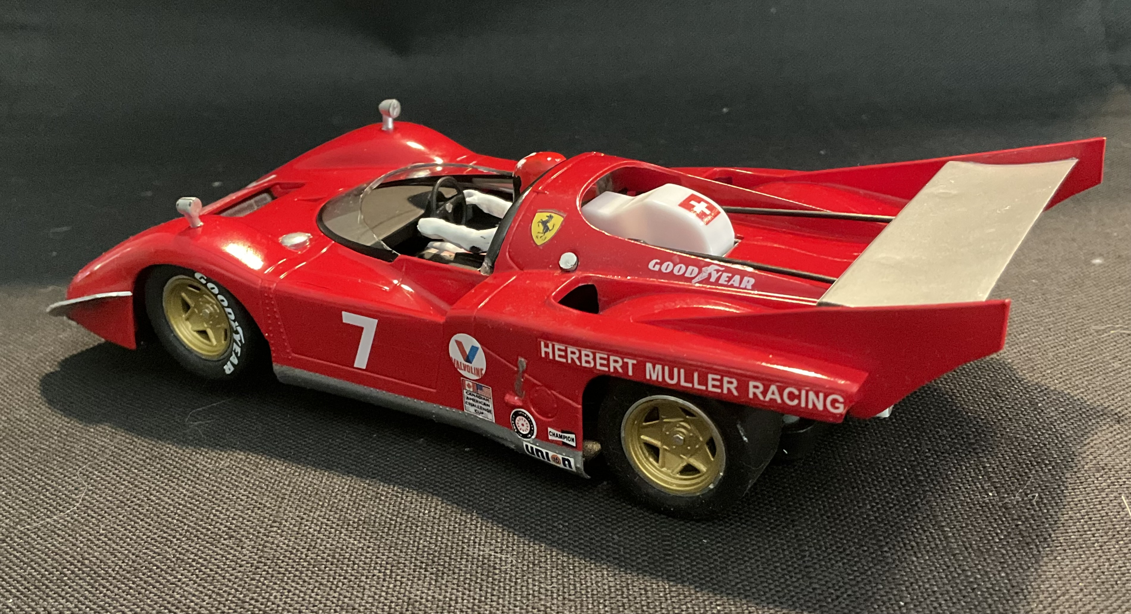

A pretty straight forward chop job. Rear wing supports and front spoilers from sheet styrene. Rear wing with supports and mirrors from a slot.it bag of McLaren bits. Thick roll bar is a black copper wire with most of the strands removed. The decals are homemade except Goodyear and Ferrari logos from a Mitoos F1 sheet. Paint is Tamiya TS Italian red and silver leaf. 10 mm rear wheels and tires in place of stock.

GReat Job Mickey!!!
It was only after I asked the question yesterday that I realised you used a Slot.it/Policar as a base - still nice job on the rear wing - cutting the body and inseting the uprights - HMMM - gonna have to do one!!!
THANKS for sharing. Thumbup Thumbup Thumbup
PS did you do your own decals? Could you share the file?
RE: Ferrari 512M Spyder - Kevan - 27th-Aug-24
I like it too and would look different to every other on the track
