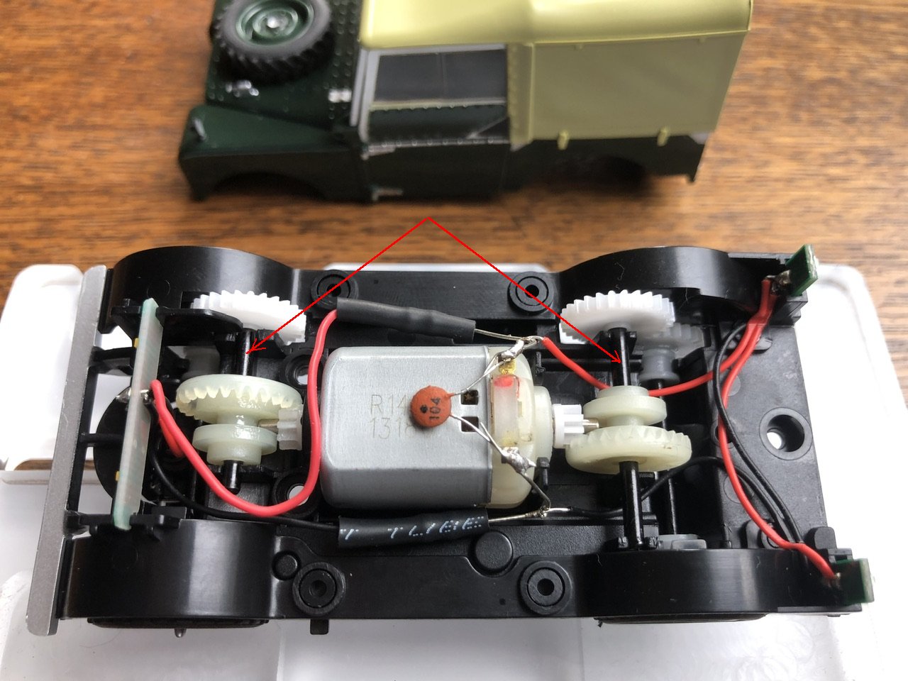

The recent Land Rovers from Scalextric/Hornby seem to have an interesting drive-train with both axles driven by spur gears.
Can anyone please share photographs that show the details of this drive-train arrangement?

Dr_C - Dr_C2 - 28th-May-24
[attachment=35552]
RE: Dr_C - Scuderia_Turini - 28th-May-24
Thank you Dr_C,  that is super helpful.

Since this is picking up interest, I wold be interested to know what the overall gear ratio is. Presumably standard Scalextric 9  tooth pinions are fitted, but is the overall ratio their standard 3 to 1 ?
I have just pre-orderd a red one, but in the meantime...
Thanks to all for contributions and thoughts.
RE: Scalextric Land Rover Series 1 - Dr_C2 - 30th-May-24
After lots of counting of teeth…
pinion gear = 9 teeth
crown gear = 27 teeth
intermediate gear = 27 teeth
drive axle gear = 27 teeth
So yes, the transmission ratio motor-to-wheels is 1:3 (teeth) or 3:1 (rpm).
And, a further yes - removing the intermediate shaft assembly appears to be the easiest way to disengage four-wheel-drive.
