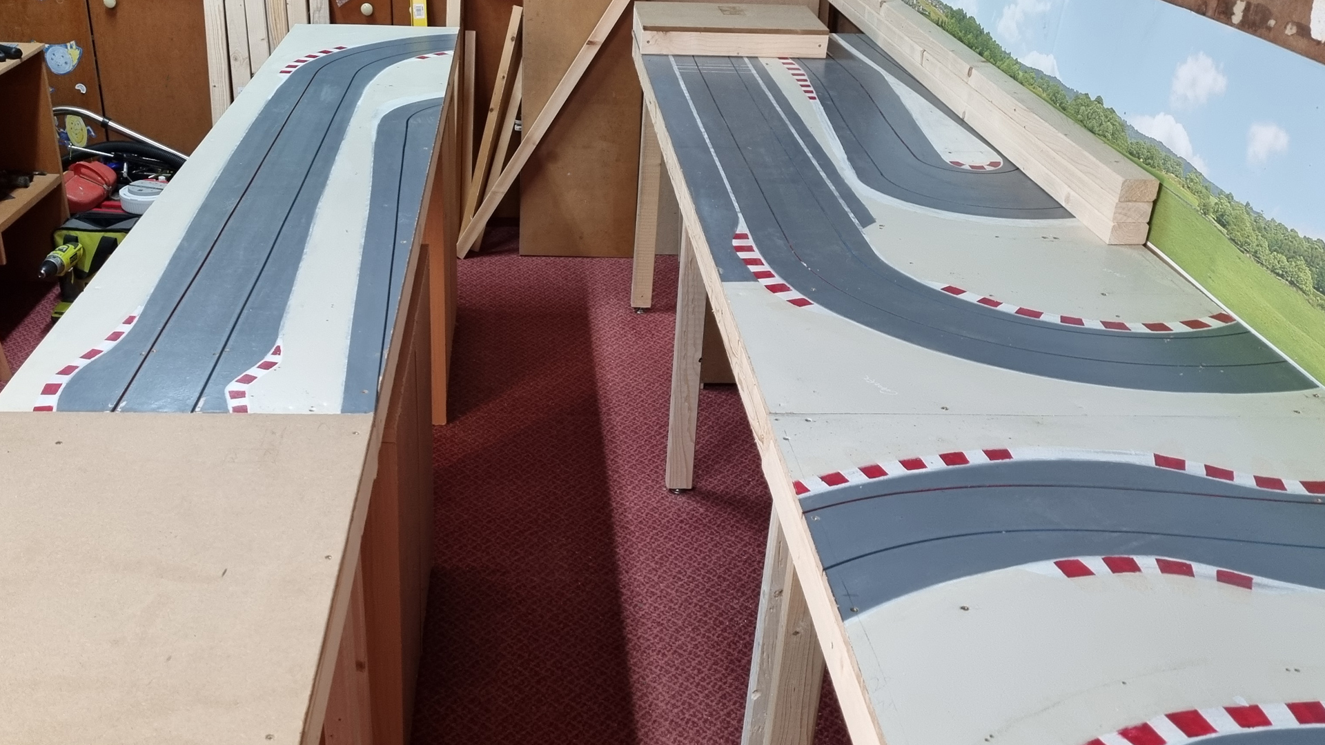

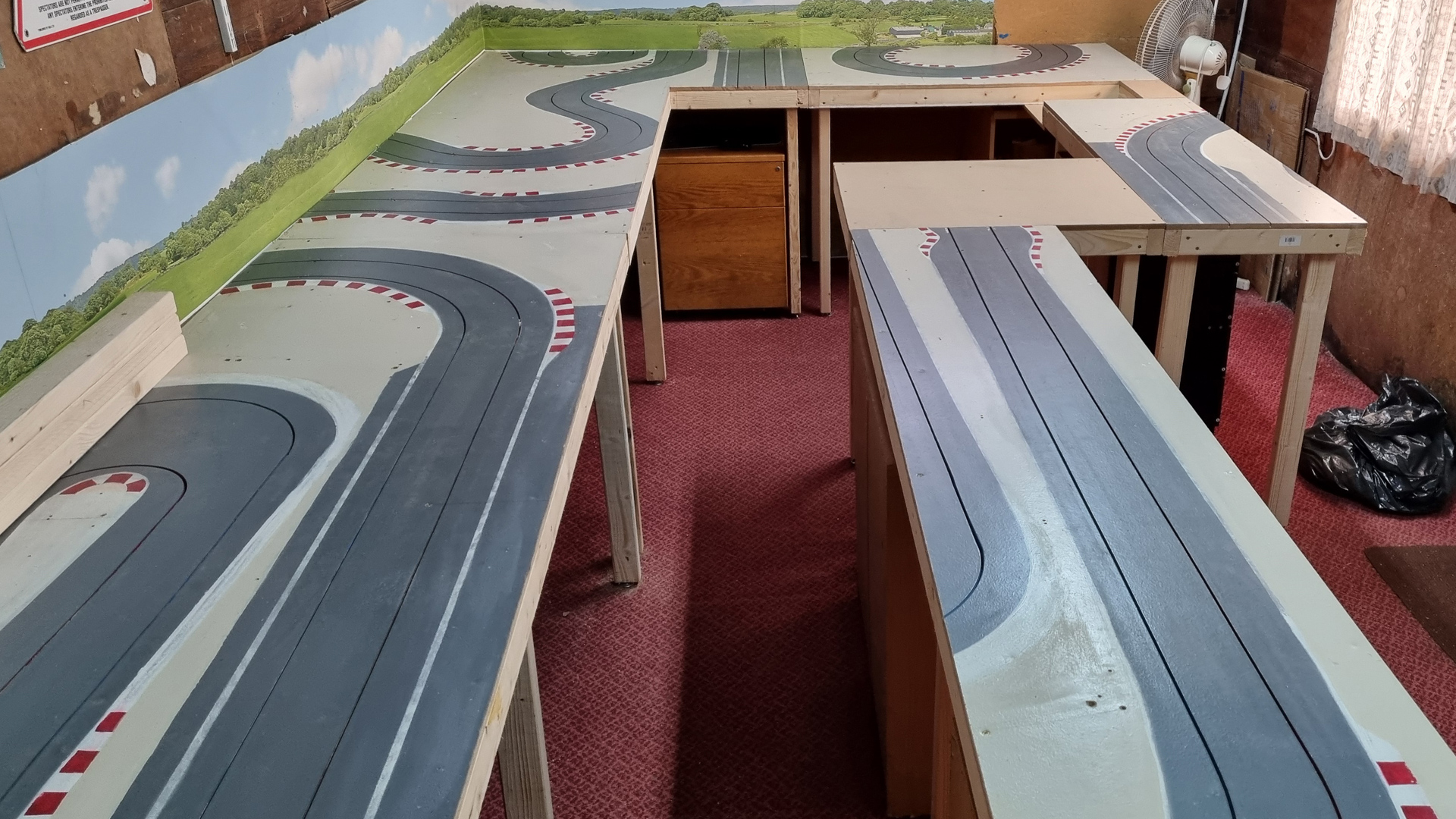

But after cutting the slot car track boards up, I discovered  there was an amount of droop on the MDF, nothing to worry a Slot car, but 00 scale Loco's are more fickle !
So I doubled up on the bracing, forcing the  droops into something close to flat again, of course the bracing means more timber underneath where I may want to put point motors, we will cross that bridge later  Rofl
But most of the boards are in place now, the slot car backscene will likely be able to be re-used for part of the layout. The gap at the end will have a removable section so I can get access to the middle without crawling under the boards. This in turn will eventually h be filled in with foam boards and lightweight removable scenery.
I have yet to fill in the slots and tidy up the shed !

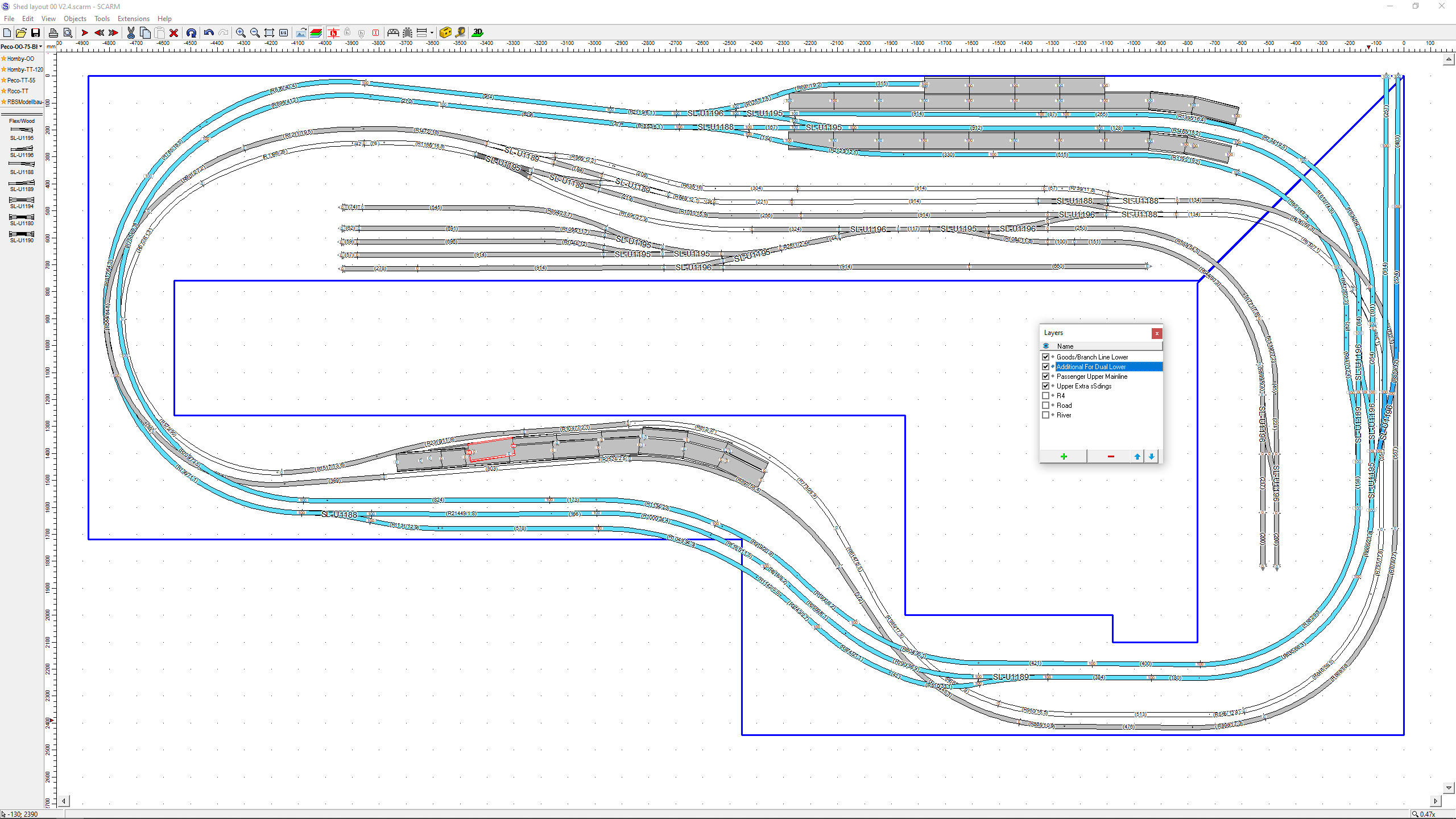

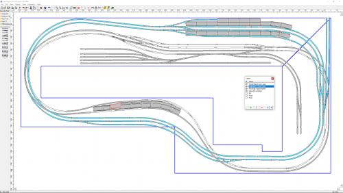

The plan is for a double height layout, effectively a separate lower level branch line and shunting/goods yard with access to the dock, a small station and a station by pass for the freight trains. This is shown as grey track on the plan. Both end curves will be hidden in tunnel or behind a false backscene.
The blue upper level is a dual mainline mainly passenger, but with provision for the odd express freight. It will feature a viaduct before the station and a metal bow bridge over the river entrance to the port.
No curve is tighter than an equivalent R4 except one in a siding. Obviously the plan will be tweaked to allow for point motors where these would be obstructed by an underboard batten, but I hope to be able to remain fairly close to the planned layout. all the roads etc are currently just for ideas and are likely to change.

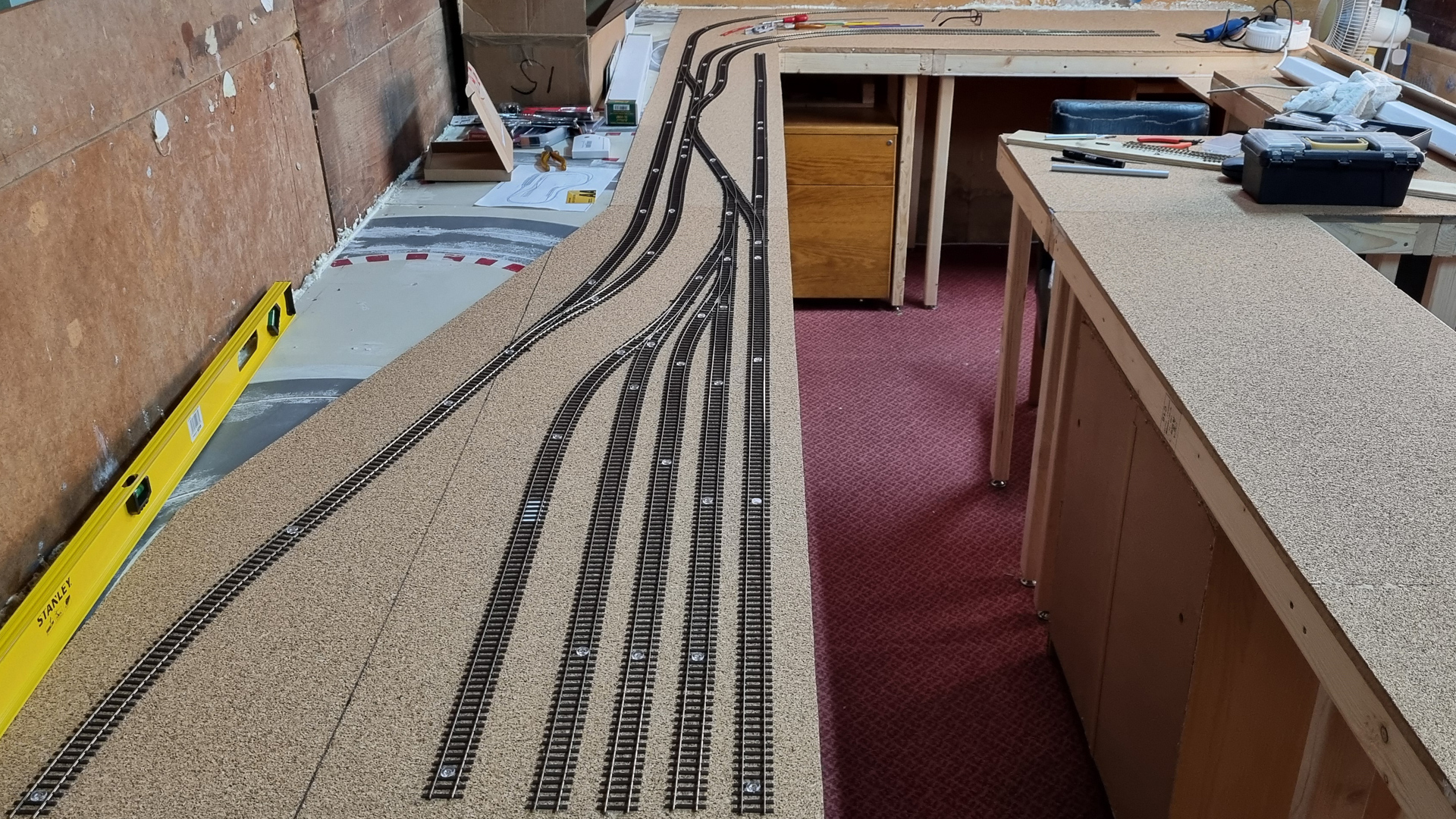

A slow burner for sure, but starting to make some progress now.

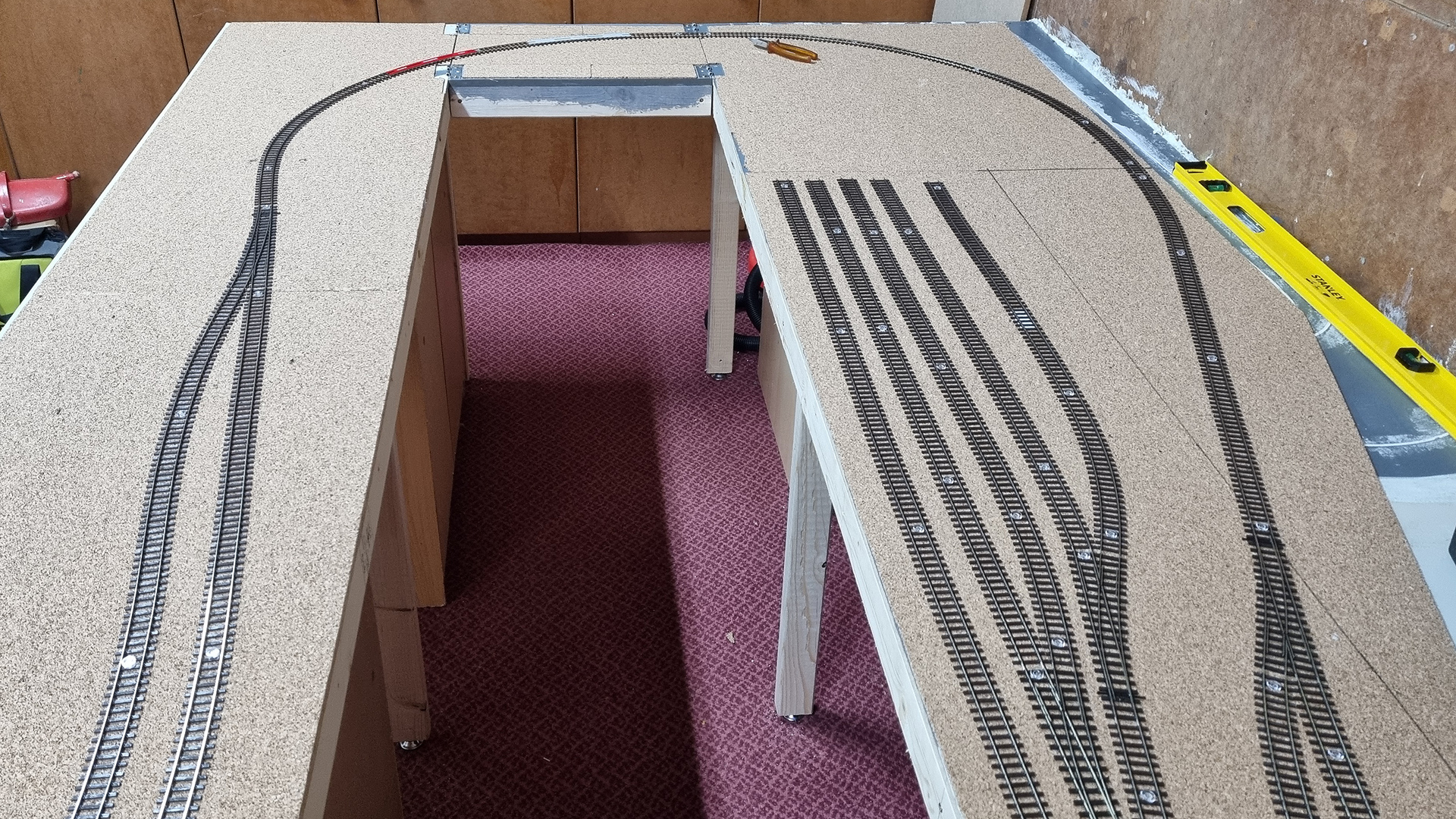

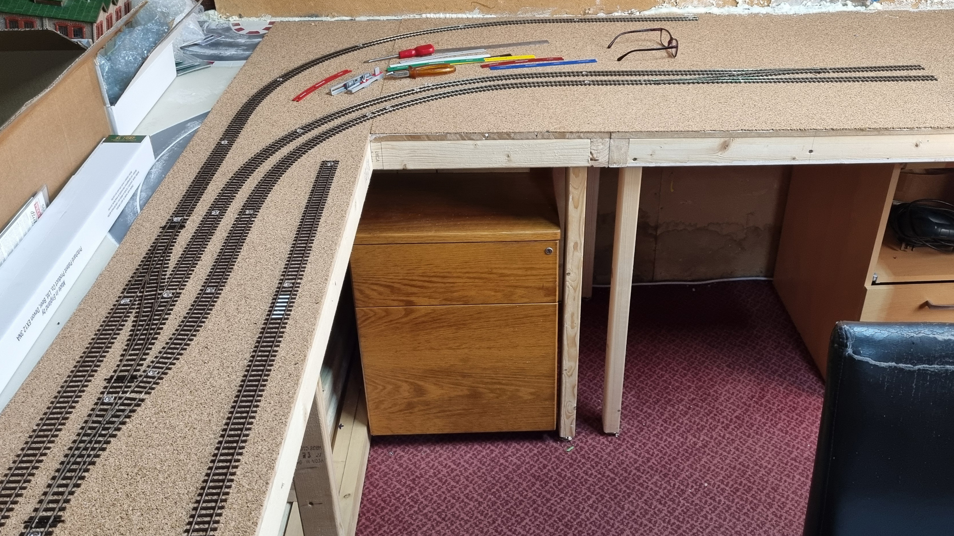

The shunting yard and dock area track cut, shaped and temporarily thumb tacked, very therapeutic that was, despite the fiddly track joiners testing both my eyesight and my fine dexterity  Bigsmile
Mind you, I am not looking forward to soldering the dropper wires on this lot, in particular the points. one false move and a very expensive bit of track becomes toast  Ambulance

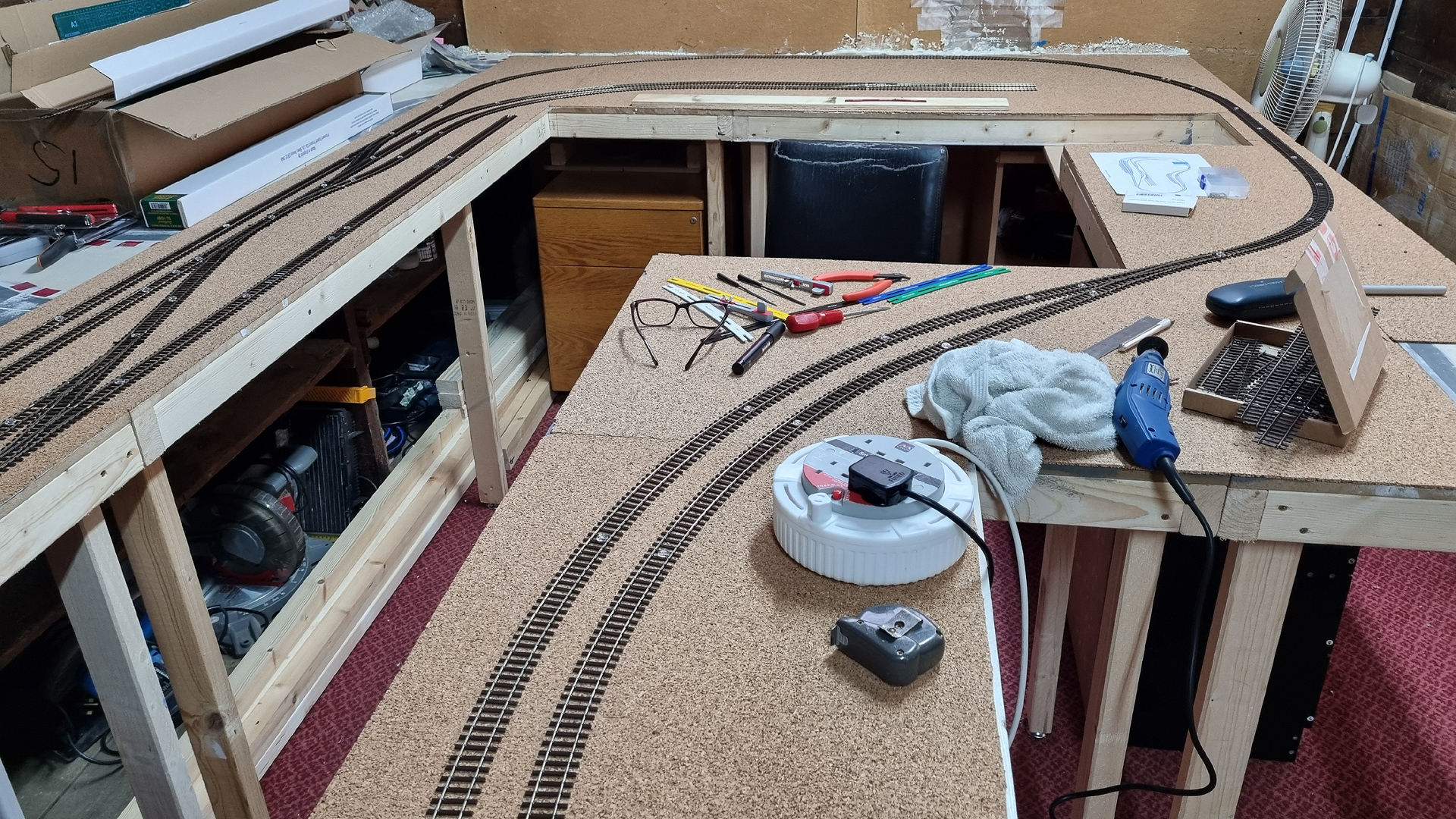

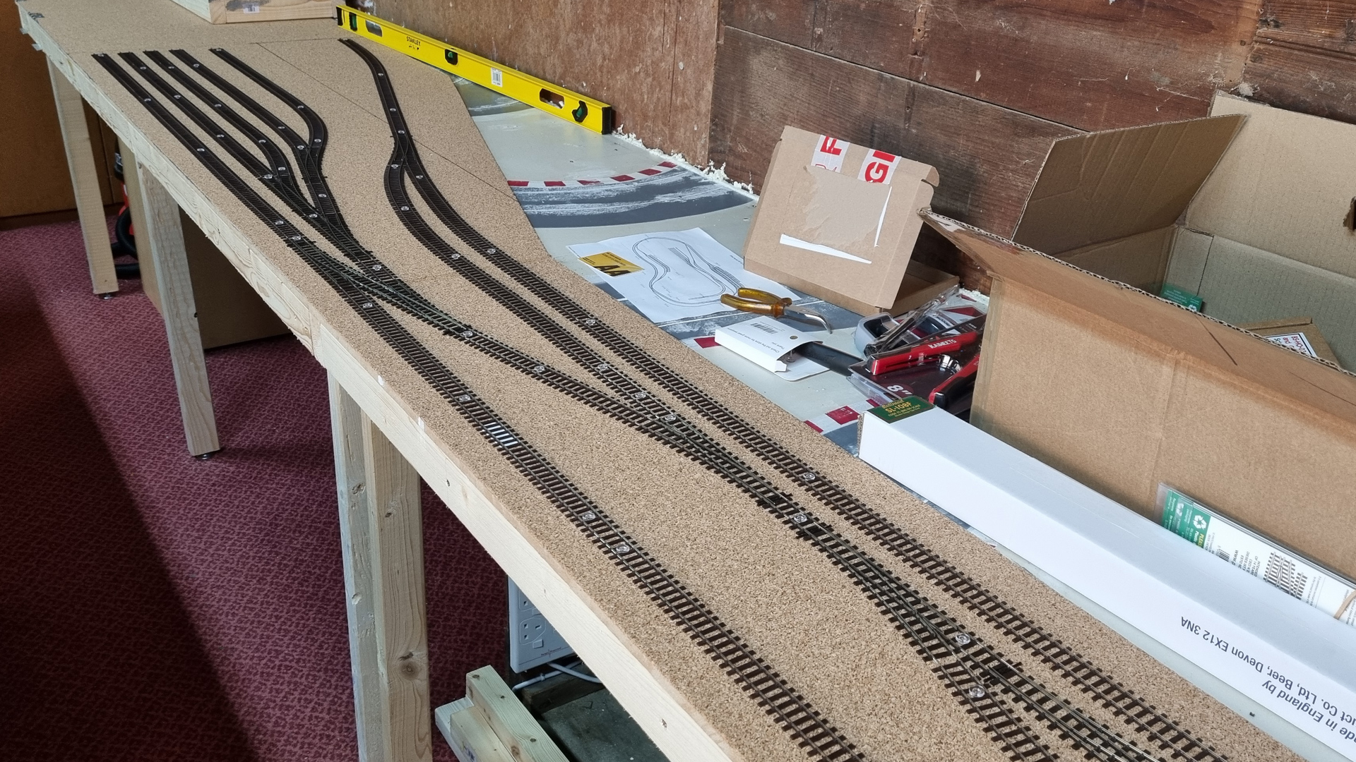

The rest of the lower level now cut and temp pinned in place.
[attachment=35826]
[attachment=35827]

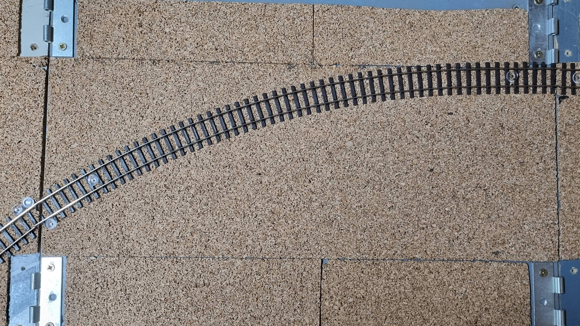

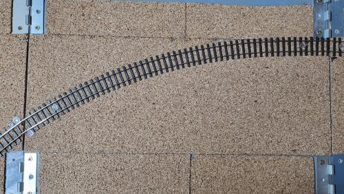

The lift out section, I was going to use the loose pin hinges, to join, but this seemed a bit "clunky" to me, so I have some flight case catches on the way to try instead.
[attachment=35828]

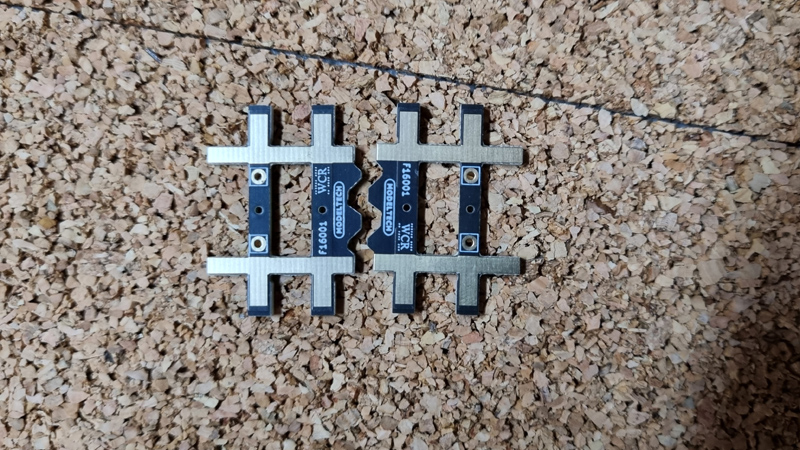

I bought these to help line up the joins, cut back a couple of sleepers and solder the rail to these .. fine on the square join, not sure how they will work out for the angled one !
[attachment=35829]

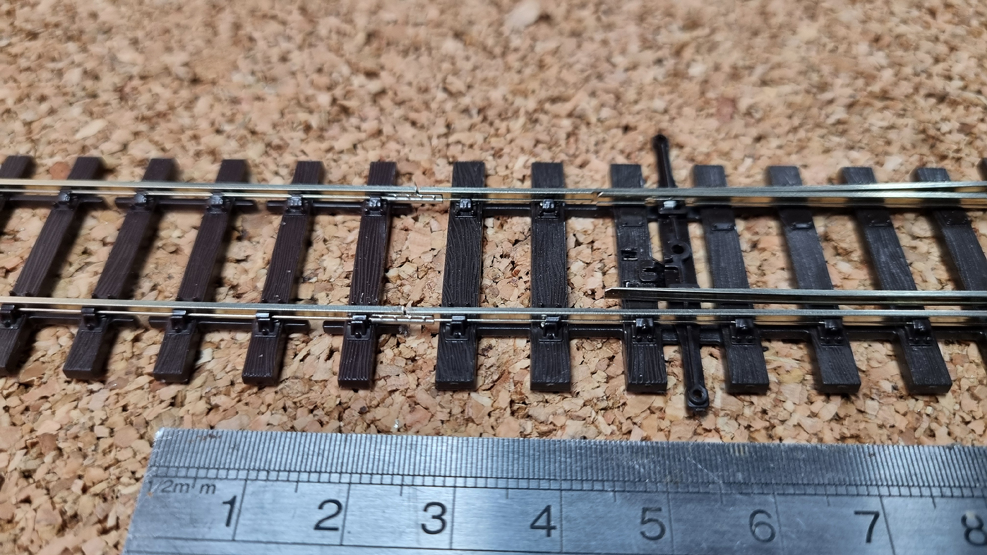

A close up of the joiners with detail to represent RL fishplates.
[attachment=35825]
As per my plan, the tightest bend on the main track is a 24 inch radius, a little over Hornby's biggest radius set track they sell which is approx 22.5 inches.

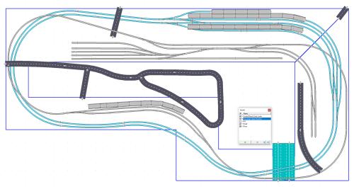

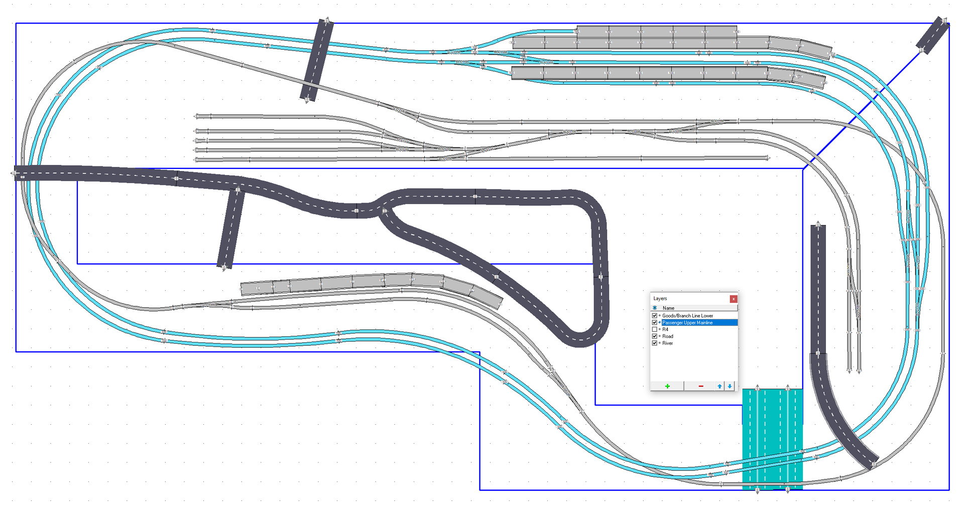

It has been a while and not a lot to add, but I have 3DP myself some point jigs for frog wires, point motor and dropper wire holes.
I also had time to contemplate th growing collection of Loco's, and so I decided the lower level branch line will now become a dual line too.
This obviously compromises on scenic plans a little but I think I have it sorted in my head now !
So the new layout will closely resemble this: Upper in blue, lower in grey.

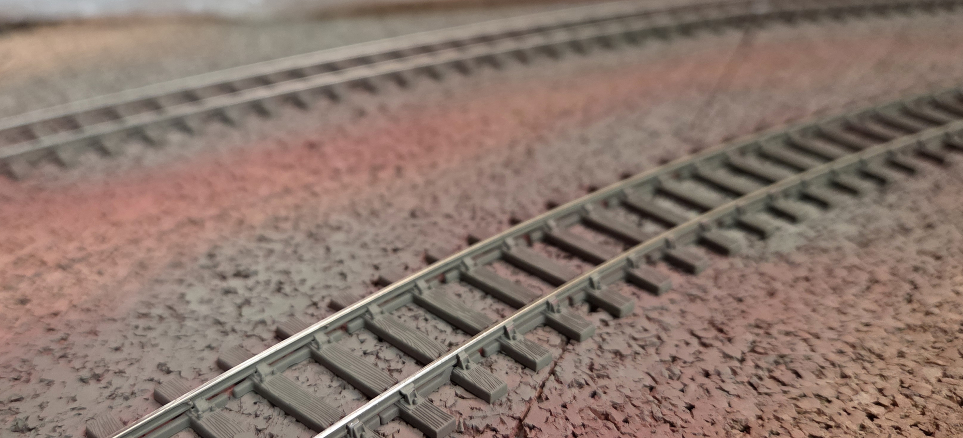

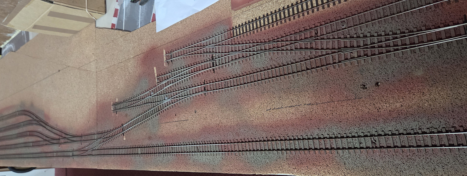

Today I got the base rust and sleeper grime coat down on the goods yard area (the only track in place and pinned atm).
Once painted and top of the rails cleaned, even though none of the dropper wires are connected, I tested out continuity with a cheap old Hornby set track controller and a 1980's manufactured  0-4-0 saddle tank.
Despite not being happy on the bullhead point checkrails (maybe B2B, maybe just older, chunkier wheels), she happily picked up power everywhere- result !
