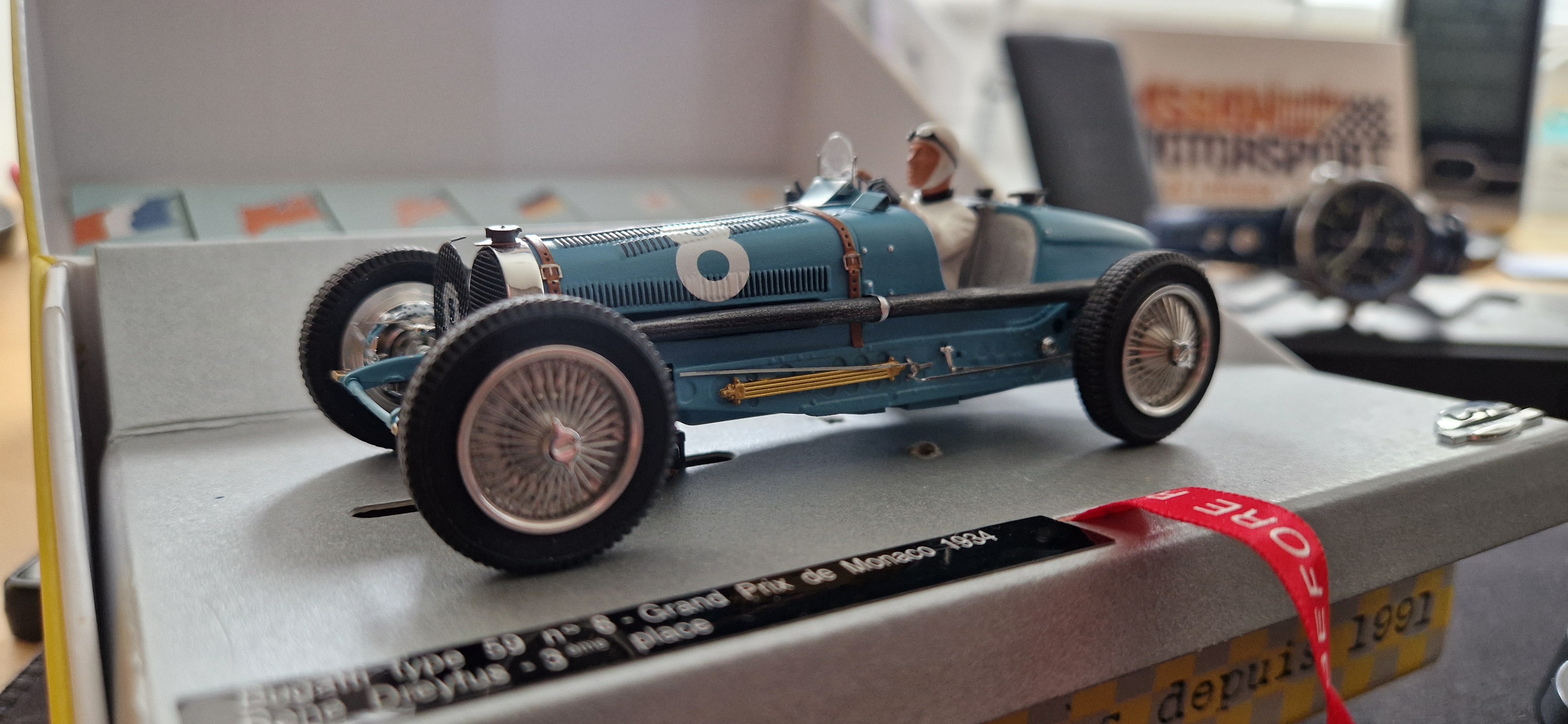

Just recieved my first ever Le Mans Miniature and oh wow, what a beautiful thing it is....

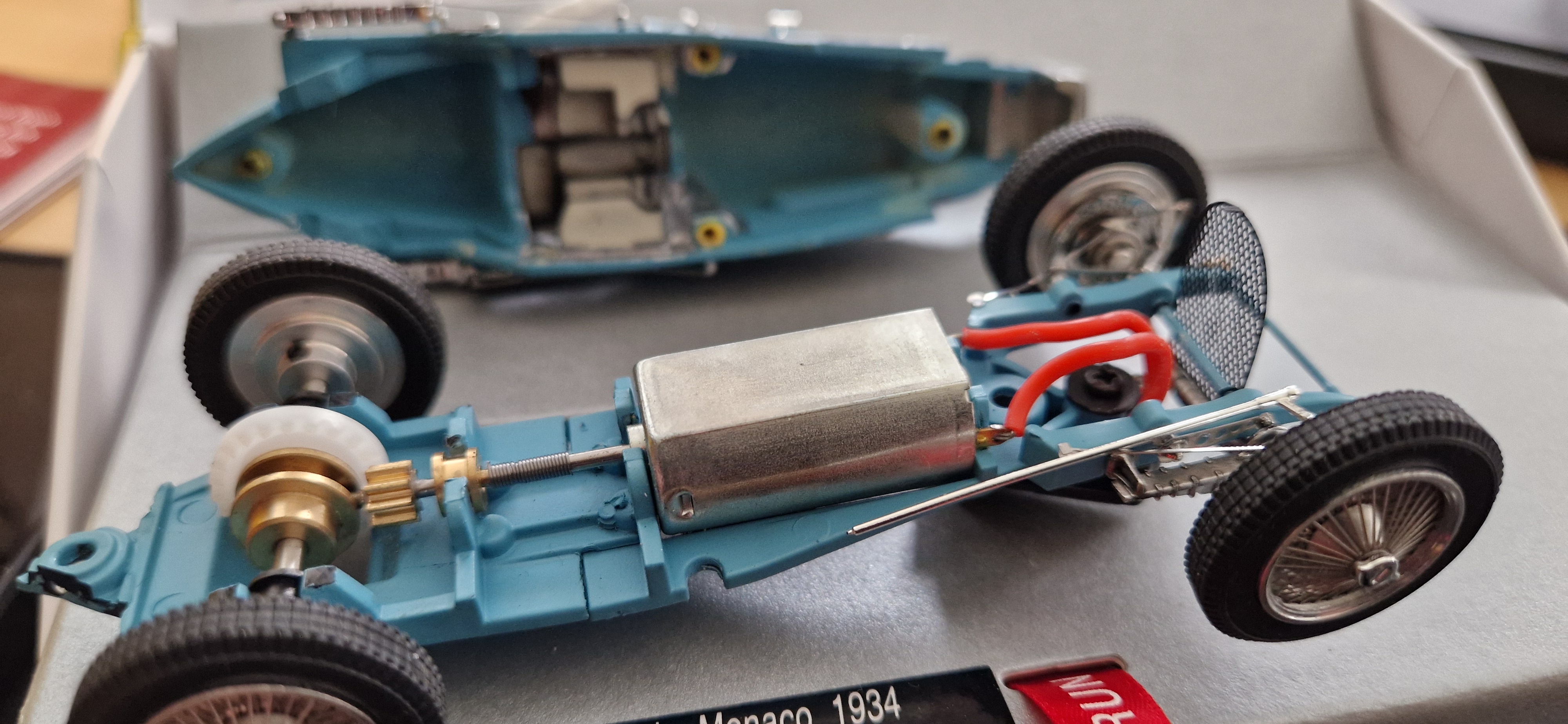

After briefly studying the fabulous details for many minutes.... out came the Phillips and off with its head (and body too) to look at the practicalities of squeezing a chip inside.
First conclusion, only a Sureguide is going to work.
The only place a chip is going to fit is on the motor.
If anyone has done this Bugatti Type 59 before please do share your findings.

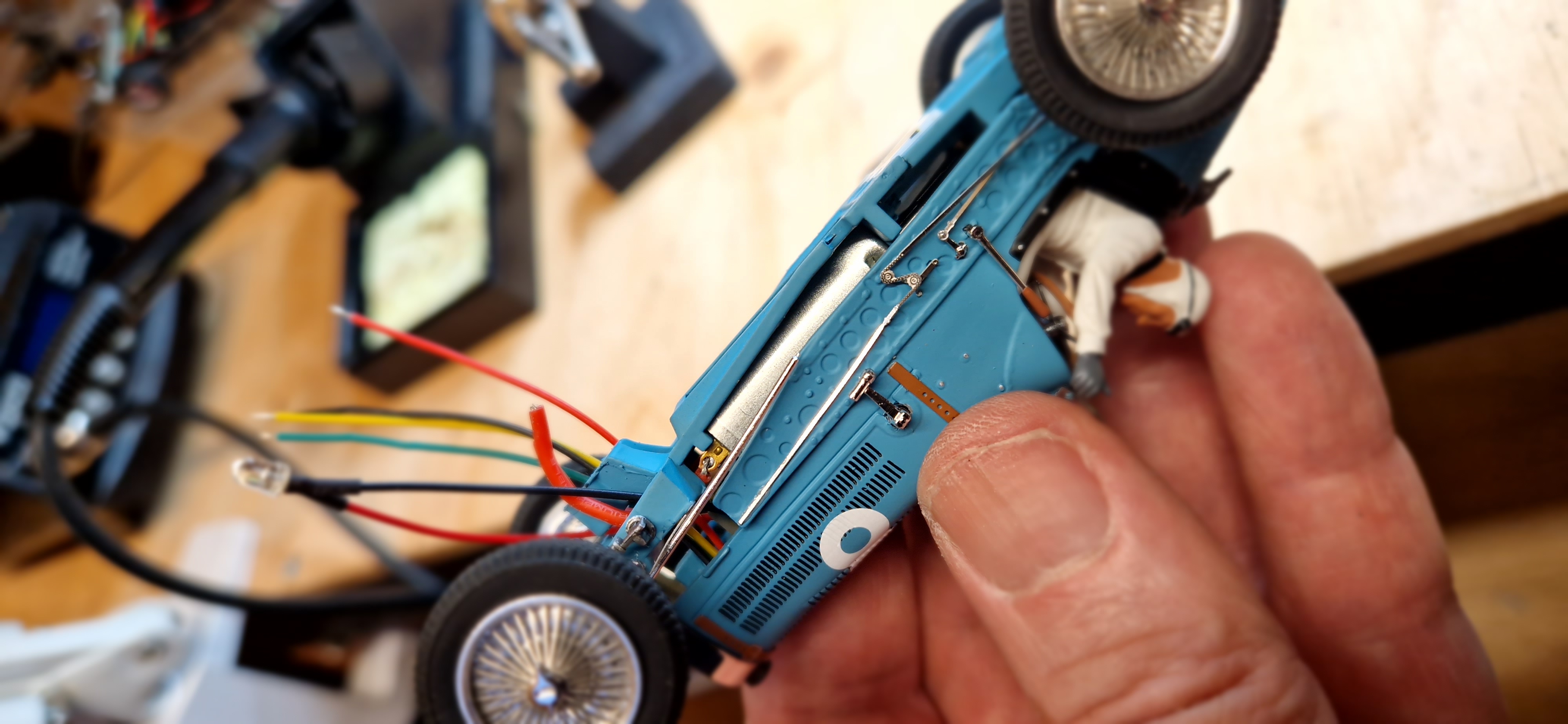

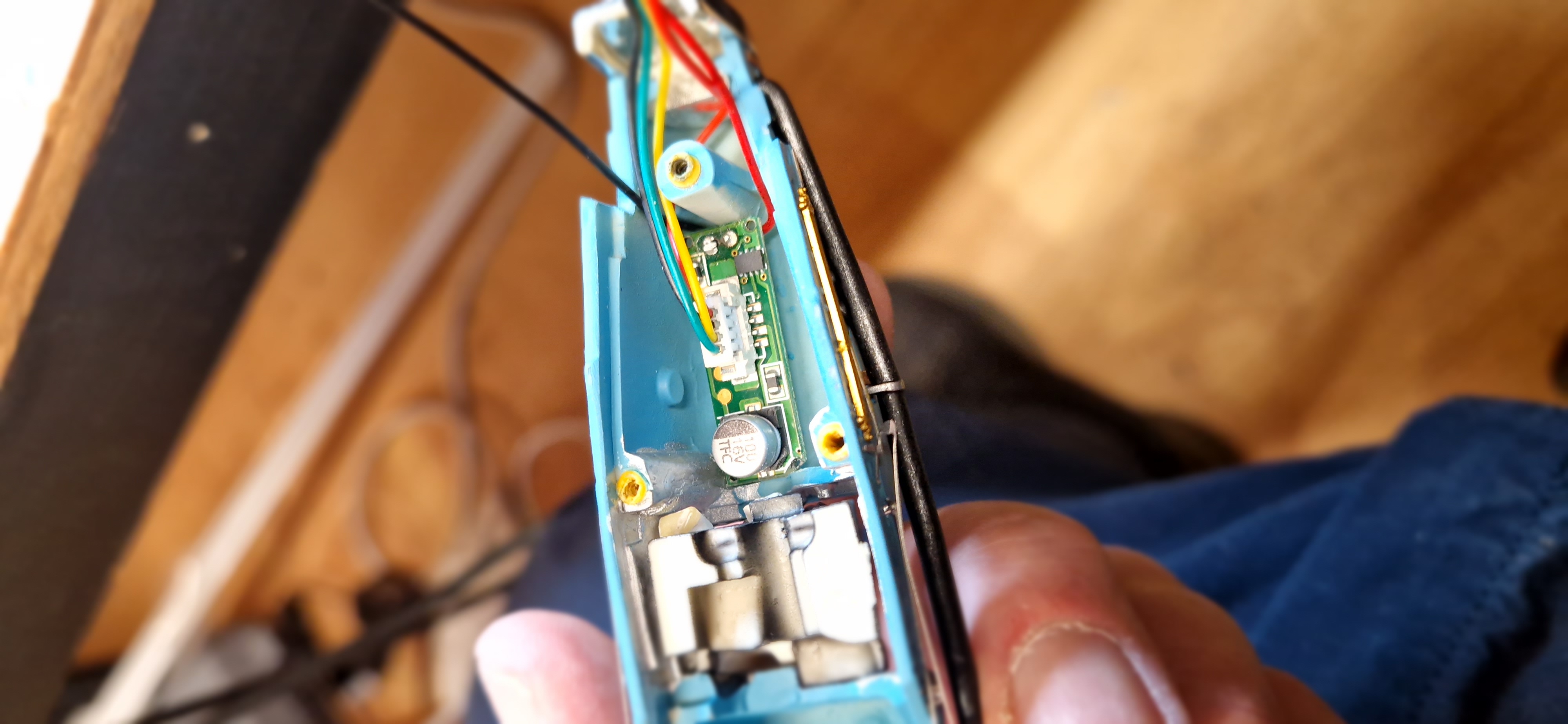

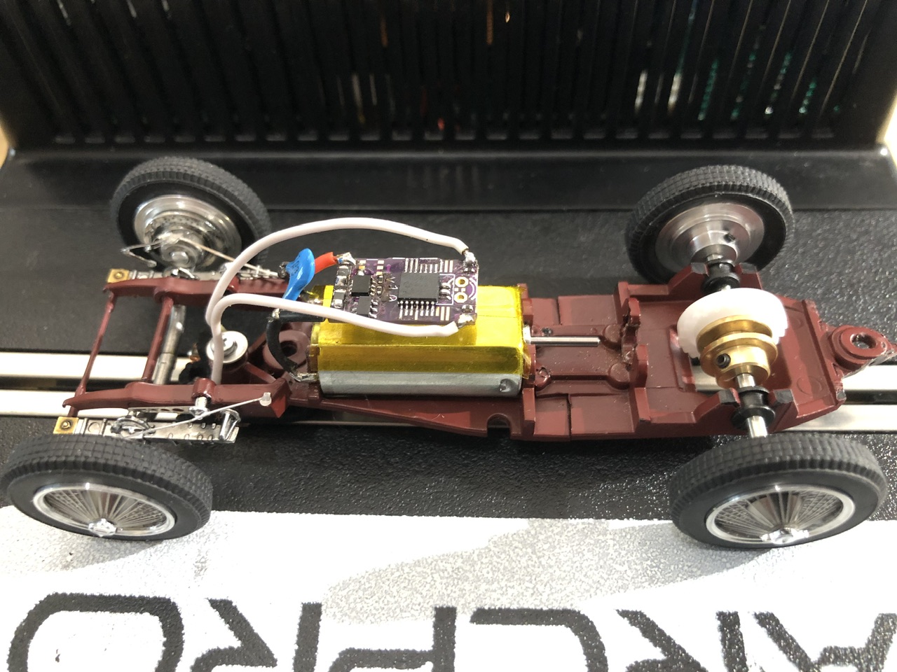

My first attempt at squeezing a modfied F1 chip inside the body failed, I moved onto fitting an even smaller SSD chip, which is the initiative of a chum who has been helping with some advanced electricary that theoretically allows 32 cars to run simultaneously on Goodwood. (In practice it cant cope with more than 8 due to speed).
The F1 chip, could be adapted by someone with better soldering skills than I, but removing the capacitor (only needed for analogue running) and the JST plug. This combined with moving the LED to a flying lead would just squeeze inside the body on top of the motor.
Here is an image of my failed attempt to use the F1 chip....[attachment=34984]
And here you can see how Fat the Chip is with capacitor and JST plug.... (see the shiny motor side protruding at the bottom of the body)[attachment=34985]
So we have resorted to the use of a brand new and significantly smaller SSD chip:[attachment=34986]

Looking at the prop shaft on the original car, the alignment between motor and crown pinion is not good, creating a lot of resistance within the spring trying to act as a UJ.
The answer has been to remove spring and sleeve the prop shaft (at least in theory).
With that completed we will be rebuilding and squeezing it all together.

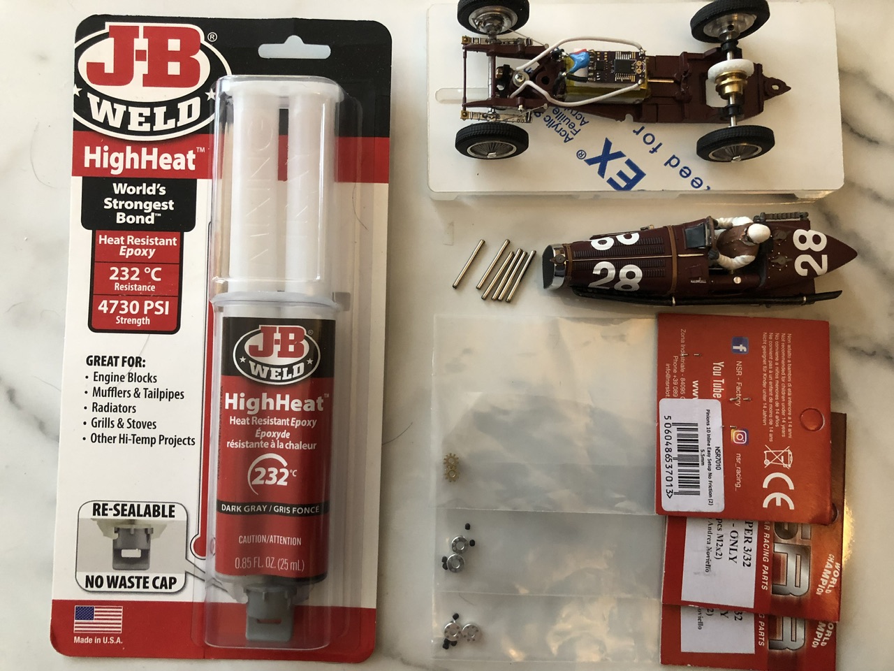

So first the ‘extra’ parts:
[attachment=35410]

As mentioned earlier, the ‘small’ SSD compatible decoder sits above the motor with a two-wire ultraflexible connection to the sure-change mounted LED. The LED is not show fitted in the above photo. Happily it does all fit.
We decided to replace the ‘simple spring’ style of universal joiner with a propshaft ‘liner’ approach to reduce internal transmission friction/loading.
The photo shows six of the required liners. These have an outer diameter of 2mm and an inside diameter of 1.5mm. Perfect!
The pinion gears fit ‘tightly’ onto the liner using a slot.it pinion pusher/puller. The liner is then a sliding fit onto the 1.5mm motor shalf. This is where the high temperature epoxy comes into play. Not yet tried - so if anyone has a better idea please let us know?
Positioning while the epoxy cures will be critical to achieve the correct propshaft length so the pinion correctly engages length-wise with the crown gear.
The final step will be to install axle stoppers to set the optimal meshing with the crown gear.
So that’s the plan :)
