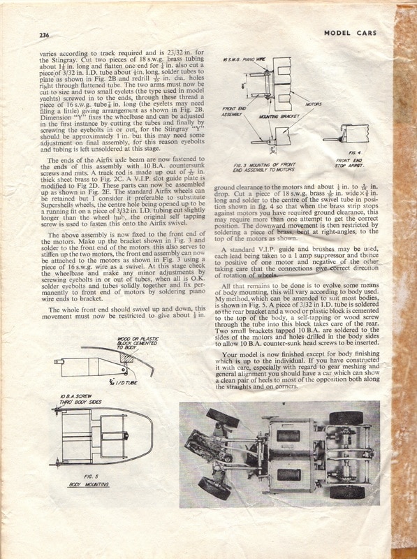

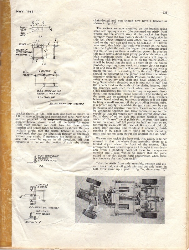

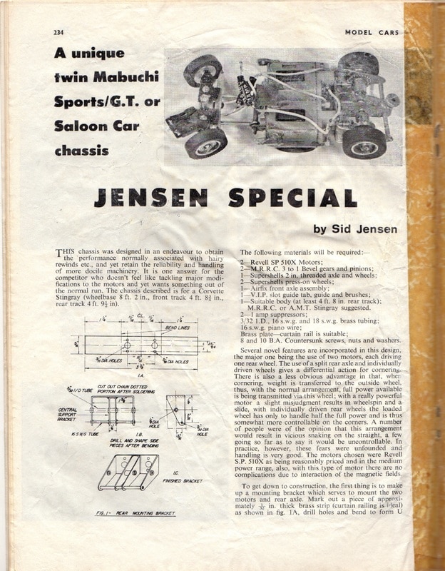

RE: V twin FF50 - Eddie Grice - 21st-Dec-23
[attachment=33130]
[attachment=33131]
[attachment=33132]
