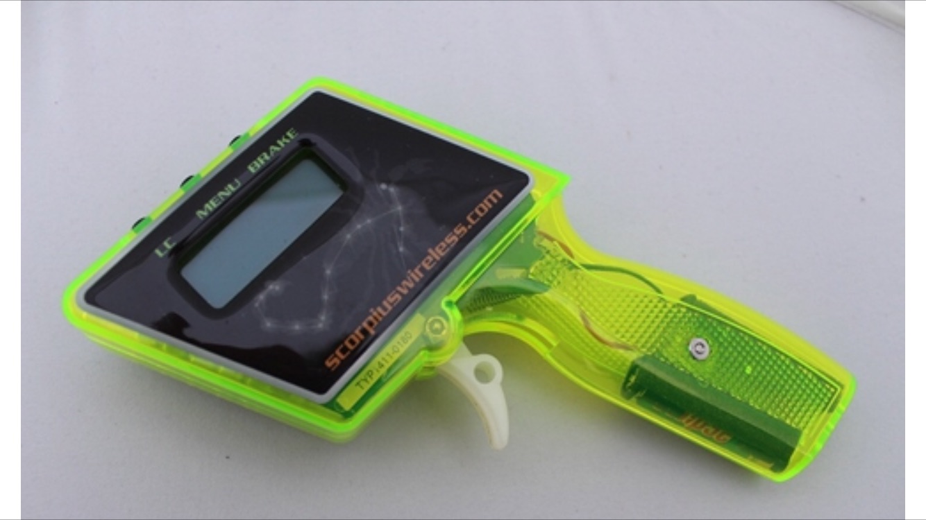

The best proven, quickest most reliable Scalextric digital combination still to this day is.
C7042
PC
Riko cable
Scorpius Controllers
Scorpius Dongle
RCS64 race software. (Unsupported)
ICP flashed decoders.
Scorpius controllers the only after market controllers for SSD for a decade continuously without a single glitch ever.
They are also very sexy
Advanced throttle mapping. LCD screen. Long battery life. Fastest lap times guaranteed or your money including postage refunded in full immediately. Available now in our web shop.
[attachment=32960]
Rick
