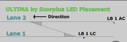

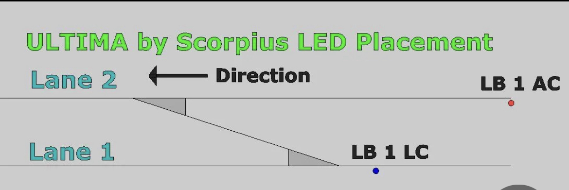

AC is totally a function of the Lane Brain relying off data from the cars. LEDs are placed in the track before the lane changer. The Lane Change LED is placed around 120-200mm (distance is relative to speed) before the flipper. The AC LED is in the adjacent lane (The lane the cars change into) a further 120-200 before the LC LED.

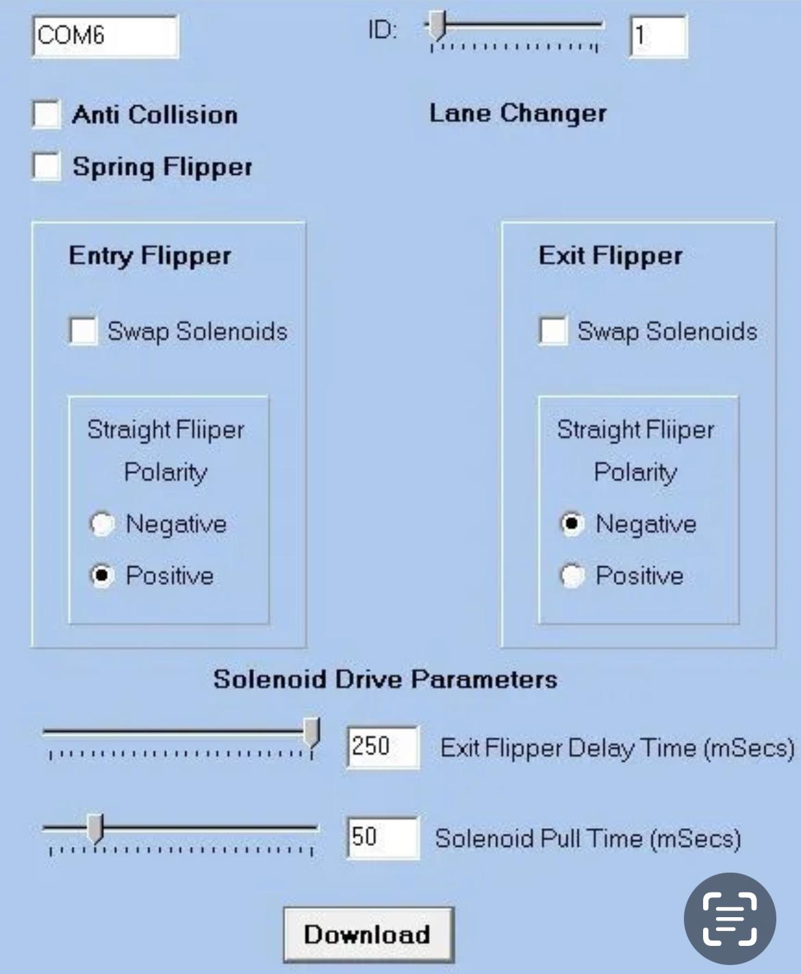

Using the Lane Brain set up page you can configure AC and lots of other adjustable parameters.
ie, Put the LED a fraction too far from the flipper? Easy, use delay.
Wired solenoid back to front? Easy, tick "Swap Flippers"
Using a pit lane entry, the liven flipper polarity will be set up to change lanes the other way. Need to change liven flipper polarity? Easy, just change polarity.
Want anti collision? Easy just tick the box,. Dont want it just untick.
Exit flipper opens and closes before the car passes through? Just increase the delay time.

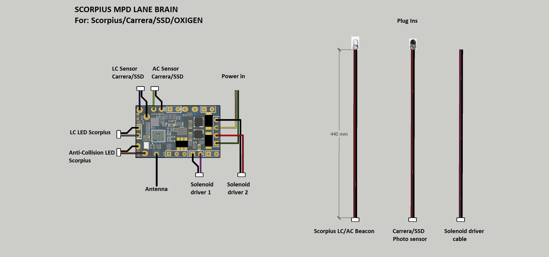

The MPD does all the work. The car does nothing. The MPD captures the SSD cars ID from the infrared signal displayed from the cars LED embedded in the chassis. From here it processes everything and operates the lane changer accordingly.
Pics showing:
MPD Lane Brain for SSD users
Photo sensor placement
Configuration software.m
